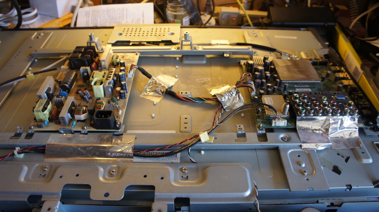

    I have been incorrectly posting to an existing thread that is for a different model Insignia. I am now going to post all the facts I have regarding the NS-L37Q-10A I am trying to fix.
    Plug in TV and red light glows. Press ON button or turn on with remote and red light changes to blue. So remote sensor appears to be working.
    "Please Wait" displays on screen for a few seconds - not very bright.
    Screen does appear to have some backlight when viewed in dark room. Light appears to be at top center, not all around the perimeter.
    I have checked voltages at PS connector that goes to Main Board. and all voltages are correct at PS end. Have not checked at MB end of cable.
    At one point I connected an XBox thru HDMI and heard some audio. But, I was trying to change inputs on the TV and pressed the button too soon. Now I can't get back to where I hear audio.

    Where is the inverter board on this TV. I can't seem to find it
      Re: Insignia NS-L37Q-10A No screen display
      You power supply-inverter board combo.

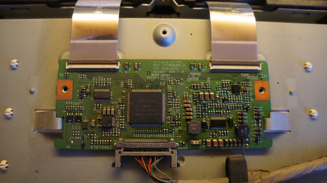

      So you do have backlights but no pictures on the screen, then you need to find out if you do have 12VDC at both ends of the SMD fuse on the T-CON board with ref to chassis GND.
      The fuse is the white fuse to the right of the LVDS connector on the T-CON board.

        So the inverters are on the power board, correct? No separate inverter board. I do have 12 V on both sides of the fuse on T-Conn board. I can see the backlight light up after a few seconds when I turn on TV. Also there is a blue LED on T-Conn that lights up momentarily (LD2). The backlight I can see goes out after a few seconds and then the blue LED also goes out. For clarification, I am looking at the chassis side and can see light at some of the cutouts along bottom of chassis. The light must be on when it is displaying "Please Wait". So it appears the backlight does not stay on when "Please Wait" goes away.
          "So the inverters are on the power board, correct?" Yes.
          OK, for less confusion, that backlights did come on and then go off but the BL-ON is still present, if that is the case, we need to look at the inverterter section of the power supply board, hopefully it will not be the lamps problem.

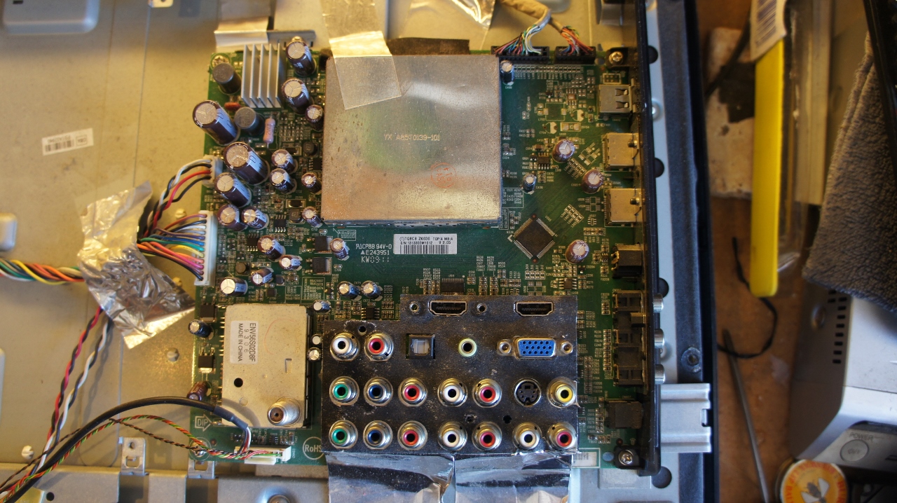

            Where is the BL_ON pin? Is it on the main PS connector at the other end from the two 5 V pins?
              It should be one of the pin of that white connector that goes to the main board, I cannot see if there is any pin labels on that connector, the picture is not in focus.
                OK. Sorry about the picture. There are 2 pins on main board end of the PS cable that are marked BL and one pin next to them that is marked BR. Both BL pins have approx 3.3VDC and BR pin has approx 12VDC.
                  I would trace that 12V and see if it goes to that fuse. If it does I would also check the path AFTER that fuse and check all the components after the fuse and see if goes almost to the display or to the display.

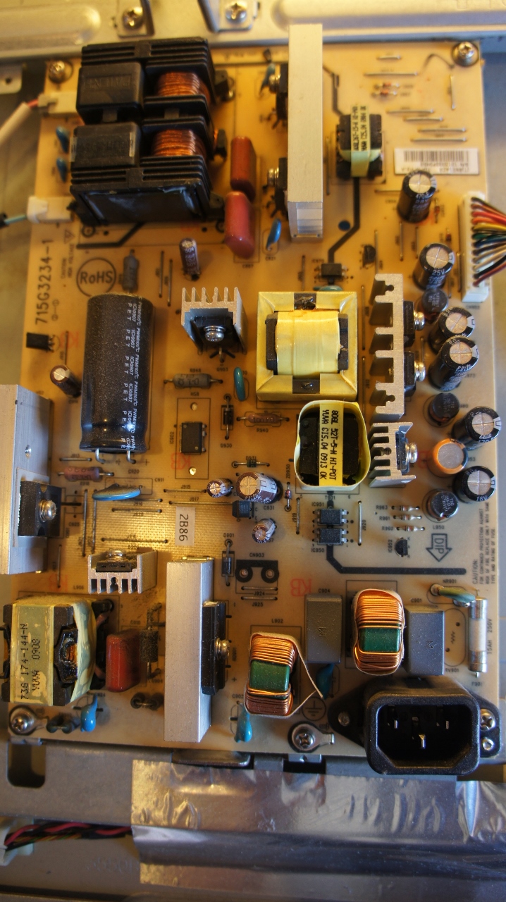

                        The connector on the power supply-inverter board has labels for the pins. Please give me the listing of the pins.

                              From the top down on PS Board they are:
                              1 - O/F
                              2 - DIM
                              3 - +12V
                              4 - +12V
                              5 - GND
                              6 - GND
                              7 - GND
                              8 - 24V
                              9 - 24V
                              10 - PS_ON
                              11 - +5V
                              12 - +5V
                              On Main Board - Pin 1 is at the bottom

                                So tell me what DCV you have on ALL those pins (except the GND pin) after the TV goes black.
                                  1 - o/f = 3.31
                                  2 - dim = 3.35
                                  3 - +12v = 12.3
                                  4 - +12v = 12.3
                                  5 - gnd
                                  6 - gnd
                                  7 - gnd
                                  8 - 24v = 25.2
                                  9 - 24v = 25.2
                                  10 - ps_on = 4.73
                                  11 - +5v = 5.2
                                  12 - +5v = 5.2
                                    hello Budm - Do these voltages look OK? Can I check the voltage on the two single wires coming off the transformers and going into the chassis - I think they must be the power for the CFL bulbs.

                                      They are all correct, so we need to look further why the backlights come on and shut down.
                                        I tried measuring the voltage coming from the pwr supply on the two single wire connectors adjacent to the two black transformers in the upper left corner (ref the picture I posted. I have a industrial autoranging digital VOM and whatever happens on that connector, it blows the meters mind. I tried both DC and AC ranges and the meter shuts itself down after a couple seconds of wild fluctuation. I think these are the wires powering the CFLs. So I don't know what is going to the bulbs.
