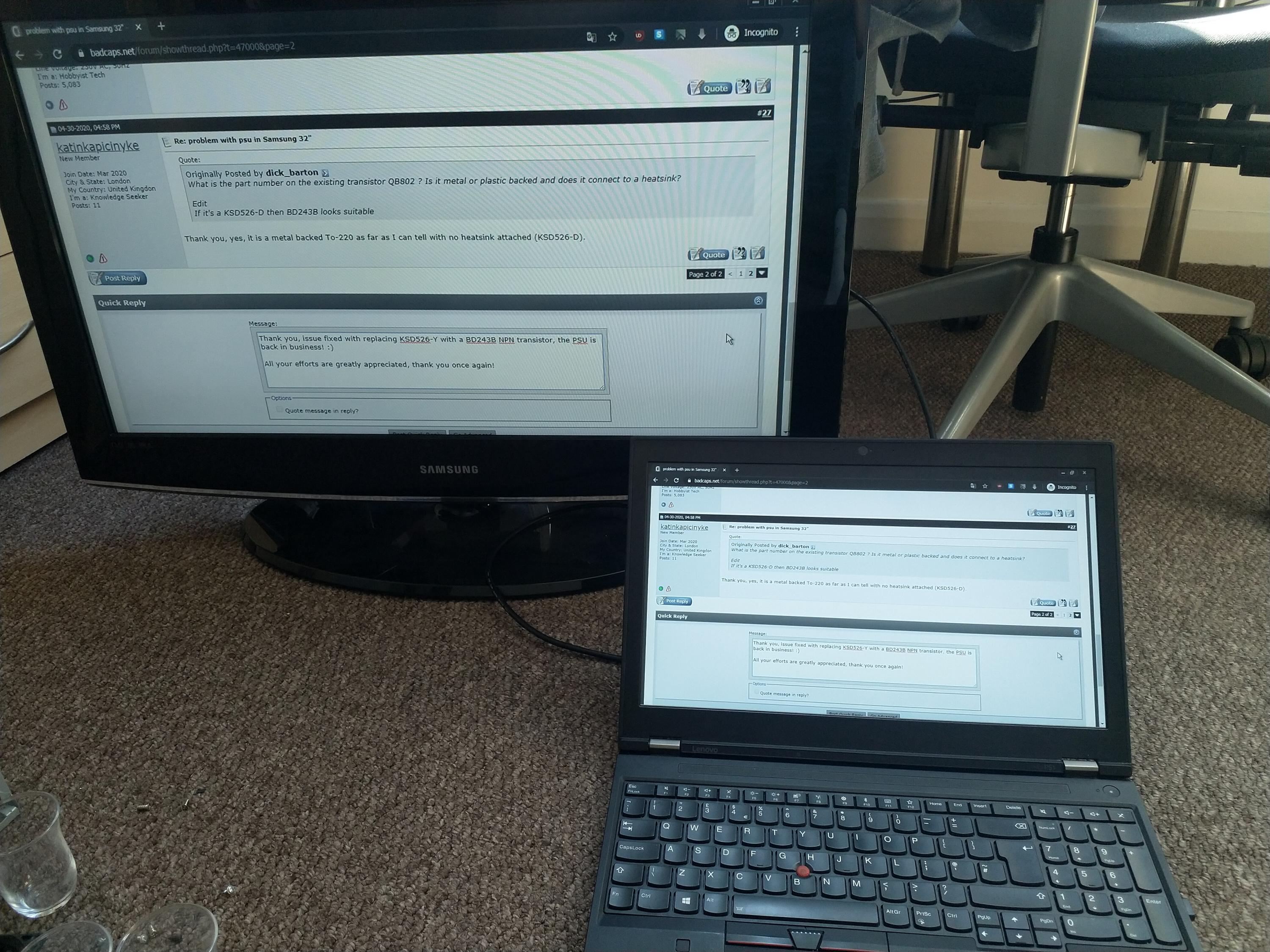

                Thank you, yes, it is a metal backed To-220 as far as I can tell with no heatsink attached (KSD526-D).
                • katinkapicinyke
                  • Mar 2020
                  • 12
                  • United Kingdon
                  Re: problem with psu in Samsung 32"
                  Reporting back here chaps, issue fixed with replacing KSD526-Y with a BD243B NPN transistor, the PSU is back in business!
                  All your efforts are greatly appreciated, thank you once again!
