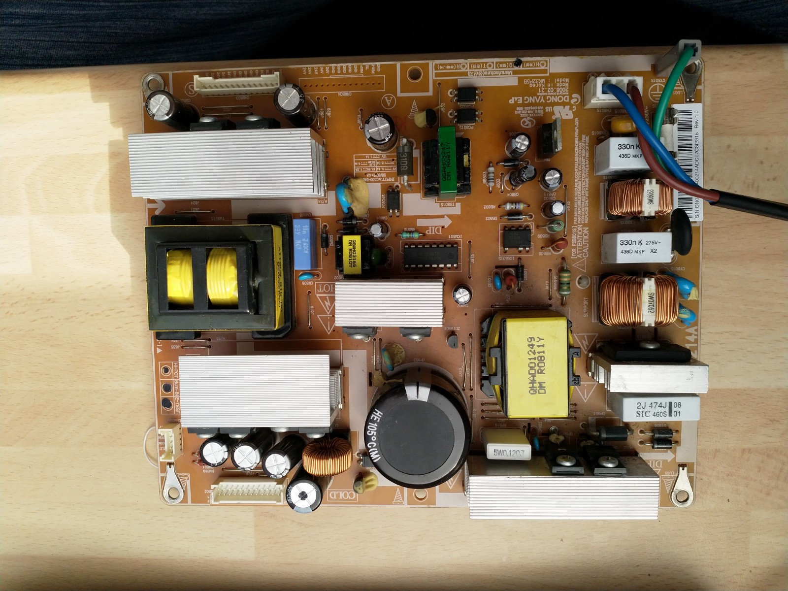

    Hi there guys i have a Samsung LE32A457C1D which has the BN44-00214A PSU, when i first got the tv i noticed a burn / bulge mark on the back of the tv but when i popped off the back i nnoticed it is the big cap that is causing this, not too sure whether to switch tv on or not, does anyone know what could be the issue ?

    Re: problem with psu in Samsung 32"
    https://drive.google.com/open?id=0B8...ZnM&authuser=0
    https://drive.google.com/open?id=0B8...TEE&authuser=0
    https://drive.google.com/open?id=0B8...dlE&authuser=0
    https://drive.google.com/open?id=0B8...NnM&authuser=0
    https://drive.google.com/open?id=0B8...eG8&authuser=0
              Yep that capacitor let go and go so hot it melted the back cover!
              I wonder what made it go like that....must have spewed a lot of stinky smelling steam!
              I'd also suggest that you replace all the other electrolytic capacitors on this PSU, they are known to fail.
              -Ben
              Muh-soggy-knee
                Check that blue disc cap next to that big cap also, looks like the glue already turned conductive and the legs may be eaten away.

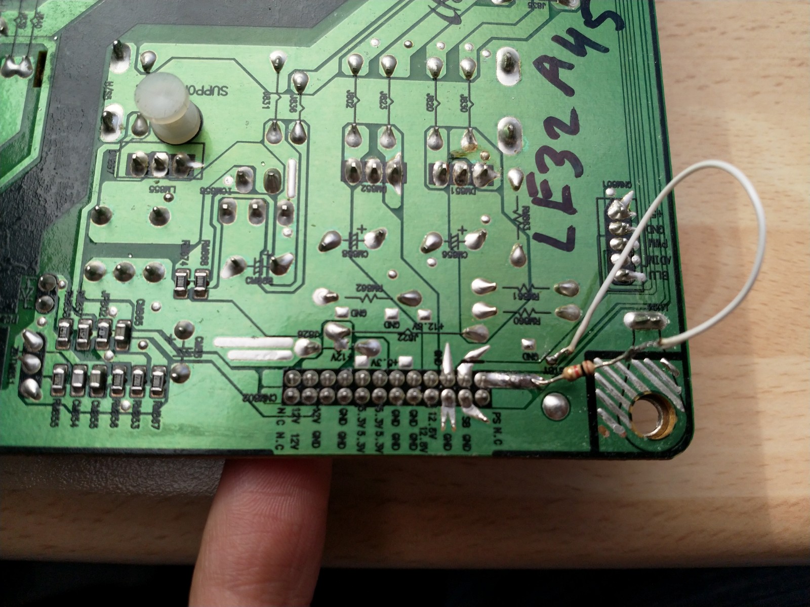

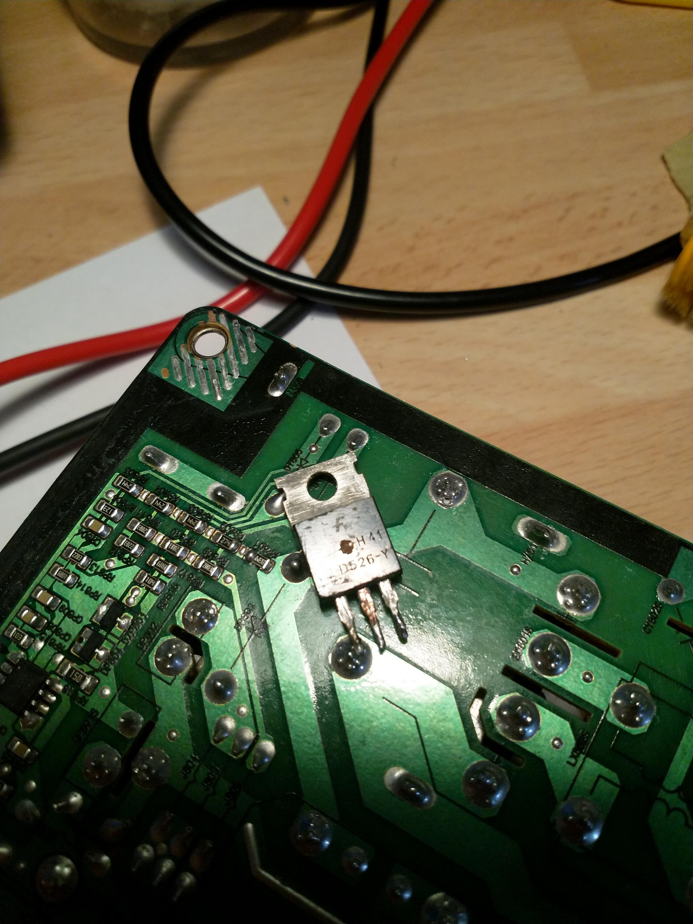

                    Hi All,
                    Sorry to resurrect such an ancient topic but dealing with an issue on the same model (Samsung LE32A457C1D) with the same PSU board. Did checks on the cold side of the PSU board, no sign of the 12V+ outputs (on turning on I get the same 5 red LED flashes and then nothing). That dreadful glue was all over QB802 and CP811, de-soldered QB802 (Fairchild D526-Y NPN transistor maybe?) and removed the glue, however the transistor test appears to be failing between B (with positive probe) towards E (negative probe) and C (negative probe) in diode mode with my super basic MM.
                    Can I order a D526-Y off from Aliexpress for a few bucks and try replacing that on its own?
                    Also, I'm measuring 84.2 uF for CP811 (schematics suggest 47uF...) but my MM is quite a cheap one, could the capacitor ok and just the meter off?
                    Is there anything else worth checking around which usually goes at the same time when QB802 is blown?
                    2nd post only, please be gentle but any suggestion would be appreciated!

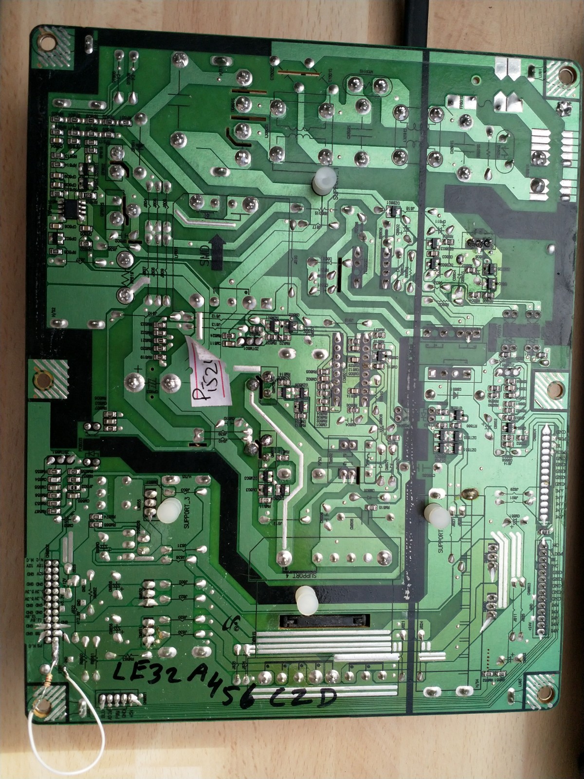

                          1) Can I see straight shot pictures of top and bottom side of YOUR board?
                          2) What Voltage do you get on E, C, and B of the QB802 if you put the Transistor back in place?
                          3) You said you do not get 12V, how about the 24v?
                          4) There will be no 12V or 24V if PS-ON is not present, so do you have PS-ON control Voltage?

                            First of all, thank you for all the above suggestions, much appreciated.
                            I've got a 1k resistor installed between SB and PS pins on CNM802, still no output on 12V/24V rails (I can measure 5.2V on the SB, also around 4V on PS once it is connected with the resistor).
                            With the above jumper in place, I'm only measuring about 324-330V on the big cap (CP803).
                            With the above jumper in place, I'm getting the following on QB802 (relative to HOT side GND of CP803):
                            Base:16.15V
                            Collector:23.9V
                            Emitter:0.04V
                            without the above jumper in place, I'm getting the following on QB802 (relative to HOT side GND of CP803):
                            Base:0.4V
                            Collector:26.33V
                            Emitter:0.2V
                            Once again, thanks for your time while looking into this.

                              One more thing please, with the mainboard, TCON and inverter connected I get 3.3V of SB constantly (would I be correct assuming logical HIGH sent back from the mainboard?) while powered up, it drops only for a mere second, so like goes to logical LOW (0V) and then back to 3.3V.

                                    Check DB801,DB802.
                                    • R_J
                                      • Jun 2012
                                      • 9557
                                      You are on the right track,
                                      Base:16.15V
                                      Collector:23.9V
                                      Emitter:0.04V
                                      The emitter voltage is missing, either due to an open QB802 or you have too much of a load on the M_VCC line. Check the resistance across CP811, this will give an idea of where the problem is.
                                      You could have a bad ICP801S, or bad ICM801, or it is possible CP811, CP805, CM807, CM814 are shorted

                                        Thank you, I can see no short on CP811, CP805 (took me some time to find, little SMD bugger!), neither on CP805, CM807, nor on CM814.
                                        The resistance between the two legs of CP811 is around 4.5K Ohm, give or take due to my meters tolerance.
