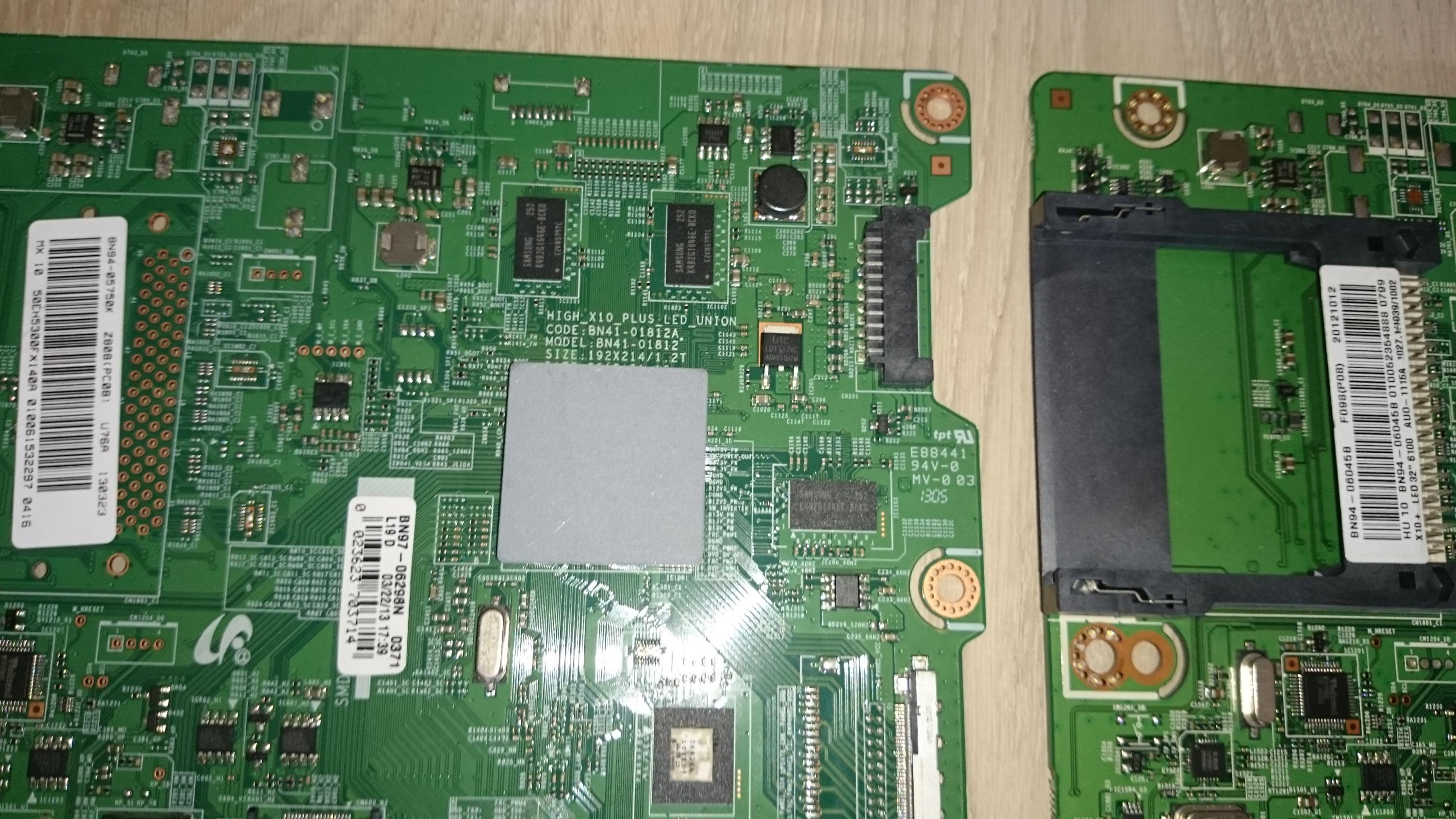

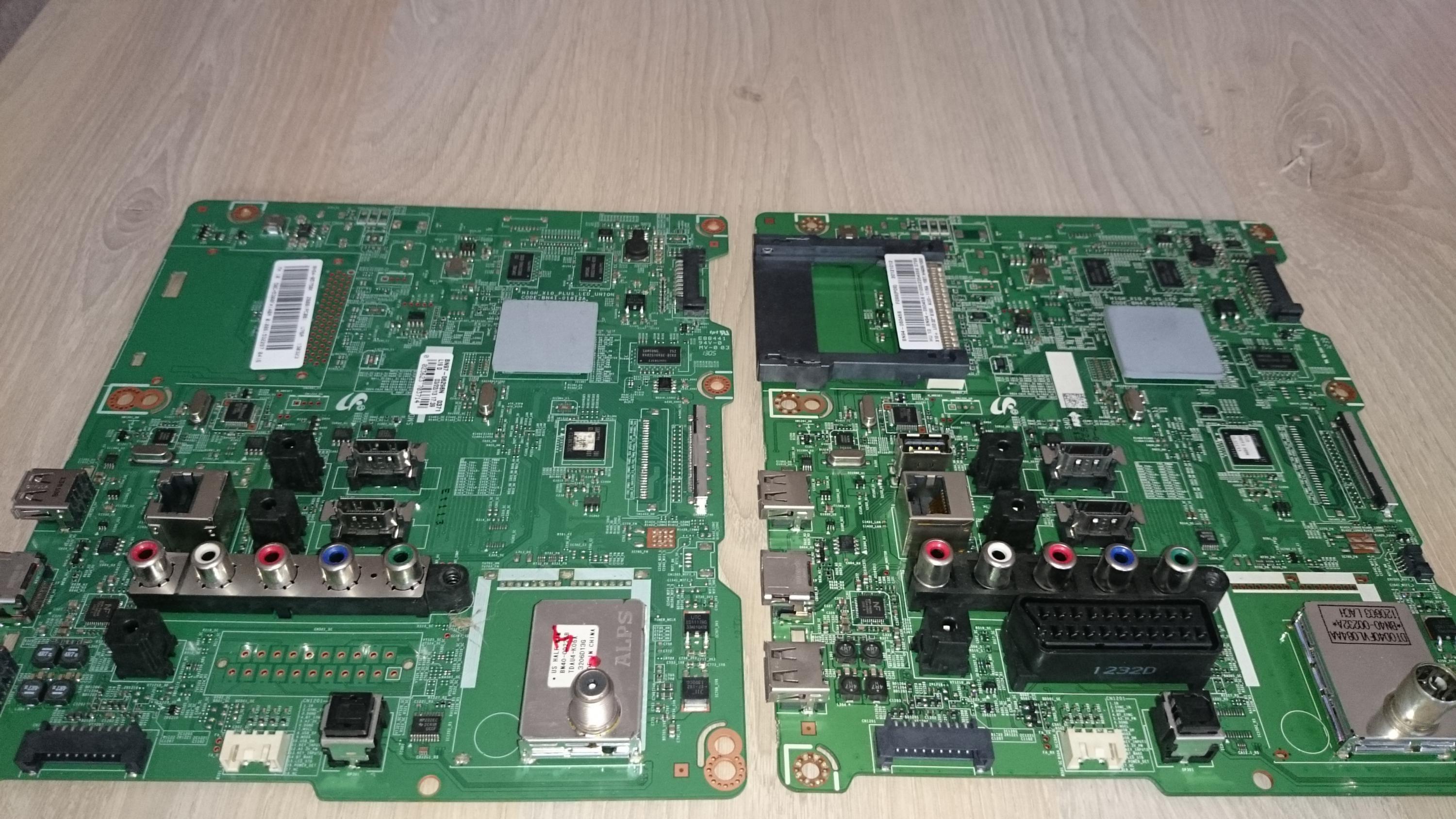

        Re: Samsung UE32ES6100 Blinking led.
        Here are the pictures of the boards.
        Original board is the board on the right.
        Tv immediately starts with 5x double blink ( blink blink STOP blink blink STOP blink blink etc etc ).

              So i got a new mainboard ( BN94-05920B ) , replaced it with the old mainboard and still the same blinking pattern.
              Im lost here , can it be a T-con problem or is it still a powersupply problem?

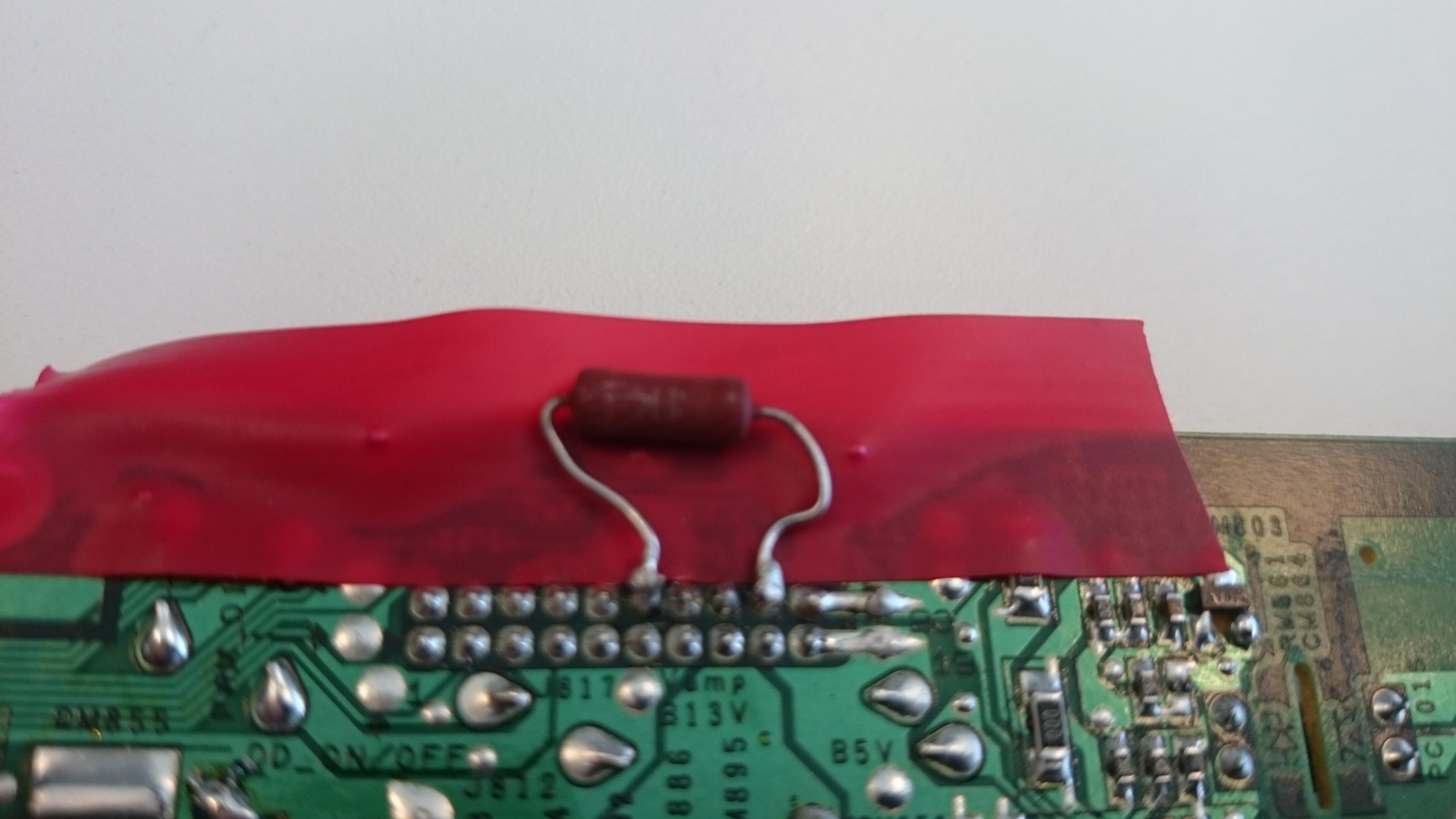

                What happens if you disconnect all the boards and force the PSU on with a 1k ohm resistor between STBY and PSON, STBY to BLon?
                  Note PSON on a samsung set is likely to be active low so try STBY to GND as well..

                        So i removed the cable from the mainboard.
                        I tried all 3 options with a 1K resistor and nothing happens. ( no backlight ).
                        I do have 5V/3.3V/12V.

                          Unplug all boards, force the PSU on and check the PFC filter cap for more than 360V DC. Be careful on the primary side. As long as you measure things at the primary, the negative on the filter cap is the GND.
                          Did you wire STBY through 1k resistor to BLon?
                            1K resistor between pin 18 and pin 12.
                            I dont get a high voltage on the caps you mentioned. I do get 45v on backlight connector.

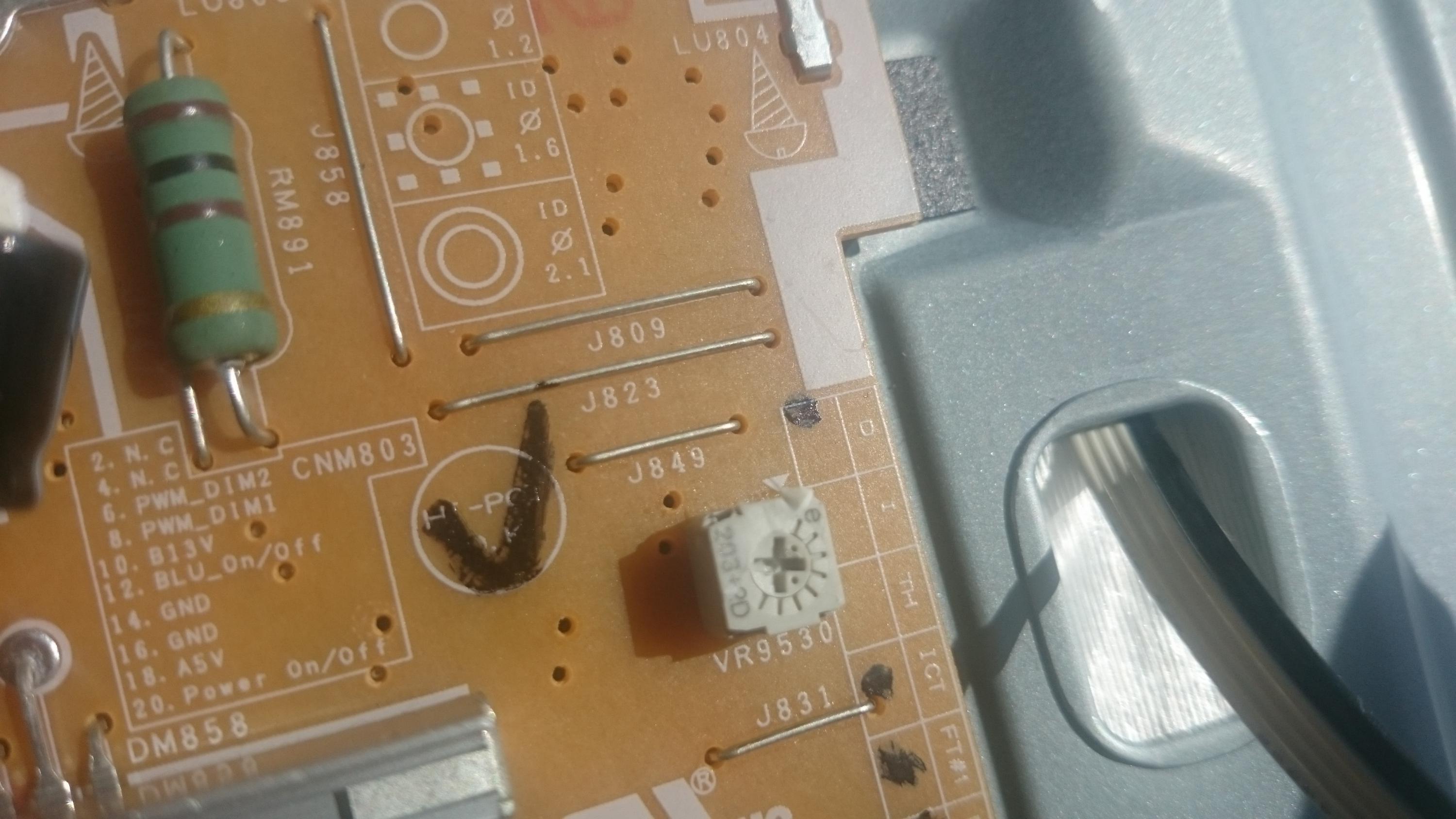

                              Did you check that big filter cap on the primary side of the PSU? Hmm... could you post a picture of the PSU and another one from the whole back side of the TV to see how things are connected?
                              • Moreno83
                                • Jun 2014
                                • 2008
                                • The Netherlands
                                https://www.badcaps.net/forum/attach...5&d=1434803394
                                Hope this works!
                                Yes i measured on the big caps.
