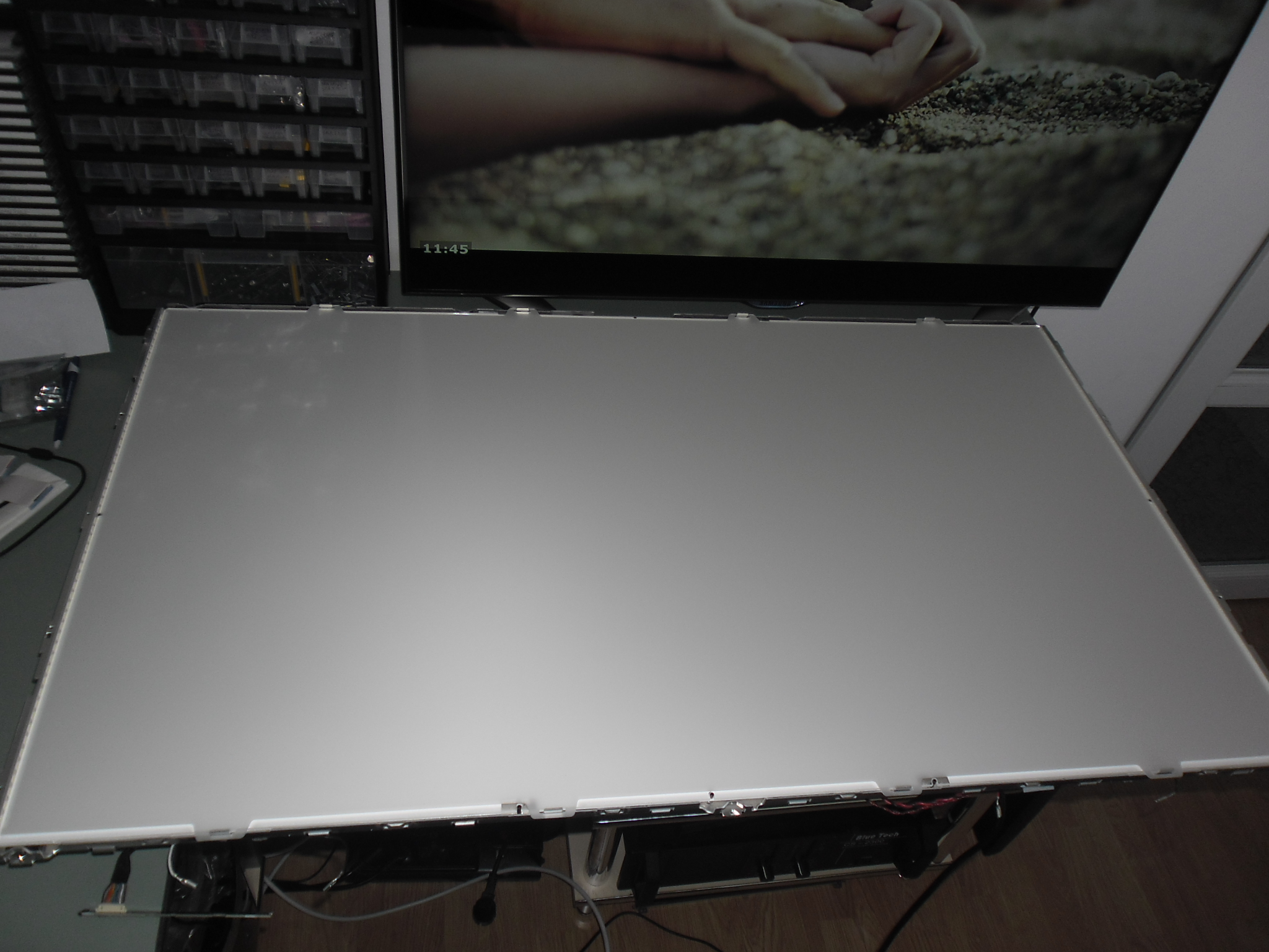

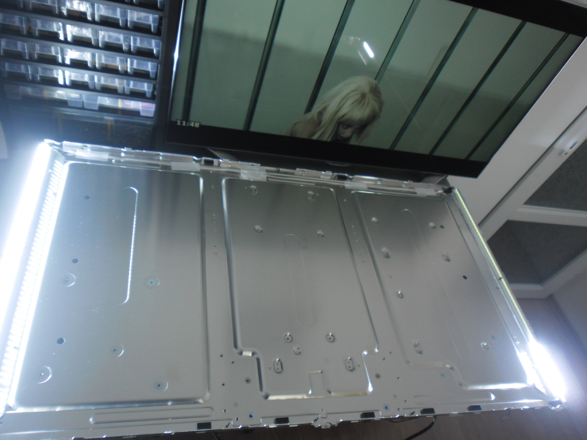

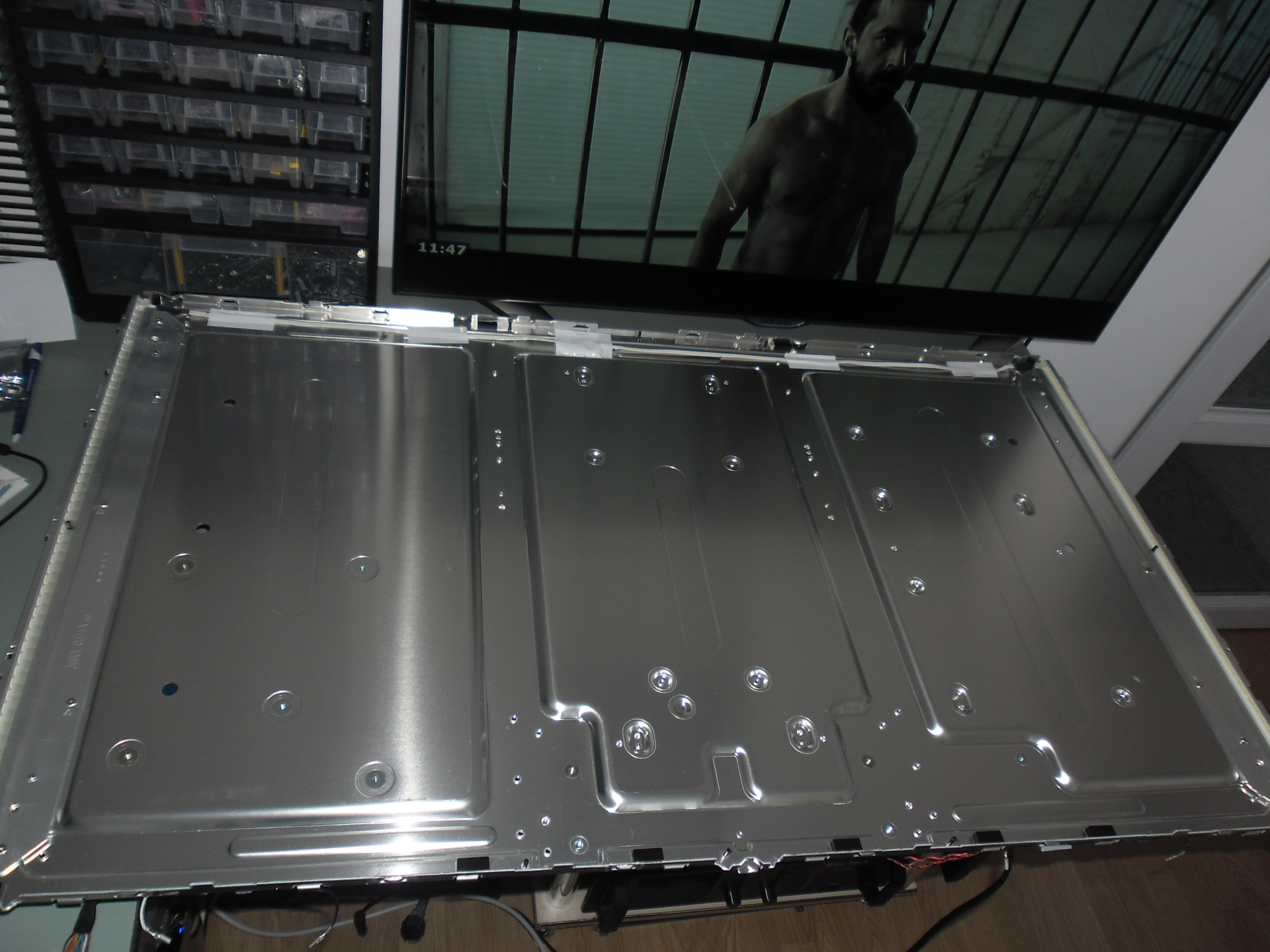

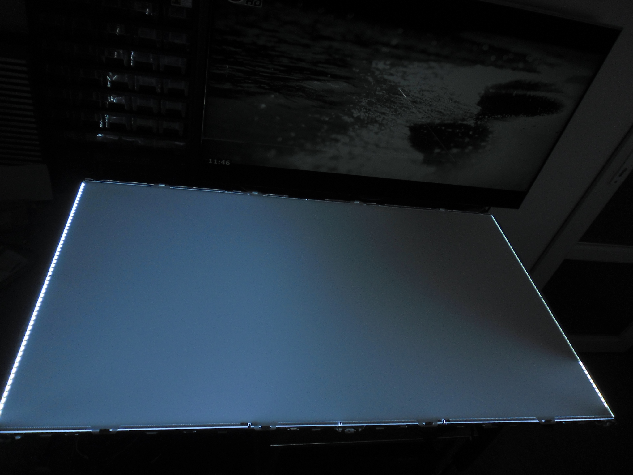

          Re: Samsung UN40H5203AF LED backlight out
          Guide yourself from my pictures, different model.
              This one is backlit instead of sidelit, so it's a bit different. I'll get it figured out though.
              Thanks for the pictures

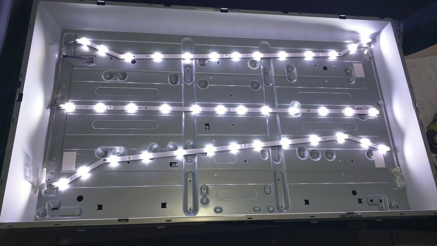

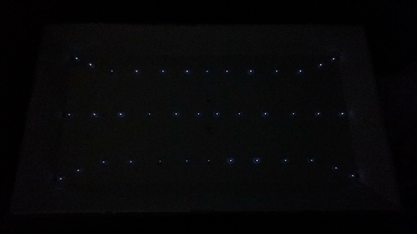

                  Ok, a little more diagnostic info. I was able to get to the strips. There are 3 LED strips. All the LEDs appear to be lit, but extremely faintly. Have to put a towel over my head to see them.
                  I measured about 120V across the top strip, but only ~17V across the middle and bottom strips.
                  Also, at one point I accidentally had my meter in continuity/diode test mode instead of voltage when connecting across the +/- terminals on the first strip. The middle and bottom strips immediately lit up to full brightness while I did this.

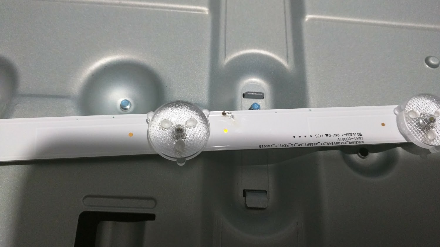

                    Looks like the top strip has high resistance.
                    • lordkev
                      • Jun 2015
                      • 7
                      • St Kitts
                      This is really strange. I swapped the top and bottom LED strips which appear to be the same, and BINGO all the backlighting turned on. We'll see if it lasts, but for now I'm a happy camper.

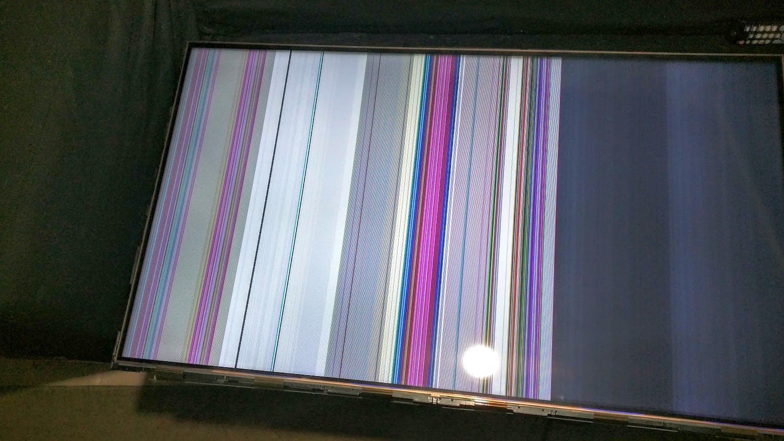

                            Hah. Is your TV still working? Picked up the same model today with exactly the same results as yours. Saw a burn mark on the top strip.
                            Swapped it with the bottom, and sure enough, all the LEDs are evenly lit. Individual LED resistance seems to be all over the place though.
                            Update: Welp, either the original owner damaged the ribbon cable or I did. Screen was working except for one vertical line (can still be seen in perfect black) on the left side. I fidgeted with the ribbon while it was on (dumb) and burnt my finger / saw the ribbon fry.
                            What a shame.
