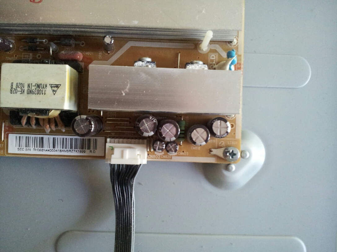

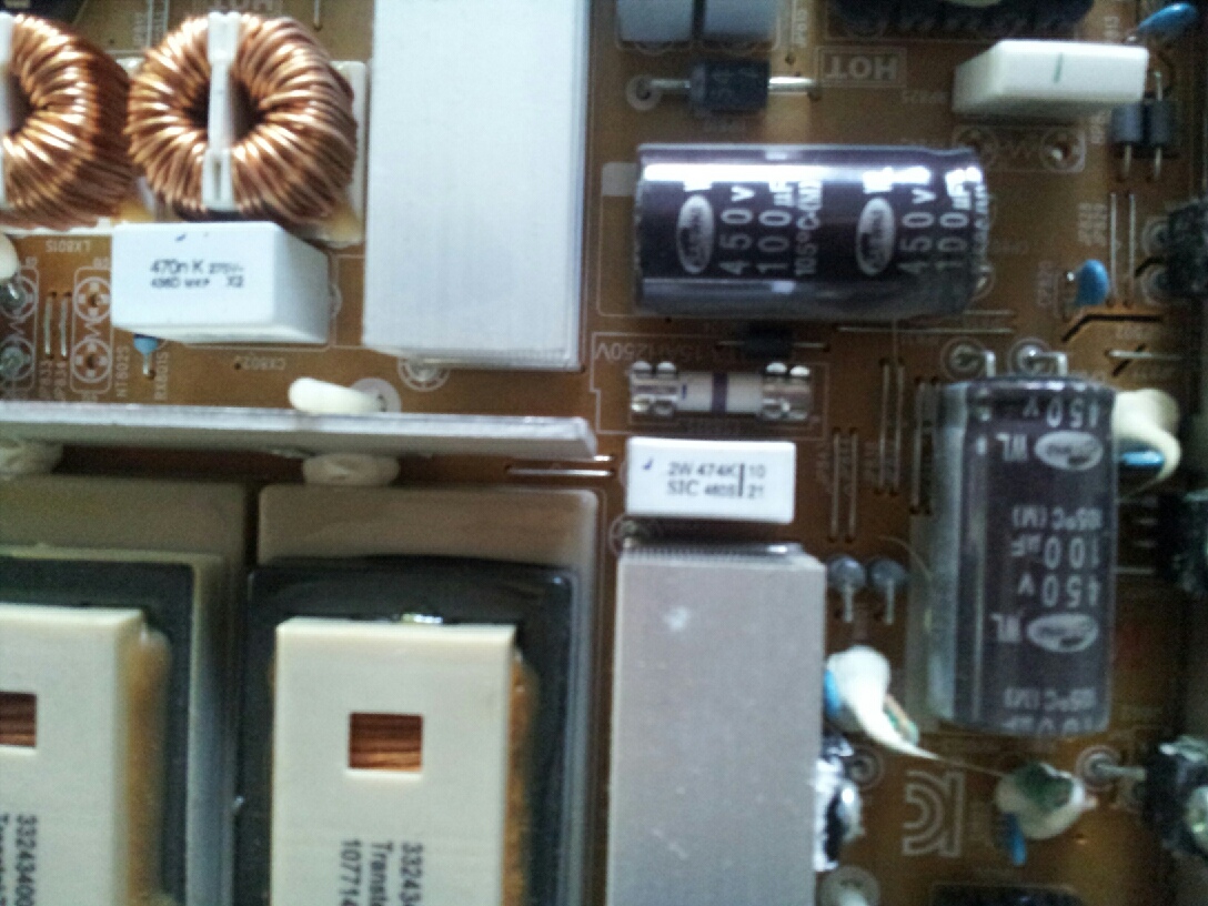

    3) Performed visual inspection of caps (LN46C600_Cap_1.jpg and LN46C600_Cap_1.jpg). None appear to have any dimpling, raised tops or were "leaking" any goo/material.

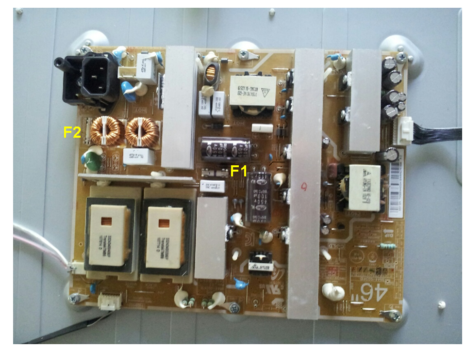

    4) Used my DMM to test fuses (F1 and F2 in LN46C600_PSU.png) -- both were good. As a sanity check, I keep a blown fuse in my kit as a control (I don't do this that often).

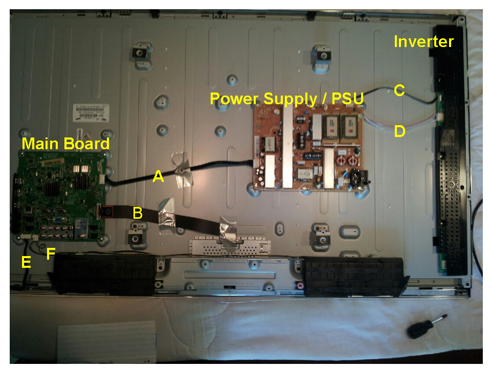

    Backlight Test: Here's where I got a little confused. There's this nugget in thread "Samsung LN46C600 audio but no pic"
    https://www.badcaps.net/forum/showth...light=LN46C600
    "You can also remove the cable between the main board and the power supply/inverter board and then power up the TV, the backlights should come on right away (the power supply board has built-in pull-up resistors)."
    I am not a schematic guy, so while I tried to follow it (thanks for the link by the way), I thought I would ask for clarification, In my uploaded image LN46C600_Main.png, is the cable referred to the one marked A in my diagram? Or is one of the others?
    Once I perform this backlight verification test and assuming I get backlight on power up, does this indicate a problem with the CI818 capacitor mentioned in other posts?

    That white connector with black wires going back to the main board, if this power supply board has pull-up resistors then when you remove that connector and power up the TV you should then see the backlights come on right away. If not, then check that white cap by the fuse is the common failure part.

      The PSU # for my Samsung LN46C600 is BN44-00341B.
      Thanks for the clarification -- when I disconnect the black wire with white connector between the Main Board and PSU the TV doesn't appear to come on, either via front pressure switch or remote. So no backlights either. I think I will go with God and use a bleed resistor to de-energize the two big CAPS and remove the PSU board. I don't have a Cap Meter, so I guess I will get one of those and fish out my soldering set to remove and test that cap.

        It does have pull-up resistors, so you need to check the PFC Voltage booster as shown in that thread, leave out that cable to the main board, the switch on the TV will not have any affect in this setup.

            Replace C1818 .47/400v ( original is white box type cap usually has bulged sides )
