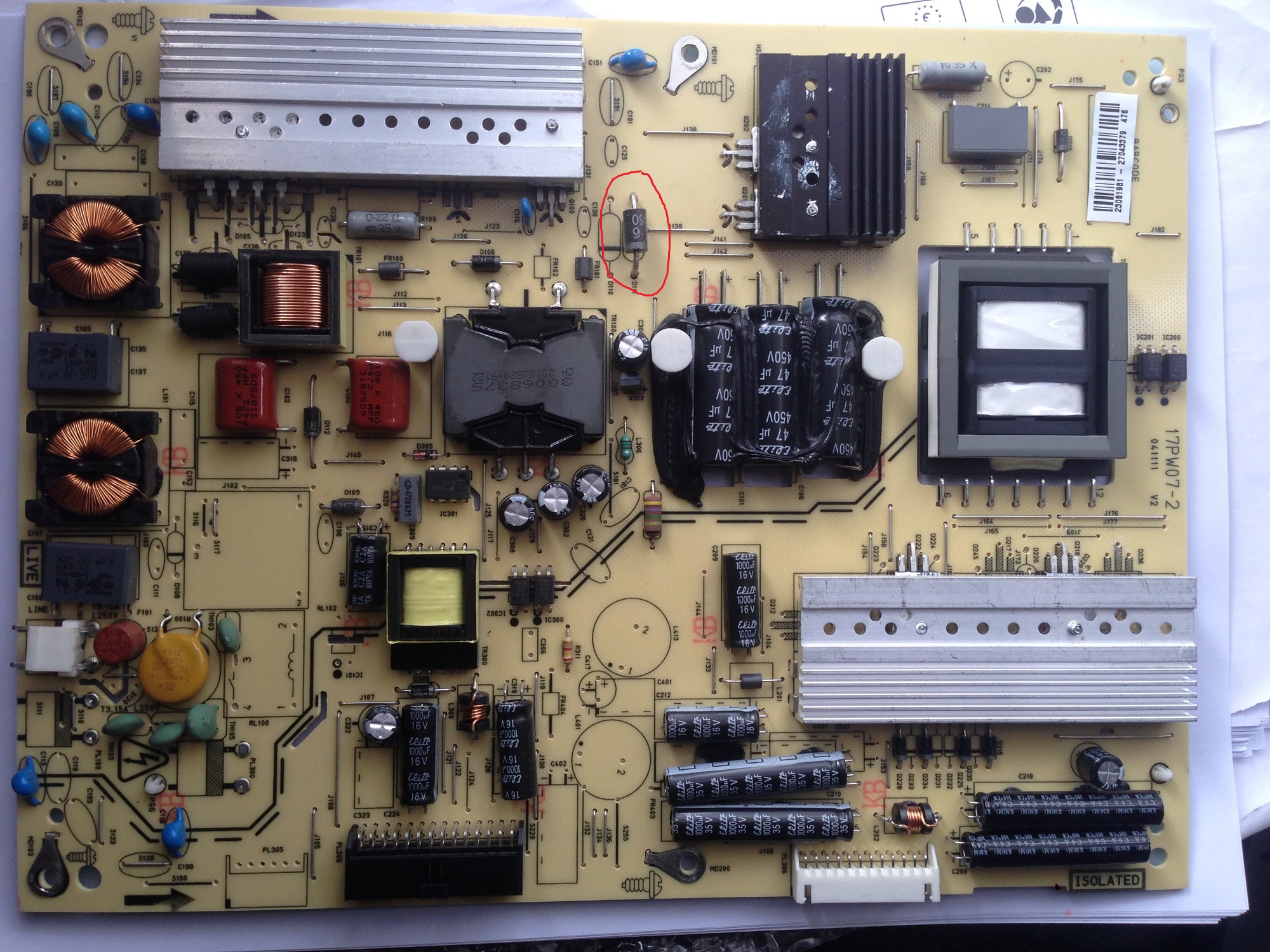

    Toshiba 40L1333b Bad psu
    As title Psu is bad
    Swapped with known good psu
    set fires up
    Diode circled is shorted.
    Mur460
    Re: Toshiba 40L1333b Bad psu
    Makes a change from the norm of bad LEDs. Was mains fuse OK?
    • zomi
      • Nov 2011
      • 511
      Yes everything else tests ok
      Just going to swap the diode and will update when done.
      Set was totally dead no lights or nothing..
        That is the typical MUR series PFC diode that failed as shorts, if you search badcaps' site with 'MUR *' you will see that happens a lot on SAMSUNG P.S., you will not get PFC boosted Voltage when it failed.
          Replace like for like
          Or is there a better alternative
            Certain batches of bad diodes with this fault. Replacing like for like should be OK.
              may be the brand or the series that they were using are bad.
              600V seems to be too low for me, it should be 1000V.
