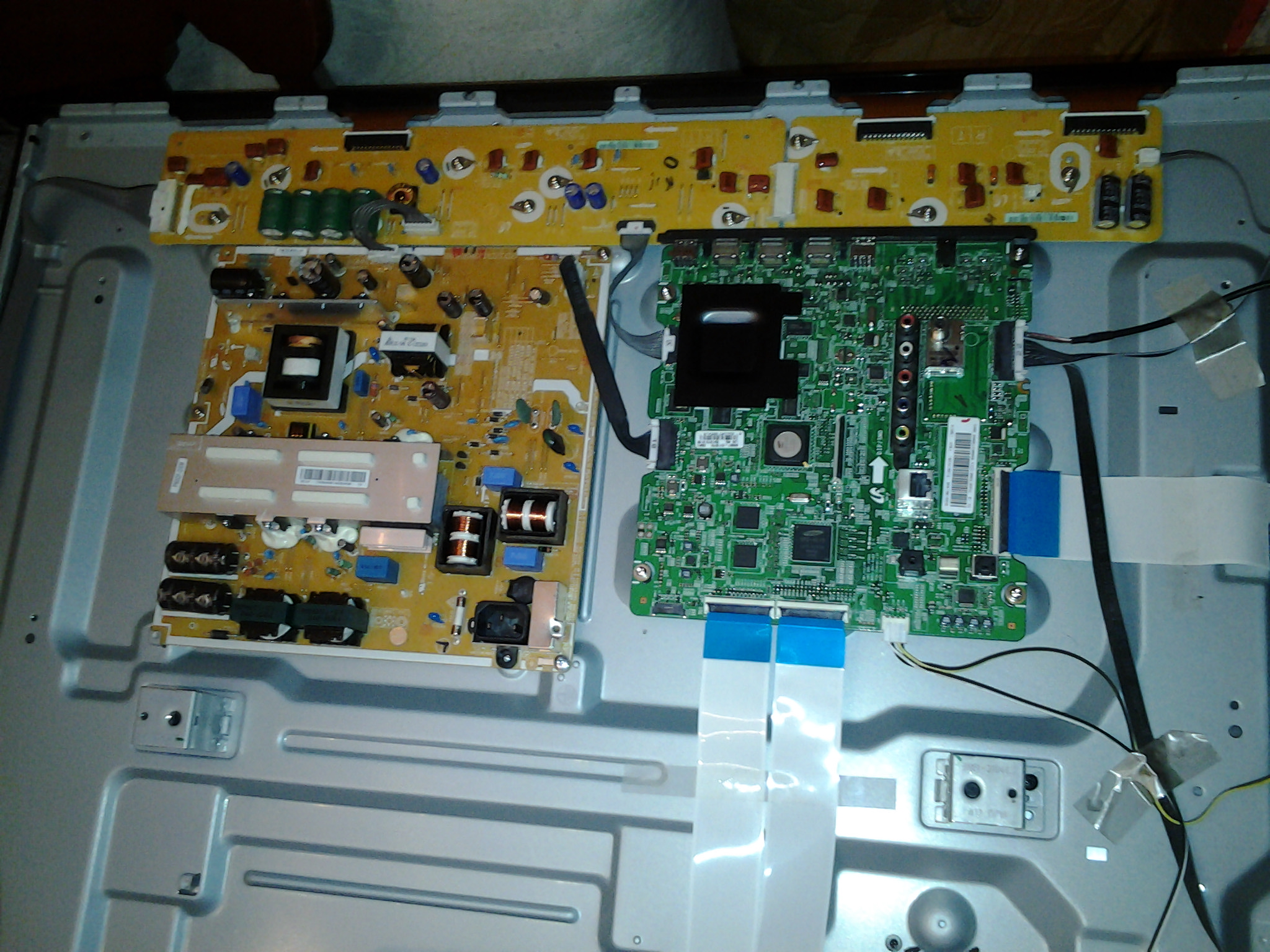

    I am working on a Samsung PN60F5500 with now power. No front panel LED and no response from the remote. The PS PN: BN44-00601A did show standby voltage. We anticipated the main board PN: BN94-06194B was defective.
    I ordered both the main board & power supply just to be safe .With the boards installed I do have the standby LED on the front panel now as well as the green LED marked LED2000_L0 on the main board that blinks intermittently.
    There is however NO screen illumination. I unfortunately do not have a service manual at this time. My concerns are that Samsung often has different revisions of panel and main board and the main I ordered may not match my panel? Alternately the Y-sustain PN: LJ92-01958A could also be defective.
    Service manual anyone ? Ideas ?

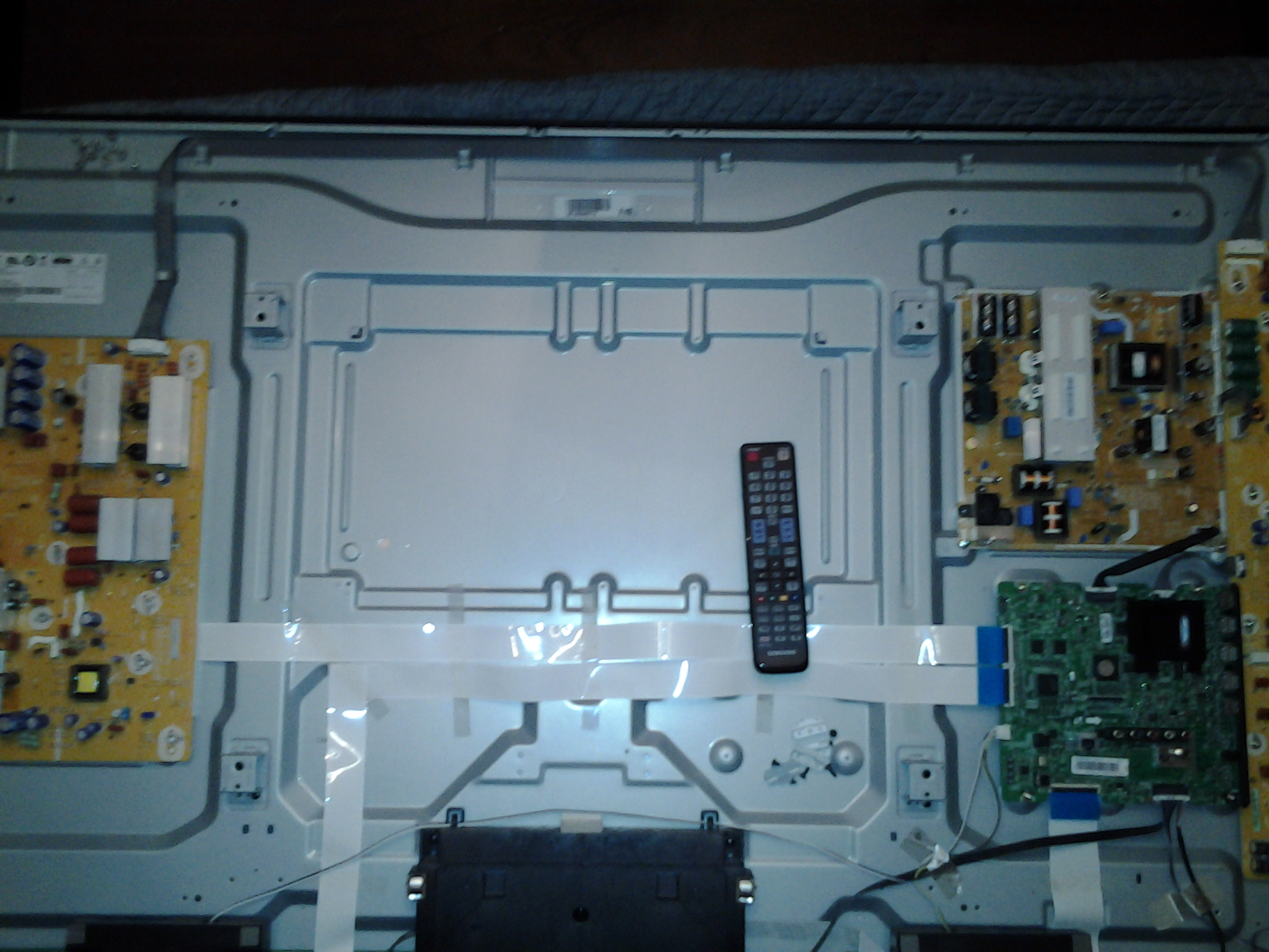

      Re: Samsung PN60F5500
      Pics of layout of boards please

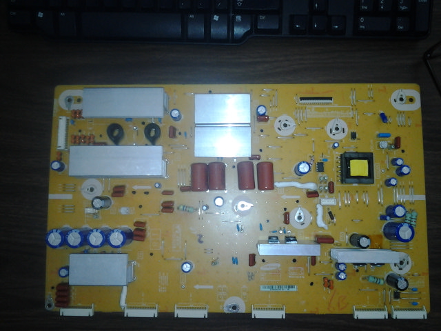

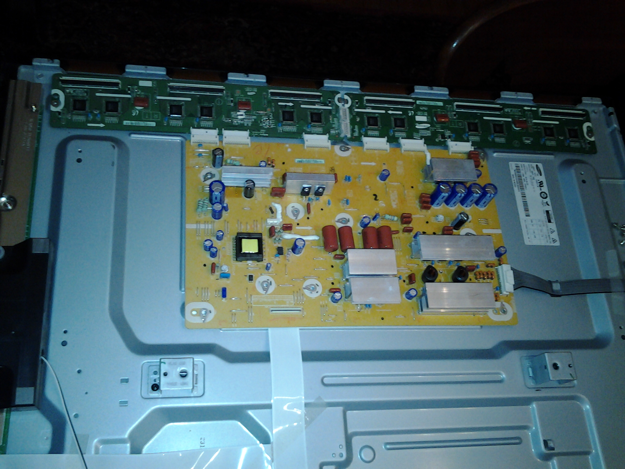

        At power on the ALL test voltages go up then drop back down.
        VS - 208 then drops down
        Va - 57 then drops
        Ve - 8-10 it never really comes up

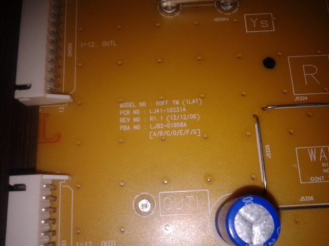

        Y- board and buffers are out in the picture to look for any shorts or defective components on front and back side of boards
          Does Vsc rise? It sounds like Ve is shorted.

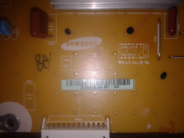

            The Y-sustain was bad. Replaced it and the set came up.
            My tunnel vision was from listening to the alleged history on the set. They claimed it was working A OK until it was moved and the mover damaged it...... Not physical screen damage but internal ??
            The main board and Y-Sustain were both defective. Seems hard to rationalize that those died in a move. I had the bezel removed and was searching for a hair line crack near the edges . I suspect that they hoodwinked the insurance for the movers.

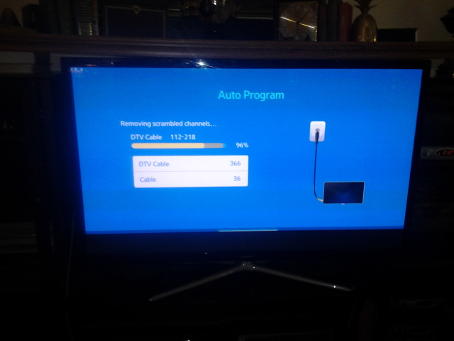

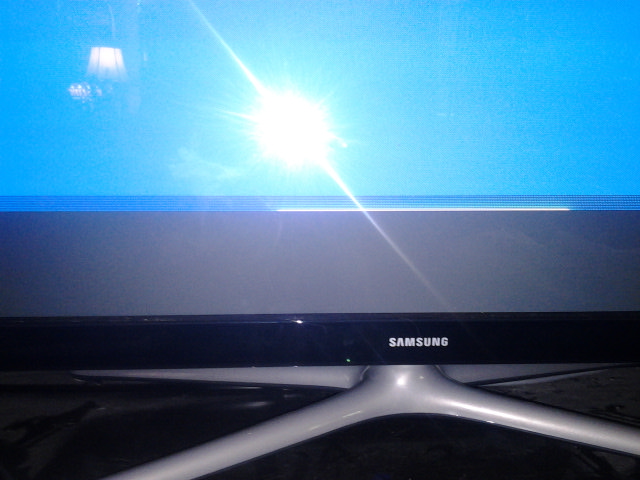

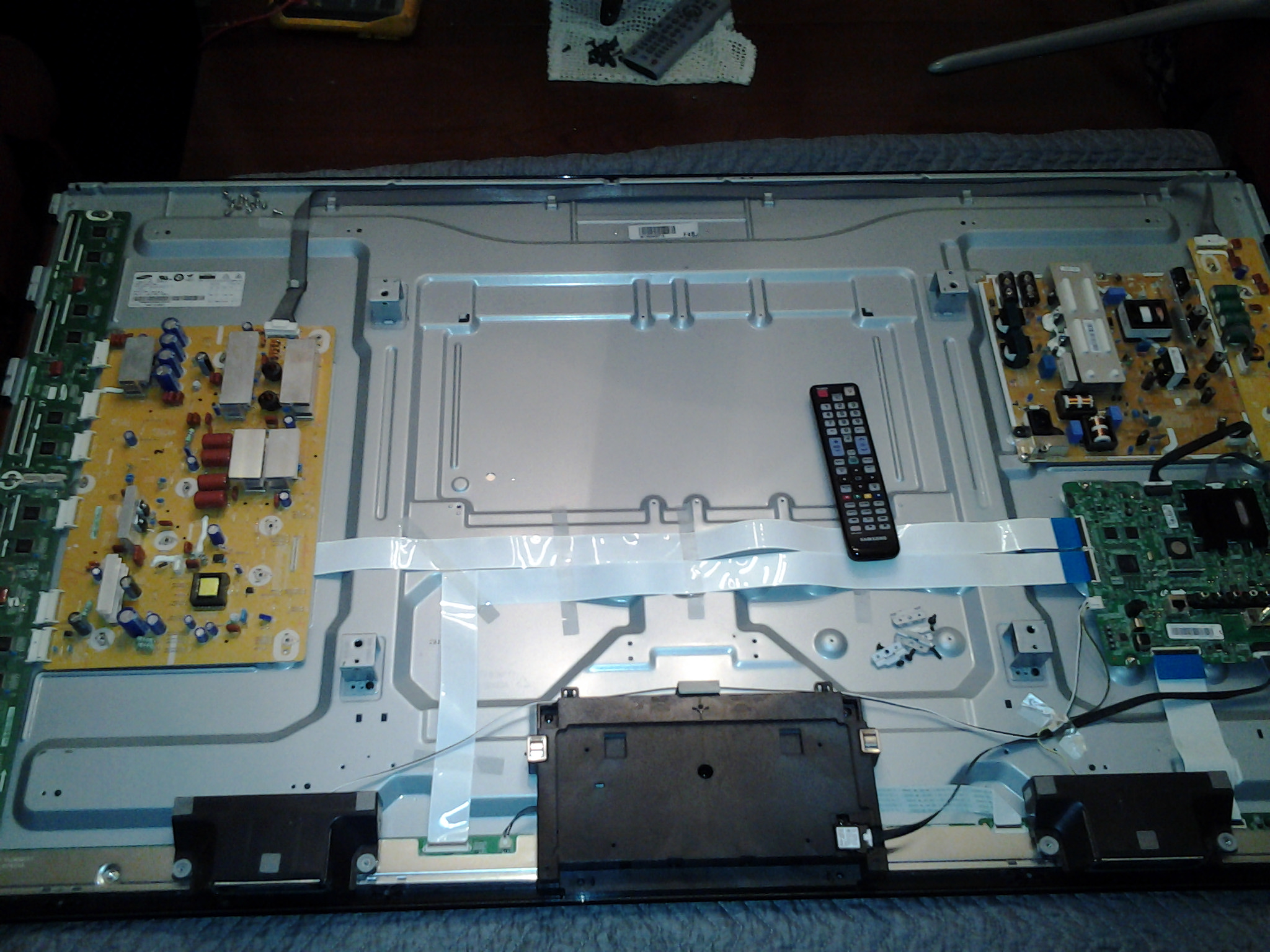

              Talking to myself here Set is up and working but the bottom of the screen has 3" of what looks like overscan. Anyone remember CRT bad caps in vertical section ? Lines spread out and video wrapped around ? Well that's it. It was 3" when it first came on then I ran a FIRMWARE upgrade. NO Change
              So I went to service menu and did a factory RESET . Well that is when 1" of overscan and missing video at the bottom turned in to 3" ???
              Well .... I have never seen this on a plasma. Analog CRT yes Plasma nooooo but ..... The parts distributor is actually saying they think it is a defective Y-sustain and want to give a refund however I just am having a hard time wraping my head around that when the factory software RESET changed the problem from 1" of distorted video to 3" . Works great otherwise but 3" missing on a 60" diagonal screen is a lot

                do you think it'd be worthwhile isolating the main and using the built in test pattern gen on the logic board?
                I think a photo would be in order too, please
                did you take note of the settings in the service menu before reset?
                definitely correct main for this size or what model is set in the serv menu?

                  If I understand what you are suggesting I think I have tried that. The built in Pat Gen from Service menu is the same. The Bottom is missing.
                  Here are the pictures of both board layout and the screen now with the missing bottom portion. Picture 3 is the best example. I just uploaded all of them. This was a batch for the parts distributor to look at. They jumped and said they thought they had sent me a dud Y-sustain. I am not convinced of that at all
                  And NO I did not take a B/U of menu settings. I did not change anything I just did a Factory Reset which I asssssssuuuuummmmmmeeedddd was OK well......... NOT LOL There are hundreds of sub values in there and I assumed a reset would IMPROVE things . Hmmmmm Wrong :-( Lol

                    well, i'm not so sure if the tests in the main are the same as the logic. I was thinking if a change occurred after the reset then maybe take the main out of the equation, jumper the logic, remove the power connector from the main and earth the Pon to force tv on. This is from what I've read ,
                    • tw2005
                      • Oct 2011
                      • 6458
                      looking at that image, especially with those lines, looks sus. bad buffer, damaged ribbons , mis-seated ribbons, bad ymain, cracked solders at the ymain/buffer connector.
                      Not sure and not overly familiar with samsung either.
                      You could go into the serv menu and see though what tv model this has been set too.
                      may purely be coincidental the change after the reset but the main board maybe be multimodel just needs to be setup??
                      I'd still try logic bd test first
