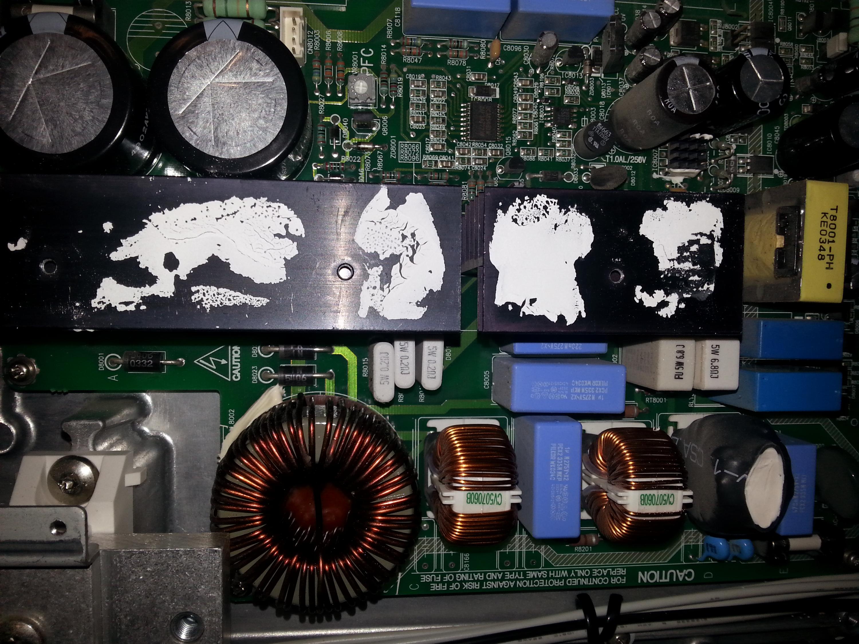

    Initially I was suspicious of the large filter capacitors on the power board so I have replaced 3 x 1000uf 160v and 2 x 330uf 450v caps which did seem to bring about some improvement. I subsequently replaced about 10 lower voltage 1000uf and 470uf caps with no further improvement in the situation.

    There are some small SMD ceramics at the top left of the board near that large coil that fail and can cause this symptom.

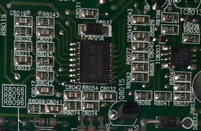

      Thanks Tom,
      I'll have a look soon. How tricky are SMD components to remove? I've done plenty of Through Hole stuff but managed to avoid SMD so far.
      Rob
      PS: Had a look at the area and attached a pic. I assume you are referring to the grouping of components above the heat sinks and to the right of the large cap? The component numbers on the schematic are different to those on the PBA.
      Rob.

        As you can see in the attached pic, the components are all designated C8xxx, R8xxx or IC8xxx whereas the ones in the diagrams you kindly provided are all C2xxx etc.
        Before I make matters worse by ripping off the wrong components, is it possible to confirm the identities of the 4 suspects, please?
        Rob.

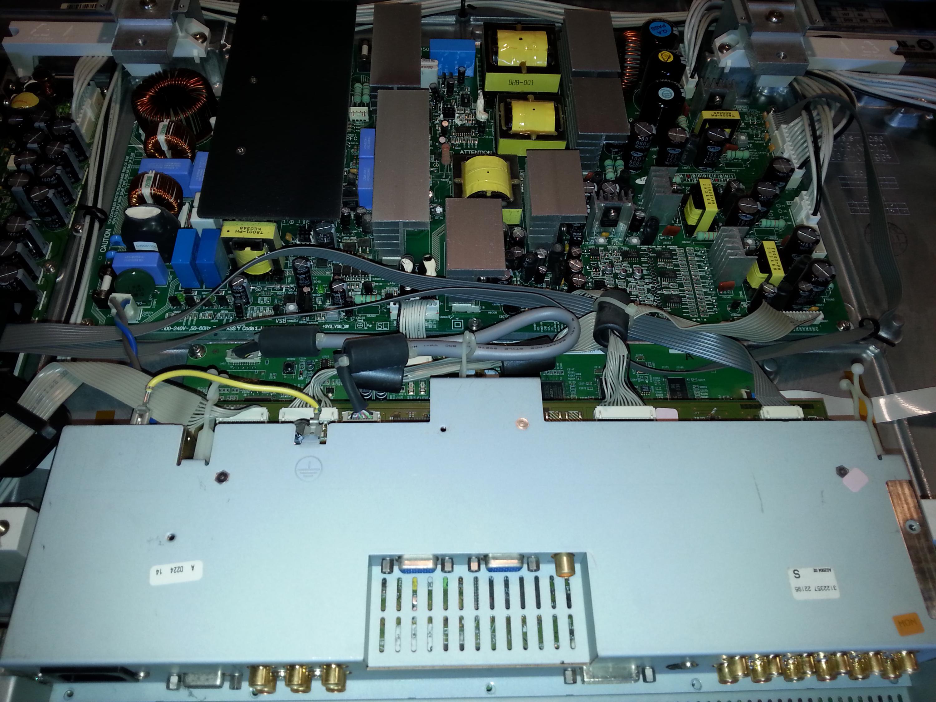

          As I have had no success searching under the Philips model number, and all the internal components are labelled Samsung, I searched under the part number which is screen printed on the SMPS board (S42SD-YD06).
          This number turned out to be used by Philips, Sony and Samsung in various models, and there is a Repair Manual on line with quite a lot of detail, but unfortunately no circuit diagrams (although there are several block diagrams and fault finding flow charts).
          The Power Supply check suggests removing the connectors to each Sustain Board in turn, to isolate which one may be the culprit. With the Y Sustain board disconnected, the fault remained, so I disconnected the X-Sustain board and the fault disappeared. So to be sure, I reconnected the X- Sustain board, and the fault (LEDs 8001 and 8002 off, LED 8003 on, LED 8004 on) has not occurred since.

            More testing has got to the point where the fault is in evidence with the X and Y boards, as well as the Buffer, unplugged from the SMPS.
            This strongly suggests the SMPS (S42SD-YD06) is faulty.

              Well it took a while and some patience, but the culprit turned out to be a faulty SMD 22uf, 16v electro on the Alarm board which is attached to the SMPS.
              Seems the Alarm board wasn't giving all the individual voltages time to appear before inserting the crowbar.
