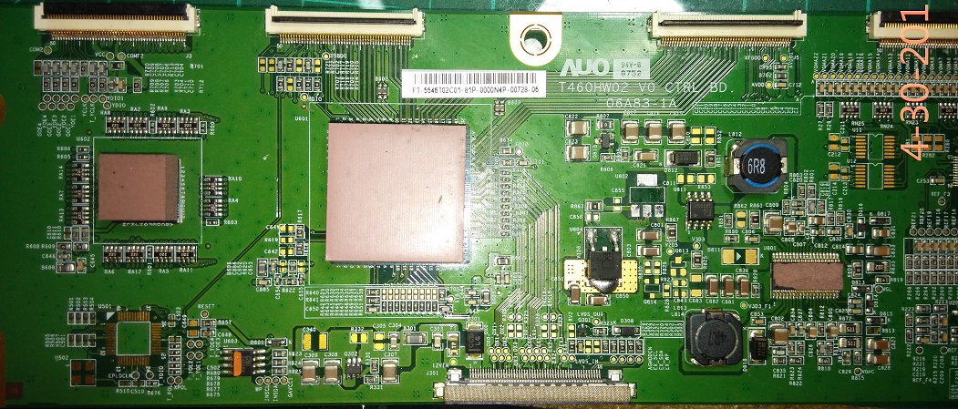

    Hello I need your help to identify a component (the broken one on the image above) on the tcon of the LE46A556P1F.
    The model is auo t460hw02 v0 ctrl bd. I can't find even the schematic of this samsung tv .

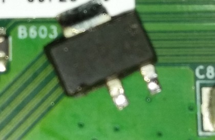

    How are we supposed to say... we cannot see ANY part number on that first pic?
    Looks like a regulator of some kind... or maybe a transistor... it's in SOT223 package...

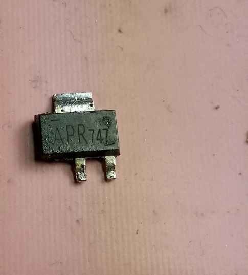

      Here is a photo

        AME8815AEGT250
        AME APRXX 2.5V page 5
        http://www.maoye-smd.com/canshu/pdf/...-9/AME8815.pdf
          Re: Samsung LE46A556P1F tcon problem
          Duncanbest, man! you are really good at finding the parts spec, thanks!
