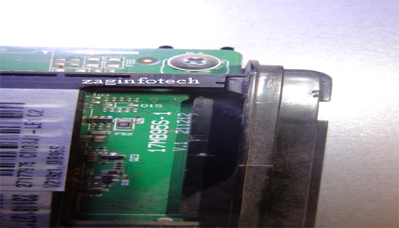

          i need firmware for Toshiba 24W3753DG TV - sn. 7983539 800280
          Board: 17MB110P-pn 23451047
          LCD: VES236WNTC-2D-N01
          The TV only flashes red and green. Do you have recovery software for the specified TV? If possible, the installation procedure.
          Please help...

            Re: Toshiba 40L1333B blinking red/green power indicator
            try this topic
            toshiba 24w1333g firmware Dump + Nand flash
            https://www.zaginfotech.click/2022/0...dump-nand.html
