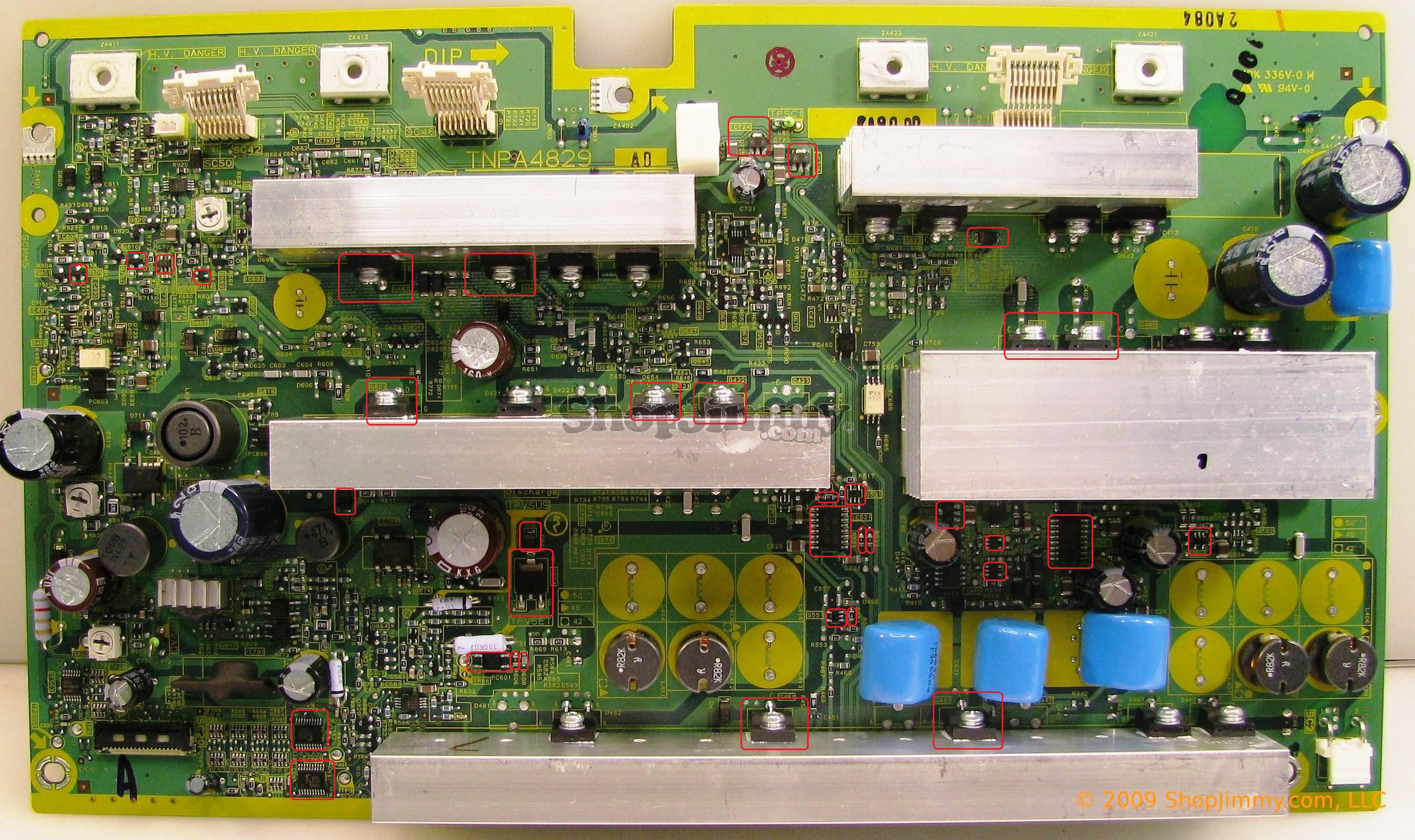

    No, but like most Panasonic plasmas the SC quits sooner or later. Must be very early 2010, really it should be part of the 2009 model line up.
    what are you like at component level repair? Repaired any SC boards?
    not sure how easy these boards are to get or could be pricey.
    basic first step is to do the SD/SU boards bypass.
    basically remove the 4 Vfg bolts from the SD/SU, disconnect the 3 connectors from sc to buffers.
    short the 2 pins on the sc at SC50, power on and see if it stays on.
    alternatively, check SC2 for short cct or a visual may find FET driver ic burnt or SMD diodes burnt
    or
    remove the SC and start checking the IGBTs for short cct
    Start with Q661,660, 601. if nothing then continue with the rest

              Sometimes I think if the SC is suspect, checking for shorted parts is a safer option just in case continually powering the Sc up does more damage. I notice on the 4782 boards there's a diode that shorts and burns long enough to burn the board and track out.

                    generally of the same generation so 2009 boards but I used 2010 model parts and got mine running
                    • tw2005
                      • Oct 2011
                      • 6458
                      Re: Panasonic TX-P42U10E 7 Blinks
                      I have not checked all parts like the large IGBTs which you can clearly see but the small stuff will be correct.
                      R606 10KOHM 0.25W
                      R696 2.2ohm 5W
                      Q661 RJP6065
                      D618 RF101L4S
                      D619 RF101L4S
                      D865 RF101L4S
                      Q441 45G127
                      Q451 45G127
                      D608 MAZ81200ML (12V 150mW) SSMINI2
                      Q401 2PG011
                      Q402 2PG011
                      Q403 2PG011
                      Q501 CPH5524
                      Q502 CPH5524
                      Q521 CPH5524
                      Q522 CPH5524
                      Q421 30G123
                      Q422 30G123
                      Q423 30G123
                      Q601 RJK6026
                      Q660 RJK6026
                      Q701 MMBTA92
                      Q702 2PD601ART
                      Q818 2SK3018
                      IC724 TC7SH14F
                      IC725 TC7SH14F
                      IC771 TC7SH14F
                      IC501 M81707FP
                      IC521 M81707FP
                      PC461 PS9817A-2
                      PC601 PS2701A-1
                      R506 10 OHM 0.25w , ERJT06J100V
                      R507 10 OHM 0.25w , ERJT06J100V
                      R551 10 OHM 0.25w , ERJT06J100V
                      IC464 TC7SH14F
                      IC465 TC7SH14F
                      IC773 TC7SH14F
                      depending on how much surrounding damage is at ic521, these can get taken out whenthat driver shorts out
                      ic561,562 tc74vhct541a

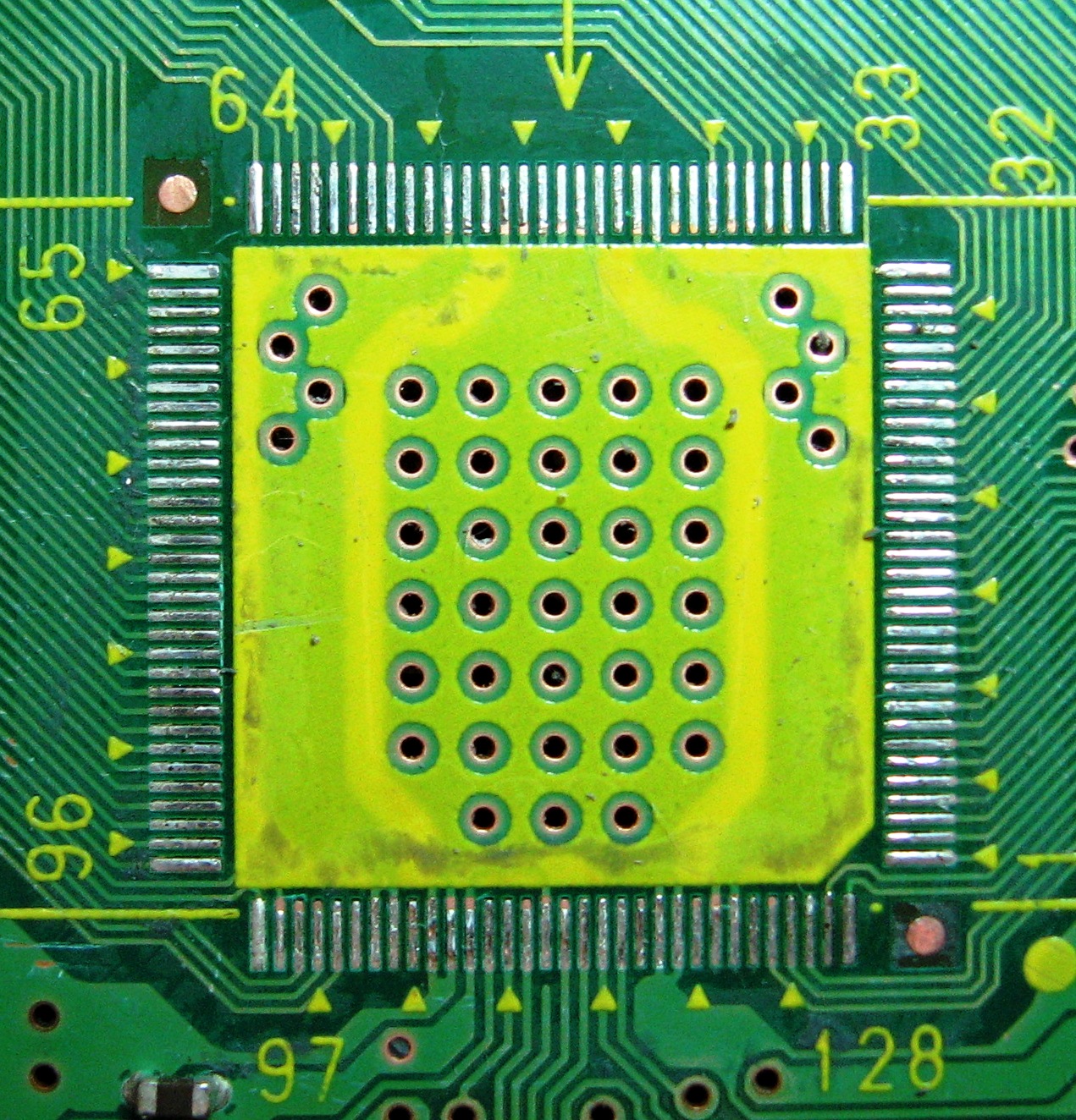

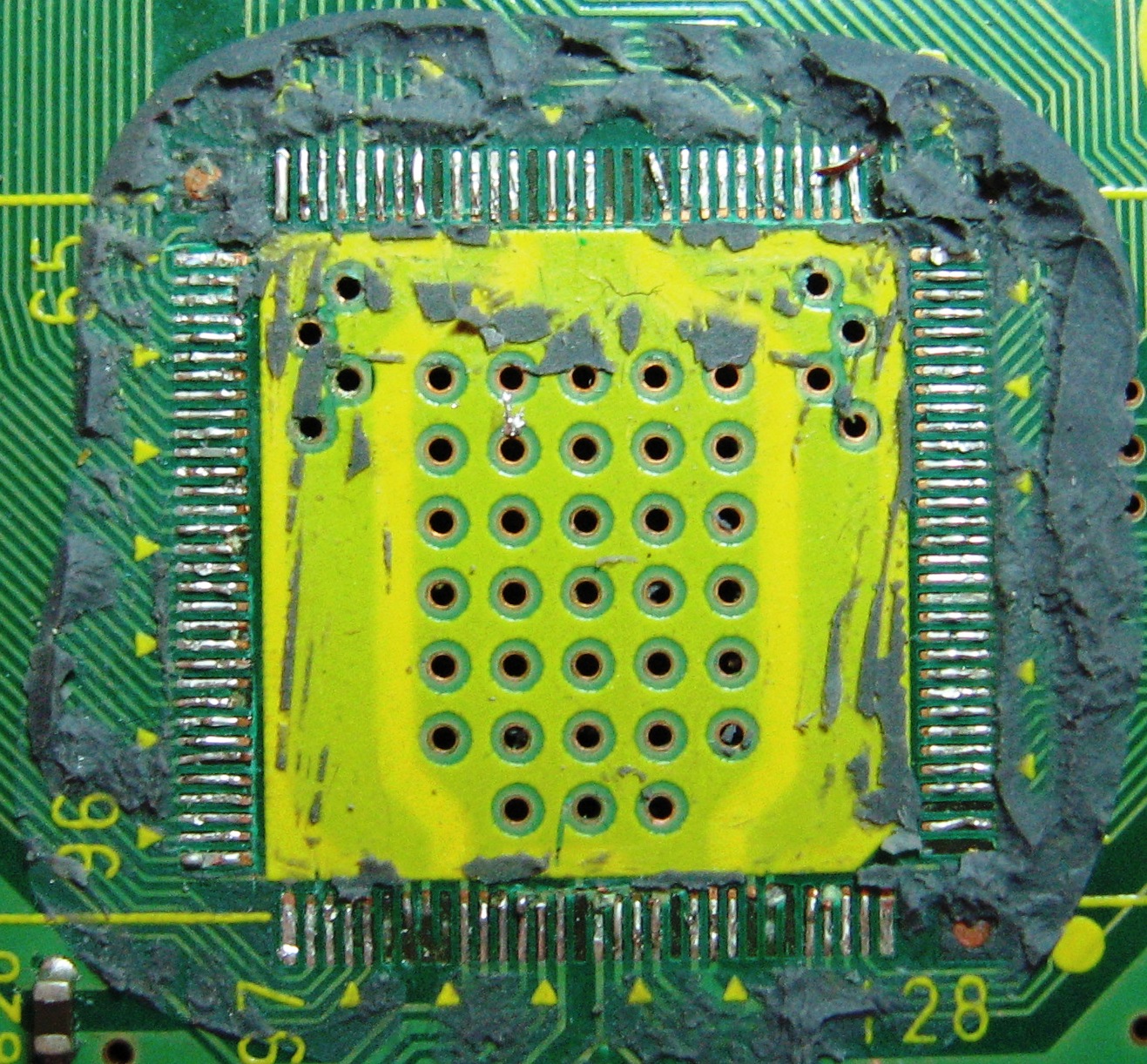

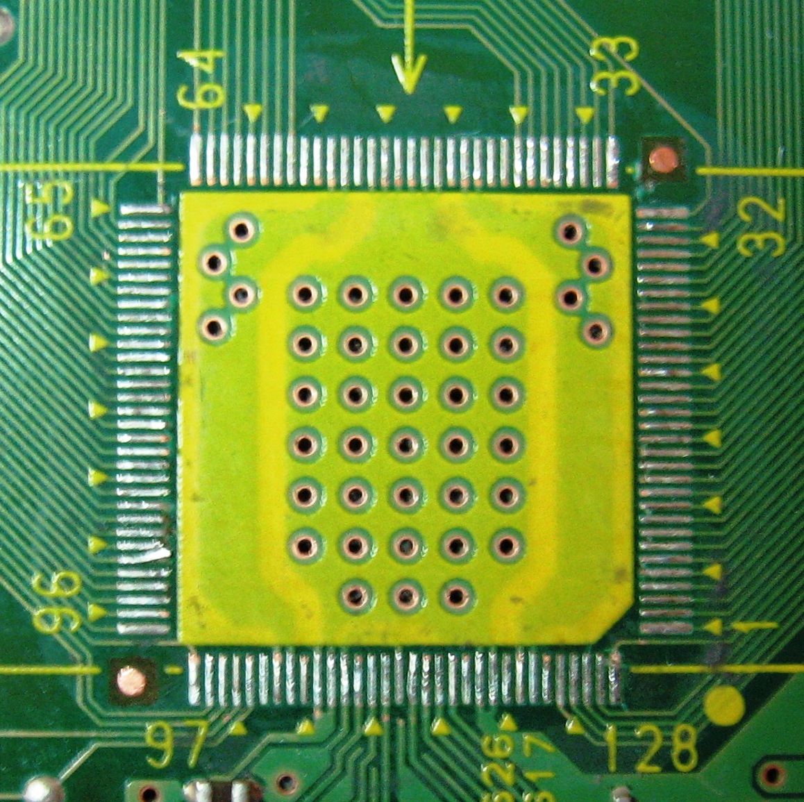

                                    Get the board, keep the dead one for another day. I've been praticing on a damaged 5090 board, just getting good at it. I use generous mounts of acetone and pick away at the silicone. get a a sharp fine blade and cut the legs against the casing, don't go too deep there's tracks below. then more acetone and grab the ic twisting back and forth.
                                    should just pop off. then get the rest of that goo off , using something like a toot pick to work it, carefully desolder the remaining legs.
                                    I already posted these on ricosavy thread as these buffer boards are starting to run out.
                                    The chips are not cheap maybe $4-7 each for me. adds up fast if all 6 - 8 are blown on a board and not having the correct gear or experience.
                                    1 or 2 chips I'd have a go at.

                                      Thx for the update! This looks like a AS15 chip wich i have replaced many times.
                                      I tried to turn the tv on without the ribbon cable for that defective chip but still 7 blinks.....
                                      Think that the tv only works with all chips intact...right?
                                      Question is , do i need the EXACT same chip? Or can i use a different one? Got many SU boards.

                                        The fault is on the board , not the panel so no that won't work. can you use different chips? maybe.Tom seems to think there's some interchange, maybe another chip for FHD panel and a panasonic, I don't know. Not my thing.
                                        I'd expect buffers from any 2009 FHD will have the same chip.
                                        I guess AS15 has 4 sides, but 48 pins , TQFP-48 9 x 9 mm, compared to 128 pin?
