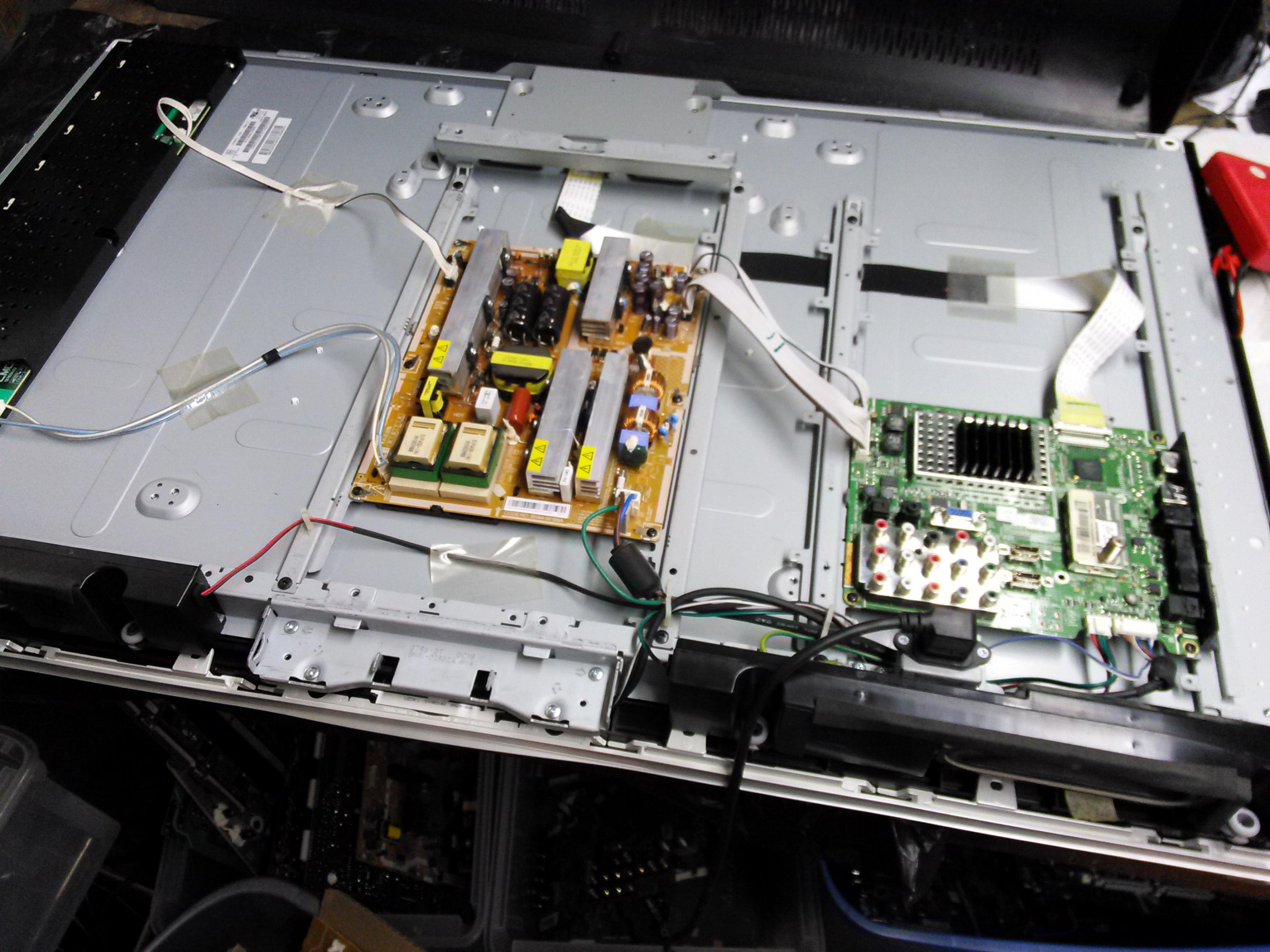

I dont even get the samsung melody, the red led just continues to flash, no pattern. Tv wont turn on. Everything seems to have all voltages, im thinkin main board fault? Im able to get voltages going to inverter, shouldnt i only get that when tv is on? But this aint powering on?
Samsung ln40a550p3f red blinks then nothing

Another one of those LNxxA550 series:
Please read post 129, 135, 136 and the links.
You can try adding the cap to the board and see what happen.
https://www.badcaps.net/forum/showth...t=25810&page=7Never stop learning

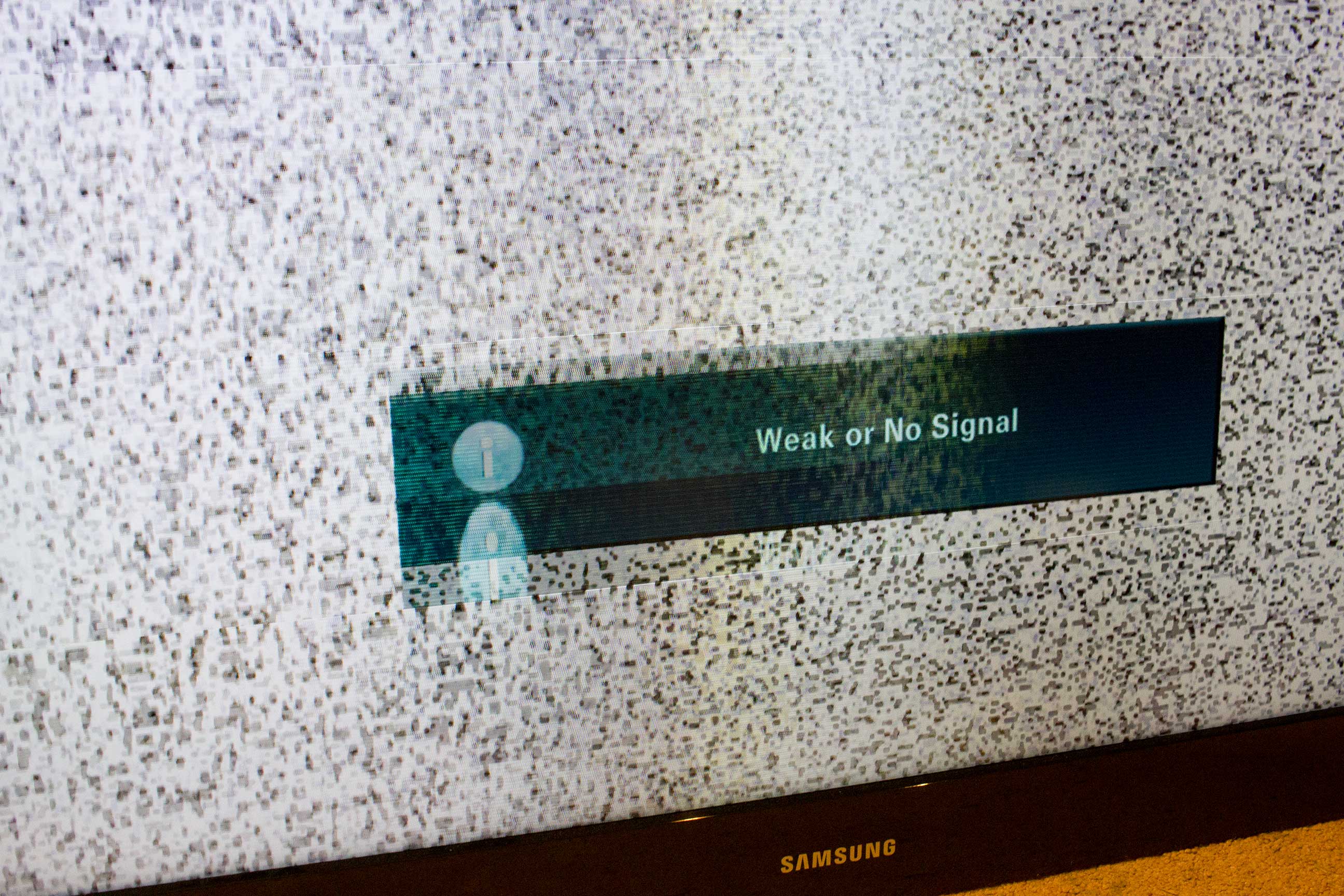

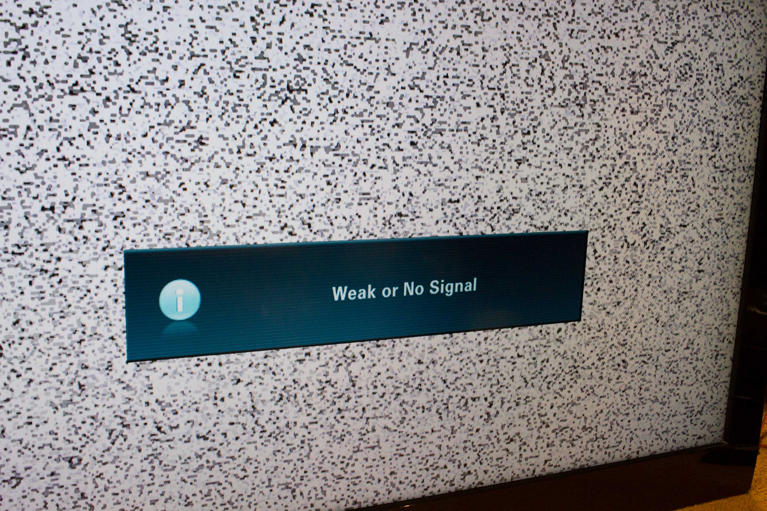

same problem, blinking red light and tv never turns on. no attempt, no sound, nothing.
i tried the cap in parallel with c102 on the main board and the tv comes on.
my question is: can i simply just leave the cap soldered parallel with the smd? currently just using some low esr electrolytic i had.
edit: might have answered my question... after less than a minute the screen messes up (like interlacing) for a few seconds then goes back to normal? would this be from that?Last edited by jasonbay13; 11-29-2016, 08:40 PM.Comment

Double check you have the capacitor fitted the correct way round.Willing to help but I'm no expert.Comment
Re: Samsung ln40a550p3f red blinks then nothing
White line on that black tantalum smd cap c102 is positive.Never stop learning

That is bad tab bonding problem, try flexing the screen to see what happen.Never stop learning

i pulledoff the bezel and lightly twisted the frame and the problem got worse, twisted it the other way and it was fine.
is there a chance to fix this? or should i assemble first and hope that it holds up while screwed together?Comment

indeed you are right. it was the far left tabbing. the part that bends down into the lcd. scary stuff, i just stuffed a bit of cut up mousepad in there behind the metal frame to keep pressure on it. hopefully it lasts long enough and doesnt act as a thermal insulator, that'd be bad probably. do they always get so hot?Comment
