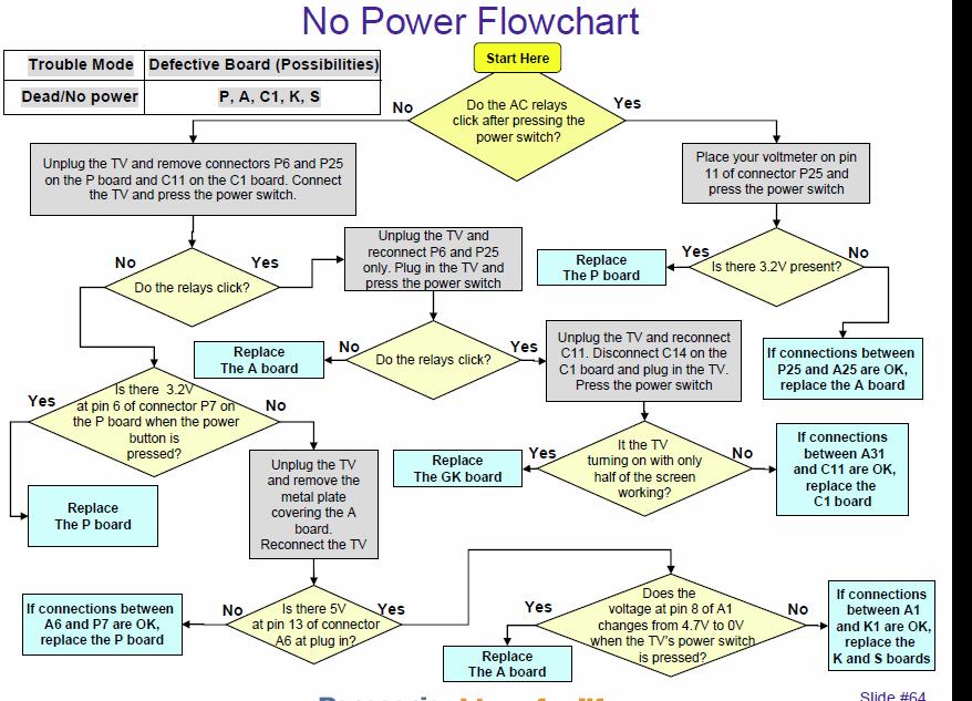

    Panasonic tx-p50s10b
    Hi all
    This set is completely dead no st/by light nothing at all.
    Checked power from power pack ok all fuses ok .
    Any one had this with this model plasma ?

    Re: Panasonic tx-p50s10b
    Pics
    • tw2005
      • Oct 2011
      • 6458
      try this chart. what do you mean checked power from power pack ok? Do relays click at plug in?
        Relays do not click at plug in.
          Remove connectors as stated in chart and try again
            Thank you all
            I will carry out some tests tomorrow and keep you posted.
