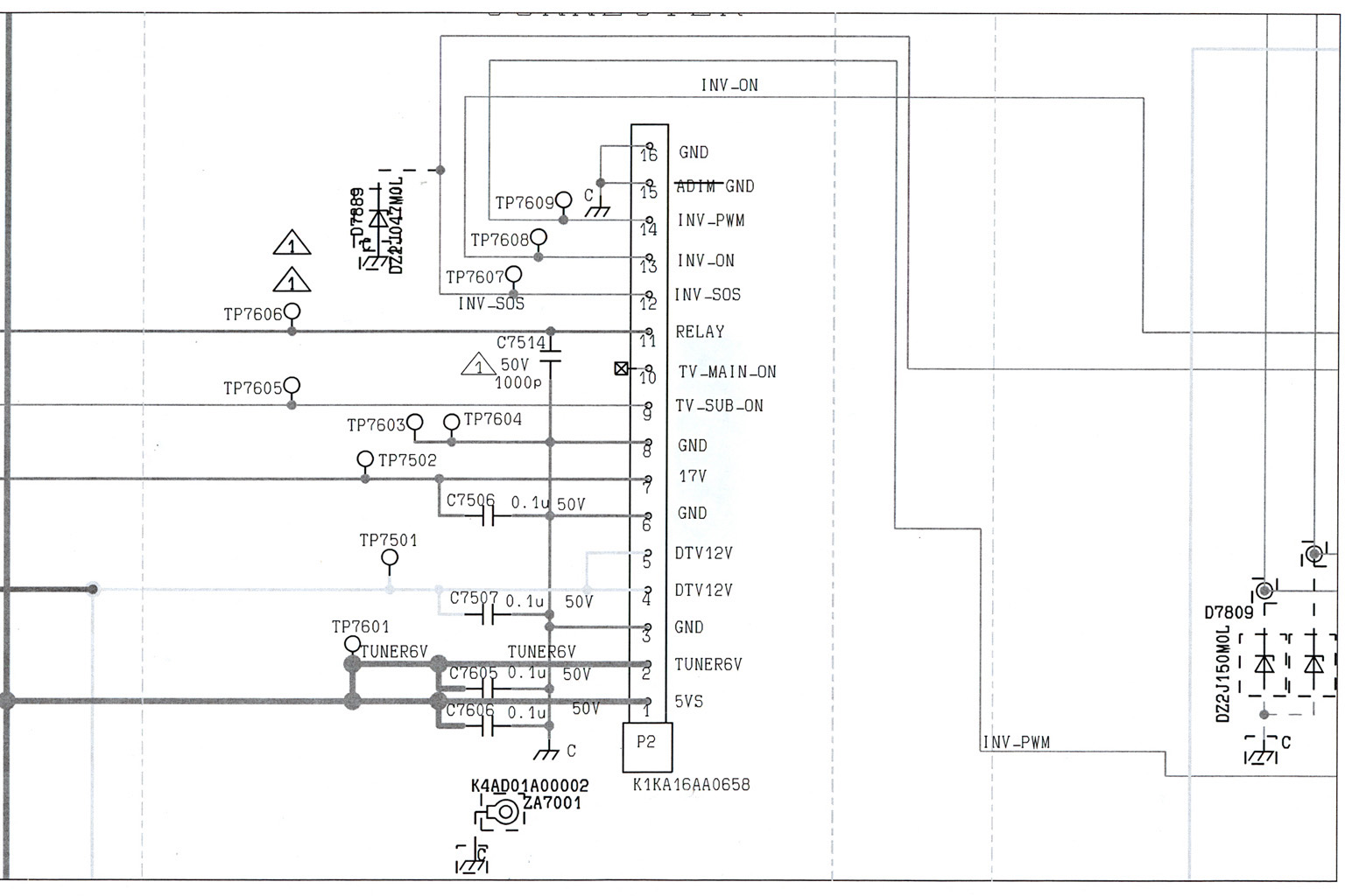

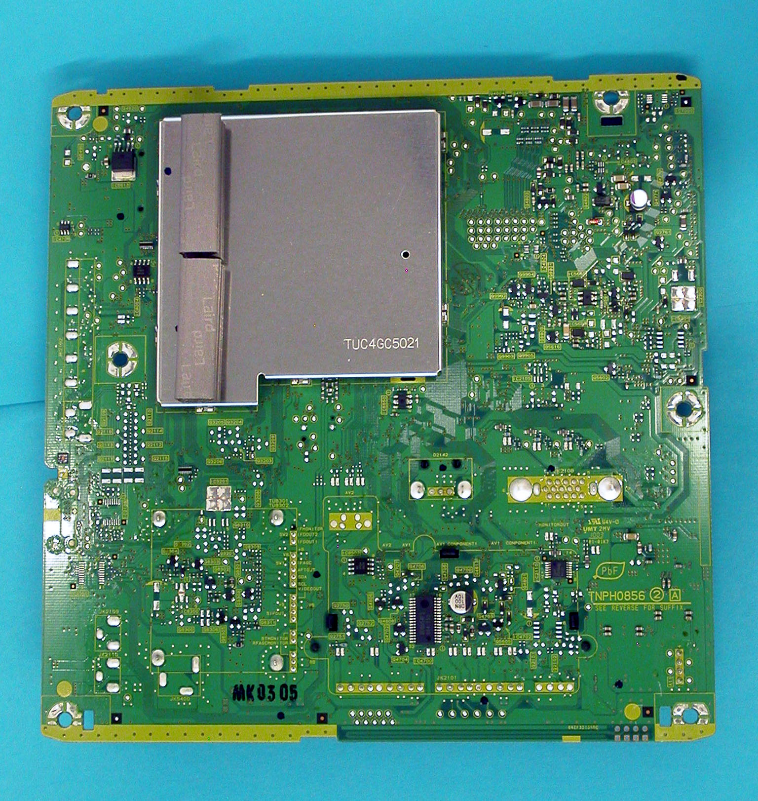

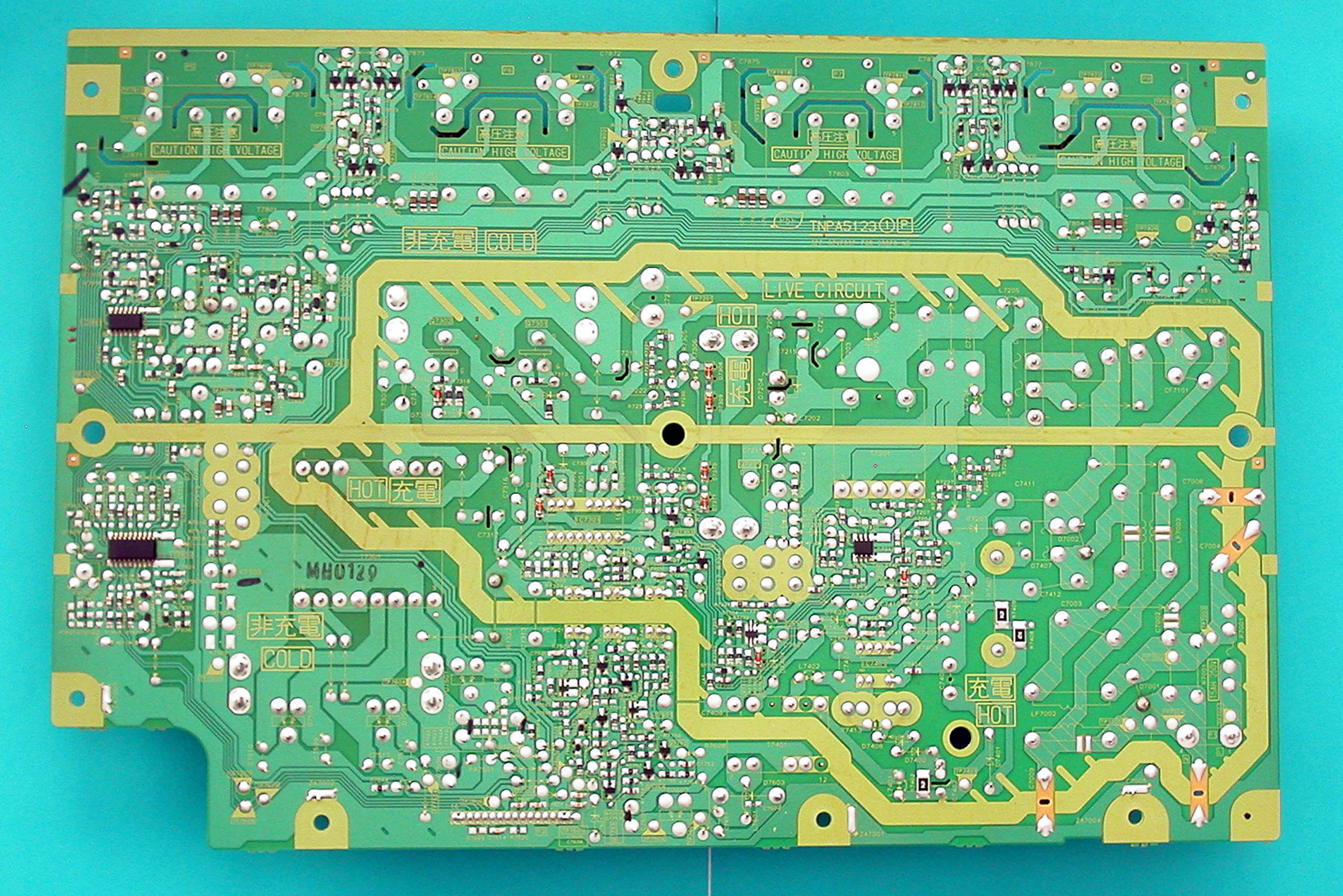

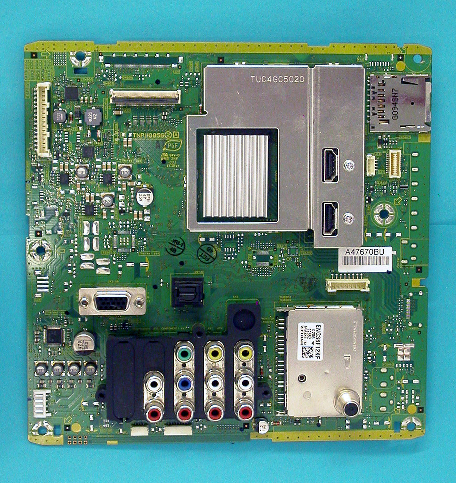

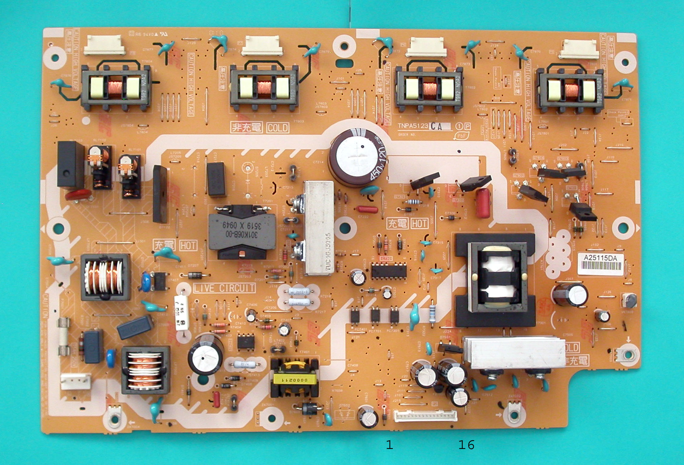

    Panasonic TC-L32C22 Blinking Red
    Initially had standby 5v but not 12v or anything else. Checked a couple of caps and found ESR of 0 - so just replaced them all. Now have the following at the power board: Pins 1&2=6v, 4&5=12v, 7=20v, 9=2.3v, 10=3.3v, 11=6v, 12=3.3v.
    Photos are power supply - input board - schematic of connection PS to input. Help - where do I go next?
