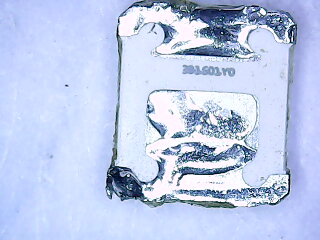

how to test lcd led backlight?
  • keeney123
    replied
    Re: how to test lcd led backlight?
    Originally posted by budm
    He can easily simulating the reading by connecting the Diode and the LED as shown or verify that with his DMM.
    That Diode is probably for reverse polarity protection since the most White LED can only handle about 5V reverse voltage, with the Diode in place, the max reverse Voltage across the LED will be only about 0.80V
    If you read this in post 73 about how he thinks it has TWO LEDs to produce Whit lights "The tester thinks have two diodes inside. And it is, first Blue diode(2.61V) and dropping with yellow diode (at 819mV) will give the almost white color.......But they put the symbol wrong side.....Don't worry, someone wrote that program not perfect, yet"
    How can the so call Yellow diode which shows on the meter as anti parallel connection will ever light up when you only apply the current flow in one direction (DC). So I have been trying to explain that it only has ONE LED!
    I see what you are saying. If it is a DC voltage it will light in one direction and block in the other direction up to 5 volts before burn out. I do not know how the inside of his tester is wired, but it would make sense to have a protection diode or LED in the reverse direction to protect the circuit being tested. The tester could be connected to reverse the polarity by utilizing a multi-vibrator or 555 timer circuit but the meter should show a reverse polarity on its readout. Of course if there is a processor and rom, etc. It could have a program that looks out on the input lines through a A to D converter to determine what it is connected to in order to take a reading. Is this a meter he is using a device he is building or something that was bought on the market?
    Leave a comment:
  • Peter Chiu
    replied
    Re: how to test lcd led backlight?
    It's a FUN project.....We gonna built a car's head lights.....and LED screen tester ...will be delayed...
    First: Ordered parts are on the way......Second: I need to study, the stuffs, I've given back to the teachers...
    I am so....so...SORRY!......I did not pay a attention to your idea ( I was at the office and Friday night and I's hungry)….....BUD M …..and, you are right, again.... .....(look picture)......look like it did has a protection diode inside........We all love Electronic......that keep me out of street, drugs, make millions for me, my job, my career, my every thing. (sound like this https://www.youtube.com/watch?v=Fcd3XuQwDQQ).......... I just try to feedback somethings to the society.........with minus salary......and As big heart as you guys doing.......so... take it easy........
    Would you Please teach me this.......No time limit just for study....I will try it, also.....It's fun...
    Question 1: What is the voltage read out ,if you change to two Schottky diodes.
    Question 2: What is the voltage read out ,if you change to two Ideal Diodes
    Question 3: What is the voltage read out ,if you change to two Zero Bias Schottky Detector Diodes, two resonant-tunneling diodes or two Tunnel diodes .
    Question 4: What is the voltage read out ,if you connected series or parallel to DC5V , AC 5V and the high (or microwave) frequence.
    Two capacitors or resisters put in series or parallel together, the values , I still make mistakes …. all the time........I'm not straight A student like most Asia's student do....I was a party boy....I's in a Band (called {120DB} U know what that means)........and I graduated by use cheating note …................. have fun.......
    Never stop learning studied:
    The Schottky diode
    (named after German physicist*Walter H. Schottky); also known as hot carrier diode is a semiconductor diode*with a low forward voltage drop and a very fast switching action. The cat's-whisker detectors used in the early days of wireless and metal rectifiers used in early power applications can be considered primitive Schottky diodes.
    When forward current flows through a solid state diode there is a small voltage drop across its terminals. A silicon diode has a typical voltage drop of 0.6 to 0.7 volts, while a Schottky diode has a voltage drop of 0.15 to 0.45 volts. This lower voltage drop can be used to give higher switching speeds and better system efficiency.
    A tunnel diode or Esaki diode is a type of semiconductor that is capable of very fast operation, well into the microwave frequency region, made possible by the use of the quantum mechanical effect called tunneling.
    The Tunnel diodes
    were first manufactured by*Sony*in 1957[2]*followed by*General Electric*and other companies from about 1960, and are still made in low volume today.[3]*Tunnel diodes are usually made from*germanium, but can also be made from*gallium arsenide*and*silicon*materials. They are used infrequency converters*and*detectors.[4]*They have*negative differential resistance*in part of their operating range, and therefore are also used asoscillators,*amplifiers, and in*switching circuits*using*hysteresis.
    A*resonant-tunneling diode*(RTD)
    is a*diode*with a resonant-tunneling structure in which electrons can tunnel through some*resonant*states at certain energy levels. The*current–voltage characteristic*often exhibits*negative differential resistance*regions.
    All types of*tunneling diodes*make use of*quantum mechanical tunneling. Characteristic to the current–voltage relationship of a tunneling diode is the presence of one or more negative differential resistance regions, which enables many unique applications. Tunneling diodes can be very compact and are also capable of ultra-high-speed operation because the quantum tunneling effect through the very thin layers is a very fast process. One area of active research is directed toward building*oscillators*and switching devices that can operate at*terahertz*frequencies.[1]
    CNTFETs
    show different characteristics compared to*MOSFETs*in their performances. In a planar gate structure, the p-CNTFET produces ~1500 A/m of the on-current per unit width at a gate overdrive of 0.6 V while p-MOSFET produces ~500 A/m at the same gate voltage.[23]*This on-current advantage comes from the high gate capacitance and improved channel transport. Since an effective gate capacitance per unit width of CNTFET is about double that of p-MOSFET, the compatibility with high- k gate dielectrics becomes a definite advantage for CNTFETs.[21]*About twice higher carrier velocity of CNTFETs than MOSFETs comes from the increased mobility and the band structure. CNTFETs, in addition, have about four times higher transconductance.[citation needed]
    Metal–oxide–semiconductor structure
    The traditional metal–oxide–semiconductor (MOS) structure is obtained by growing a layer of*silicon dioxide*(SiO2) on top of a silicon substrate and depositing a layer of metal or*polycrystalline silicon*(the latter is commonly used). As the silicon dioxide is a*dielectric*material, its structure is equivalent to a planar*capacitor, with one of the electrodes replaced by a semiconductor.
    Zero Bias Schottky Detector Diodes
    file:///home/a/Desktop/badcaps%20pic/41115/AV02-1377EN%252C0.pdf
    kinda late. I not supposed to come to office today. But company has a lot things need to be going ...I need to earn my coins...one by one.... . ... going to GYM soon…....see you guys …..lunes.......
    Last edited by Peter Chiu; 04-11-2015, 05:15 PM.
    Leave a comment:
    replied
    Re: how to test lcd led backlight?
    It is a matter of applying what you want the circuit to do. Diode is not made just for rectification only, it can be used as switch also for example.
    "yes, when you use multimeter is 0.5V and the other side is 0.5V " So how does it display on your tester?
    How about another application, Voltage protection for OP-AMP?
    https://cdn.badcaps-static.com/pdfs/...921fff160b.pdf
    BTW, I am still learning EVERYDAY!
    Last edited by budm; 04-10-2015, 09:55 PM.
    Leave a comment:
    replied
    Re: how to test lcd led backlight?
    could be a reverse diode,
    some early phillips leds on the star heatsink had a reverse led diode - they used a visible red led so you could tell if the polarity was wrong.
    Leave a comment:
  • Peter Chiu
    replied
    Re: how to test lcd led backlight?
    Never be afraid to ask questions....Anybody know more than me, are my teachers....
    But, small signals and HF is totally different storys...I did fall first time on my hf antenna theory.... all is advance mathematics and mathematics. Sorry! I still at my office. When I go home ,I don't play computer at all....I need to give time to my family ...... see you tomorrow ...
    Leave a comment:
    replied
    Re: how to test lcd led backlight?
    Originally posted by keeney123
    BudM are you sure the 0.826 Volt reading of the device is coming from a protection diode built into the device or is this protection diode built into the LED? Understand BudM the higher the level of theory the bigger the mistakes. Like sometimes not being able to see the forest through the trees.
    He can easily simulating the reading by connecting the Diode and the LED as shown or verify that with his DMM.
    That Diode is probably for reverse polarity protection since the most White LED can only handle about 5V reverse voltage, with the Diode in place, the max reverse Voltage across the LED will be only about 0.80V
    If you read this in post 73 about how he thinks it has TWO LEDs to produce Whit lights "The tester thinks have two diodes inside. And it is, first Blue diode(2.61V) and dropping with yellow diode (at 819mV) will give the almost white color.......But they put the symbol wrong side.....Don't worry, someone wrote that program not perfect, yet"
    How can the so call Yellow diode which shows on the meter as anti parallel connection will ever light up when you only apply the current flow in one direction (DC). So I have been trying to explain that it only has ONE LED!
    Last edited by budm; 04-10-2015, 09:28 PM.
    Leave a comment:
    replied
    Re: how to test lcd led backlight?
    ".In real world , that circuit not exist, will shorted I only see two zener diodes put together" What do you mean that clipper circuit does not exist? You are joking right? Again, shorted?
    Want to learn?
    http://www.muzique.com/lab/zenmos.htm
    http://www.giangrandi.ch/electronics...-clipper.shtml
    http://sound.westhost.com/articles/soft-clip.htm
    https://cdn.badcaps-static.com/pdfs/...e96127937c.pdf
    http://www.musicworks.ca/diy/how-make-fuzzbox
    Last edited by budm; 04-10-2015, 09:08 PM.
    Leave a comment:
  • Peter Chiu
    replied
    Re: how to test lcd led backlight?
    I been build frequency counter,Apple II, TTL logic analyzer,Constant current control power supply, Oscilloscope,frequency counter ......all from components and made my own PCB ...I learned Assembly language , COBOL and FORTRAN and I am airline , hospital equipment maintenance manager for a long time.... been trained by UK engineers. And now I still own a electronic company , I use multimeter and Oscilloscope for 40 years........In real world , that circuit not exist, will shorted. I only see two zener diodes put together......I am not very sharp person , you can find my neglect all the time (I have ADHD), like I always find my employees troubles ....be nice...... We ALL love Electronics.......Hoop! In the future, you can find the genuine side of me....
    Last edited by Peter Chiu; 04-10-2015, 08:43 PM.
    Leave a comment:
  • keeney123
    replied
    Re: how to test lcd led backlight?
    BudM are you sure the 0.826 Volt reading of the device is coming from a protection diode built into the device or is this protection diode built into the LED? Understand BudM the higher the level of theory the bigger the mistakes. Like sometimes not being able to see the forest through the trees.
    Leave a comment:
    replied
    Re: how to test lcd led backlight?
    "but when I put on DC power supply there shorted right away..." Why would you do that? The diode will try to maintain Vf of about 0.6V, so what do you expect.
    May I ask, did you take any basic electronics theory class?
    Read this what the anti-parallel diode connection can be used for and how it is used.
    http://www.electronics-tutorials.ws/...-circuits.html
    "Yes I really don't know why......although I graduate Electronic Engineering(double E)."
    What the heck do they teach these days? No hands on in the labs? I mean you look at the circuit you can see what is going to happen. The power supply has output impedance, then you have diodes connected to the output.
    Last edited by budm; 04-10-2015, 07:15 PM.
    Leave a comment:
  • Peter Chiu
    replied
    Re: how to test lcd led backlight?
    Sorry... Sorry..my bad ..... I did not pay attention to that , I was here and there take pictures, take out SD card and put it back.........yes , when you use multimeter is 0.5V and the other side is 0.5V .....but when I put on DC power supply ,they shorted right away...Yes I really don't know why......although I did graduate Electronic Engineering(double E).
    Oh.....Oh...I remember, it is reverse voltage readout.....too late...... I lose.....I really think..... how could you ask so simple question to me ... teacher gap a handful scr triac pnp npn ujt mosfet ...I am the only guy pass the test. By use mouth-water I can distinguish EBC each legs ............my apology...........
    Last edited by Peter Chiu; 04-10-2015, 07:31 PM.
    Leave a comment:
    replied
    Re: how to test lcd led backlight?
    "but you drew the diagram mean SHORT" No, it is not. I think you need to read up on electronics theory! iF YOU THINK ANTI-PARALLEL connection of the two diode is short, you have more learning to do.
    As I said, hook two diode as shown and use the DMM to read the Vf in both directions and see what you get.
    The 100KHz is used for ESR AC resistance testing, nothing to do with Vf testing.
    When you test the junction of the semi, does your DMM in diode mode put out 100KHz for testing the Vf, of course not.
    " most is the firmware (software) do the job...." Like I said it does the test routine by applying the reversing testing automatically, what do you think do when you test semiconductor, you test it in both directions.
    How do you think it knows when you stick a bipolar transistor and it can tell you if it is PNP or NPN? How do you do with your DMM to figure out if it is PNP or NPN?
    BTW, you DID NOt hook up the diodes as shown and tested in pin 2 and pin 3 of the tester as I suggested, right? or Tested them with your DMM.
    Last edited by budm; 04-10-2015, 06:50 PM.
    Leave a comment:
  • Peter Chiu
    replied
    Re: how to test lcd led backlight?
    No, exactly happen like #70 readout, I will use scope and see what happen.....tomorrow...
    but you drew the diagram mean SHORT ( in DC, but they probably use 1k-100k hz to test the pin because they can test ESR...
    By the way.....the tester is GM328 transistor tester \ ESR meter \ LCR meter \ Cymometer( Frequency counter)\ square wave generator......... most is the firmware (software) do the job....
    Last edited by Peter Chiu; 04-10-2015, 06:19 PM.
    Leave a comment:
    replied
    Re: how to test lcd led backlight?
    The meter is doing its auto test routine by reversing the probes automatically just like when you do the test manually with your meter by testing the DUT in both direction.
    Just hook up two diodes as shown in my picture then you will understand what your meter is doing.
    Just use your DMM to do the diode test both direction on that LED to see what it shows on the DMM also.
    Last edited by budm; 04-10-2015, 05:31 PM.
    Leave a comment:
  • Peter Chiu
    replied
    Re: how to test lcd led backlight?
    One of the LEDs I take out from the board ,now.and,I take picture again.
    When I push test button, the LED will blink twice then the the readout....
    For BUD M... yes , but you drew the diagram mean SHORT ( in DC, but they probably use 1k-100k hz to test the pin because they can test ESR...
    Last edited by Peter Chiu; 04-10-2015, 05:53 PM.
    Leave a comment:
    replied
    Re: how to test lcd led backlight?
    They are selling the whole strip not the individual LED, Shopjimmy is also selling some replacement strips now too.
    Leave a comment:
  • Peter Chiu
    replied
    Re: how to test lcd led backlight?
    For BUD M... yes , but you drew the diagram mean SHORT
    by search D3GE-400SMA-R2 Pop a lots.... come out......
    D3GE-400SMA-R1, LM41-00001V, 2013SVS40, UN40EH5300F, LED BACKLIGHT,DE400BGS-V1
    http://www.ebay.com/itm/D3GE-400SMA-...-/271496440642
    THIS PART PULLED FROM WORKING 40" SAMSUNG LED TV MODEL # UN40EH5300F, UNIT WORKING COMPATIBLE ALL MODEL # BELOW.
    HG40NA570LFXZA
    HG40NA577LFXZA
    HG40NA578LFXZA
    HG40NA590LFXZA
    UD04LH40HDBPLGA/ZA
    UN40EH5000FXZA
    UN40EH5300FXZA
    UF40LH40EDCPLBC/ZA
    US02LH40MDCPLGA/ZA US02
    PART DESCRIPTION IS.
    http://www.ebay.com/itm/D3GE-400SMA-...-/221430738045
    Wow....I did not know, you can sell that, I already parting out
    SAMSUNG 40" LED BACKLIGHT (SAMSUNG_2013SVS40_T1_3228N1_B2_13_REV1.5) UNIT FULL FUNCTION TESTED & CERTIFIED BY TECHNICIAN (100% WORKING CONDITION).
    WHAT YOU SEE ON PICTURE, THAT IS RIGHT PARTS YOU NEED.
    http://www.sahy.cz/sahy/eshop/5-1-LE...NS-D3GE-400SMA
    http://www.ebay.com/itm/like/1516186...466&rmvSB=true
    Last edited by Peter Chiu; 04-10-2015, 04:57 PM.
    Leave a comment:
    replied
    Re: how to test lcd led backlight?
    https://www.badcaps.net/forum/attach...3&d=1428689792
    When you test with 1 junction device, it will show Vf (Forward Voltage, 1.6V), Ir (leakage current, 4nA), Junction capacitance (28pF).
    https://www.badcaps.net/forum/attach...8&d=1428684053
    If you look at this picture, only test pads 2 and 3 are used.
    If you draw up the test result, you will see I what I draw. It is probably protection diode:
    You can simulate the reading by connecting a diode in parallel with the LED as shown, and you will see what I mean.
    Last edited by budm; 04-10-2015, 04:27 PM.
    Leave a comment:
  • Peter Chiu
    replied
    Re: how to test lcd led backlight?
    The chip is traditionally positioned on top of the cathode lead. Applying several volts across this device makes the chip emit blue light. Passing the light through a yellow phosphor yields white light. Modern, high-power LEDs are {variants of this architecture, featuring more complex packages} for superior thermal management.
    Once you’ve got blue light, you can get white by passing the blue rays through a yellow phosphor. The phosphor absorbs some of the blue and reradiates it as yellow; the combination of blue and yellow makes white.
    Applying several volts across this device makes the chip emit blue light. Passing the light through a yellow phosphor yields white light. (Modern, high-power LEDs are variants of this architecture, featuring more complex packages) for superior thermal management.
    the first practical bright-blue LED using nitride-based compound semiconductors. ......Once you’ve got blue light, you can get white by passing the blue rays through a yellow phosphor.
    All LEDs are fabricated as aggregated sections, or regions, of different semiconductor materials. Each of these regions plays a specific role. One region serves as a source of electrons; it consists of a crystal of a compound semiconductor into which tiny amounts of an impurity, such as silicon, have been introduced. Each such atom of impurity, or dopant, has four electrons in its outer shell, compared with the three in an atom of gallium, aluminum, or indium. When a dopant takes a place that one of these other atoms would normally occupy, it adds an electron to the crystalline lattice. The extra electron moves easily though the crystal, acting as (a carrier of negative charge). With this surfeit of negative charges, such a material is called n -type.
    At the opposite end of the LED is a region of p -type material, so called because it has excess positive-charge carriers, created by doping with an element such as zinc or magnesium. These metals are made up of atoms with only two electrons in their outer shell. When such an atom sits in place of an atom of aluminum, gallium, or a chemically similar element (from group III in the periodic table), the lattice ends up an electron short. That vacancy behaves as a positive charge, moving throughout the crystal like the missing tile in a sort-the-number puzzle. That mobile vacancy is called a hole.
    In the middle of .......the sandwich...... are several extraordinarily ....thin layers...... These constitute the active region, where light is produced. (Some layers made of one semiconducting material surround a central layer made of another, creating a “well” just a few atoms thick—a trench so confined that the laws of quantum mechanics rule supreme. ) When you inject electrons and holes into the well by applying a voltage to the n - and p -type regions, .......the two kinds of charge carriers .......will be trapped, maximizing the likelihood that they will recombine. When they do, a photon pops out.
    Unfortunately, blue and green LEDs lack such a good platform. They’re called nitride LEDs because their fundamental semiconductor is gallium nitride. The n -type gallium nitride is doped with silicon, the p -type with magnesium. The quantum wells in between are gallium indium nitride. To alter the light color emitted from green to violet, researchers vary the gallium-to-indium ratio in the quantum wells. A little indium produces a violet LED; a little more of it produces green.
    Combatting Droop Droop—the loss of efficiency at high power—afflicts conventional nitride LED structures. These feature an active region with gallium indium nitride quantum wells and GaN barriers, and an electron-blocking layer to keep electrons in this region. Researchers at Rensselaer Polytechnic Institute have reduced droop with new active regions, made first by combining GaInN wells and aluminum gallium indium nitride barriers and, more recently, by pairing GaInN wells with GaInN barriers. Meanwhile, Philips Lumileds has also developed a structure that is less prone to droop, thanks to a far thicker quantum well.
    In 2007, Humphreys’s Cambridge team, together with researchers at the University of Oxford, described how they had attacked the problem with what’s known as a three-dimensional atom probe. This device applies a high voltage that evaporates atoms on a surface, then sends them individually through a mass spectroscope, which identifies each one by its charge-to-mass ratio. By evaporating one layer after the other and putting all the data together, you can render a 3-D image of the surface with atomic precision.
    Krames’s team used a laser to probe a layer of gallium indium nitride, the semiconductor used for quantum wells in a nitride LED. They tuned the laser to a wavelength that only the gallium indium nitride layer would absorb, so that each zap created pairs of electrons and holes that then recombined to produce photons. When the researchers graphed the resulting photoluminescence against different intensities impinging on the sample, they produced curves that closely fit an equation that described the effects of Auger recombination.
    The company does so with what’s known as a double heterostructure (DH), essentially a quantum well that’s 13 nanometers wide, rather than the usual 3 or 4 nm. It still shows quantum effects, although they are not so pronounced, and the design is less efficient than the standard one at low currents. Still, it excels at higher currents. The Lumileds team has created a test version that delivers a peak efficiency slightly higher than that of a conventional LED.
    The good news, though, is that Lumileds has shown that you can push the peak of your efficiency to far higher currents by cutting carrier density—that is, by spreading the carriers over more material. The company does so with what’s known as a double heterostructure (DH), essentially a quantum well that’s 13 nanometers wide, rather than the usual 3 or 4 nm. It still shows quantum effects, although they are not so pronounced, and the design is less efficient than the standard one at low currents. Still, it excels at higher currents. The Lumileds team has created a test version that delivers a peak efficiency slightly higher than that of a conventional LED.
    However, it is possible to detect electrons in the p -type region by modifying the standard LED structure, and researchers at UCSB have done just this. This team, led by Steven DenBaars and Nakamura, did the job of fitting the p -type region with an additional quantum well, one that emits light of a color different from that of the main LED. At a workshop in Montreux, Switzerland, in the fall of 2008, the group reported that they had found just this sort of emission.
    However, it is possible to detect electrons in the p -type region by modifying the standard LED structure, and researchers at UCSB have done just this. This team, led by Steven DenBaars and Nakamura, did the job of fitting the p -type region with an additional quantum well, one that emits light of a color different from that of the main LED. At a workshop in Montreux, Switzerland, in the fall of 2008, the group reported that they had found just this sort of emission.
    Although this experiment proved that electrons do flow into the p -type region, it can’t tell us where they came from. And while Schubert’s theory of electron leakage could explain the results, there may well be other things that can also account for them. We can’t even rule out Auger recombination as the dominant mechanism, because the proportion of electrons flowing into the p -type region is still to be quantified.
    I only know , the tester think has two diodes inside by the voltage they detected, how this happen ? I need more research......
    Last edited by Peter Chiu; 04-10-2015, 04:26 PM.
    Leave a comment:
  • keeney123
    replied
    Re: how to test lcd led backlight?
    Could it be the minimum and maximum voltages that the LED will pass current. Perhaps at the minimum one can not see light, but the diode is passing current and when it is at the maximum voltage one can see it at its brightest.
    Last edited by keeney123; 04-10-2015, 03:59 PM.
    Leave a comment:
