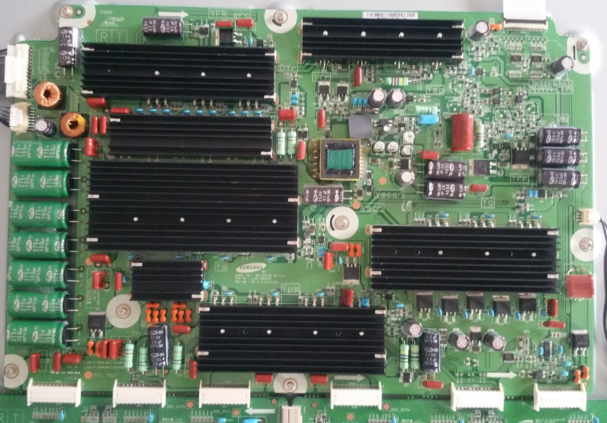

    I've been browsing this site for a few days but thought I would register to be able to see all the pictures you folks posted. After not being able to find quite the same issue as my TV, I've decided to post.

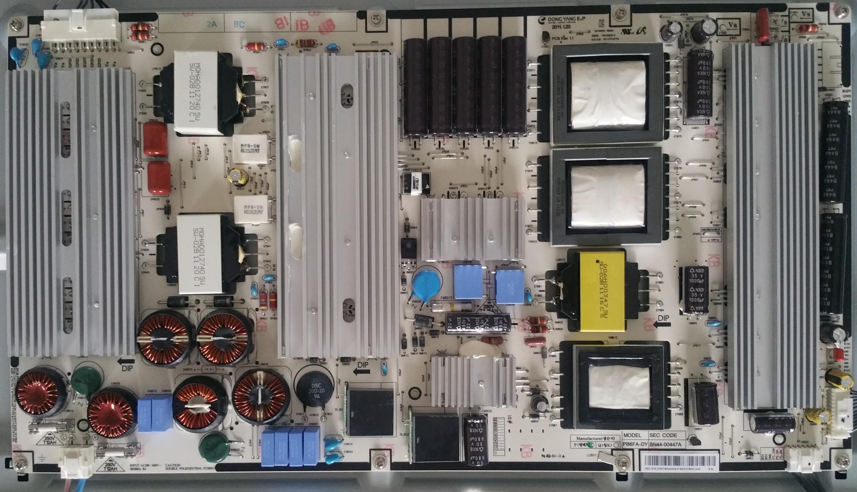

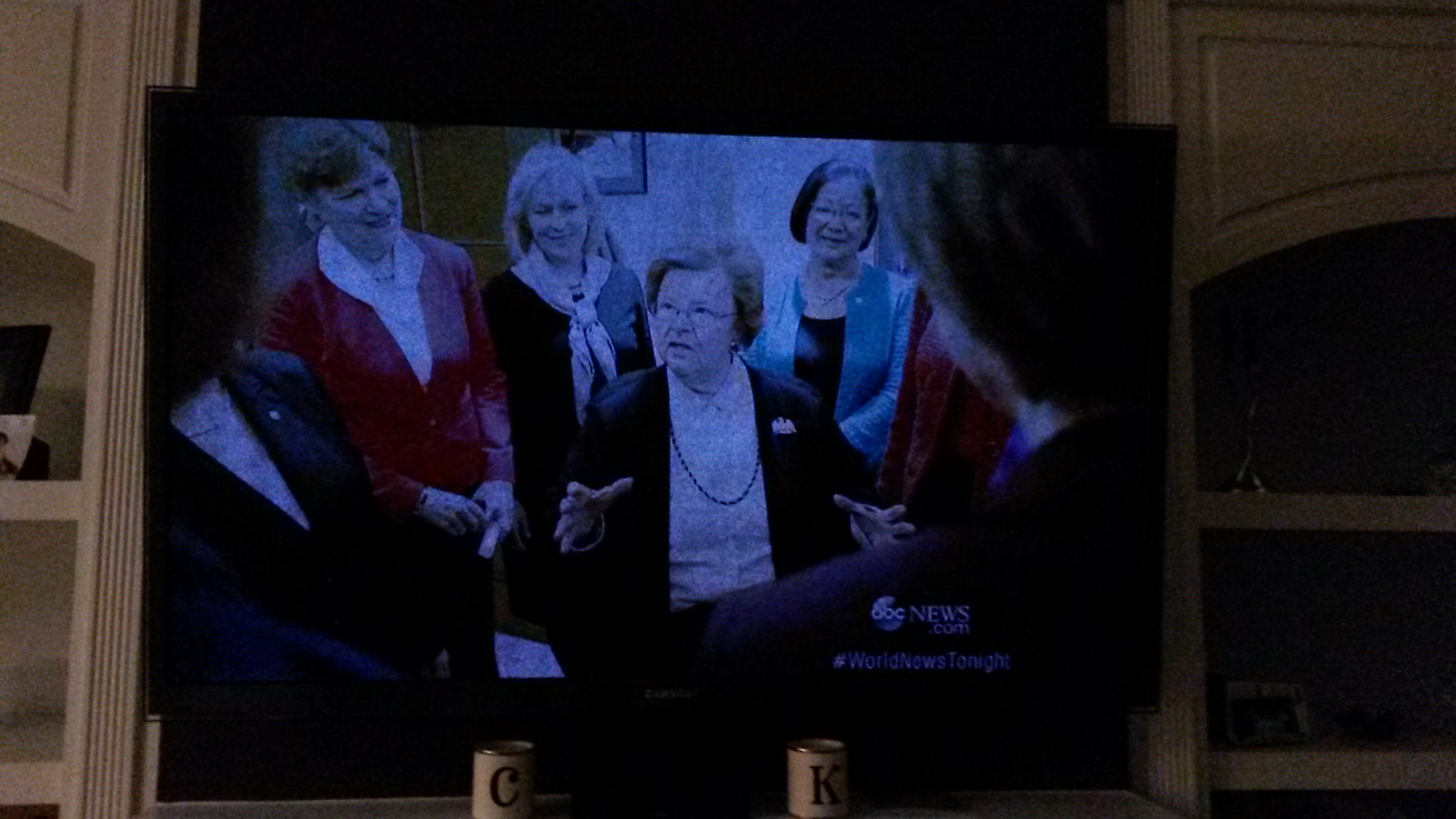

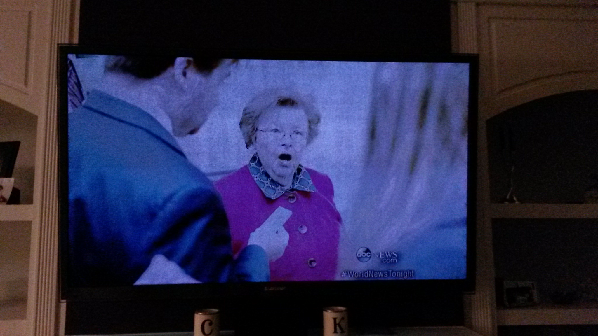

    I bought my Samsung Plasma PN64D7000 in 2012 (almost 3 years to the day of this issue occurring). The TV was working fine in the morning and when I came home from work all of a sudden it looked like the attached Pictures 1 and 2. The best way for me to describe it is a very white washed picture, with every pixel visible from close, and ~15-40% of them sparkling green and red. As you can see from the pictures, skin tone can not be distinguished.
    I've included a few pictures of the open TV but Cannikin, here, does a much better job of all the boards.
    I've checked the capacitors (visually) on the boards and none of them are bulging. I've also checked the two fuses next to the power inlet and they give me a reading (0.3-0.6).

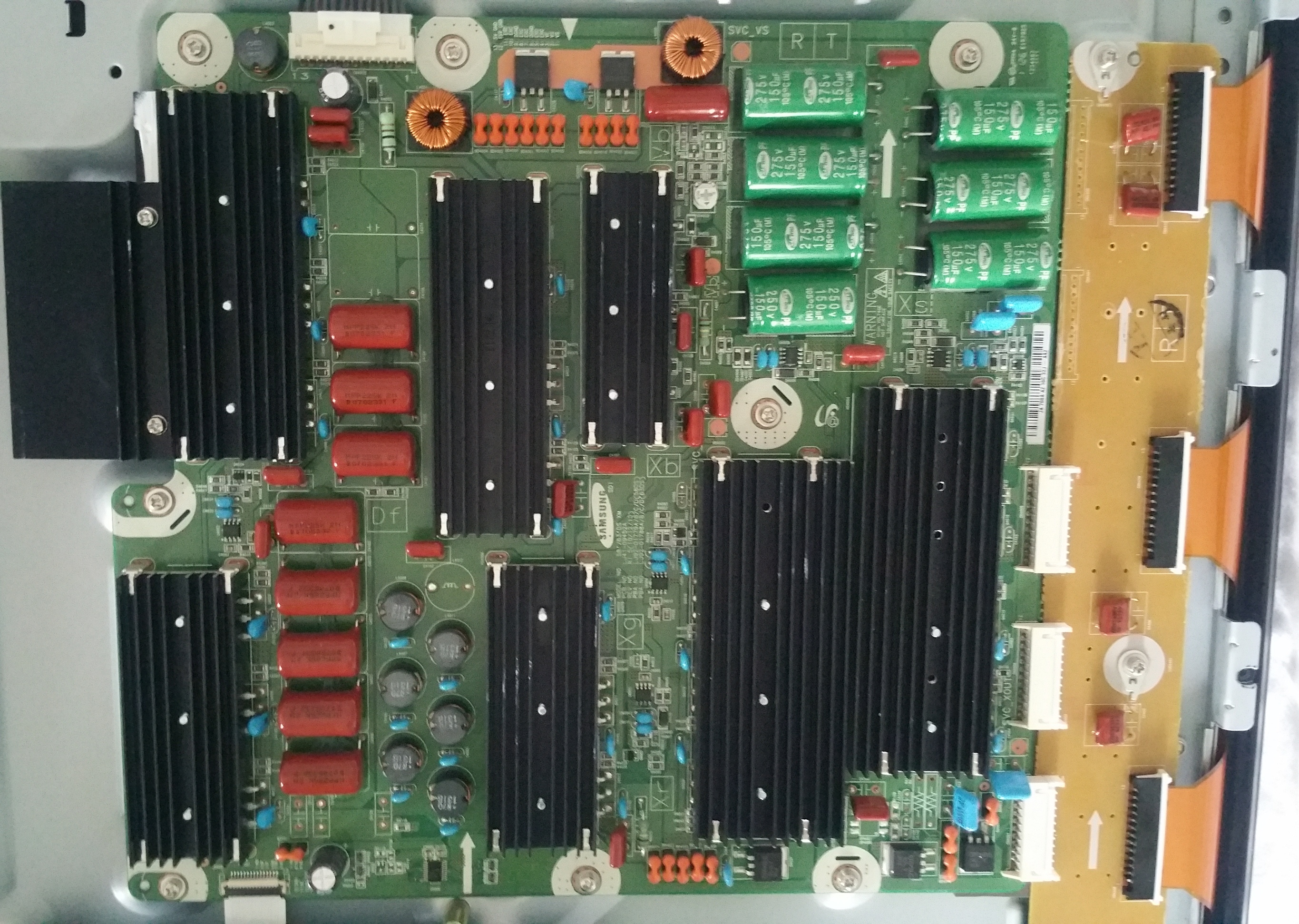

    Hmm--Looks like summit to do with X-SUS side of things....
    Firstly though, Its worth checking all the various supply voltages such as Vs, Va, VSC, Ve etc.....
    --They are marked on the back of the panel on a paper tag-the value each one should be....

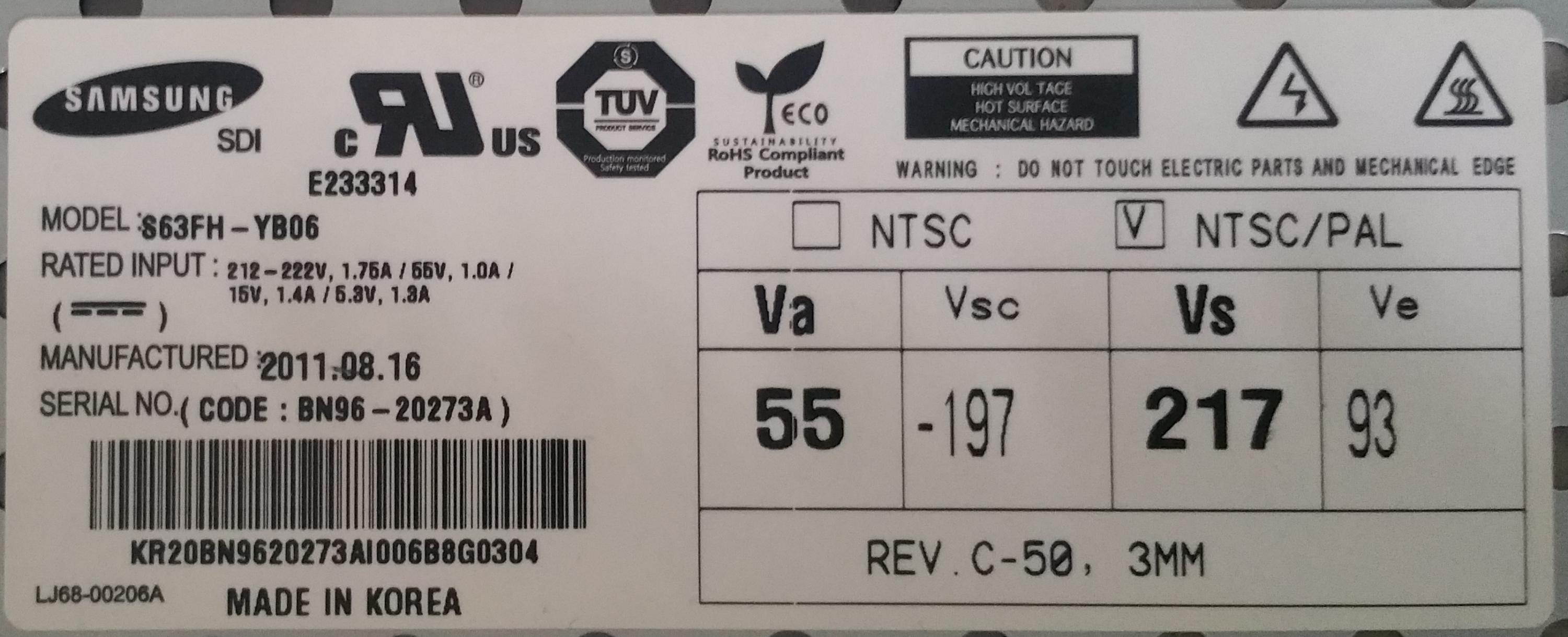

      Alastair, I figured that I will need to check these. I don't know what to do. I have a multimeter but I've never meaningfully used it. the voltages are listed in picture 3 of my post.
      VA 55
      VSC -197
      VA 217
      Ve 93
      Can you walk me through it or send me a link to a video/instructions?

        Set meter to dc volts.
        Black probe on chassis.
        Vs, va test point located on power supply.
        Vsc (Vscan) located on ysus
        Ve located on XMain.
        Voltages should match panel sticker.

                So I checked my voltages finally. The sticker voltages are:
                Va 55
                Vsc -197
                Vs 217
                Ve 93

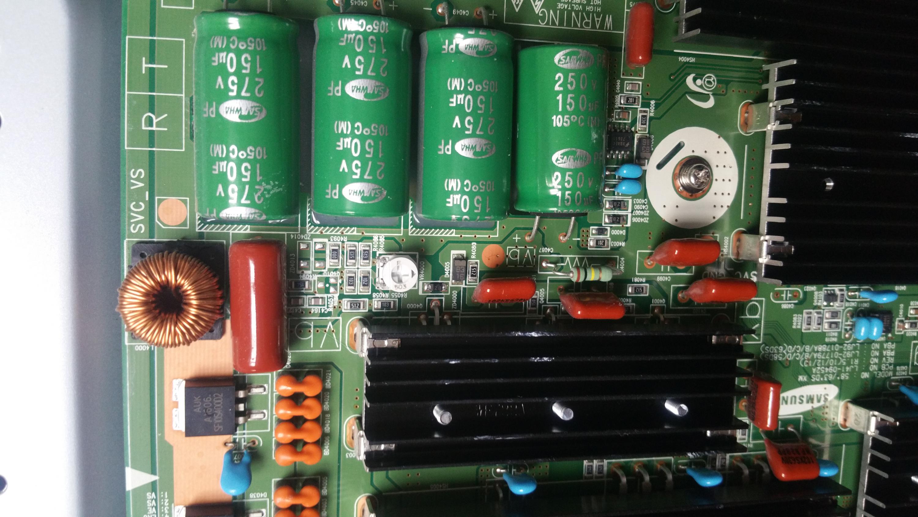

                I turned down the Vs voltage to 217 to match the sticker. The Vsc (VSCAN) voltage is 2 volts off so I don't know if that is the problem. Also I don't know how to change that
                I could not find the Ve test point. I see Vb test point and SVC_VS and SVC_XOUT on the X-main board. Maybe you can tell from the pictures I posted? Also on the X-main to the right of the Vb I see a white dial that can be rotated with a Philips head screw driver, leading me to believe that maybe that is the Ve?
                  Re: Samsung Plasma PN64D7000 White picture with sparkling pixels
                  For some reason for the 2011-2012 plasmas Samsung decided to use Vb instead of Ve... It's the same voltage just with a different name. So check that instead of Ve

                      Just checked Vb.. 95 volts
                      So Ve and Vsc are both off by 2 volts each

                        Is the white "dial" in the picture to adjust Ve (aka Vb) voltage? I want to ask before attempting to move this dial.

                          2 volts shouldnt result in the picture being like they way it is.
                            Yea, agreed. Worst might be a slightly off image, but not something this bad. There's a realistic tolerance of about 10V on Vsc and Ve, and 3V on Vs and Va.
                                Most likely, it's the X-main.
                                It's $24 on ShopJimmy. http://www.shopjimmy.com/samsung-bn9...main-board.htm
                                I've got one quick test you can try if you like. Check the voltage across the cap highlighted in the blue box. Should be about half the Vs voltage or around 80-120V.
                                If it's low, get the X-main from there, you can be pretty sure...
                                If it's NOT low... I'd still get the X-main if you are OK with taking a $24 risk to fix a 64" TV (I would, myself, given that plasmas are now dead technology & represent the best image quality you could get. Only OLED available now. )

                                  Tom I'm more than willing to risk the $24. I'll check the forum for info on how to's, but if you beat me to it:
                                  How do I check voltage across the capacitor?
                                  (Multimeter setting, tv on or off, what not to touch, etc? - I've been warned not to touch anything metal while the tv is on or shortly after, so I just want to ask before doing anything unsafe)
                                    The TV is on for this test. You want to put the red probe on one lead of the cap and the black on the other. It doesn't matter which way around you put the leads. Set the meter to the 200V DC range, with probes in Volt and COM and tell us what you get.
                                    • cap223
                                      • Mar 2015
                                      • 22
                                      Tom,
                                      The reading on those caps is 14.9-15.2
                                        Ok, then your X-main is definitely not working right.
