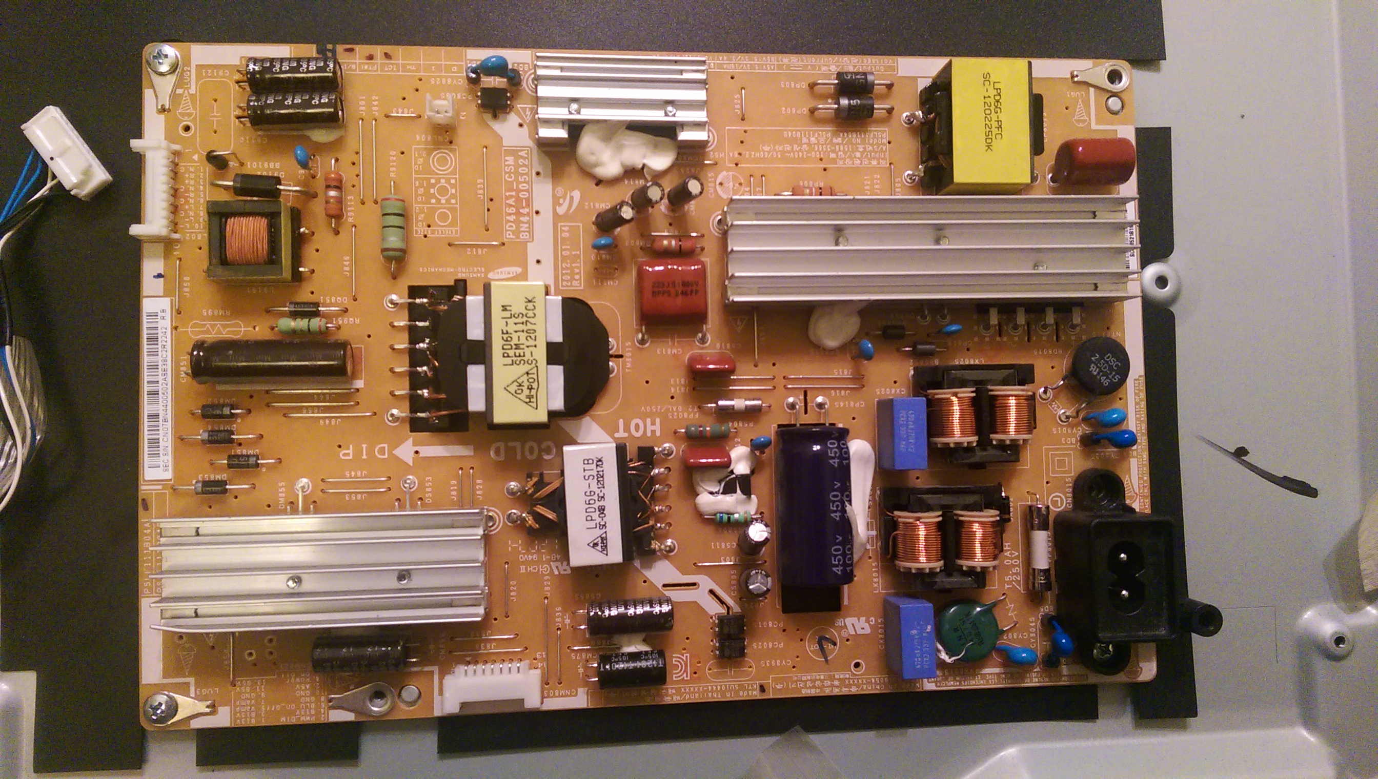

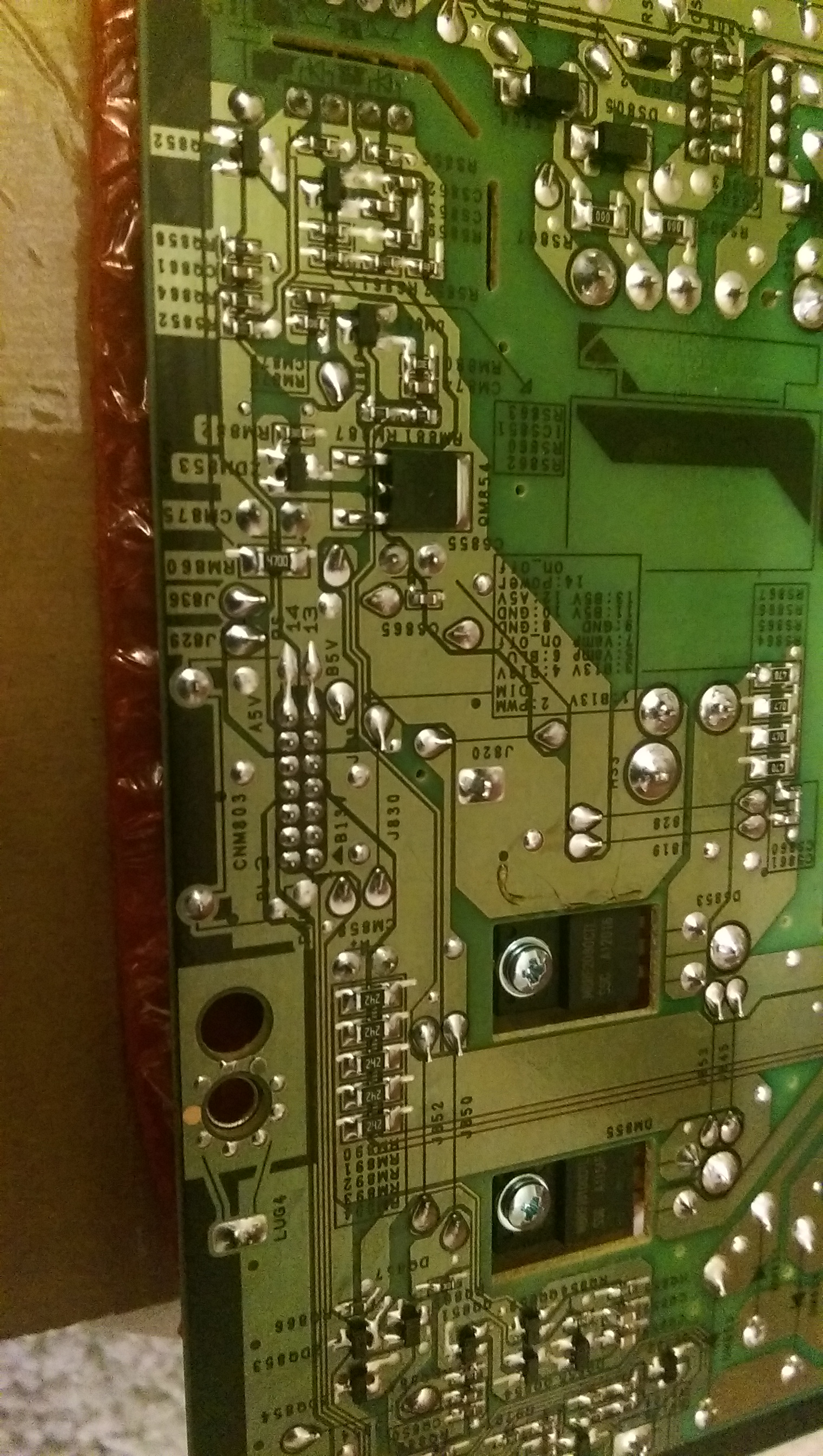

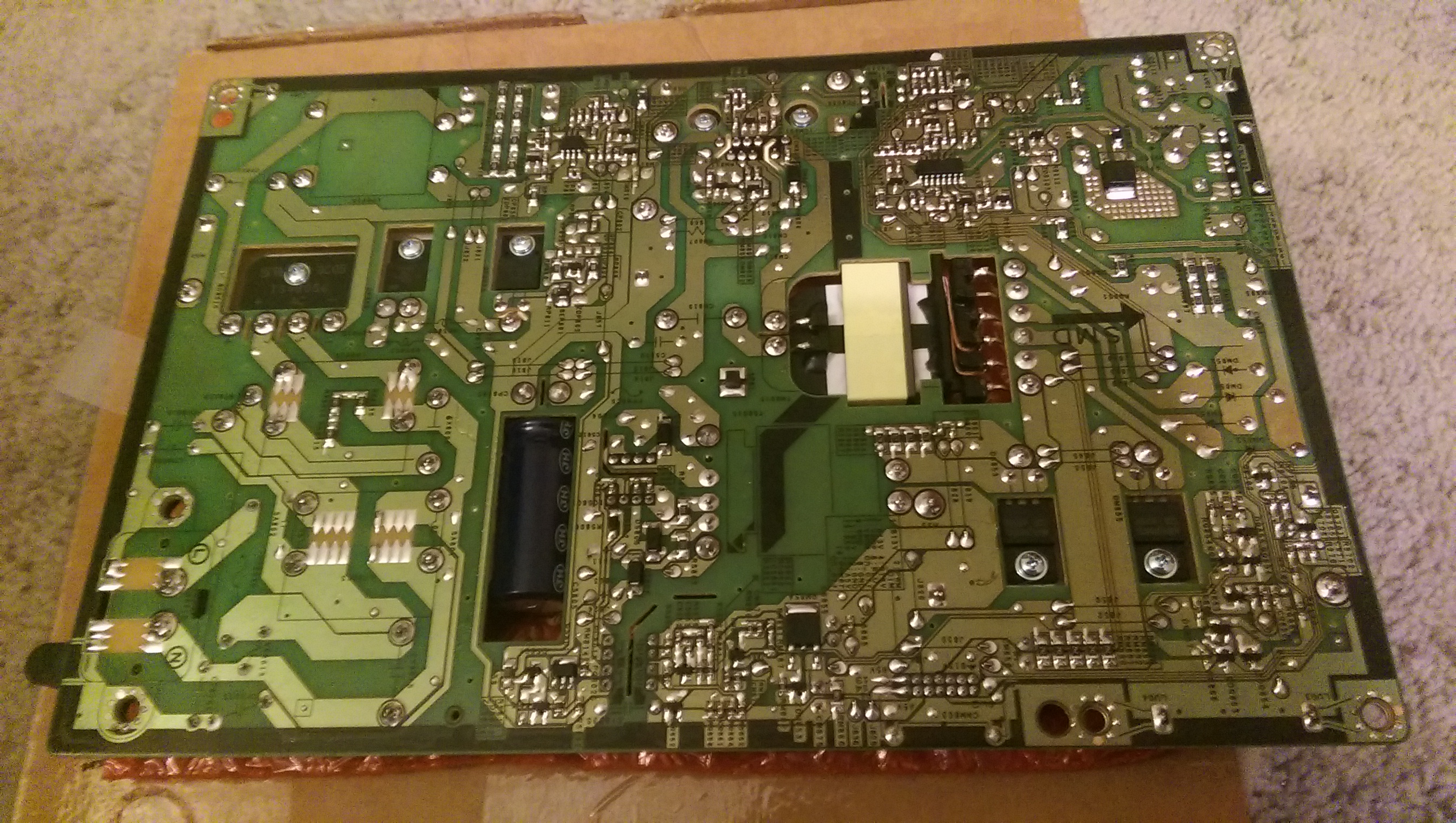

    UN40ES6150 - Intermittent/no video
    So I dug this set out of my closet. Forgot how long it has been there. Plugged it up, got a display with the smart splash screen and vertical green lines. Did it the sloppy way and chanced a tcon since it was cheap and might be the cause of the lines. When it arrived, I plugged the set in and got no display before installing. Unplugging the main gives me backlight so i can see the panel and led's seem to be good. At this point I went back to test voltages and they checked out except for my 13v line which is @ 12.85 and drops to 12.82ish when the backlight is on. I also probed the panel vcc point on the main with it plugged in and it matches the input voltage from the harness, which leads me to believe I may have to solve this first before I can move on. I have been unable too find a schematic and am still an amateur so any help is appreciated. Also, PS model is BN44-00502A. I have attached 3 images of it, please let me know if you need more detailed pictures and what areas to take them of. Thanks in advance!
