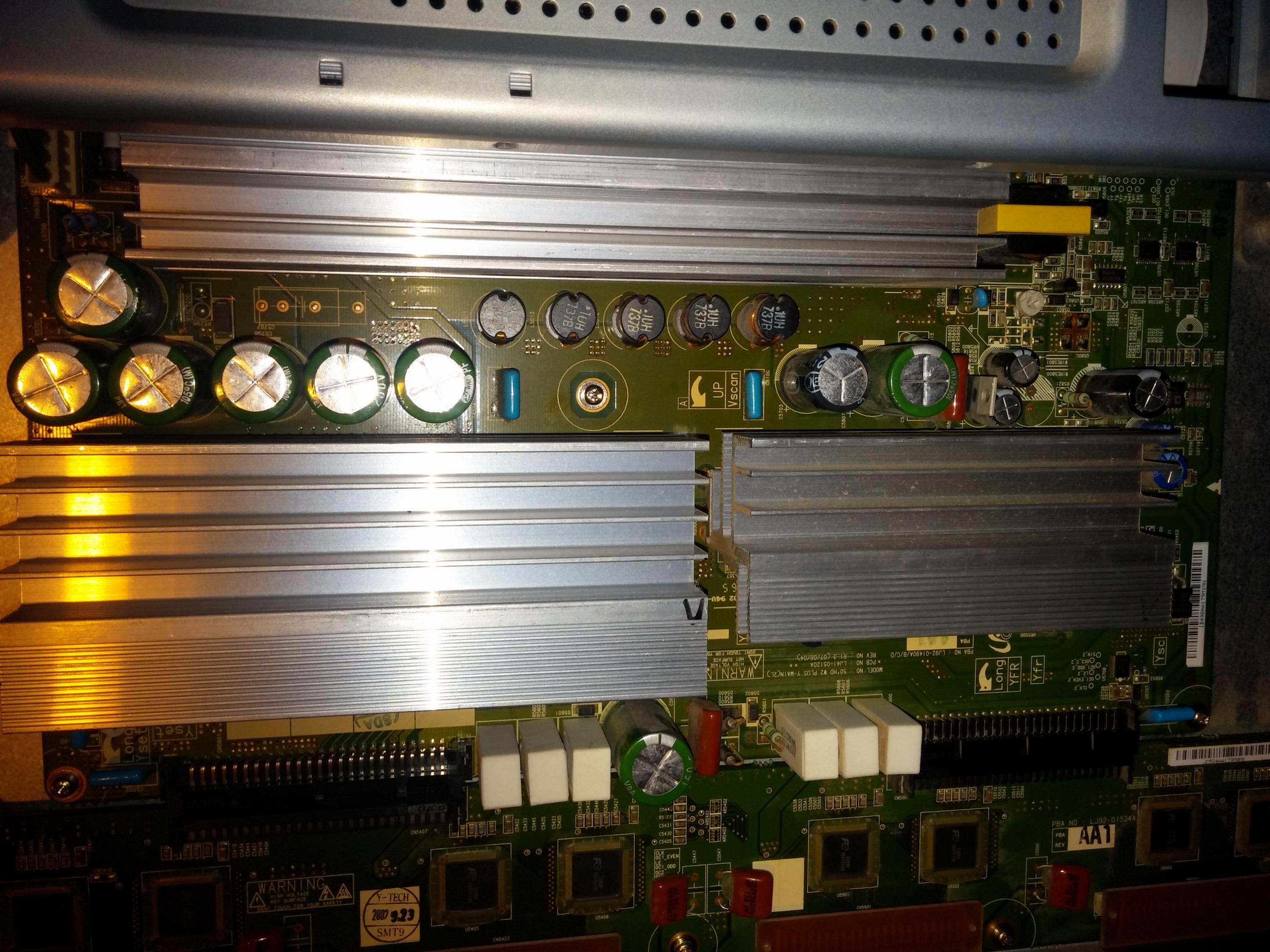

    The set will turn on and begin to display video, and then goes into protection mode. Blinking red 6 times repeatedly. The set then has to be unplugged, and plugged back in to get it to power up again. The set will stay on if there is no video playing, and just a black screen. When the set goes into protection mode there is a green LED on the power supply that blinks twice then repeats. The chart on the PS indicates the code means Va.
    If I unplug the connector on the power supply that has an output for Va. The set turns on and sound plays. I test the Va output from PS and get a healthy 63.5 volts. When I plug the connector back in and take a voltage reading I get 54 volts. The power supply does have a bulged capacitor, but after swapping it I still get the same results.
    The Va from the power supply runs to a long board on the bottom of the tv. I believe this to be a buffer board.
    I do have some component level repair knowledge, but very new to the Plasma scene. Any advice or suggestions is welcomed, and appreciated.

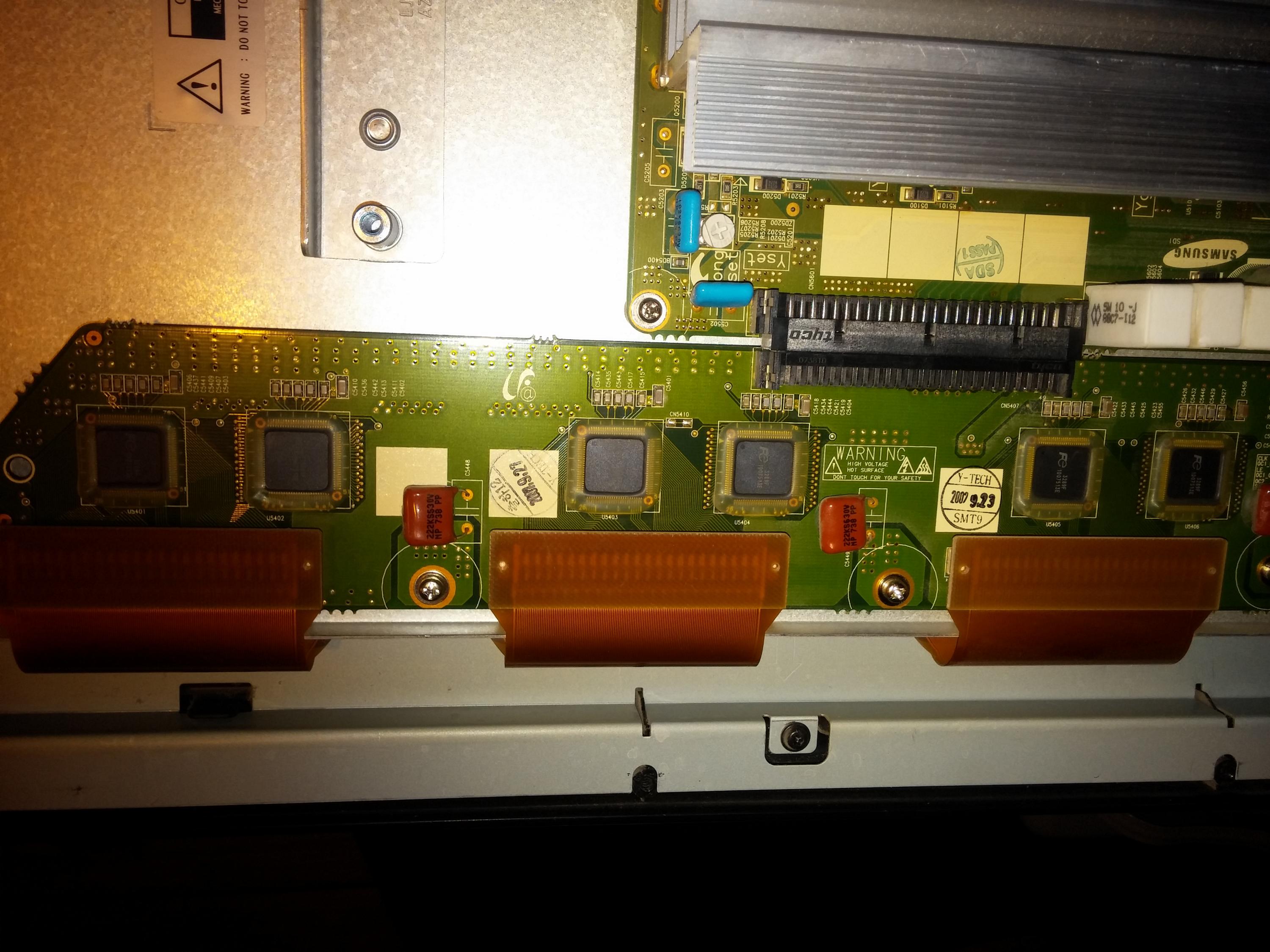

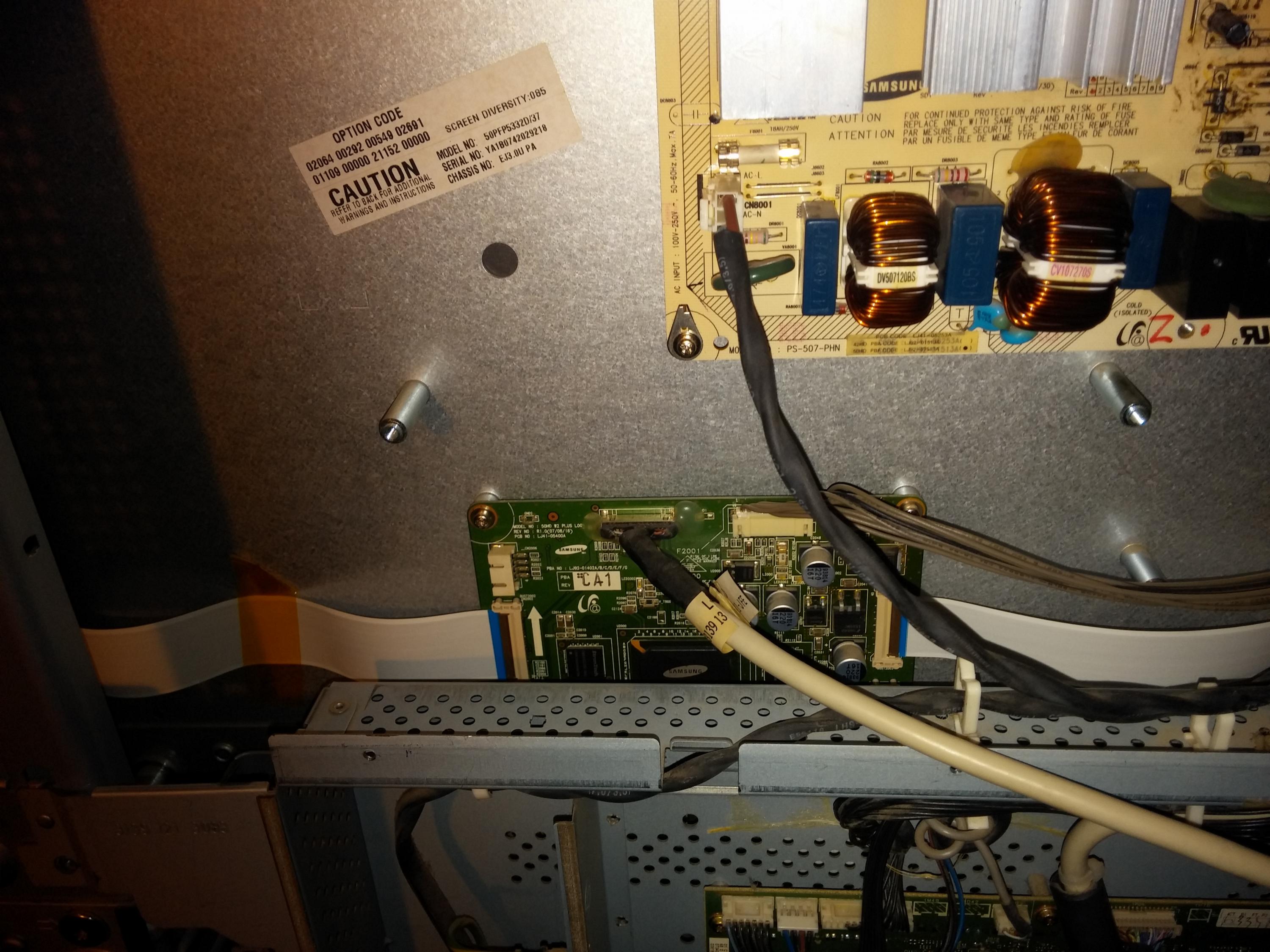

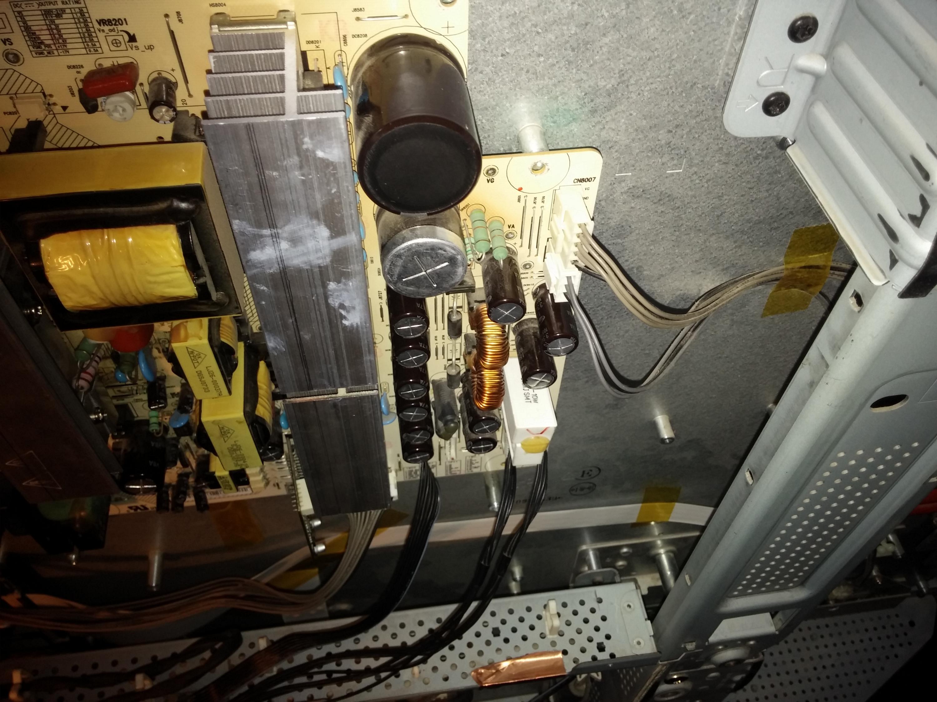

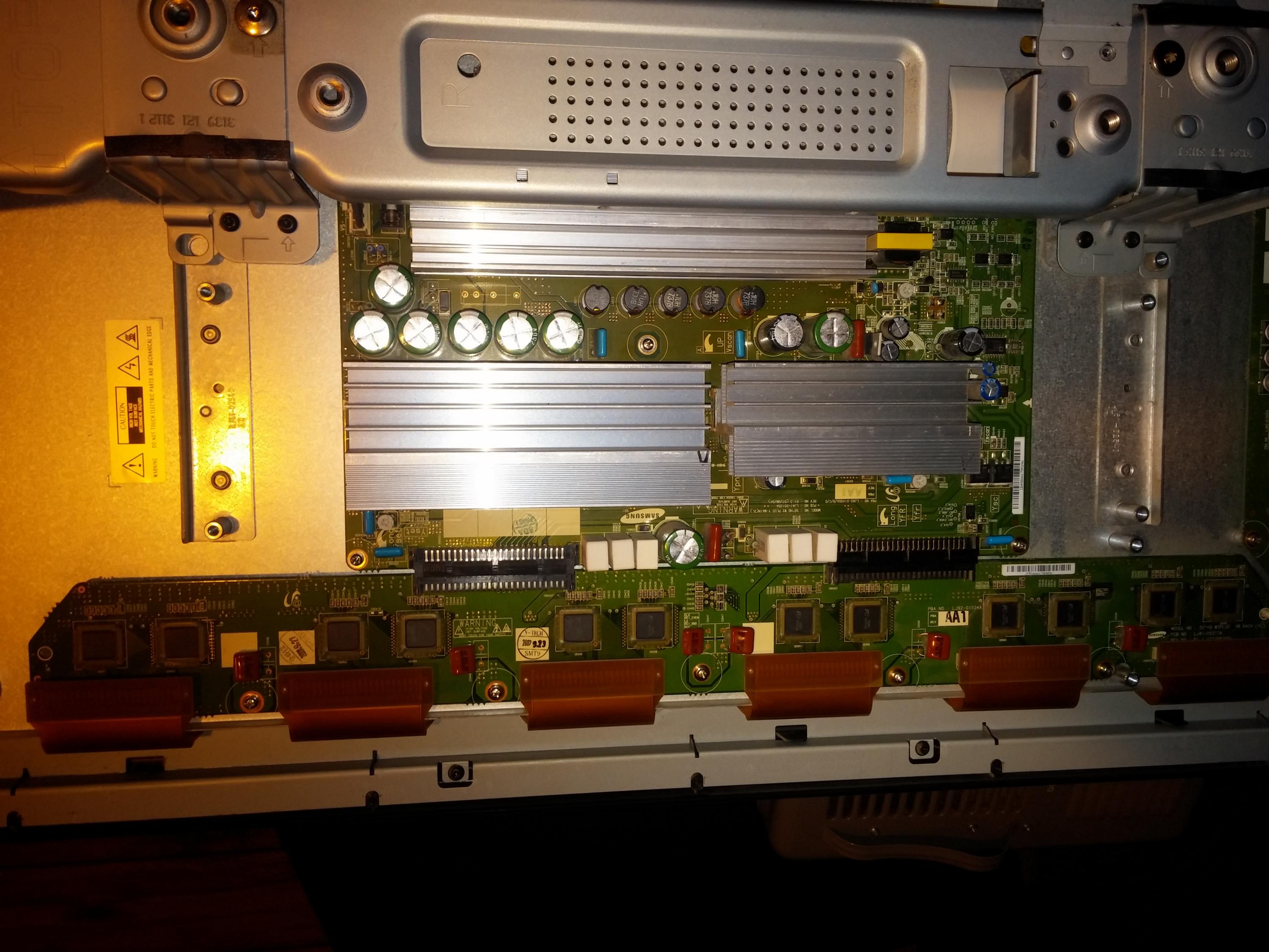

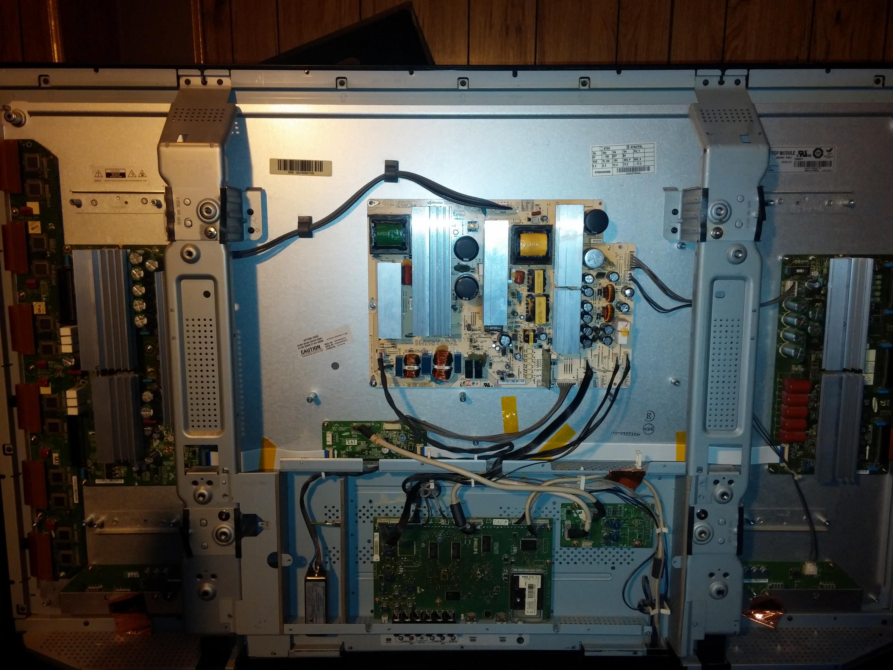

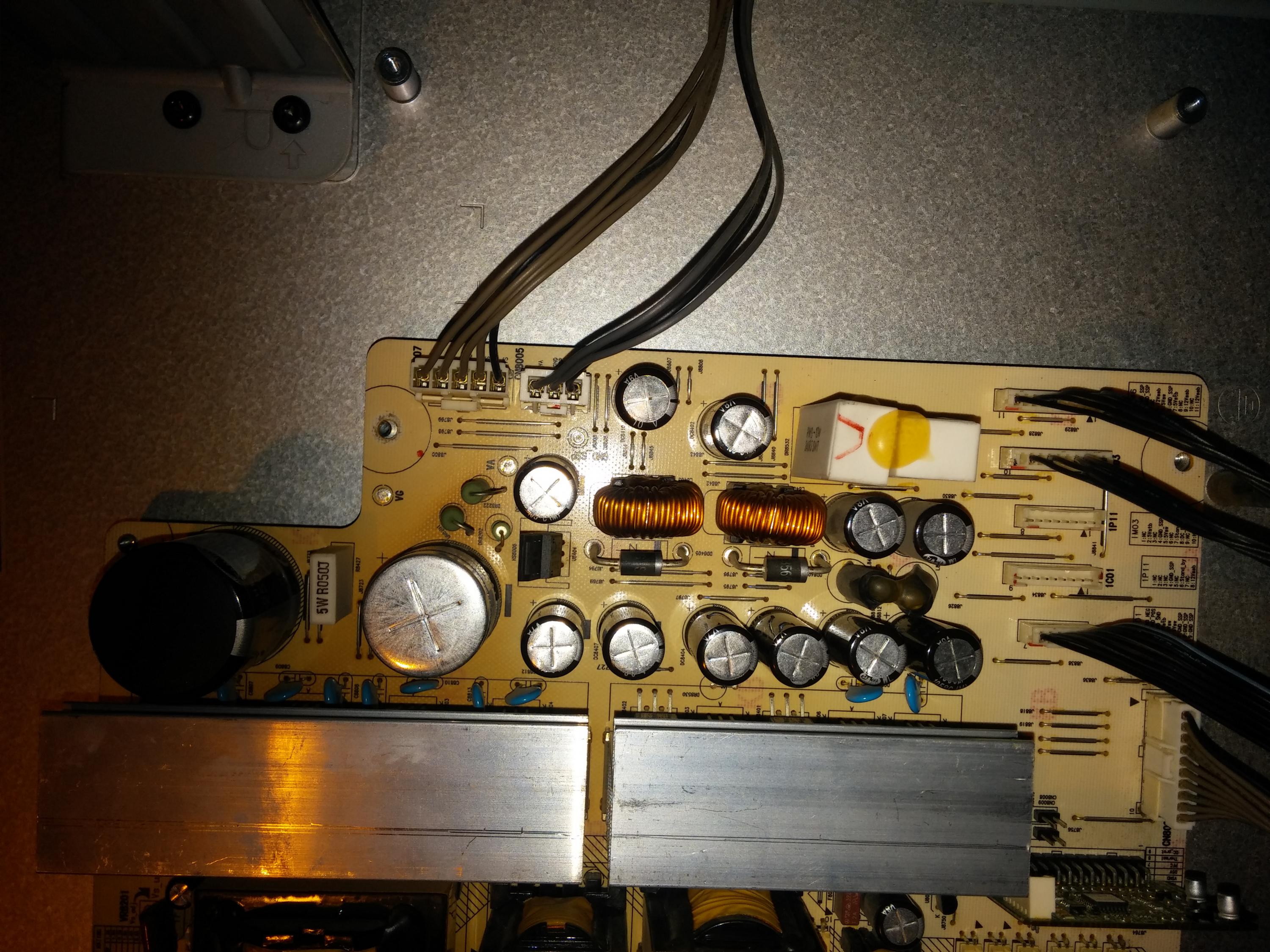

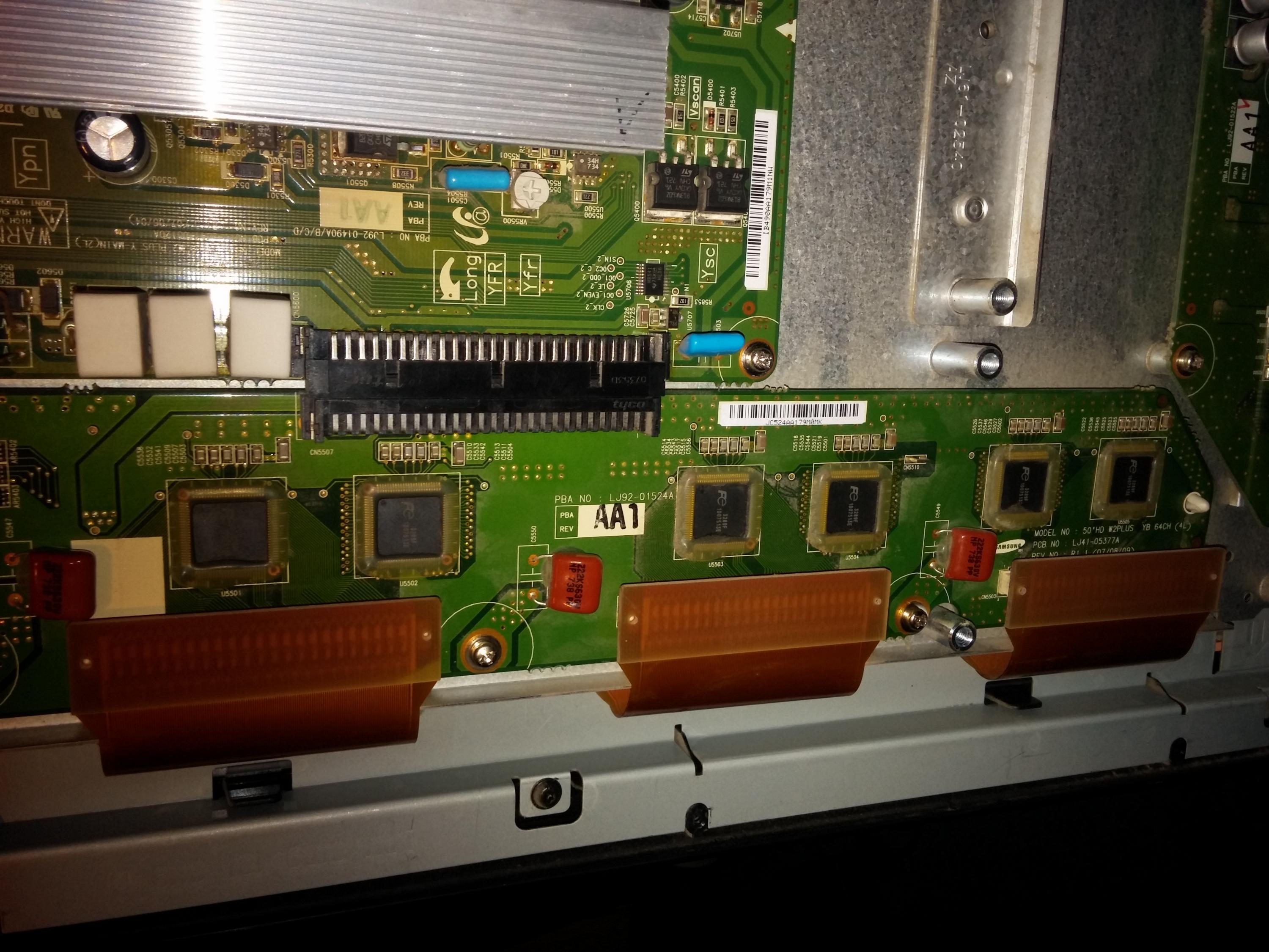

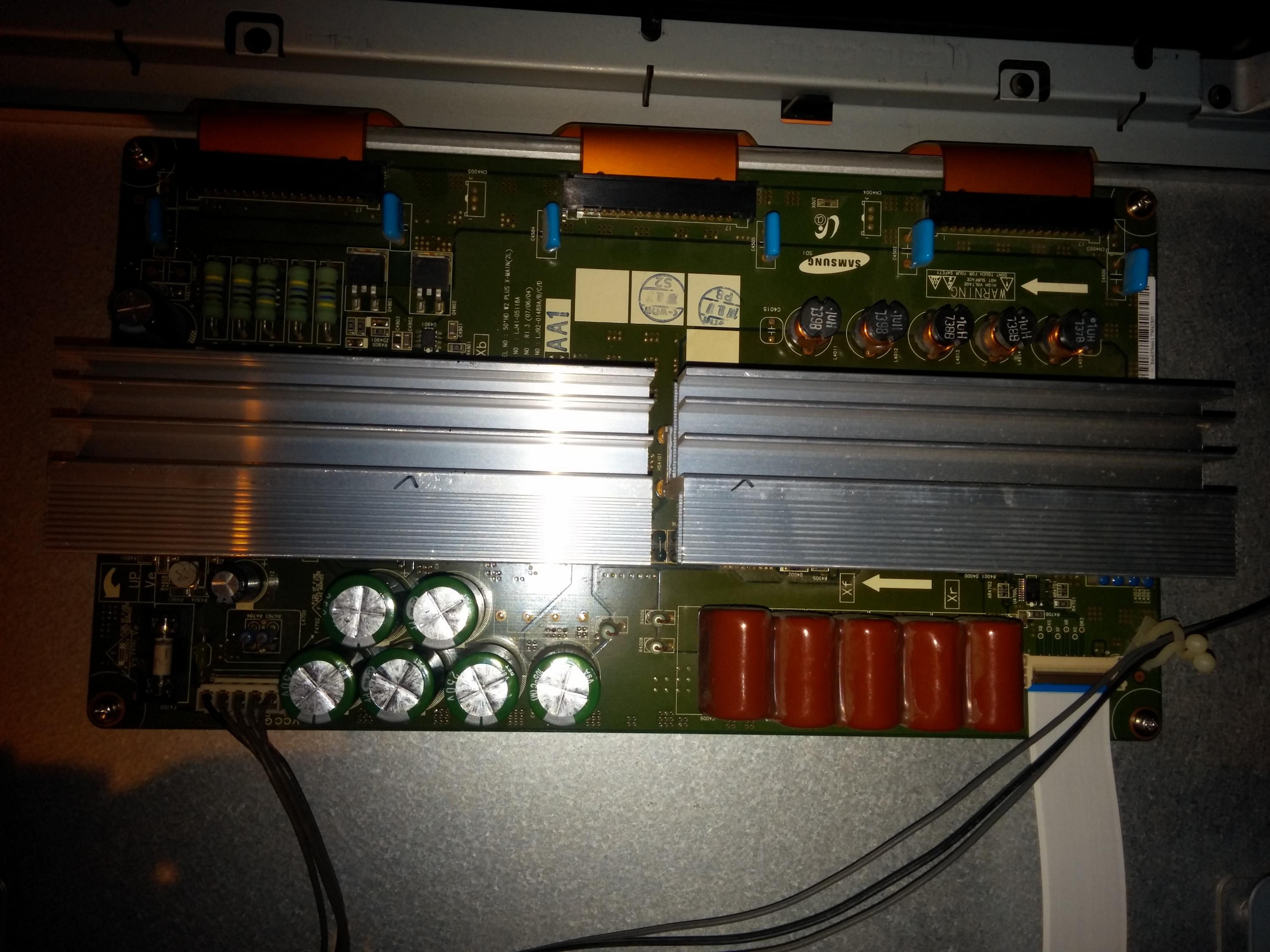

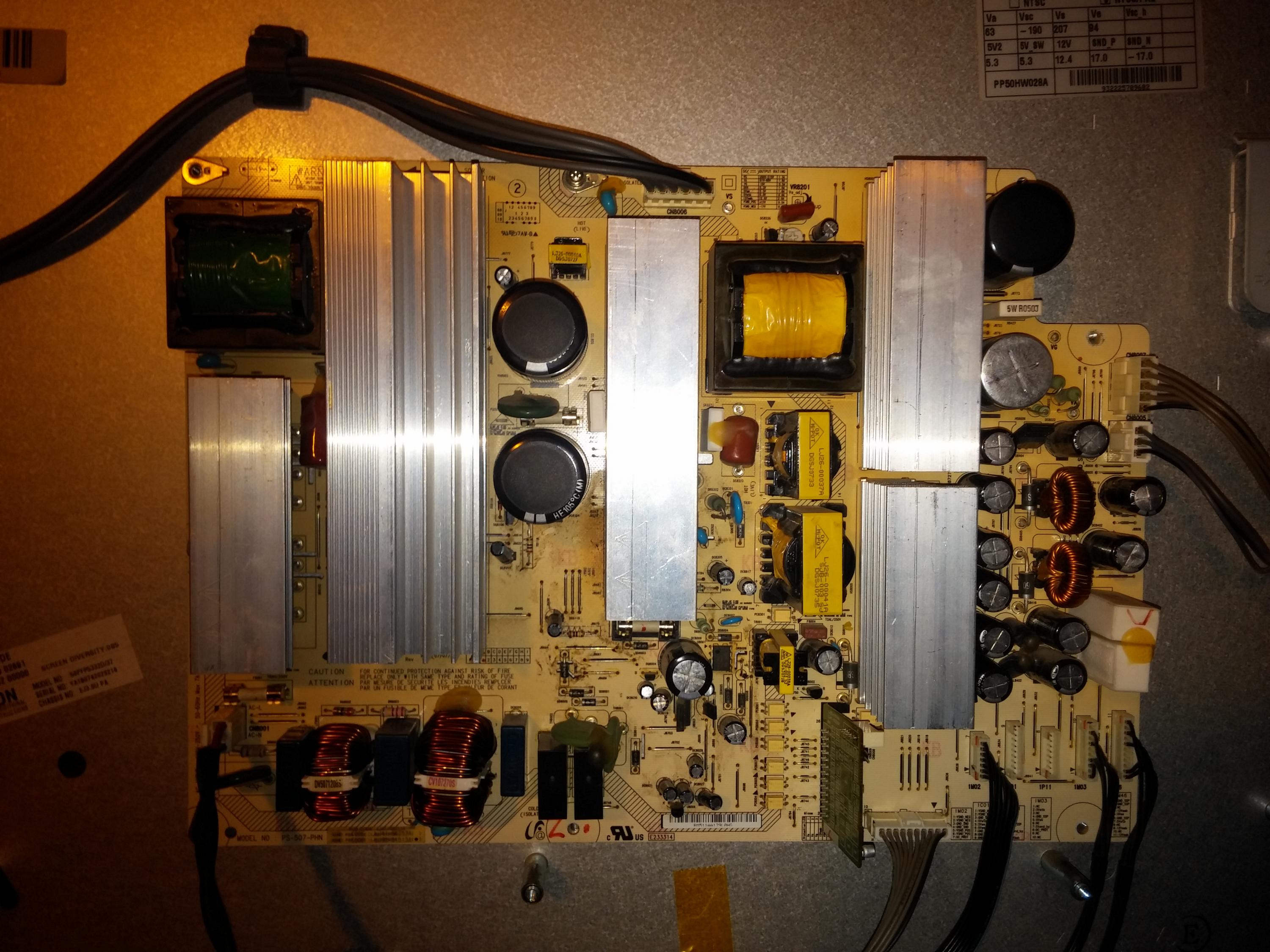

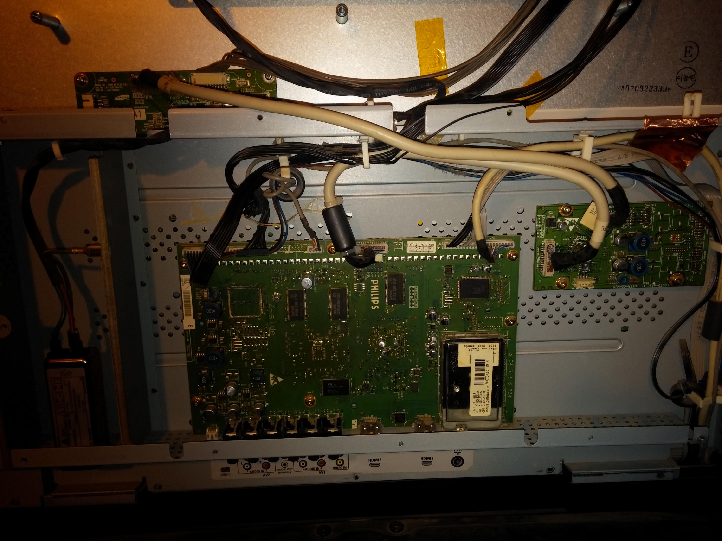

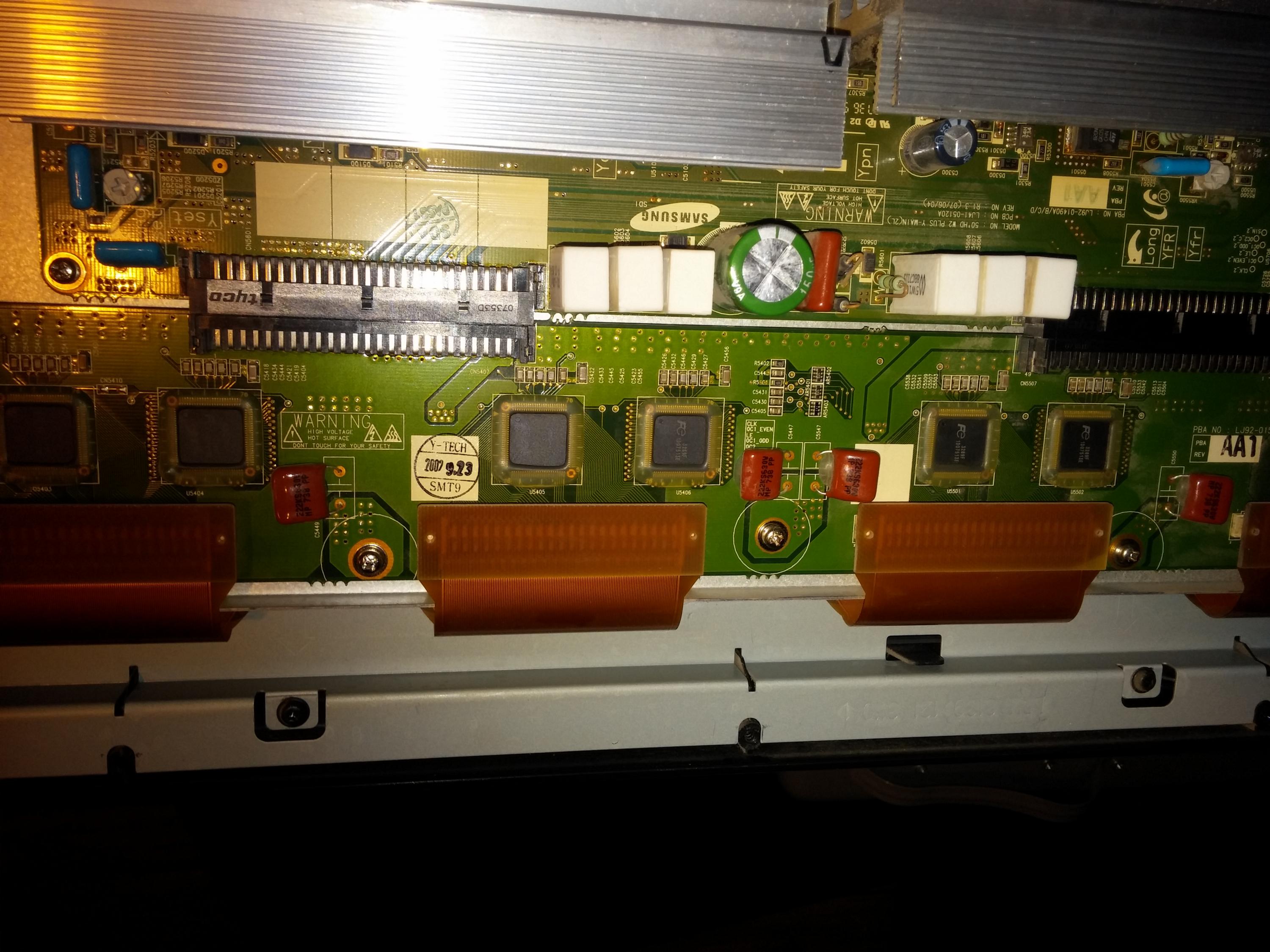

      Re: Philips 50PFP5332D/37
      Posting pictures of the back of your tv showing the boards with clear pictures may help you more with fixing your problem
      • dlaroche
        • May 2014
        • 24

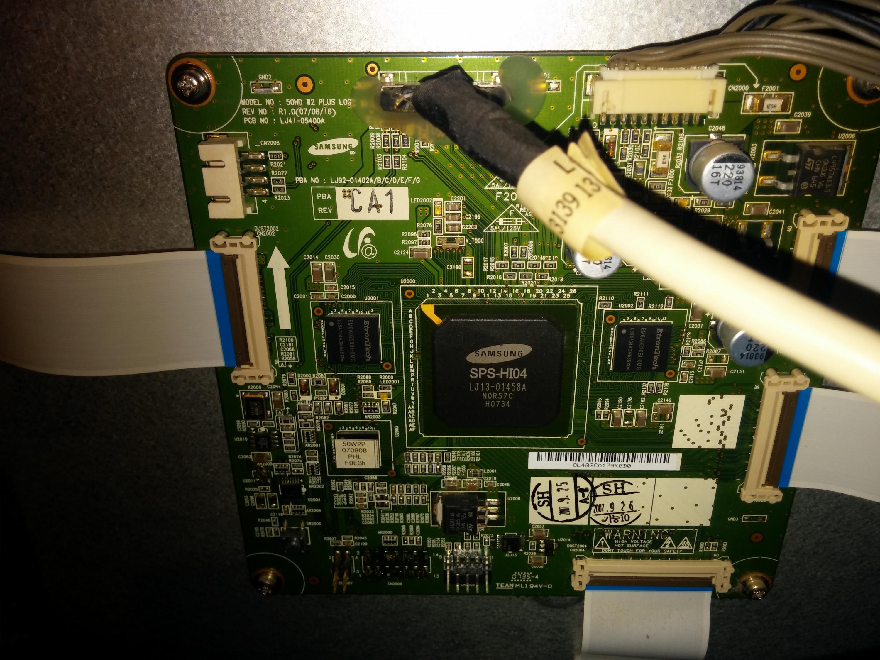

        I have included pictures of the back of the television. Also, when I unplug the LVDS cable and jumper pins 3 and 4 on the logic board the screen plays the test patterns correctly, and does not power off. Does this suggest the SSB (small signal board)? The RF modulator housing on the SSB seems to warm up very quickly and obtains a high degree of temperature. Does not appear to be normal.
          There is at least one bloated capacitor on the power supply. This could cause issues.
              If one is bulged then the others are soon to follow. Its best to replace all of the low voltage caps IMHO to save having to change others in the future.
              If there are others that have gone out of spec but not bulged yet, they will cause problems.
                However, the set plays the test patterns fine. I thought this test ruled out the power supply? The tv will remain on when there is no video plugged into it. It will power off if you try to access the menu or plug video into it. It will play video for about 2 seconds before powering off.
                  Depends what the SSB requires. If the power supply is unable to regulate well as the SSB draws current this could cause a fault which would not show up during test patterns (panel only uses Vs, Va and sometimes 15V... SSB may require other voltages; Philips usually uses +/-12V and 5V) Perhaps worth checking how well PSU voltages are regulated during fault condition.
                          You should probably check which occurs first. Example, set your meter up to measure Va. Note that, perhaps, Va drops out, then power supply signals Va error which THEN causes a PSU full shut down and the SSB to think error code 6... OR... Power supply works fine, SSB shuts down w/ 6 blinks but does shut down poorly causing sequence errors, tripping PSU error code 2.
                          To me, it sounds more like choice 2, as the set works fine on test patterns... but don't rule out a power supply with a struggling 5V rail.
                          Examining which order the codes occur in can give you a lot of info.
                              That Va is too low. Test patterns can be quite generous to Va. (Load on Va is generally proportional to the number of vertical pixel transitions in the image. Real content will load more than typical solid colours.) If you try solid colours on the TV via SSB does it still cut out? BTW, Va should be within 2V of sticker rating at all times.
