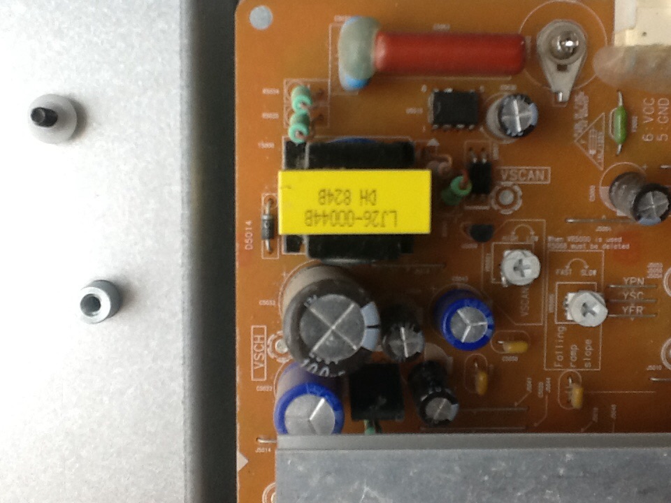

    Check the Diode, D5015 near top edge of Y-SUS for S/C. Its a UF4007

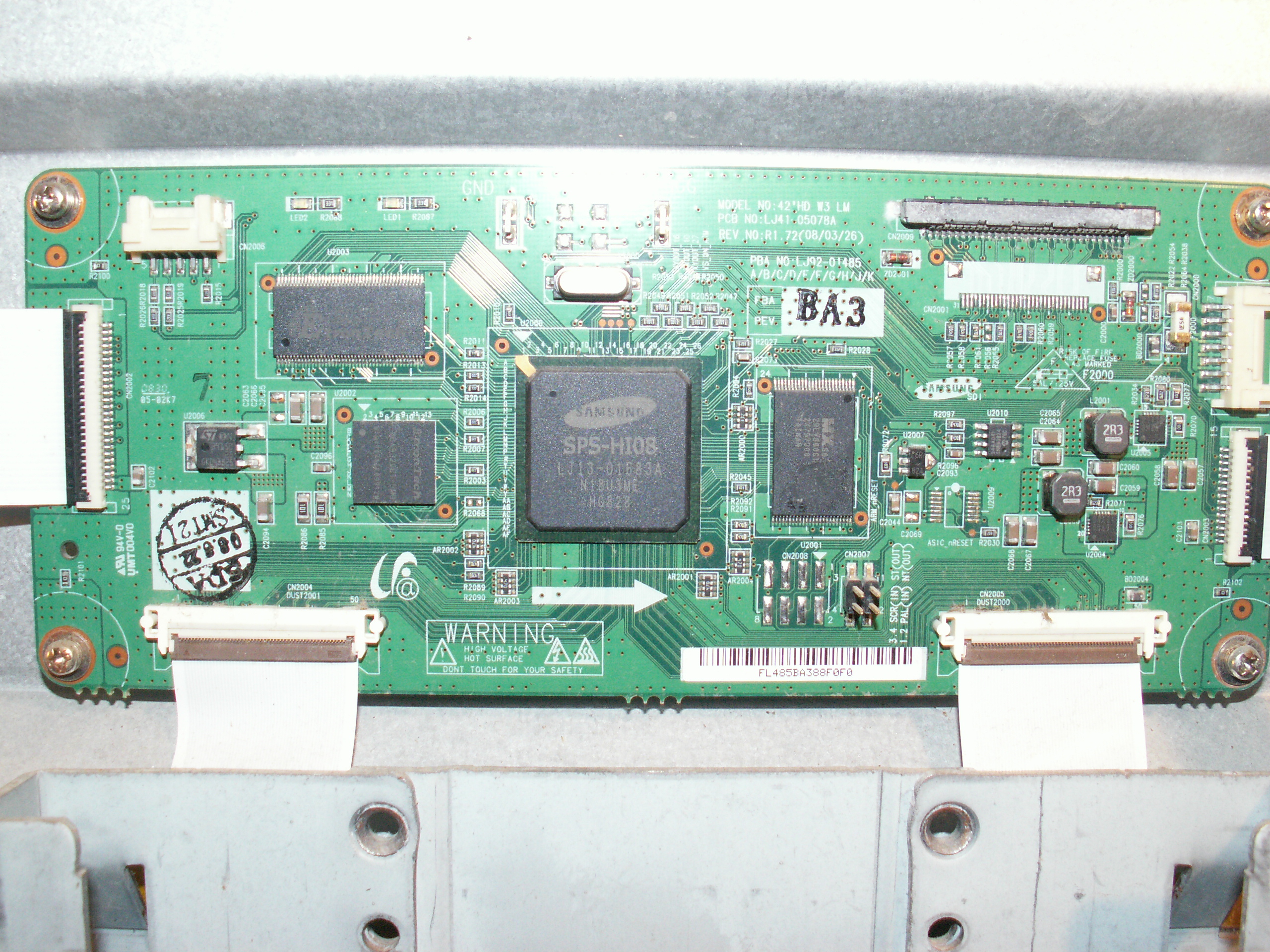

      You can disconnect LVDS cable from mainboard to logic, look at logic board and find 4 holes 1,2,3,4 jumper 3,4 with alligator clip or the like, then disconnect power cable from main and use a resistor to jumper 5v Stby to PS-on. There might also be a VS-on pin, if so then that will need a jumper also.
      If it's working properly there should be test patterns displayed, If not then better pics of all boards are needed.
      When logic LED flashes, is it once every second or once every 5 or so seconds?

        Thanks Alastair E, do you mean 5014?
        If so it checks out at .485 ( fluke83), good no?

          Thanks MagicSmoke, steady once a second, ok I'll replace the ef heat sink and try to power it up, just wasn't sure about try to force it on if it doesn't even prime( been reading plasma threads trying to figure out TS procedures)

            Aye--My mistake Thats the diode--sounds like yours is OK.
            Whats the Voltage on that rivet marked Vscan? Should be about -190

              Yup Vscan(Vsc on panel sticker),Ve, Va and Vs are all spot on.

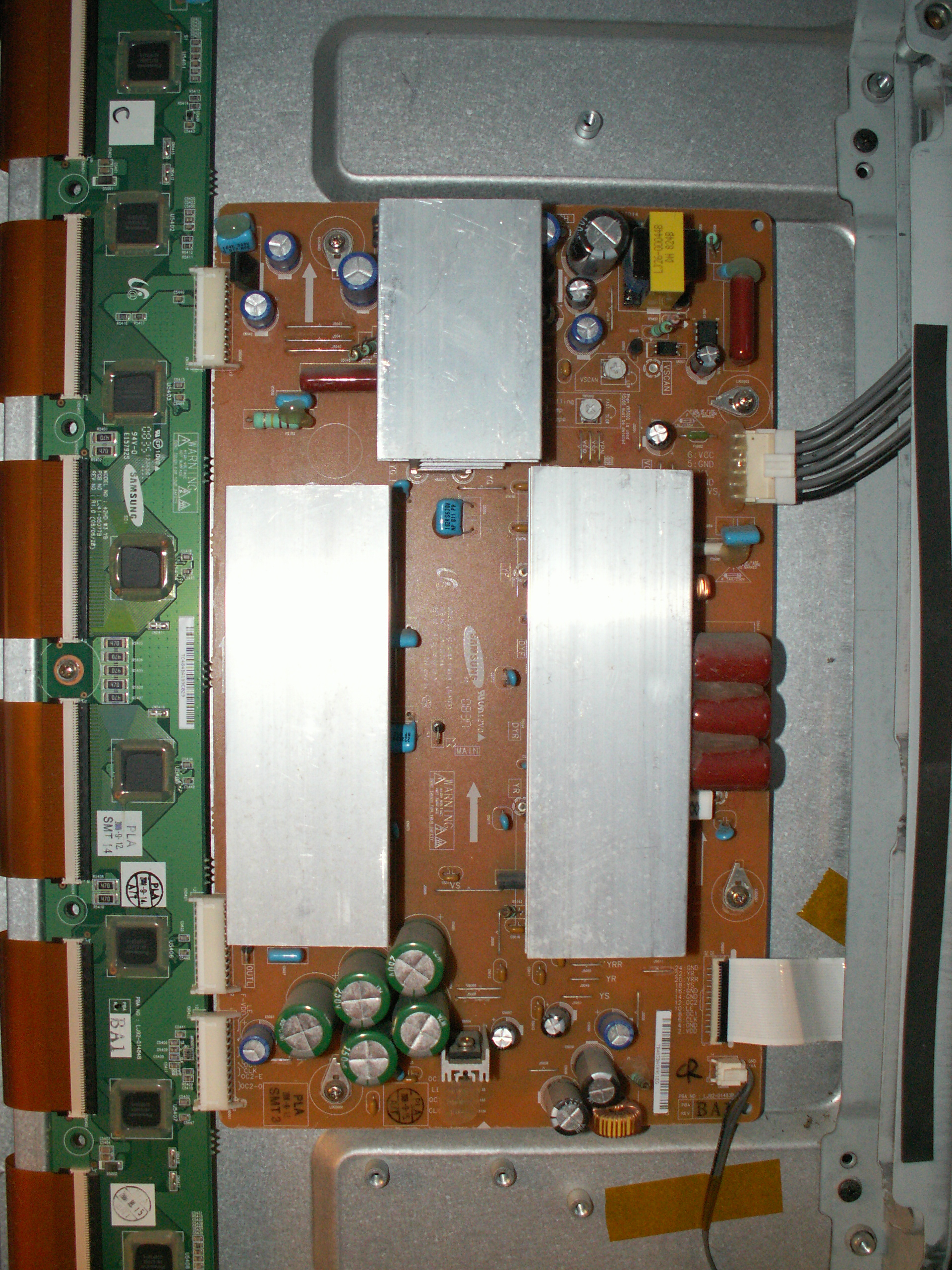

                            Re: Samsung PN42A450P1D Plasma screen doesn't prime

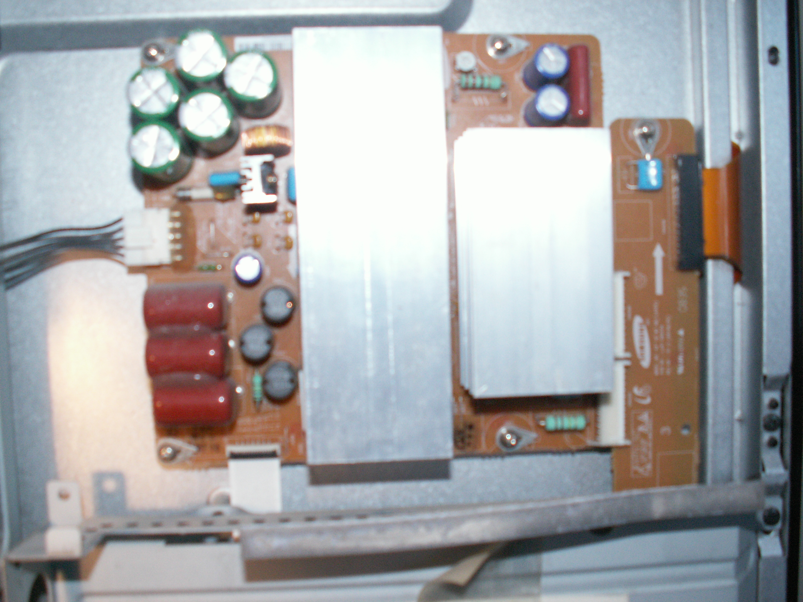

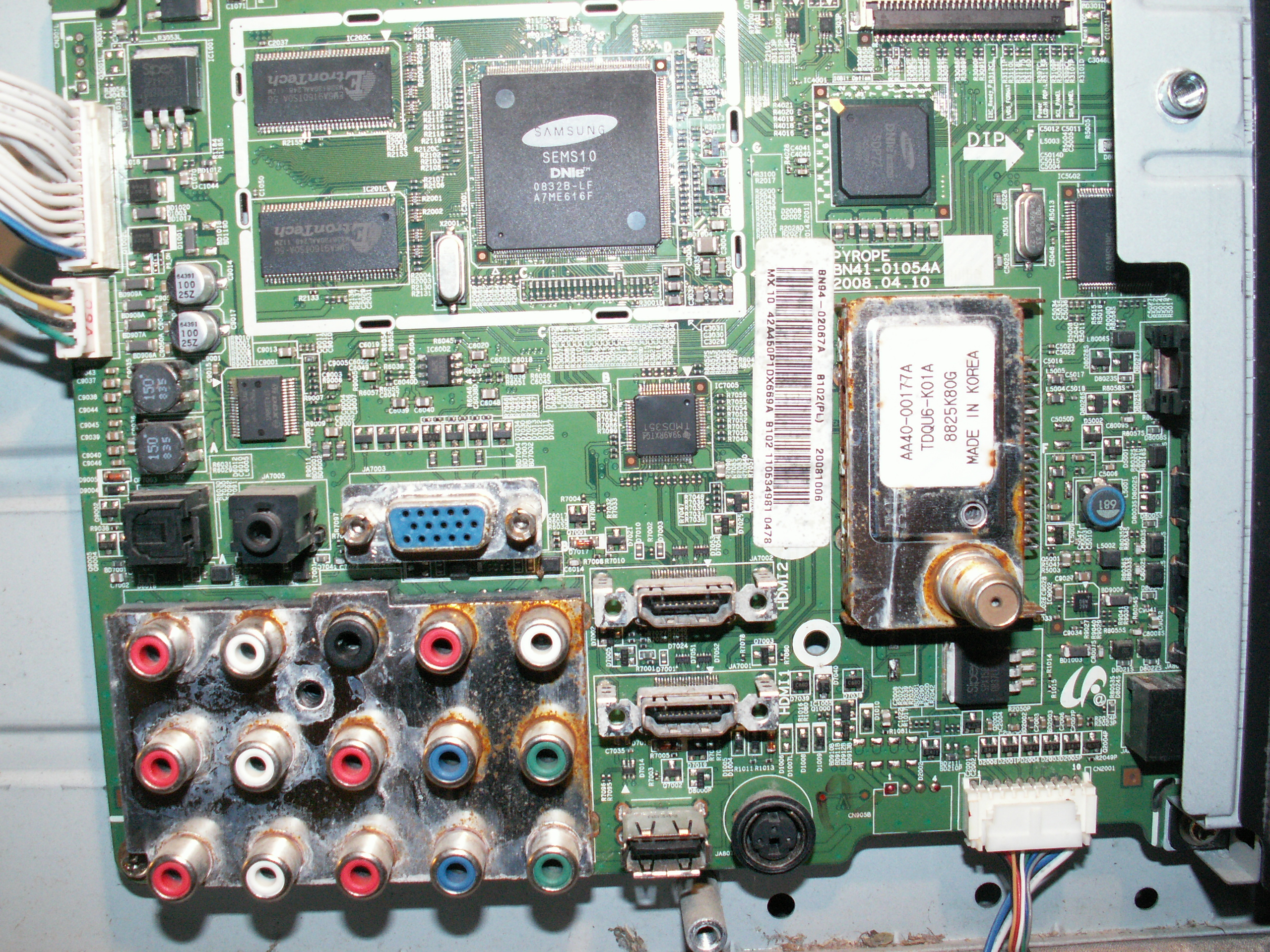

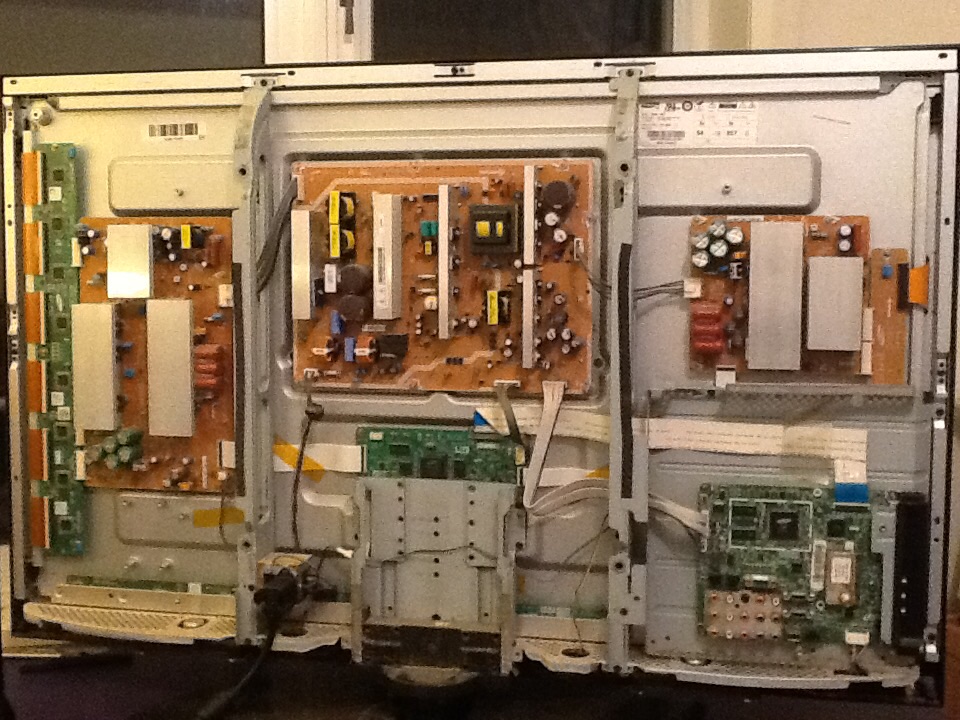

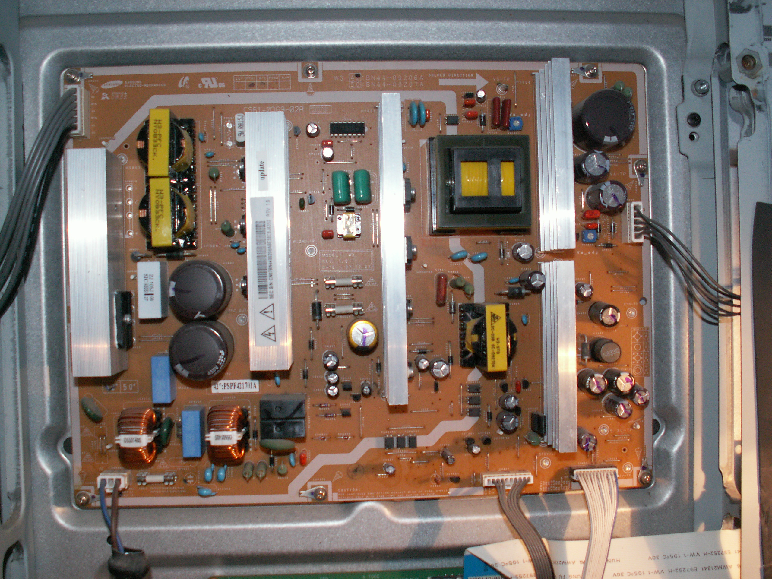

                            boards:
                              Originally posted by tom66
                              Weird... do you have access to an o'scope? Are all fuses, including small 15V or 5V ones ok on the Y-main?
                              I do! Picked up a tek2465 last spring but have not used it yet, been looking for an isolation trans...
                              Fl1&2 on Y-main, are those fuses?
                                Yes the green ones are a fusible resistor.
                                  So I should have 5 & 15vdc at the exposed legs?
                                    Yes, sometimes there is also one for Va (~60V)
                                      Rl1 is ~26vdc
                                      Rl2 is ~35vdc
                                      10x probe is my only probe at this point and I don't have much practical experience.
                                        Ok I found the GREEN FUSES F5002 top right quadrant of Y-main, 15vdc.
                                        F5007 is in the bottom right quadrant under the heat sink, 92vdc.
                                        Both measurement use chassis ground.
