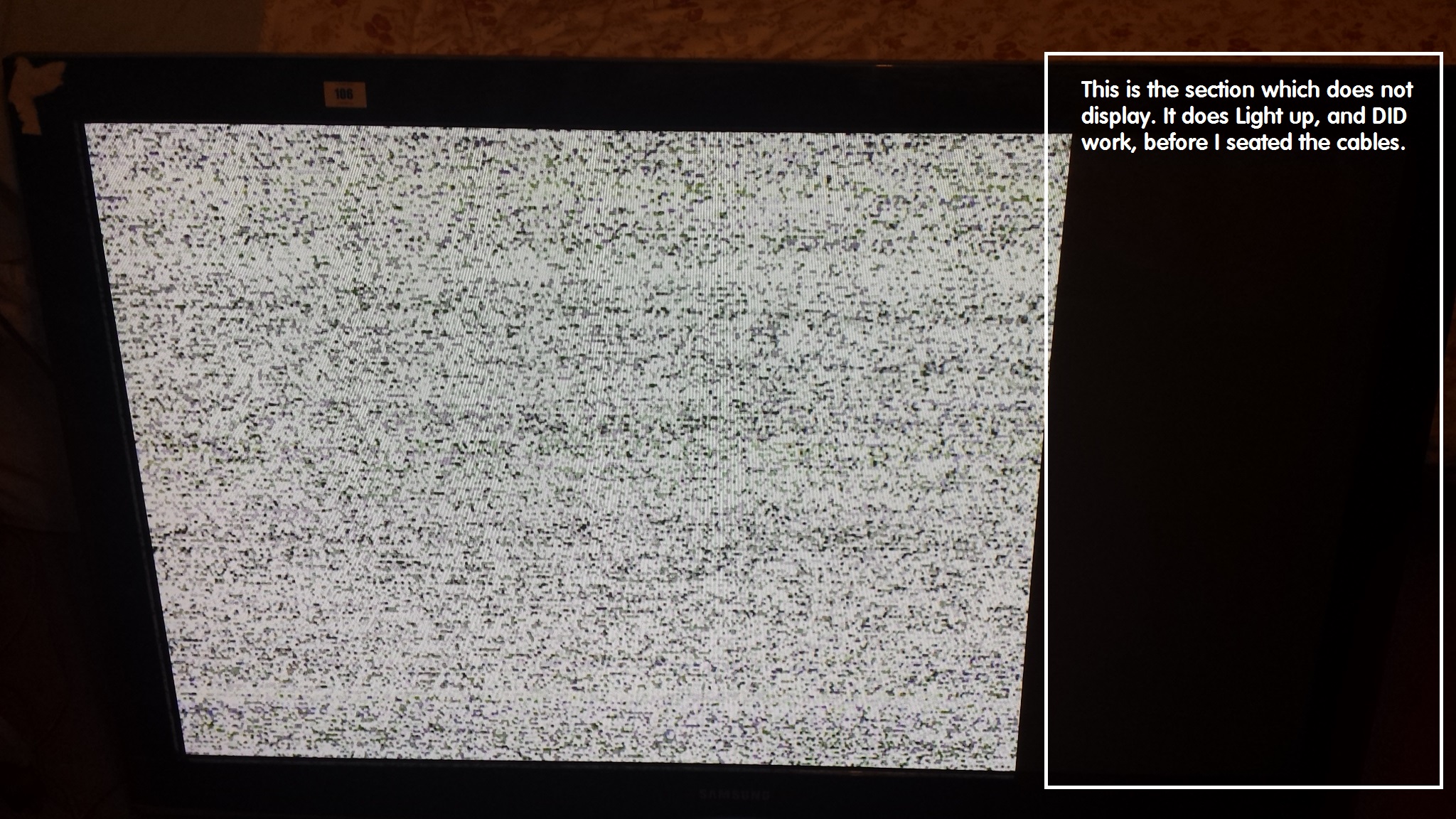

    When I switched it on, it seemed fine, then a series of verticle white lines with a pink line in the middle appeared, just left of centre.
    Did a bit of research, and found it could be a loose cable. I carefuly reseated all the ribbon cables, and fired her up. Lines all gone! BUT! Now, the right hand quarter of the screen no longer works. everything else seems fine. By disconnecting the ribbon cables that leads down to the boards at the bottom, one at a time, then powering up, it shows that the screen itself is getting power on that side and lighting up, it just doesn't get the picture.

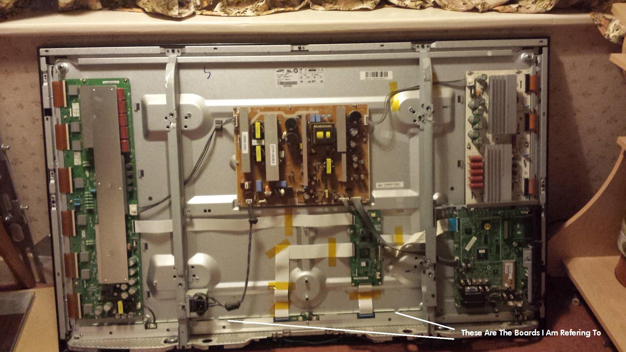

    As I understand it these lower boards are E & F buffer boards , but I dont fully understand if this is what's at fault. Would simply replacing these clear the fault? If so, how do I go about it as I can't find any info on this on the web.

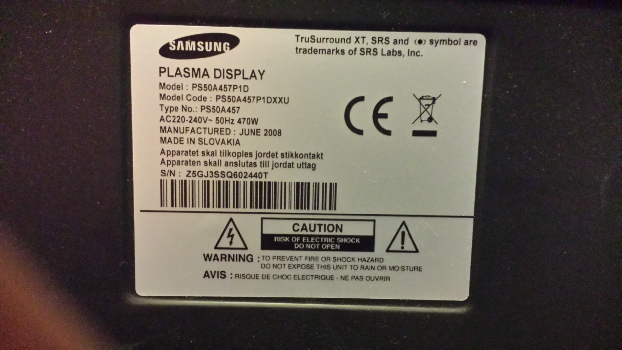

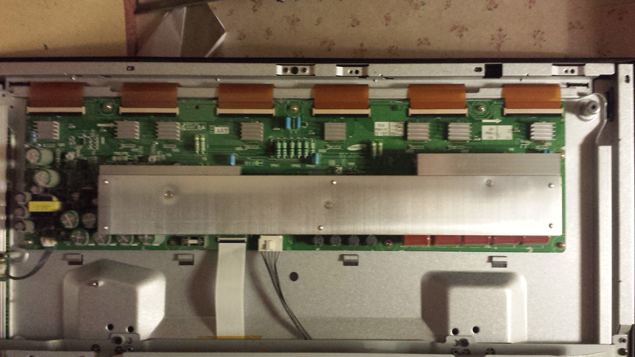

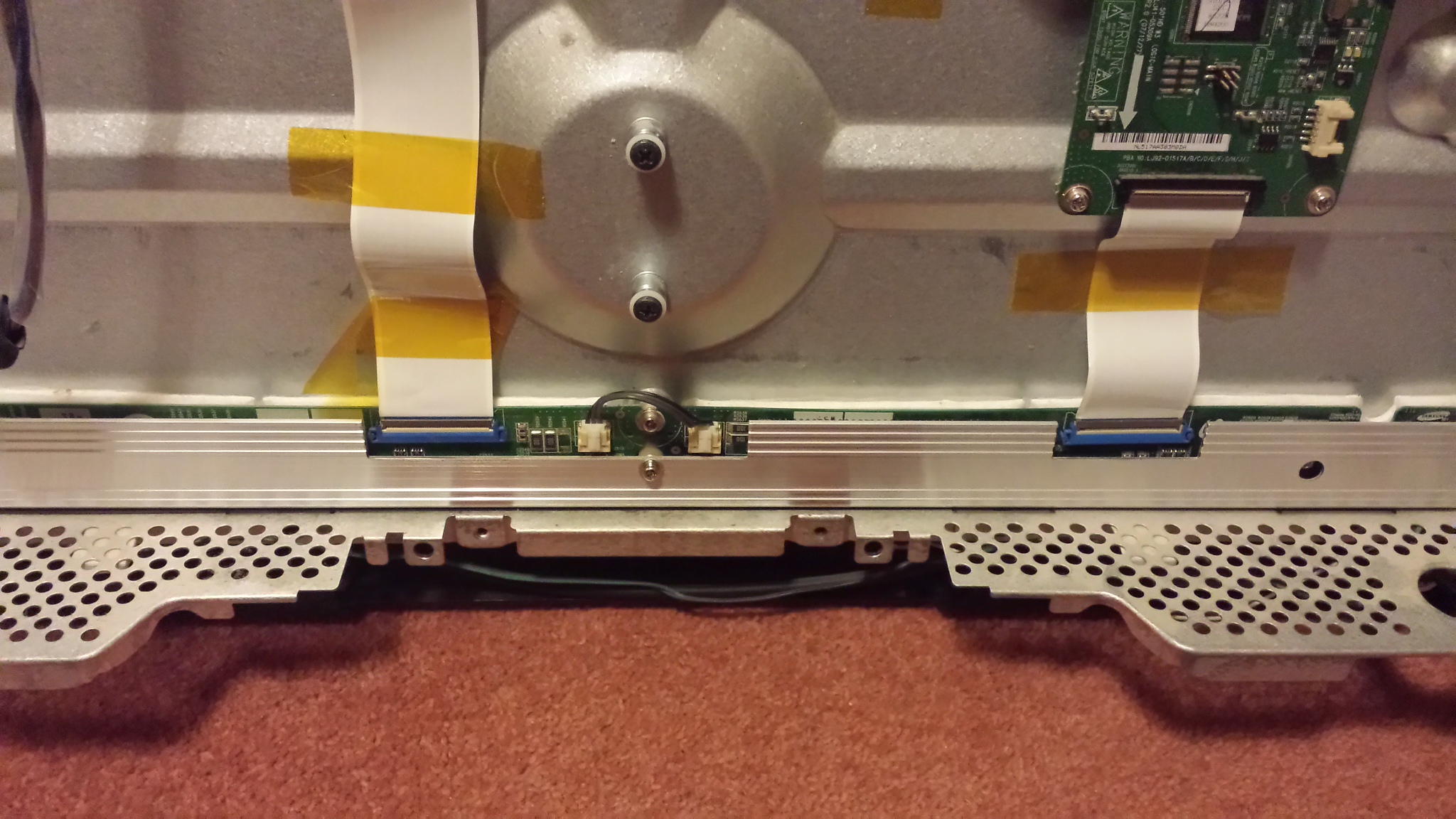

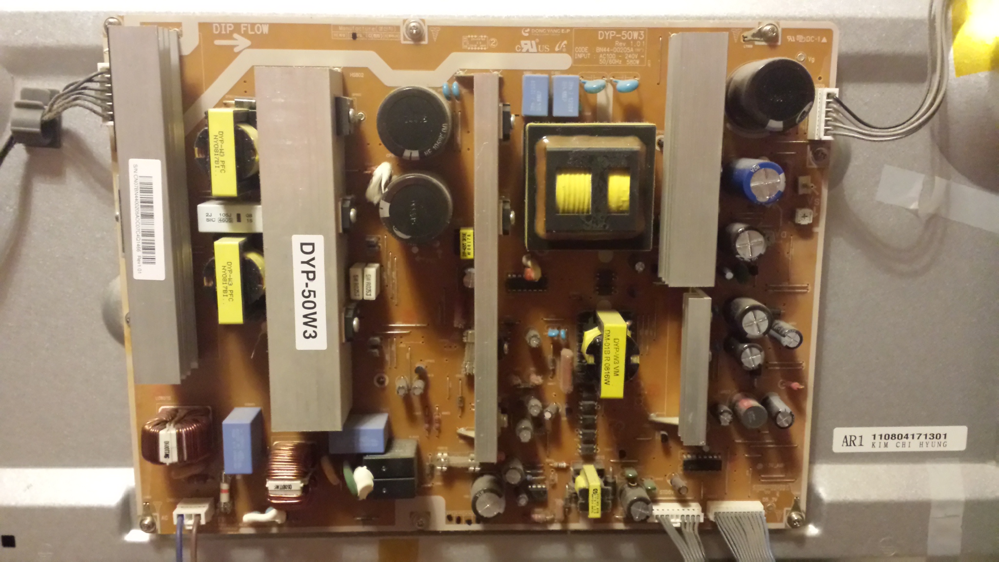

      I have put one up of the front and Rear (with panel off!) and a couple of the other boards. Also the makers panel on the rear panel of the set.

        I would say if the panel is priming on that side you probably have a bad control board or a really bad connection on the ribbon cable. Does a ribbon cable look marred on the connections or torn in any way?

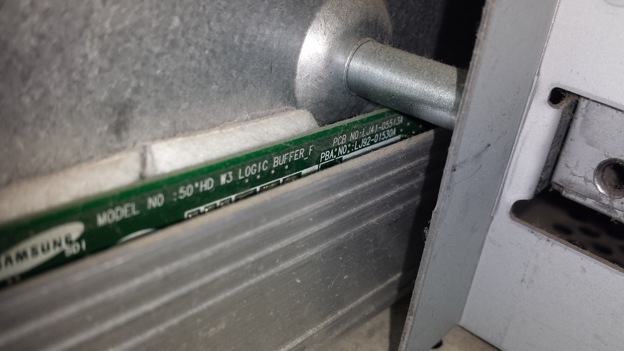

          Re: 1/4 of display missing on Samsung PS-50A457P1D

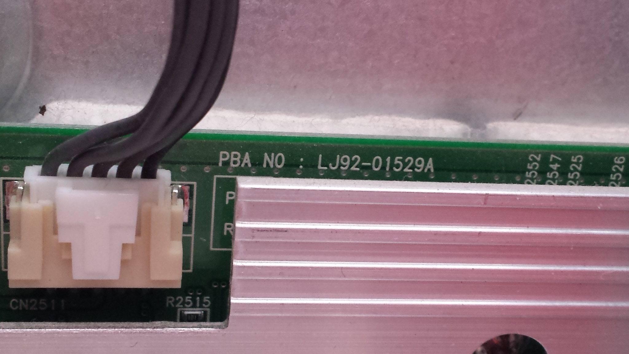

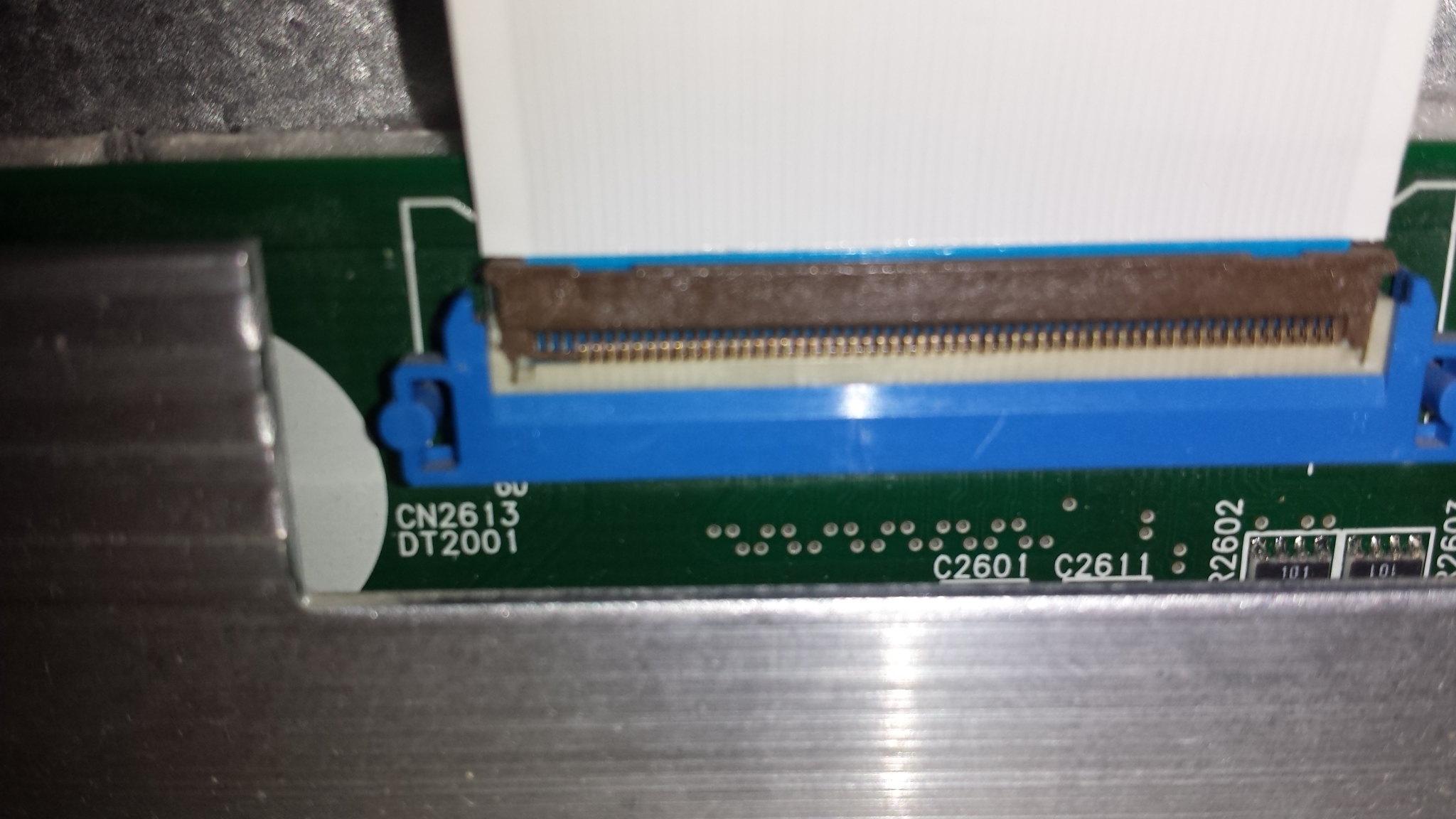

          Ok, following what freakaftr8 suggested, I have re-examined all the ribbon cables I can get to. All the cables seem ok and undamaged. However, as you will see in the one picture attached, there seems to be some pins damaged on the left hand end of the socket of one cable.
          This is the cable that connects the Logic buffer F card to the rest. I compared it to the one on the E board, and as you can see in the pic ( look close, sorry it is a little blurred!) there seem to be three small pins missing. I carefuly removed the cable and got a torch and mag. glass in there. The lower part of the pins are there, it just seems to be the part that protrudes through the brown clamp that is missing.
          Worth noting also that this board is the F board which if you are looking from the screen side is the left hand board. but the missing piece of screen is on the right. (E Board).
          As I said before, bit of a newb to this so I am trying to be as clear as possible, not teach my granny to suck eggs !
          Thanks Guys!
            The fault will line up with the image problem on the screen.
            So--If that plug/ribbon is on the Other side to the displayed fault--It Isnt the problem.
            Check the ribbons/COF Chips immediately Under the displayed faulty image area on the screen--Thats where the fault will be.

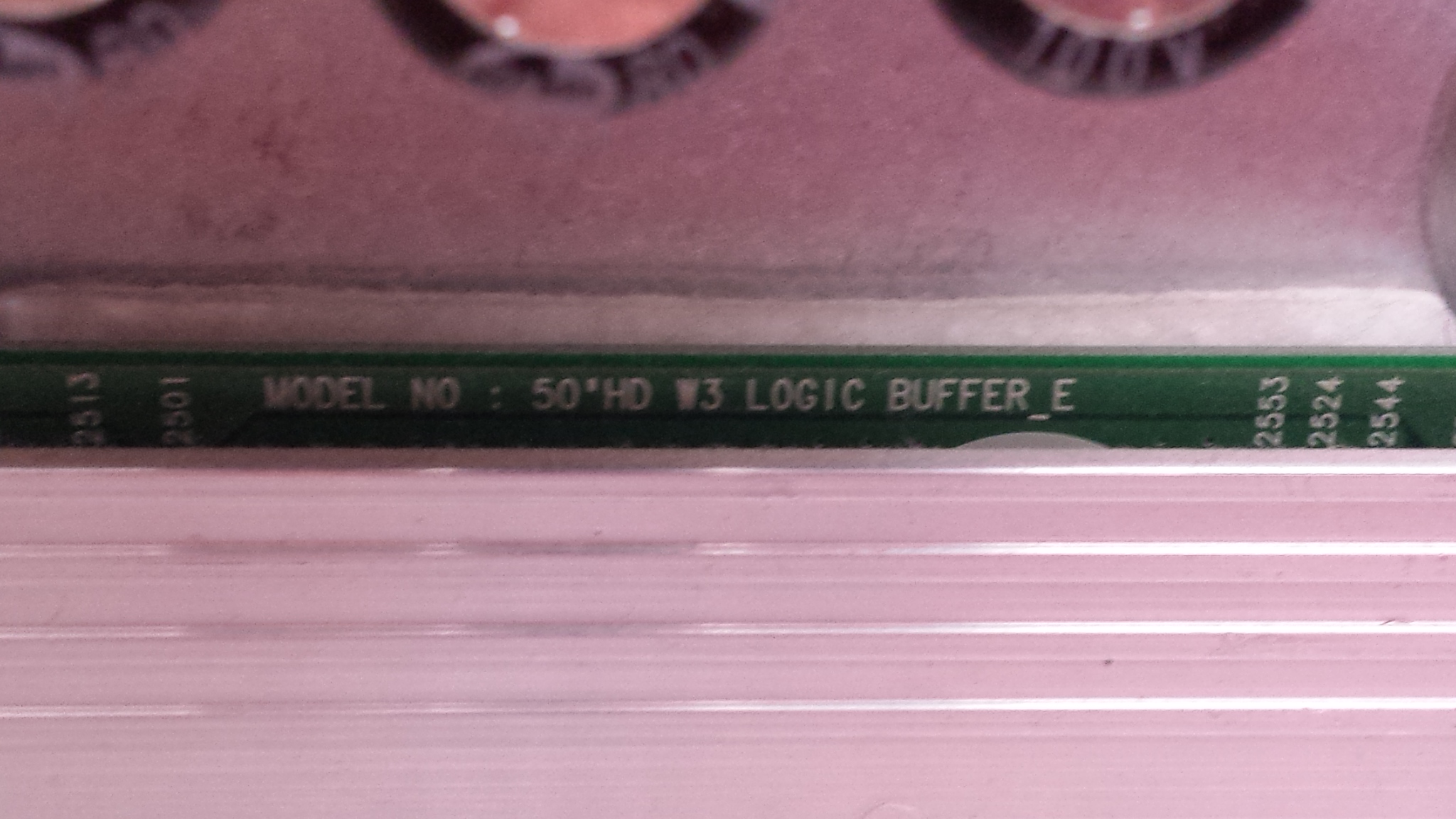

              Thats what I thought Alistair. The E buffer board was my guess. How to get to it is the next thing! The conection at the top seems ok, but I believe there are a series of cables at the bottom. Didn't touch these originaly as they are hard to get to. Oh well, out with the screwdriver again!

                            The control board is worth a shot. Only because you mentioned that the panel is priming in the dead area. If it lights up in the dead area I believe there is hope.

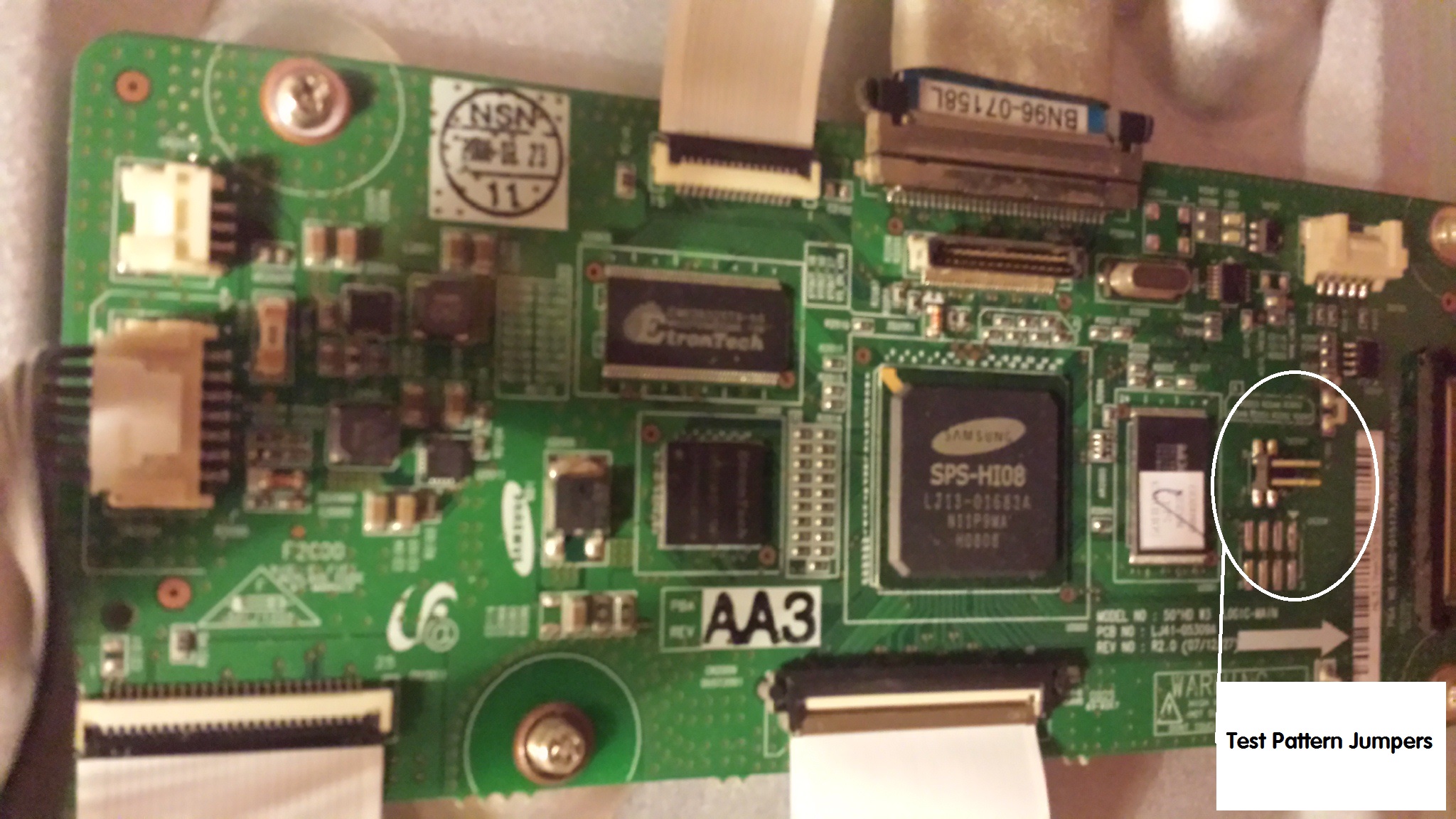

                                  Good call sordis999! OK bigted01 on your old control board you should see a block of jumper pins. First disconnect the LVDS cable going from main board to control board. Then after that's done first find a jumper or anything you can short pins 3 and 4 together and power up TV. what you should see is a random picture of different colors coming up flashing between red green blue white and others. Is the whole screen there?

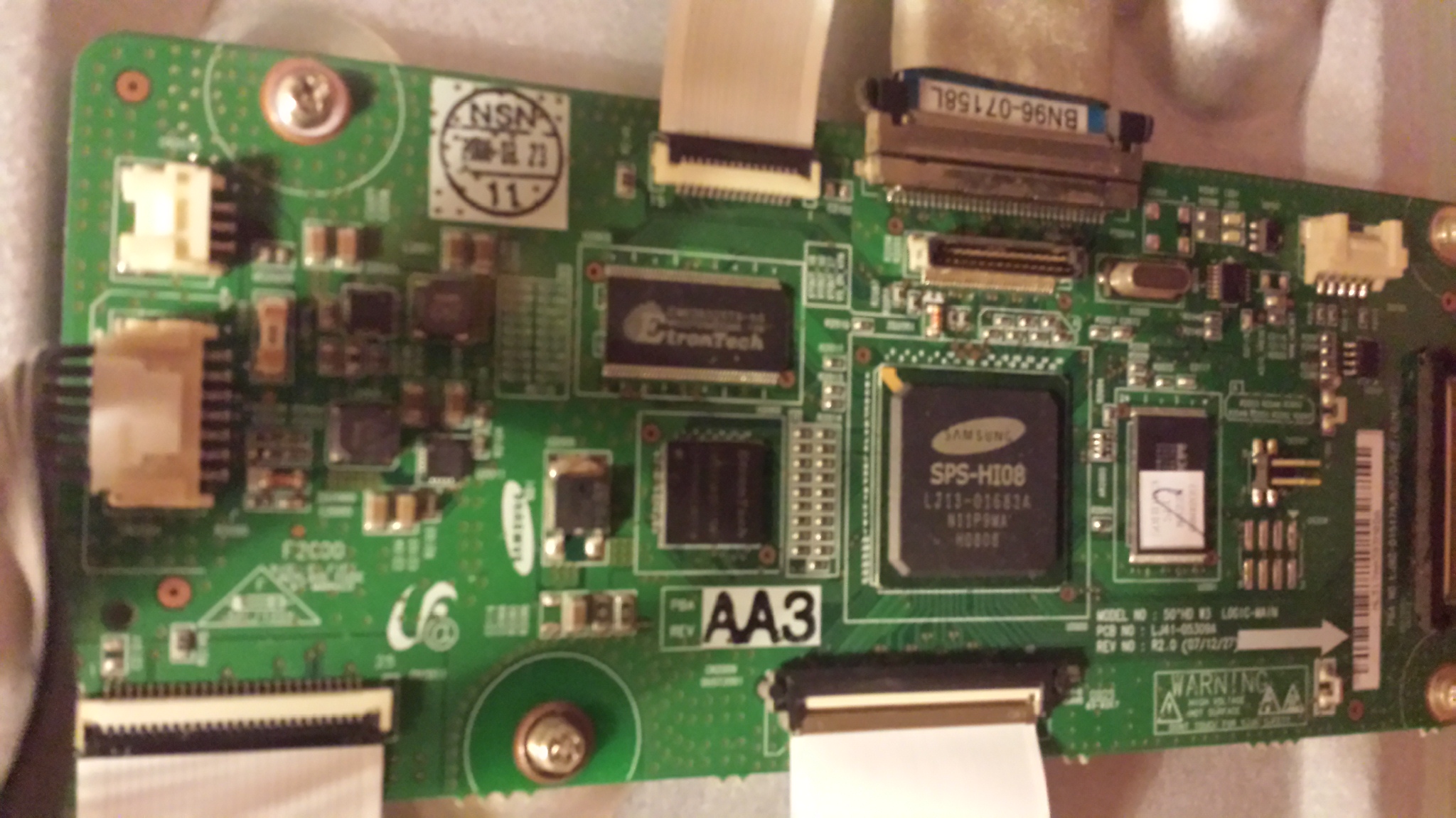

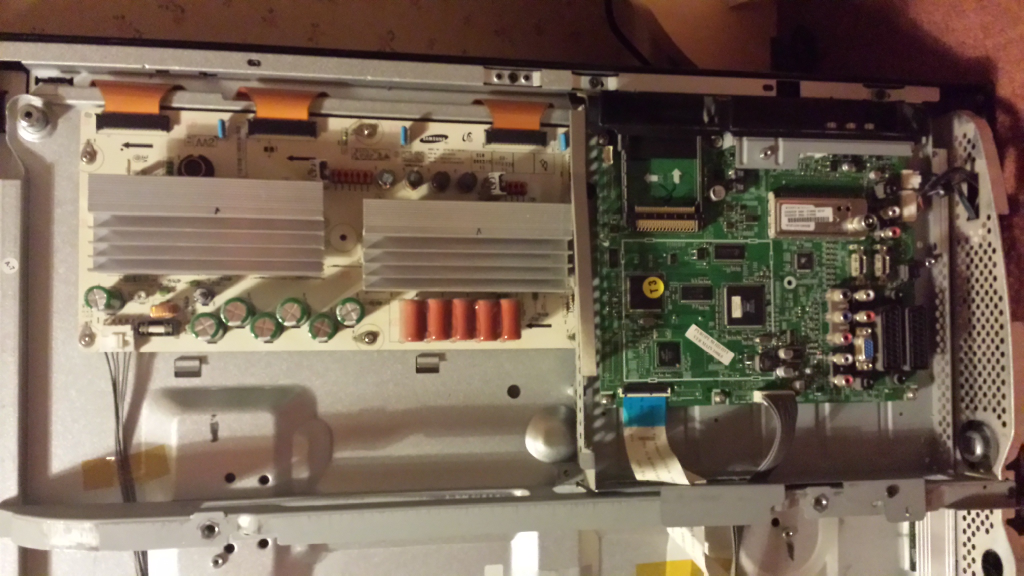

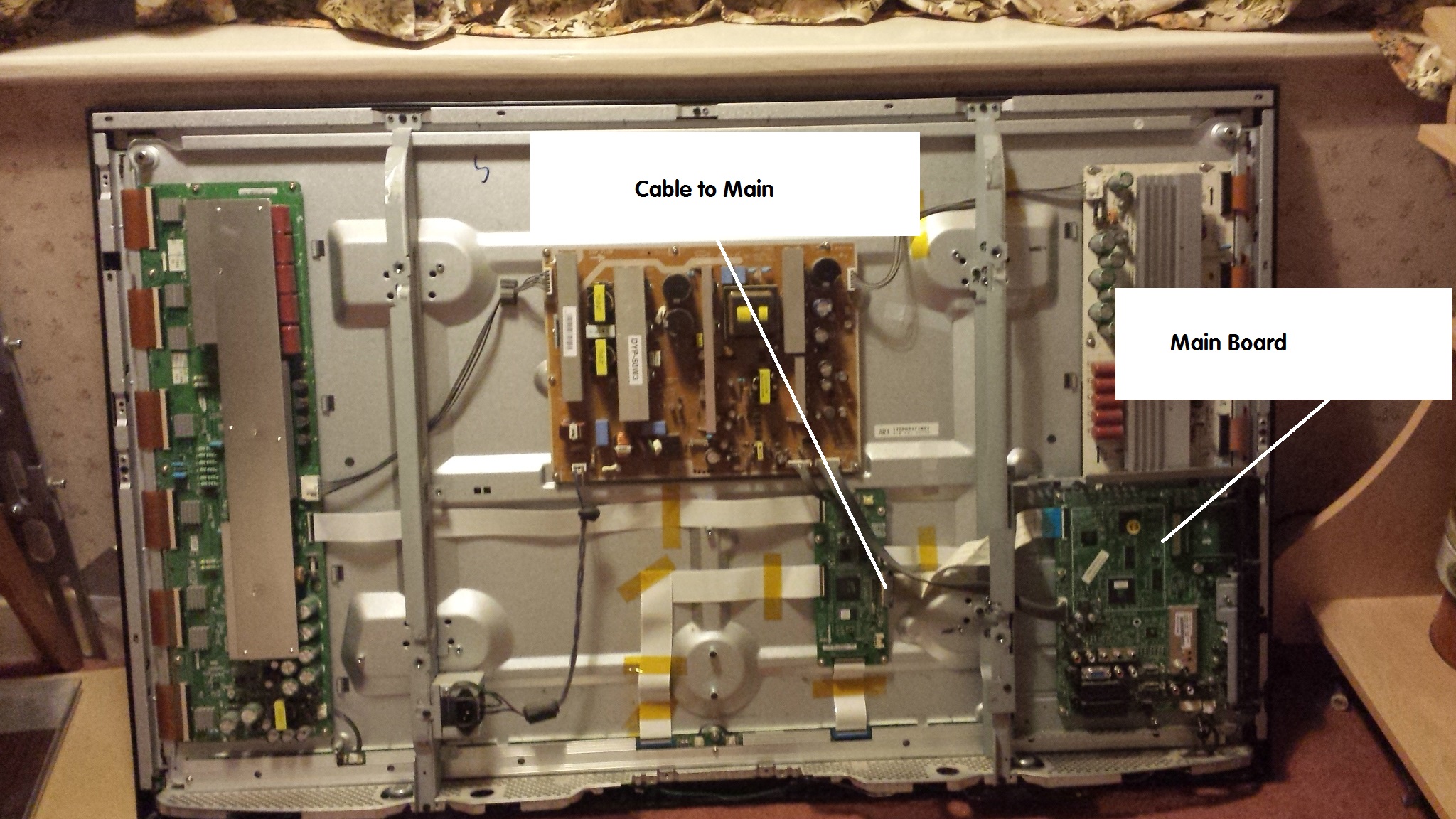

                                    Right Then. Before I go ahead and blow everything to bits!
                                    Have attached a couple of pics to be sure I am looking at the correct bits!
                                    Thanks for being patient guys!
                                      Looks good to me... assuming "cable to main" means that flat white one going between the two boards all is good to try it.
                                        Correct you should hopefully get test patterns
