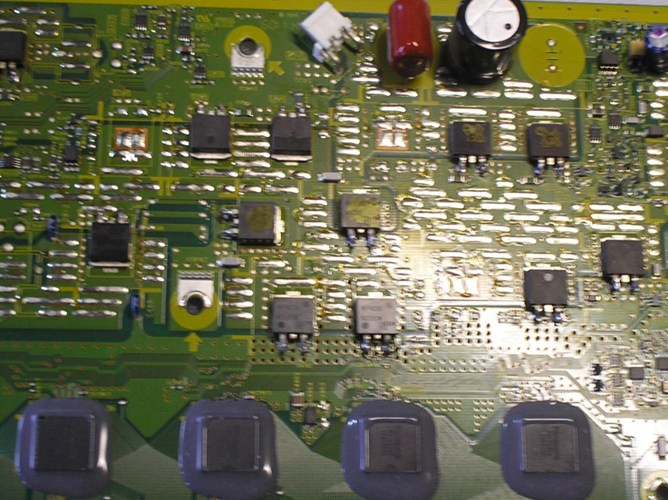

    I have a Panasonic TX-P42S30B that has shorted SN board TNPA5349 fitted. And was hoping for the normally shorted Q401/Q402/ect fault But after lifting all the legs on all the components It still testing S/c on SN2,testing shows short between C+E on Q661 and short all three legs on Q662 the rest test good? so started to check Buffer ICs and found IC 4803 showing shorts all over . so here`s my problem, I am looking for some one to replace this IC for me. My eyes are not what they were I can supply the IC just need it fitted so if there is anyone in the UK that could help an old man out with this please message me Thanks Flocko

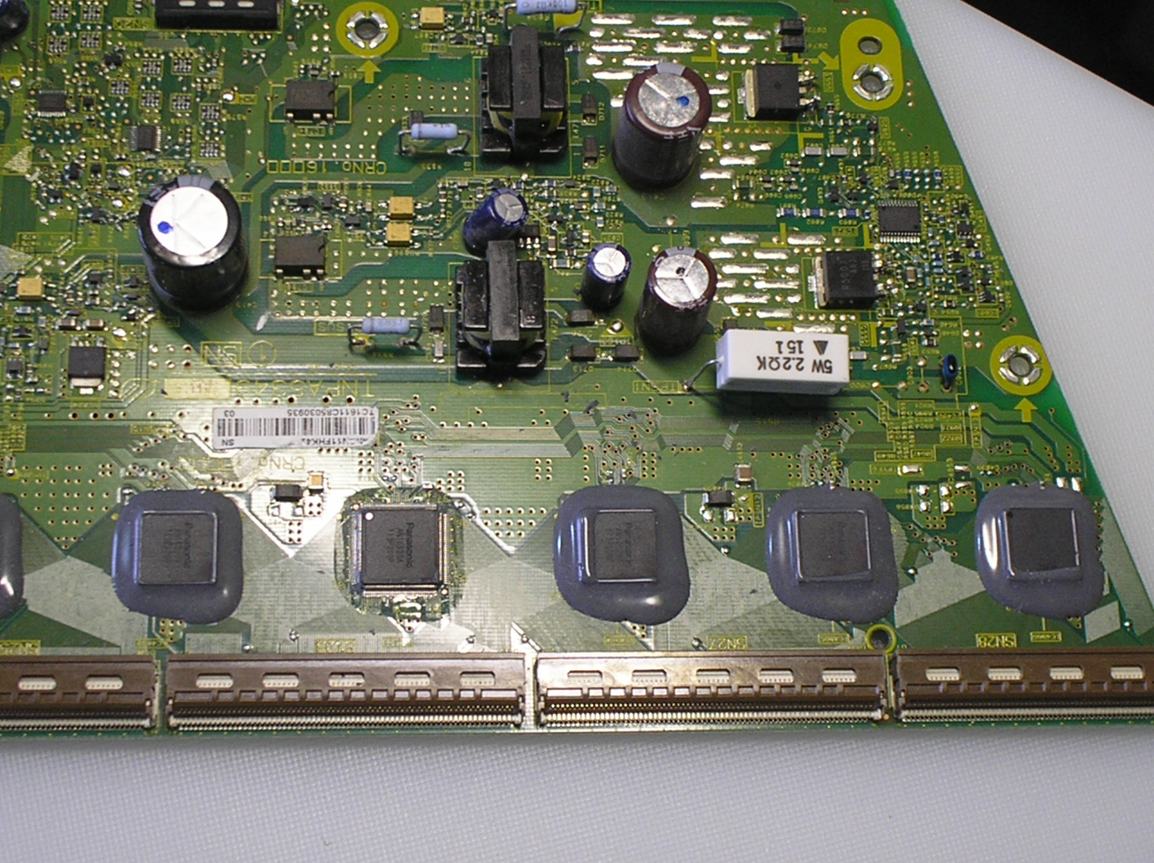

          With those panasonic buffers, those Ics have that grey sealant which also has heatsinking properties under the chip and it sticks very,very well. i tried and failed on a bad board, I think the trick is to completely remove every trace of it from the pins, maybe carefully cut the legs hard against the ic.
          desolder the pins, then grip and twist that ic free.
          but I failed so better advice may be out there on this. not sure how many have tried yet on a panasonic board

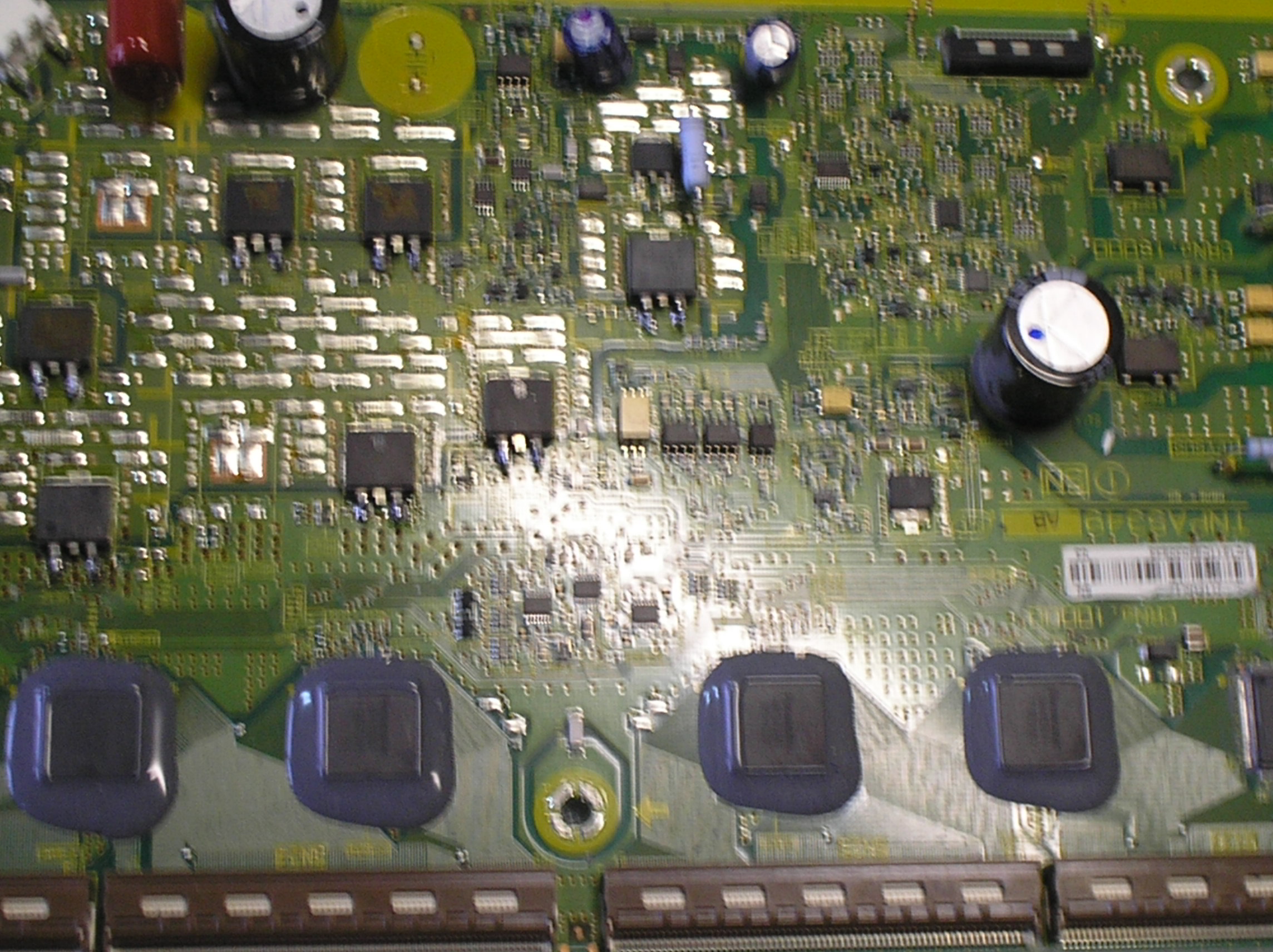

            Hi Tom if you read through you will see that Q661+Q662 are shorted but that is all apart from the buffer IC, I had lifted the legs on all 17 devices on the board and SN2 was still showing short, that lead me to the buffer IC4803 short, my Question to TW was did he think the set would power on with one missing buffer and Q661/662 replaced? Flocko
              Re: TNPA5349 Buffer replacement
              You still wouldn't get short on SN2 if buffer ICs were bad... something else is shorted. The ICs can't short to ground, only to their own floating ground, which would only cause Vscan/-Vad to drop out (causing a 7 blink SOS)
              The set may work with a missing IC but any other ICs that chain data off of it will be blank. So if it's the top most or bottom most IC it might not work. If it's in the middle it might work.

                  the IC is showing shorts to ground that is how I found it , if I run my meter in continuity over the tab sockets and board ground this one rings out and after removing the silicon from it most pins are short to ground? all other tabs are clear

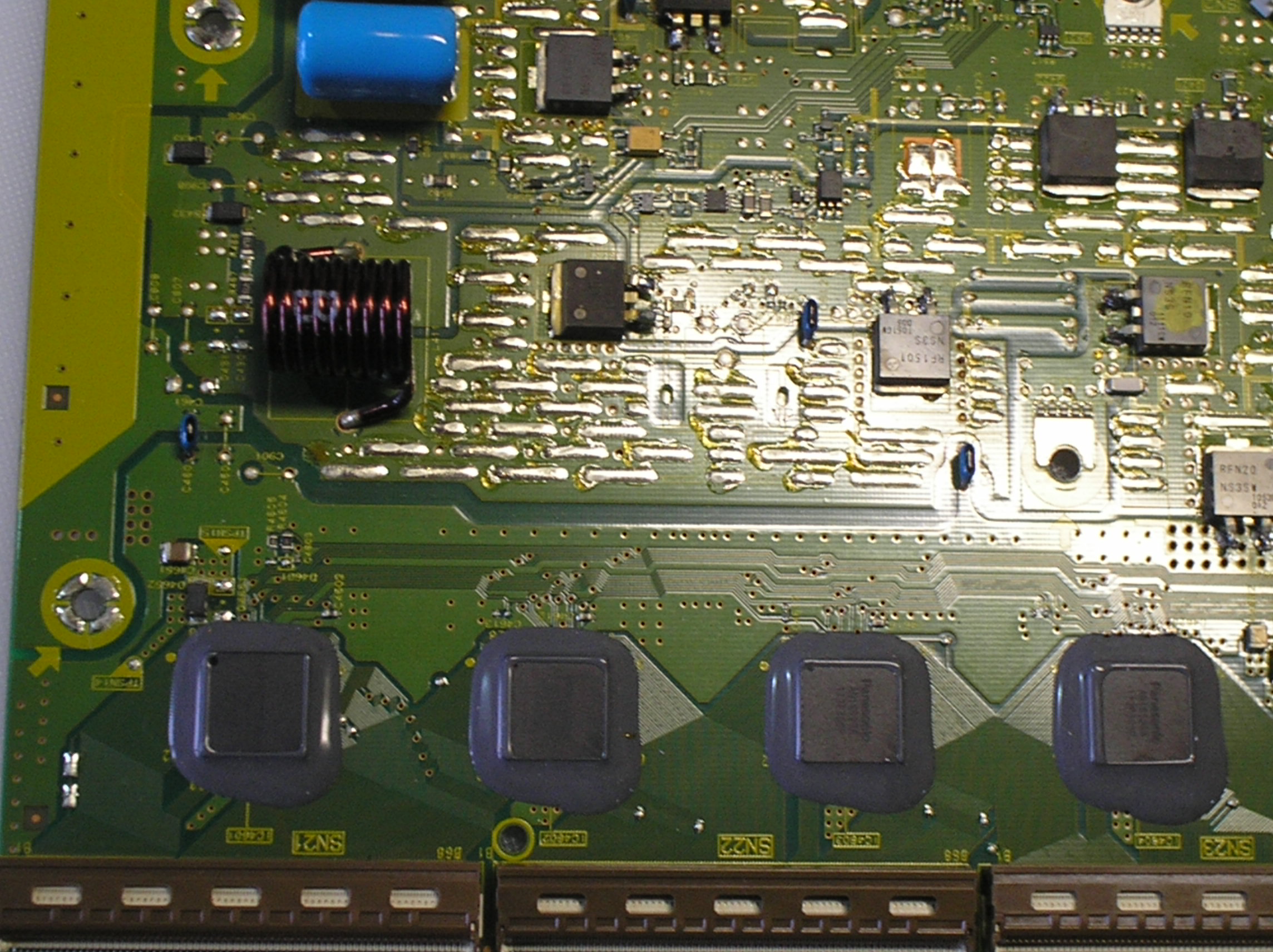

                    You would need to test to floating ground. Can you get a photo of the SN board?
                    Due to the internal parasitic diode structures, shorts to actual (cold-earth) ground aren't necessarily bad...
                    If they are bad, it indicates something else on the SN side is still short, besides the IC.
                    The ICs themselves have -no- direct electrical connection to ground, they are floating -190V (-Vad) below ground and the outputs can switch between -Vad and up to -Vad + Vscan in normal operation.
                    So that in itself, indicates that -Vad or Vscan is shorted somewhere to ground (not the buffer IC)

                      with all legs lifted on diodes + IGBT from board the SN2 shows 13.9 ohms across the socket, I only get buzz from meter when set to continuity? shows nothing in diode or 200ohms mode between tab and ground and only on this buffer IC. but have had this before ,the last time when the buffer was removed so was the short
                        So you've isolated every transistor and still getting 13 ohms?
                        Try isolating the big white 2.2ohm 5W resistor, from memory that's the Vscan source for the buffer ICs, would eliminate a potential short from there.
                        I've never seen this before, really odd, perhaps a small little diode is shorted somewhere.

                          Tom GTV sell the chip on eBay and in there add they say top buffer is the normal one to go (heat)and goes s/c, and tested should read 800ohm one way and o/s the other ? bad buffer will read s/c.i can only think they mean to read across the diodes by the side of the IC? if you look I have cut and re joined the resistor not that on my meter reads 2.37 ohm

                                I have now started to go round checking on the pads were the legs have been lifted on the diodes + IGBTs to see if any show shorted there was a small Fet Q600 that I had missed but there is no short on that. I will also pull the 2 cap from across SN2 socket as well do you think that I am right about the test across the diodes by the buffers as these show short?
                                • flocko
                                  • Nov 2012
                                  • 1121
                                  • uk
                                  After checking the pads no shorts found, But now think the anodes on D461/462 (RFN20) are the floating ground for the buffers as if you diode test from here to tab connectors you get IC 4803 showing short in diode mode and 200ohm ? only way to see if this the short at SN2 is to take buffer from board will get on to that tomorrow afternoon.
