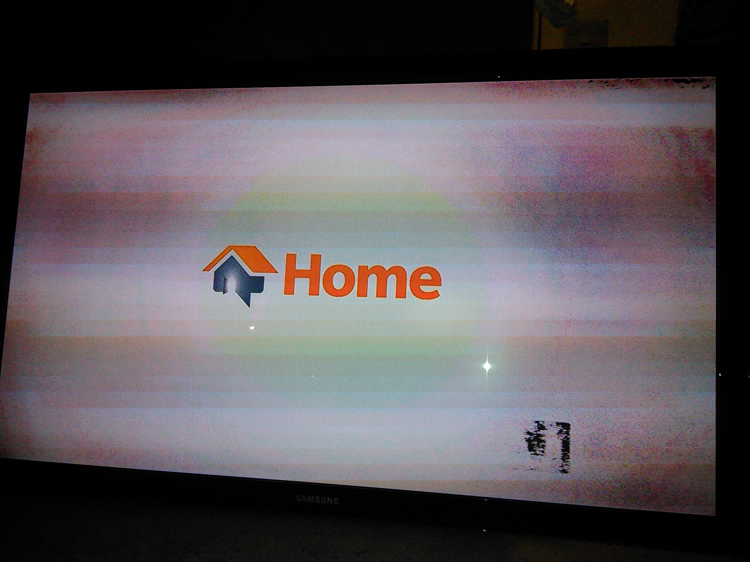

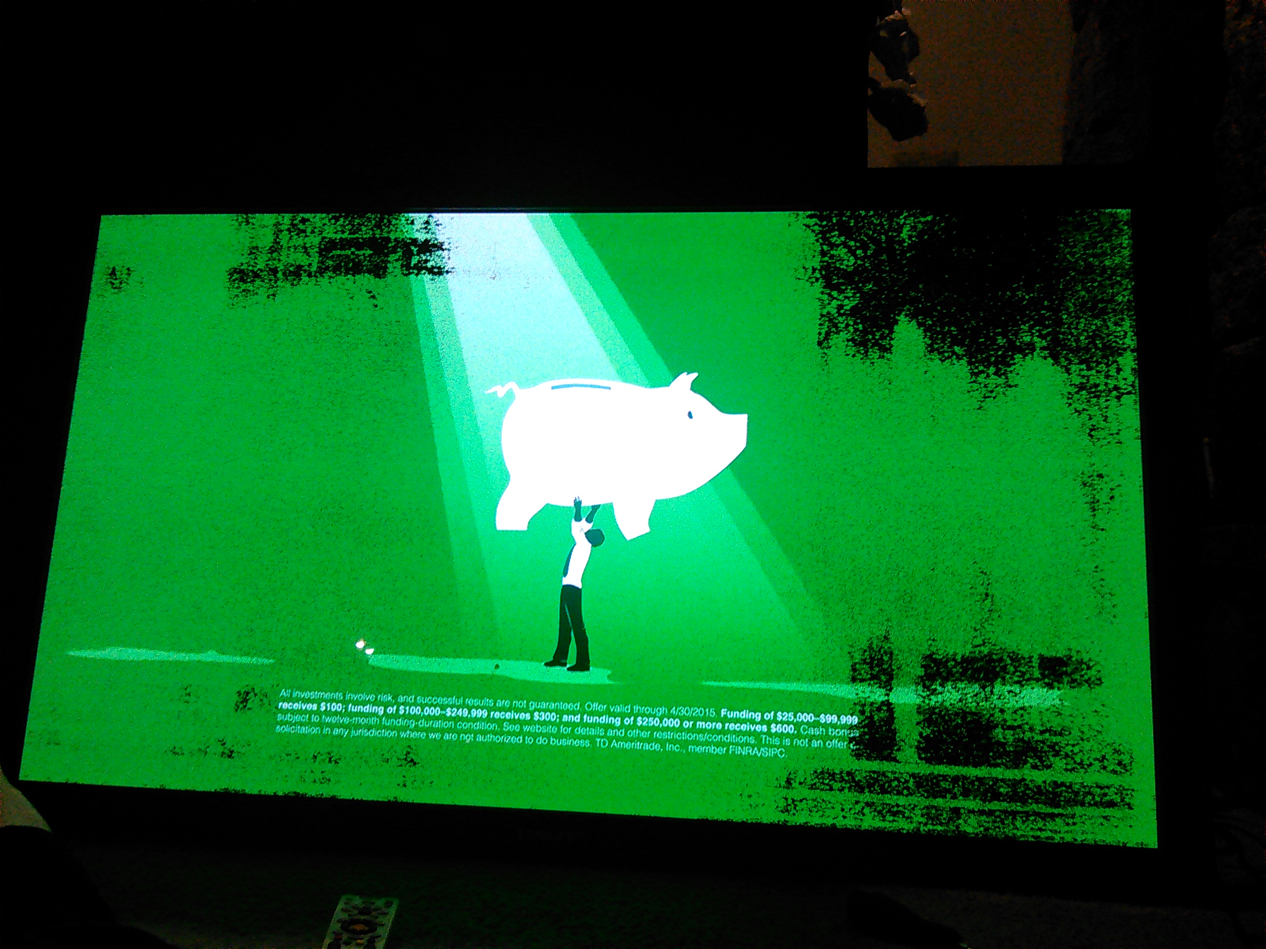

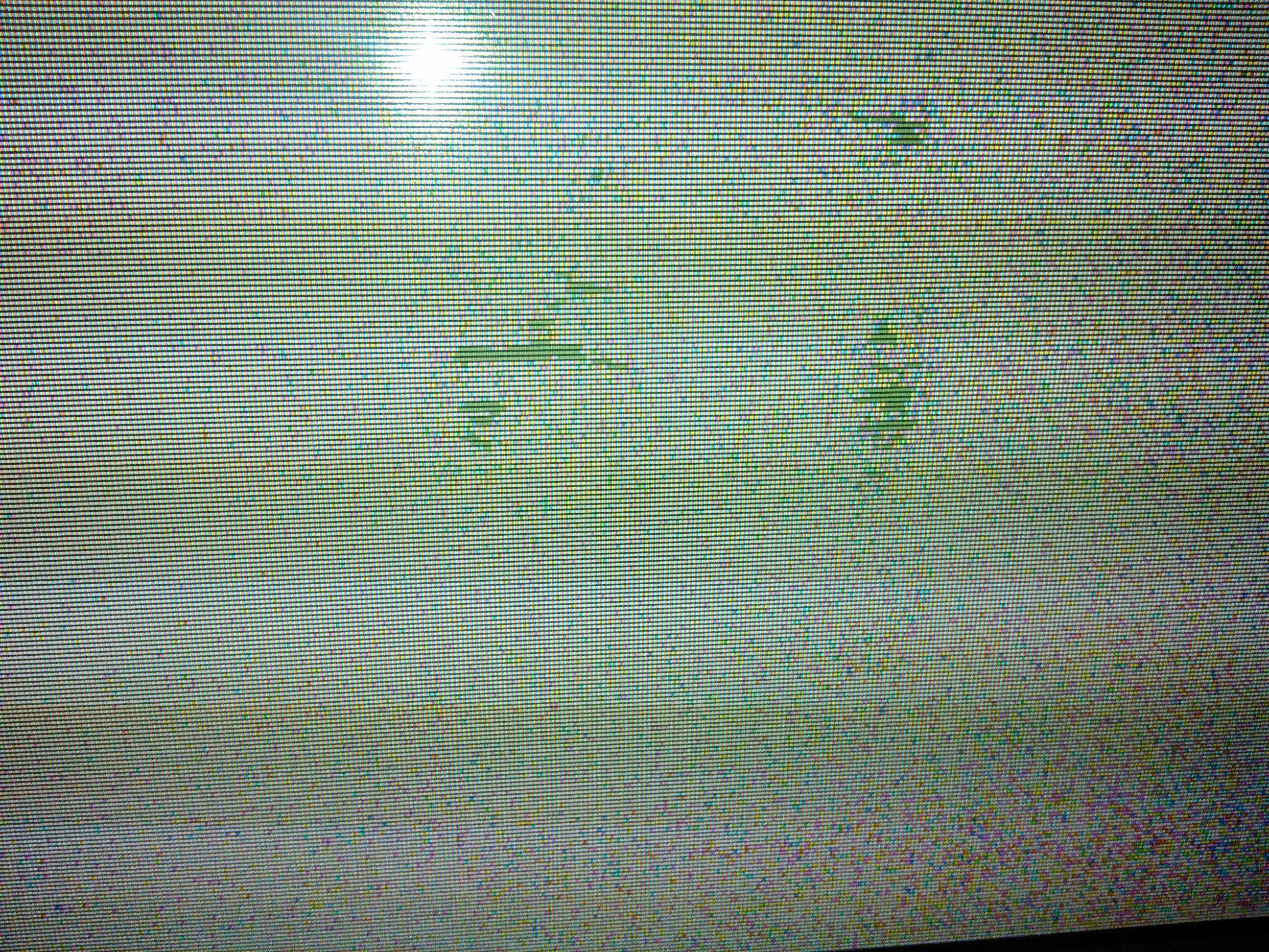

    this ones throwing me for a loop. The guy picked it up from said all the screen became a little dark in areas And it had a lot of pixelation so I had to go check it out. Ended up picking it up and I brought it home what happens is that it has a lot of black areas in a lot of pixelation kind of Like a bad zsus. all voltages check with its Spec including Vscan. oddly the panel has a label for ve but I cannot find ve on the Z sustain board. so far there watching this TV and I noticed that after a little bit of time the picture starts to clear up the black blotches start to disappear however they don't completely go away. On a full white screen with lettering I see a lot of horizontal purple banding and flickering. Now I have done some research on the internet and noticed that these c-series and b-series 58 inch plasmas from 2010 are known for having bad panels? Well I went ahead and cranked up VS from its original 210 to maximum that the power supply can output about 218. Pictures almost perfect a little black dIthering and some green and red mal discharge . I was able to take care of by turning vscan from its original - 200 -203. so all is well now except for the fact that I'm a little concerned about the higher vs. Voltage but as soon as I went into the menu and started playing around with the picture modes of course it was set in dynamic if I go to movie mode the screen completely starts losing its picture almost as if I unplugged the z sustain. but if its in standard or dynamic the picture seems decent it's still not perfect but a lot better. Now if I put it in 3d its all messed up a lot of green dithering lot of green mal discharge sparkles and some green vertical lines all through the screen. So does this sound like a panel ? Losing it is possibly? I noticed Y & Z sustain boards are relatively cheap for this TV however I have not pulled the boards to find out if there's any bad components but since they're working I would only assume that they're doing their job including especially since all voltages seem to be present and accounted for. I have not heard of Samsung's having bad panels like this have you?

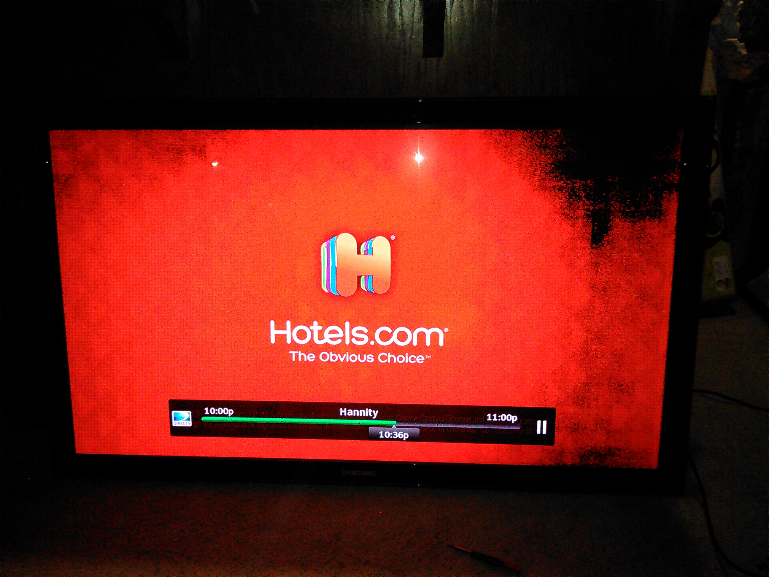

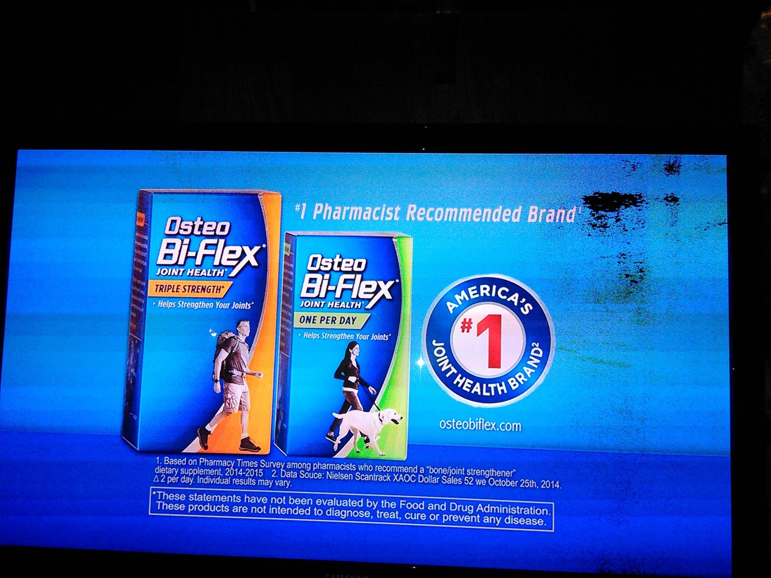

    Here are pics. all of these were taken before voltage adjustments.

      Looks like an X-main (Z-sus) failure; a lot of panels will work nearly good enough with a missing Ve-bias period, which I think is what you are seeing.
      Note, some Samsung panels use Vb instead of Ve. Same voltage.

          I second what tom66 said, when you ran the test patterns did you see the same ink looking blobs?
          When I started on my 60pv450 I was seeing this almost exact same thing and I replaced the xmain and all was restored.

            @freak if you've got a scope going spare you can check X-main output and see if it's bad or if the panel is bad (I think 99% x-main here... I can't really see a panel do this if bad.)

                        What's happening is as the panel ages, the driver board is failing to compensate for panel changes. Increasing the Vs hides this (and should fix it, as the panels "settle in" to a point.) Samsung set the Vs low to start with to save energy.
                        The reason you get pink tints on bright images is because the electrode resistance drops the sustain voltage on each cell below the threshold for the blue cells to discharge fully.
                        Plasma panels don't need regassing and they should last much longer than 6,500 hours... Only if they actually are really worn out (like 50,000+ hours) do they start giving real issues.
