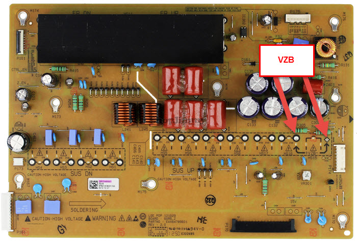

    It sounds like it could be a ZSus issue. You'll need to start by checking for the standard voltages - there should be labeled test points on each of the boards:
    (1) PSU: VS and VA
    (2) YSus: -Vy and VSCAN
    (3) ZSus: VZB
    Please post clear pics of the circuit board layout if you need further guidance.

        It doesn't sound like you took the readings correctly.
        VZB should be taken by simultaneously placing the negative probe on the negative test point and the positive probe on the positive test point, not using the chassis as ground.
        The VSC reading on the YSus is taken in the same manner as VZB. Can you take a picture of the -Vy test point on the YSus?

              I think you're misunderstanding. VZB is a test point on the Z-sustain, and it's usually marked across a resistor on the Z-sus board. Similarly, -VY and VSC are also marked on the Y-sustain. They are not the labels next to the connector coming from the control board.

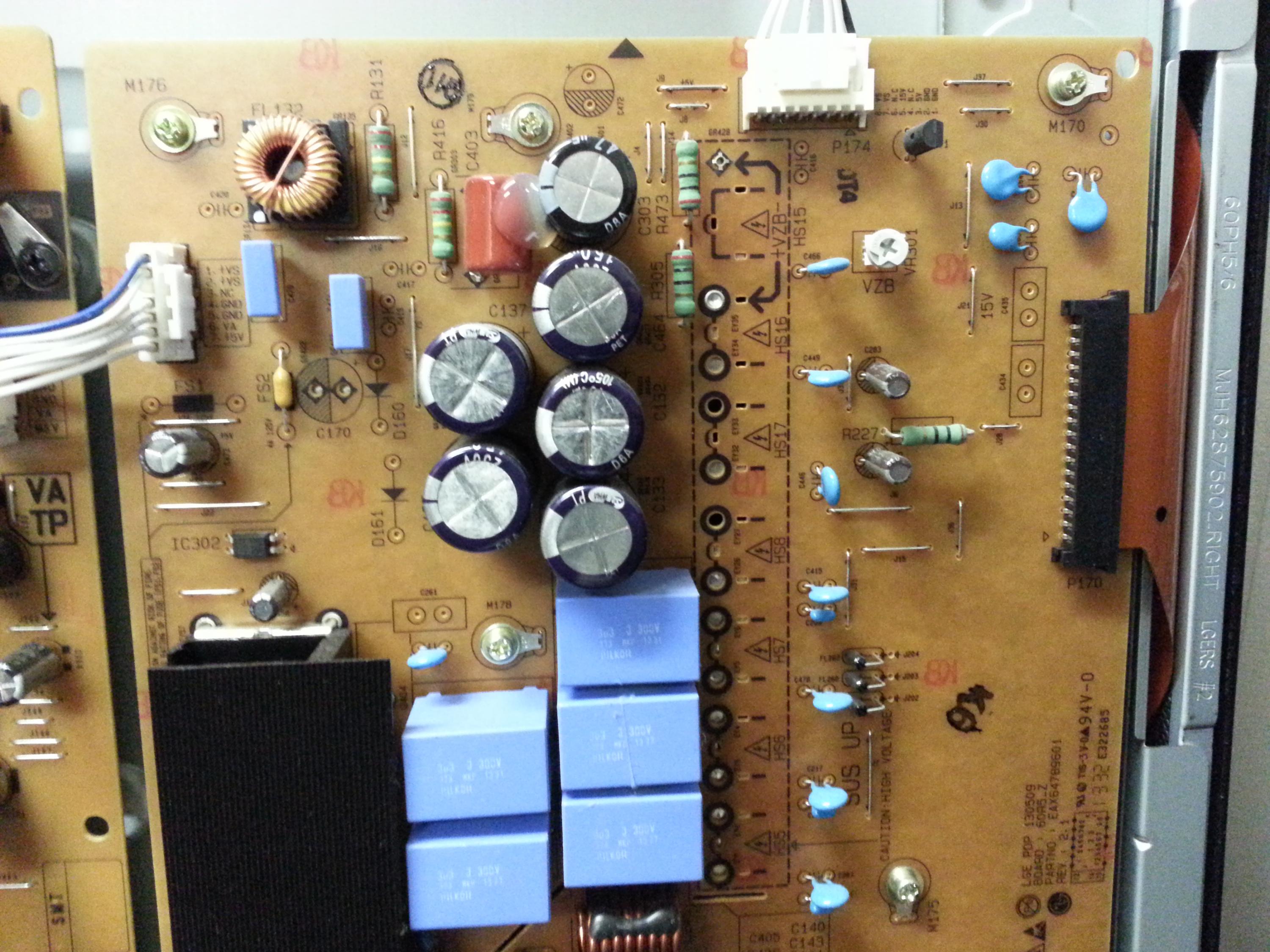

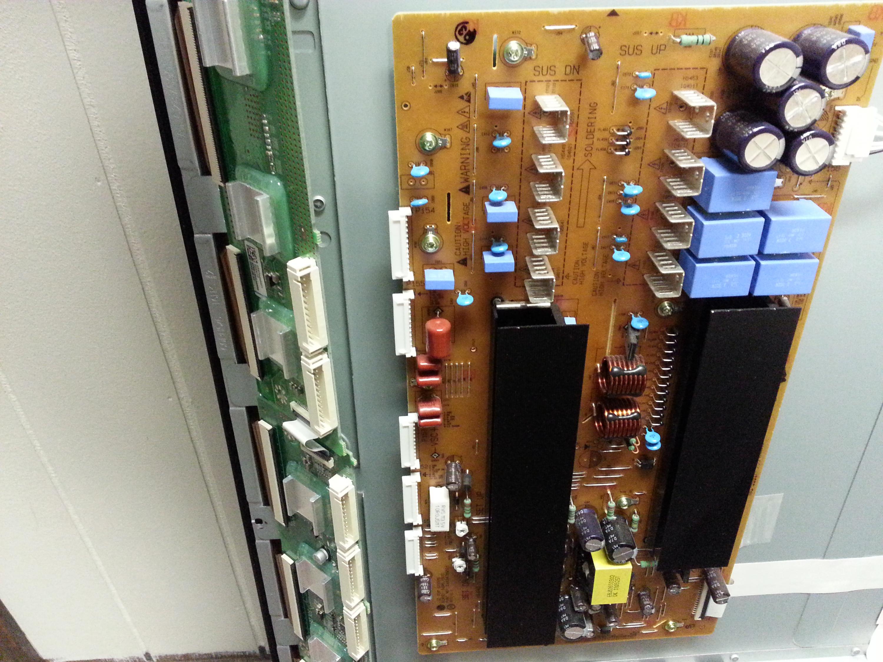

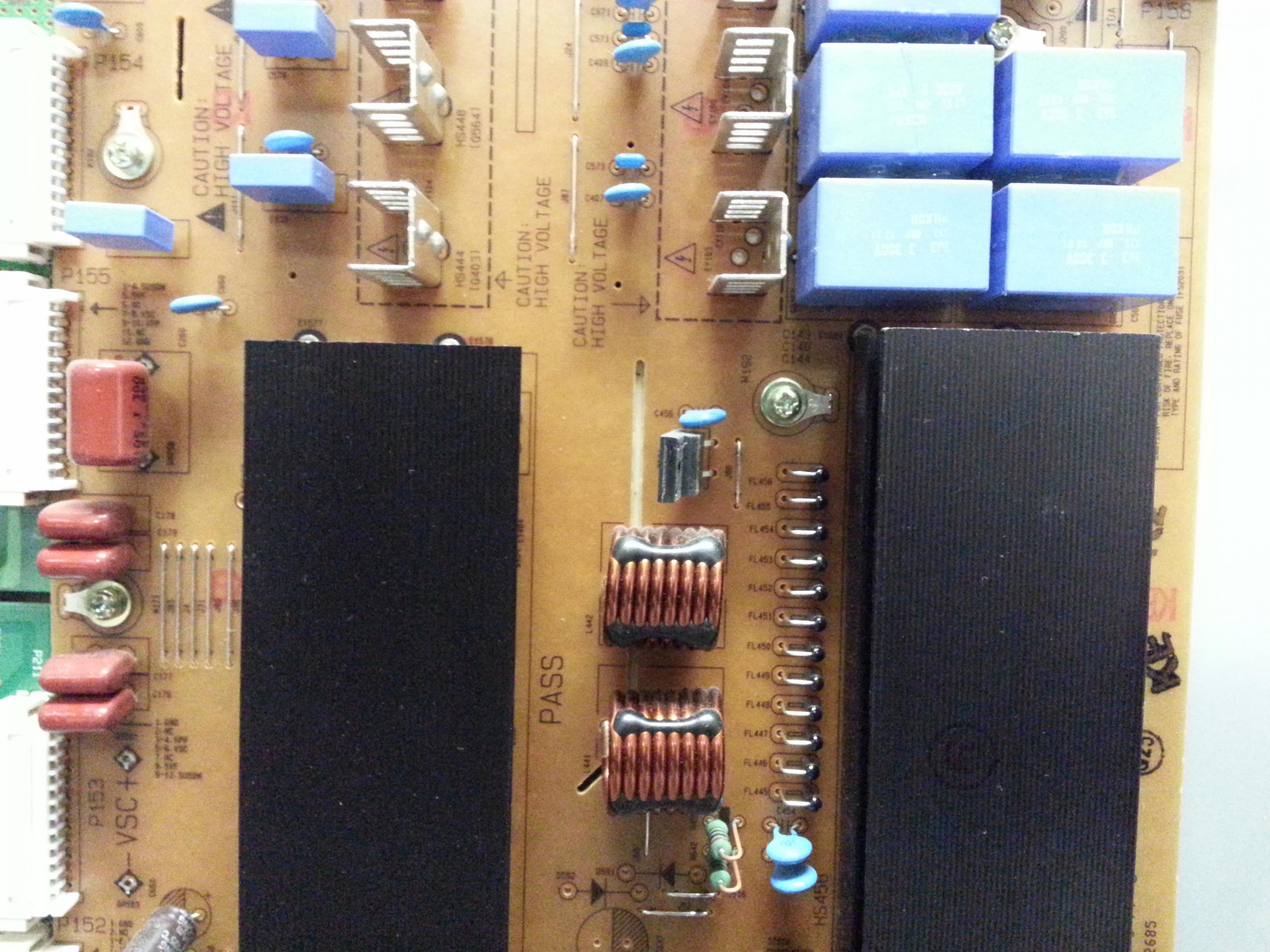

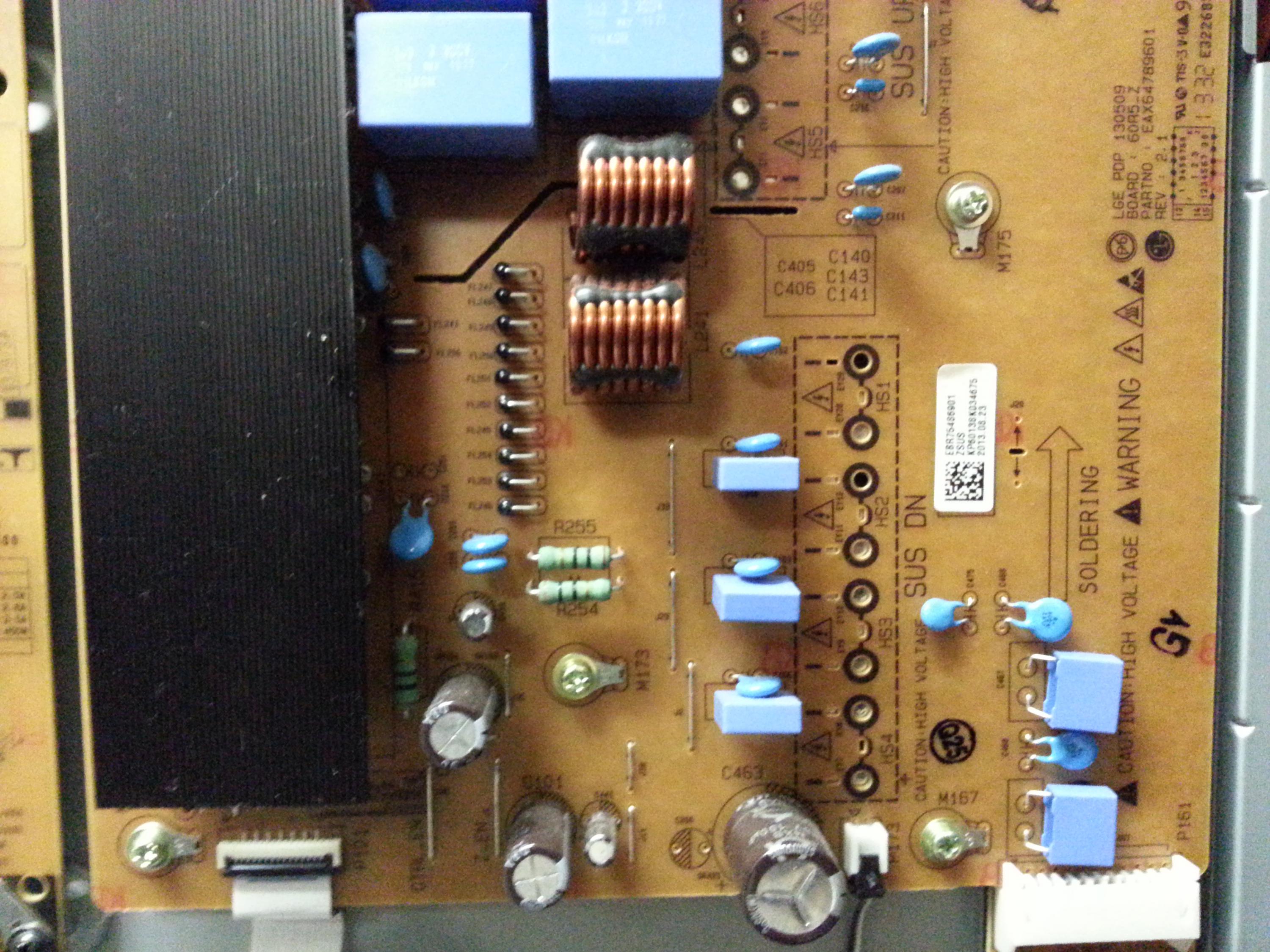

                  The board

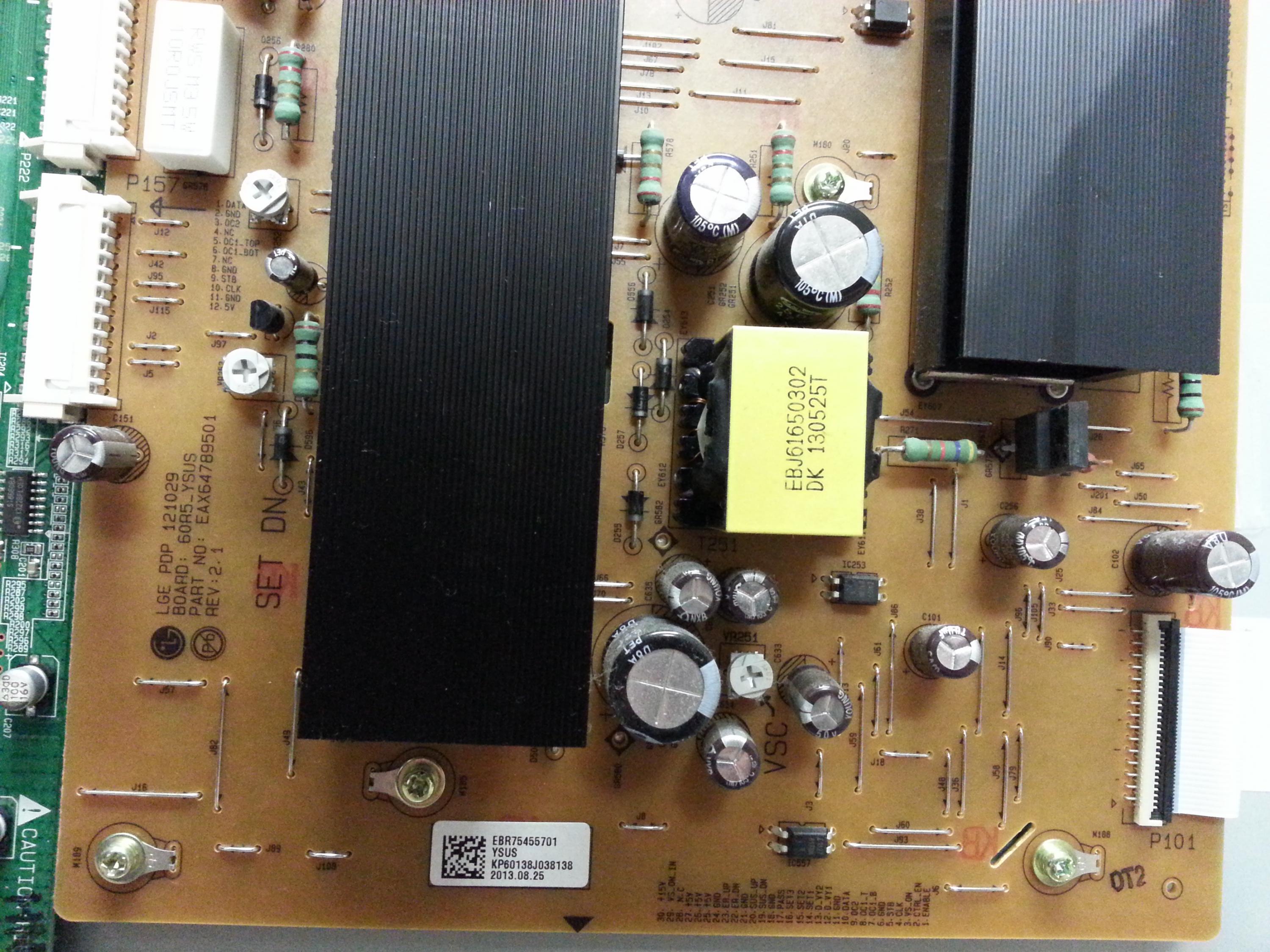

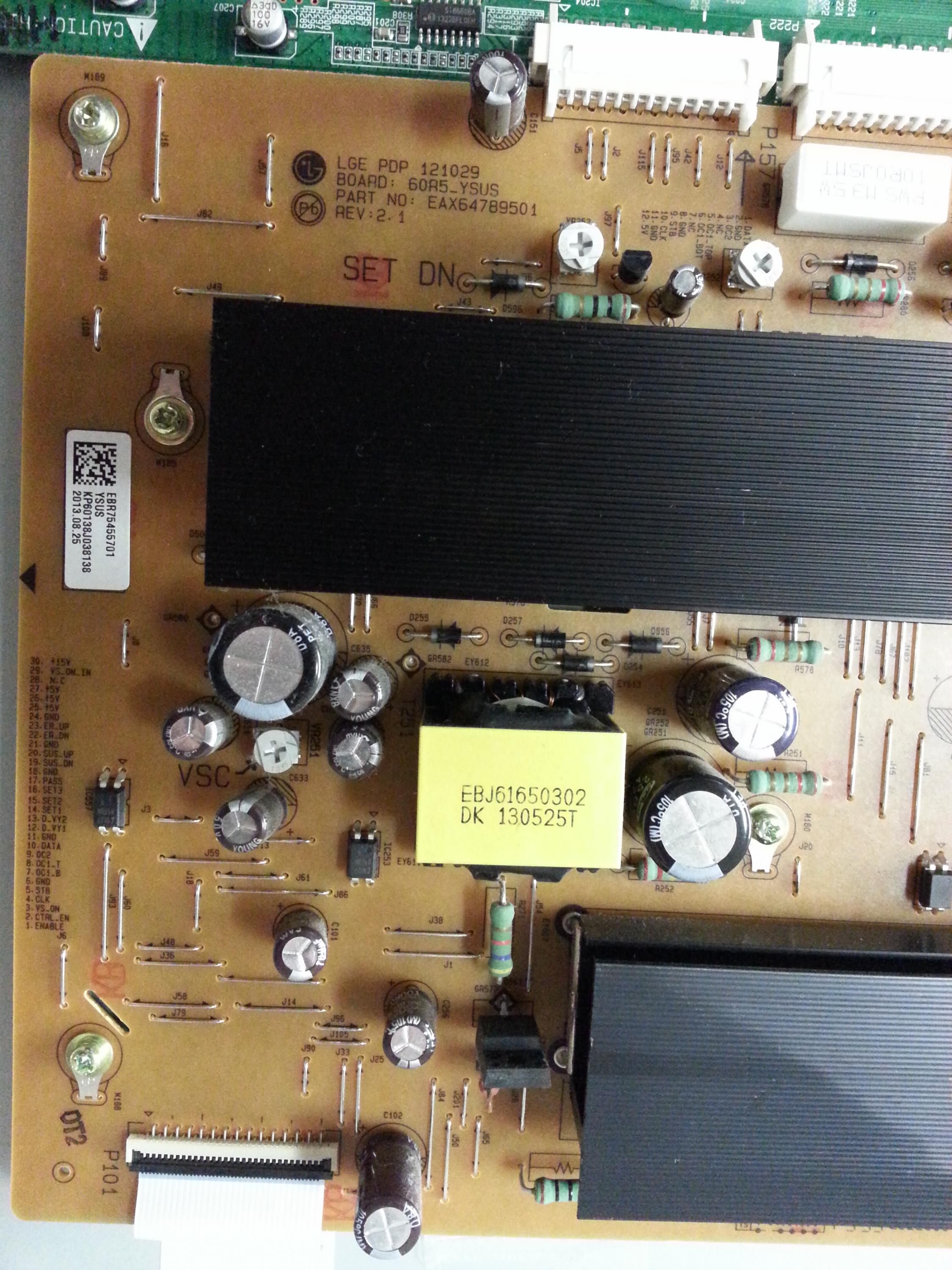

                  Upon further inspection today, I was unable to find those points. Here's some photos of the boards:
                  Z:
                  Y:

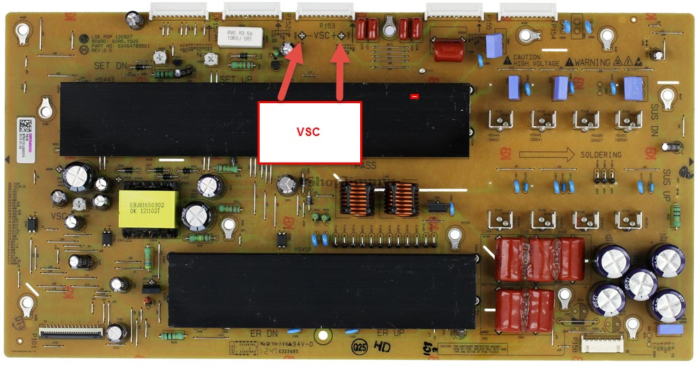

                    Re: Power, but no video on LG 60PN5700 Plasma flat panel
                    I've attached annotated pics. I can't see the -Vy on the YSus. Can you take a picture of the label on the back of the panel that lists the voltages? Also, please include a pic of the back of the TV with all the boards visible.
                    Edit: It looks like your boards are different from the pics I posted, but the test points should be in similar spots.

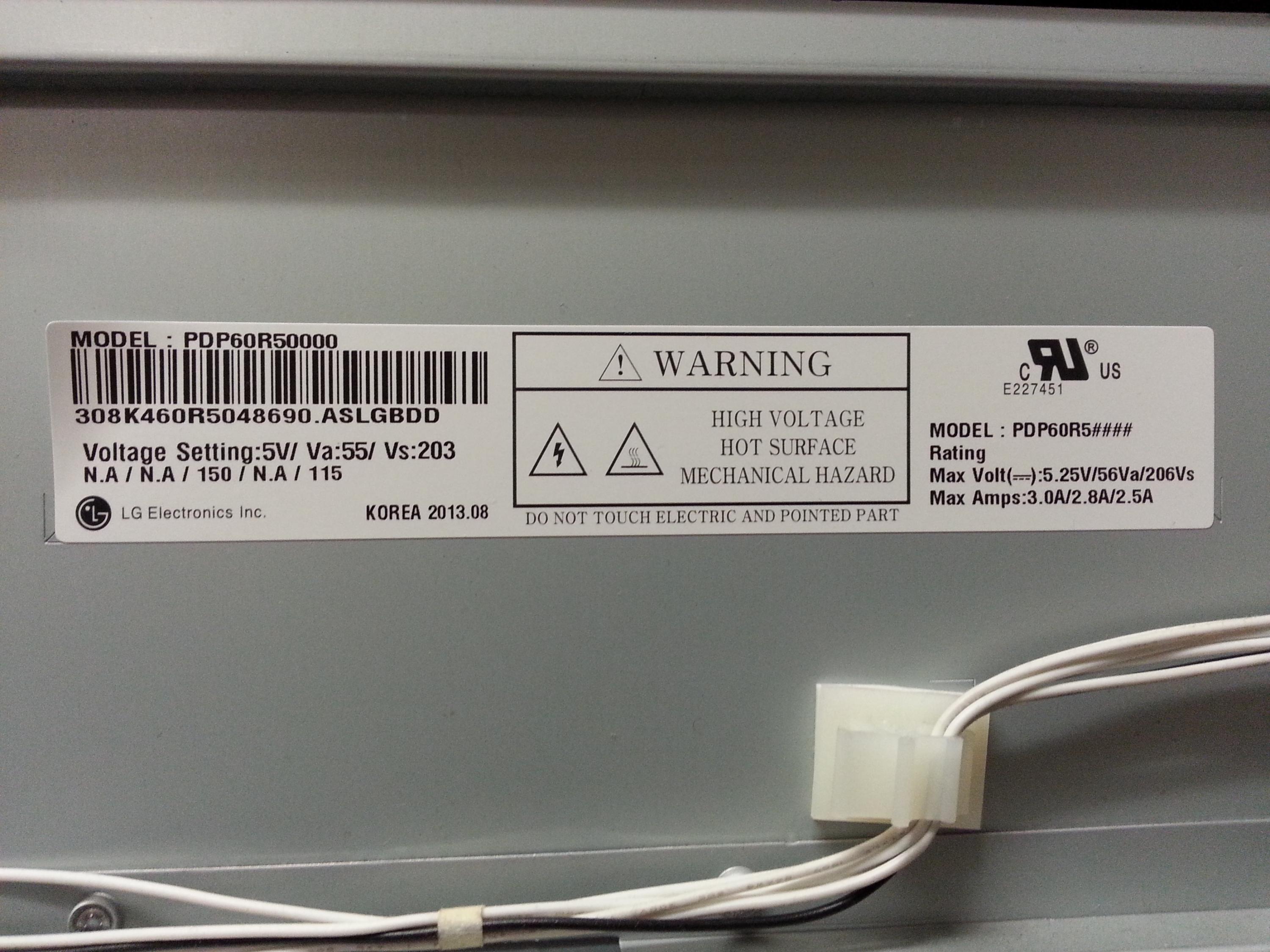

                      Follow up with proper voltages and pictures
                      Thanks, the points were right in front of me the whole time and I missed them somehow. The correct VZB reading is about 113 and the VSC fluctuates between 154 and 174.
                      Here are the pictures of the entire set and the sticker with the voltage information:
                        Wow, I think this panel may not use -Vy or may use some alternate drive method, as it's not marked? Really odd.

                            Yeah, I scanned the pics closely, and I saw no -Vy. Very different.
                            It looks like the VSC is having issues. I'd turn the TV off, unplug it, disconnect the Y-buffers from the Ysus, then turn the TV back on and recheck VSC.
                            Note: If you go to reconnect the Y-buffers to the YSus after the above test, wait about 10 mins. before doing so. The high voltage caps on the YSus need time to discharge.
