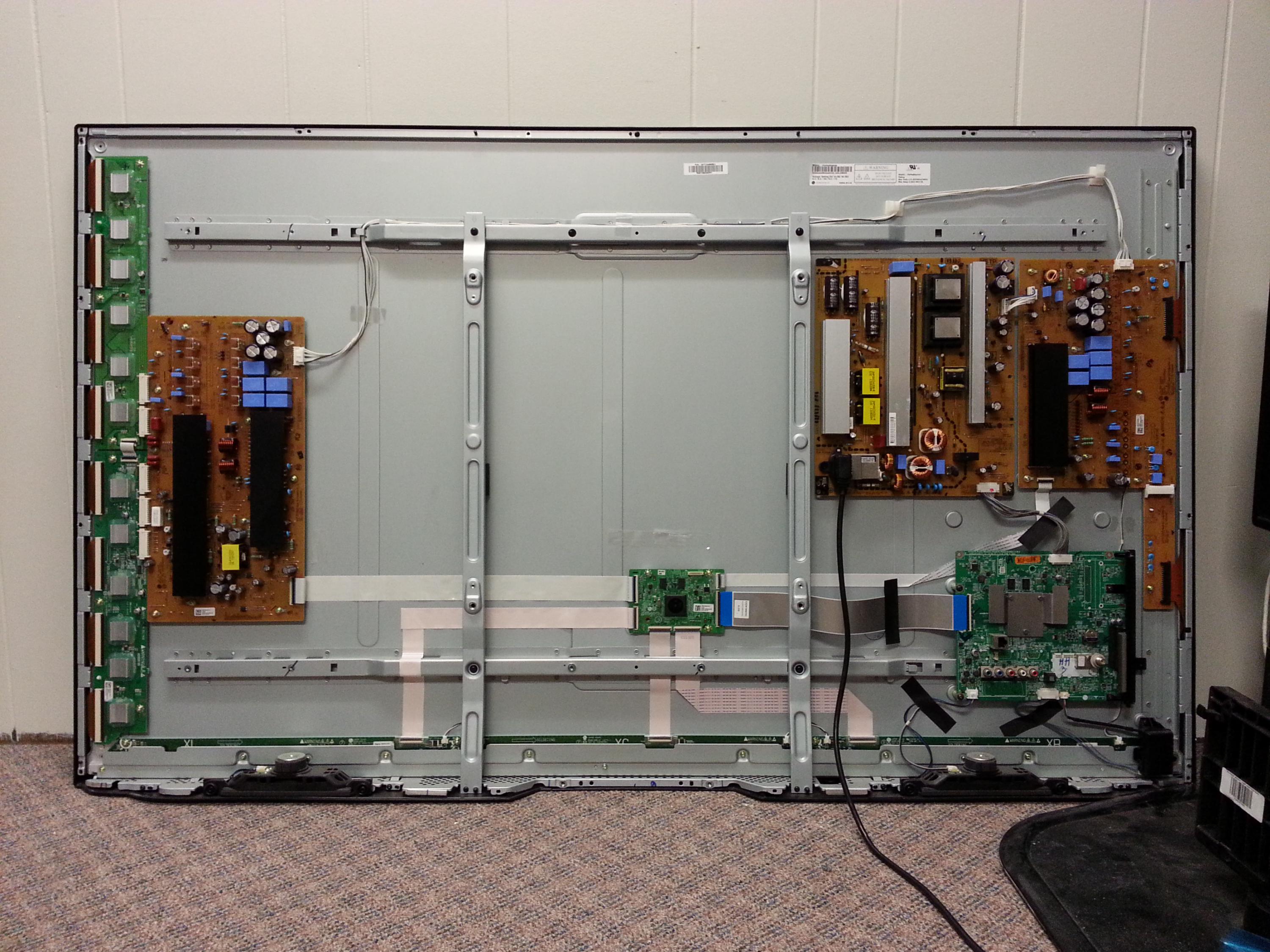

    Here's what I've got: 1 LG 60PN5700 60" plasma television that seems to power on normally (you can even see light output from the screen if you look closely) but displays no video. The back has been removed from the set and a visual inspection of all the boards reveals no obvious issues. The small green light on the board in the center occasionally blinks while the television is on (I'm guessing this is what it's supposed to do).
    Any ideas on what might be the problem or what the next step for troubleshooting might be?

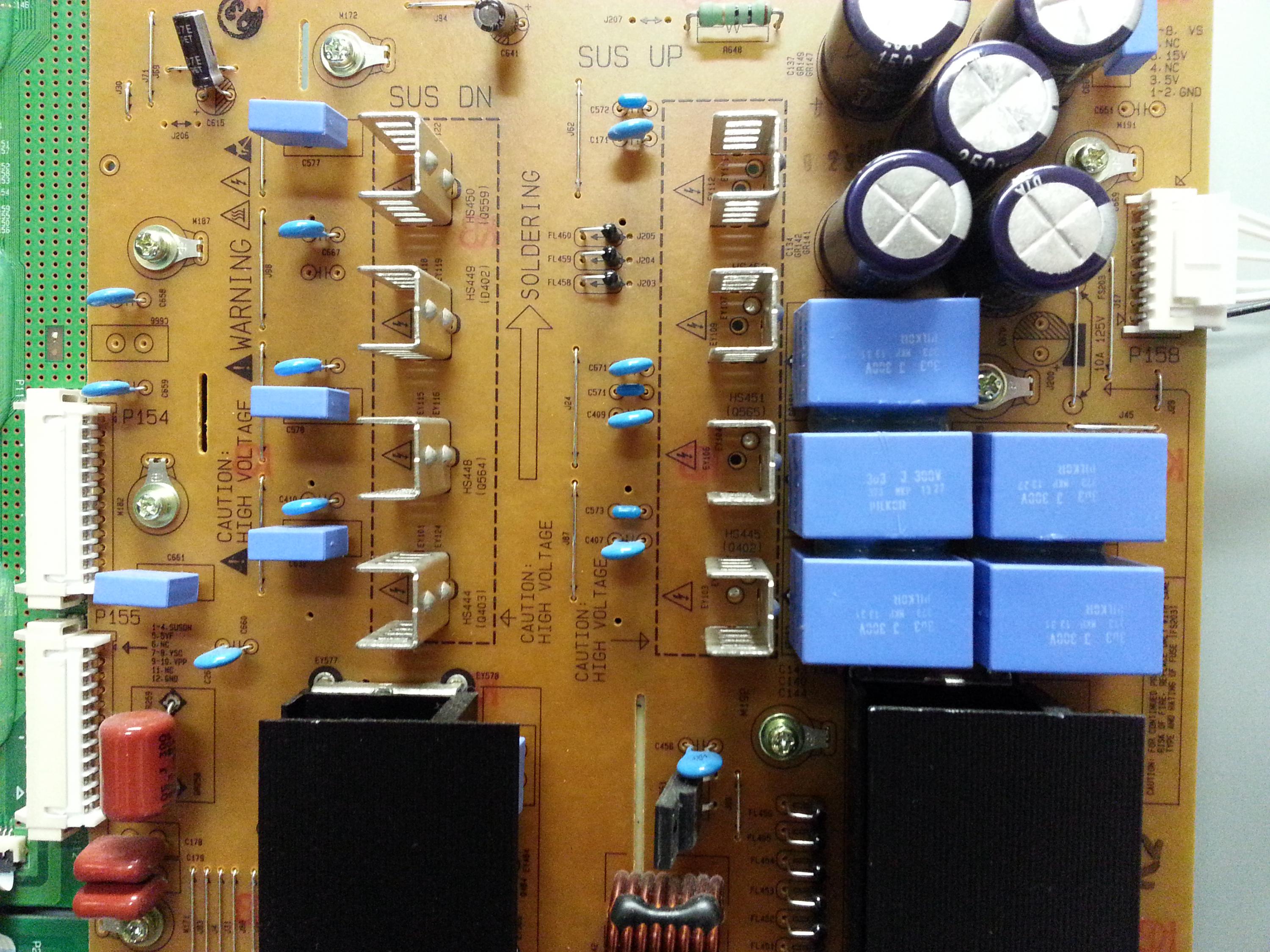

                  Upon further inspection today, I was unable to find those points. Here's some photos of the boards:
                  Z:
                  Y:
                    Re: Power, but no video on LG 60PN5700 Plasma flat panel
                    I've attached annotated pics. I can't see the -Vy on the YSus. Can you take a picture of the label on the back of the panel that lists the voltages? Also, please include a pic of the back of the TV with all the boards visible.

                      Thanks, the points were right in front of me the whole time and I missed them somehow. The correct VZB reading is about 113 and the VSC fluctuates between 154 and 174.
                      Here are the pictures of the entire set and the sticker with the voltage information:

                            It looks like the VSC is having issues. I'd turn the TV off, unplug it, disconnect the Y-buffers from the Ysus, then turn the TV back on and recheck VSC.

                                  With the buffers disconnected from the Y Sustain, I'm getting just a few volts on the VSC. It's ranging from 0 to 30, but mostly hanging around the mid teens.
                                    So, just to check, the white connectors are fully out? If so, this would indicate a bad Y-sustain, to me.

                                        I agree with Tom: Looks like a bad YSus. I'd try the logic control board test that Tom mentions in post #5, just to cover all bases. The logic board is the small one in the middle of the panel.
