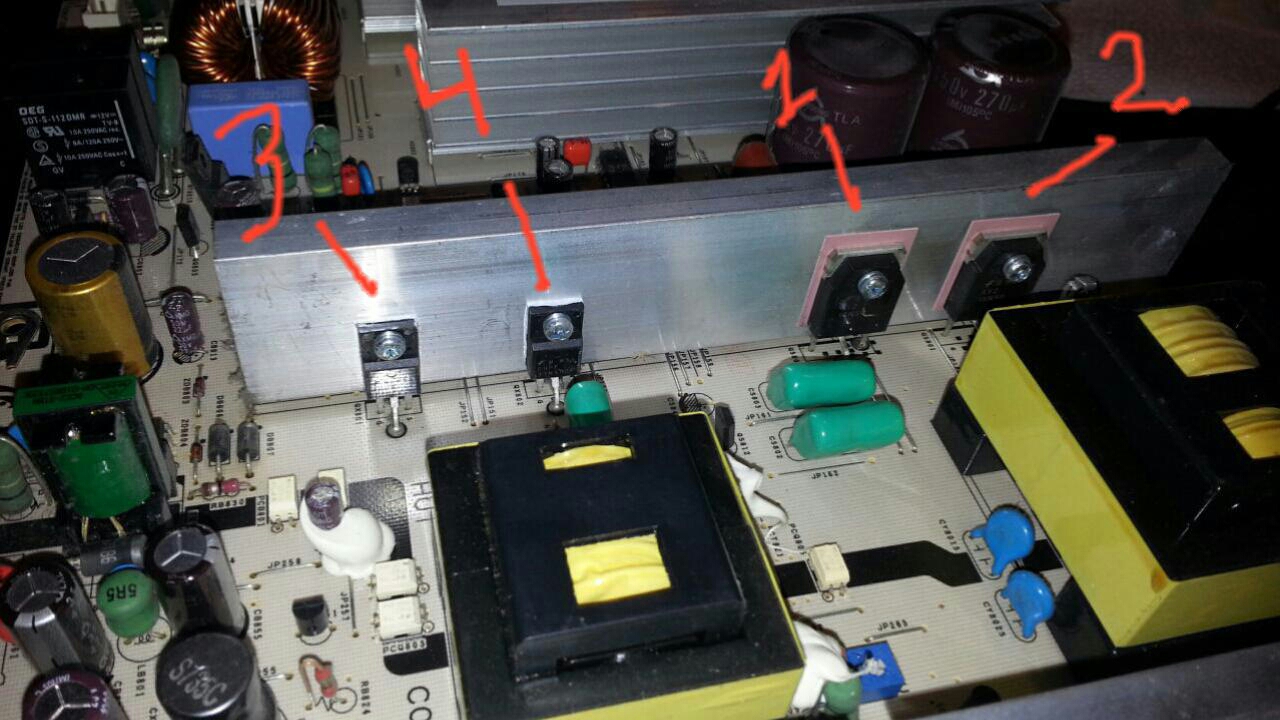

    samsung hp-t5054 no power
    so i did a search for my issues and nothing came up closely related to the issues i am having
    only thing i read was faulty ic's on the upper buffer boards
    i am having issues with the psu
    i disconnected all of the cables going to the psu
    i get nothing close to the voltage readings specified on the sticker for vs or va
    all fuses checked good
    i did a search for the board on ebay
    and there are a few sellers selling repair kits that include 2 mosfets and 4 really small resistors you can barely see
    on the sellers page it said these are a common component to fail
    but of course i rather get my answers here
    so i tested 4 mosfets but i dont know if they are shorted or not
    here is are the readings on diode mode
    mosfet #1
    1-2 = ofl
    2-3 = .503
    1-3 = .007
    mosfet #2
    1-2 = ofl
    2-3 = .504
    1-3 = .007
    Mosfet #3
    1-2 = ofl
    2-3 = .419
    1-3 = .036
    Mosfet #4
    1-2 = ofl
    2-3 = .415
    1-3 = .036

      Tour mosfets don't sound shorted. What happens when only xmain is connected?

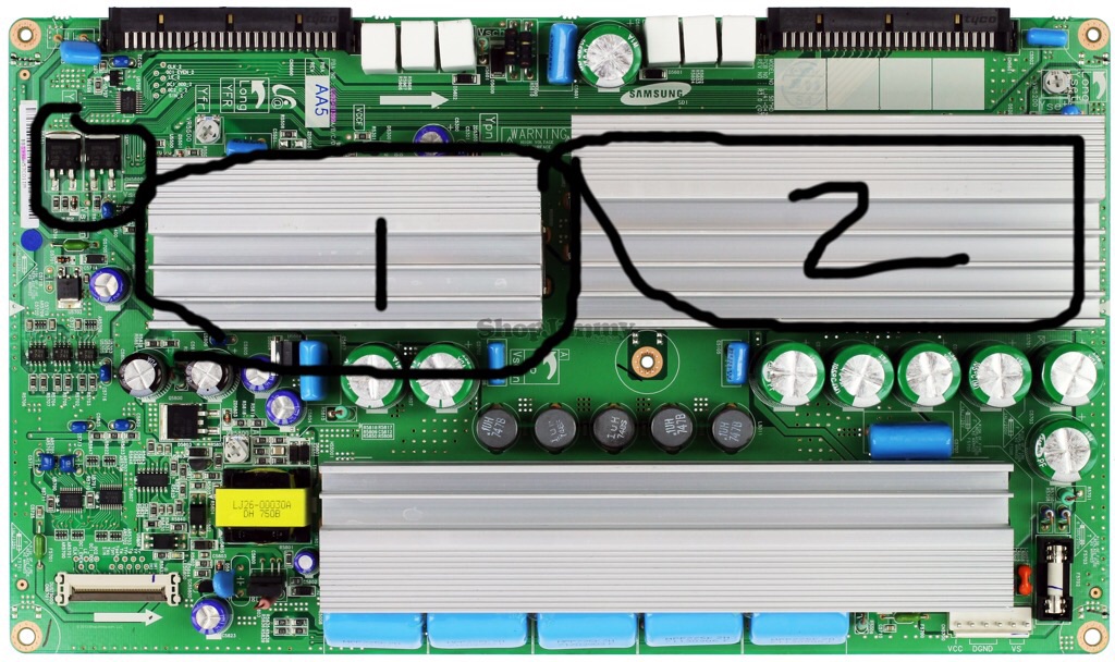

        From what you listed they are shorted. common issue with these is the solder fractures on the fets and I think that is when they blow, often the PSU just clicks on and off and they can blow. Other times depending on heat the TV can fire up and then randomly shutdown.
        i've also got the same PSu , which I'm reluctant to fix because the ymain and buffer is also fried, a lot of work but you'll find transistors, maybe resistors but more importantly a bunch of smd diodes underside that will be shorted also need replacement.
        this kit from shopjimmy is closer to the mark for what you'll need
        http://www.shopjimmy.com/samsung-bn4...repair-kit.htm

          oh, I was thinking they were? what about the 0.037 and 0.007 readings on pins 1-3? Is that normal for these?

            Now that I thought about it Im not too sure about the readings between pins 1 and 3. Sounds fishy.

              probably need to know in or out of cct?

                    I will remove the fets and test out of circuit today

                              You need to check your ymain the mosfets on these short out and will usually take out your upper buffer board.

                                        the reading you are saying you have on those components are good they are not shorted the power supply is not working because it is not being turned on.I was helping a friend fix his tvs both same model hpt5054 both would not turn on the upper buffer board shorted out and took out the ymain and the logic board.I would check ymain first check the ones attached to these heat sinks also under number 1 heat sink the is a surface mount mosfet that shorts out part number is B20NK50Z.the two surface mount ones in the circle usually don't short out but i would check them.
