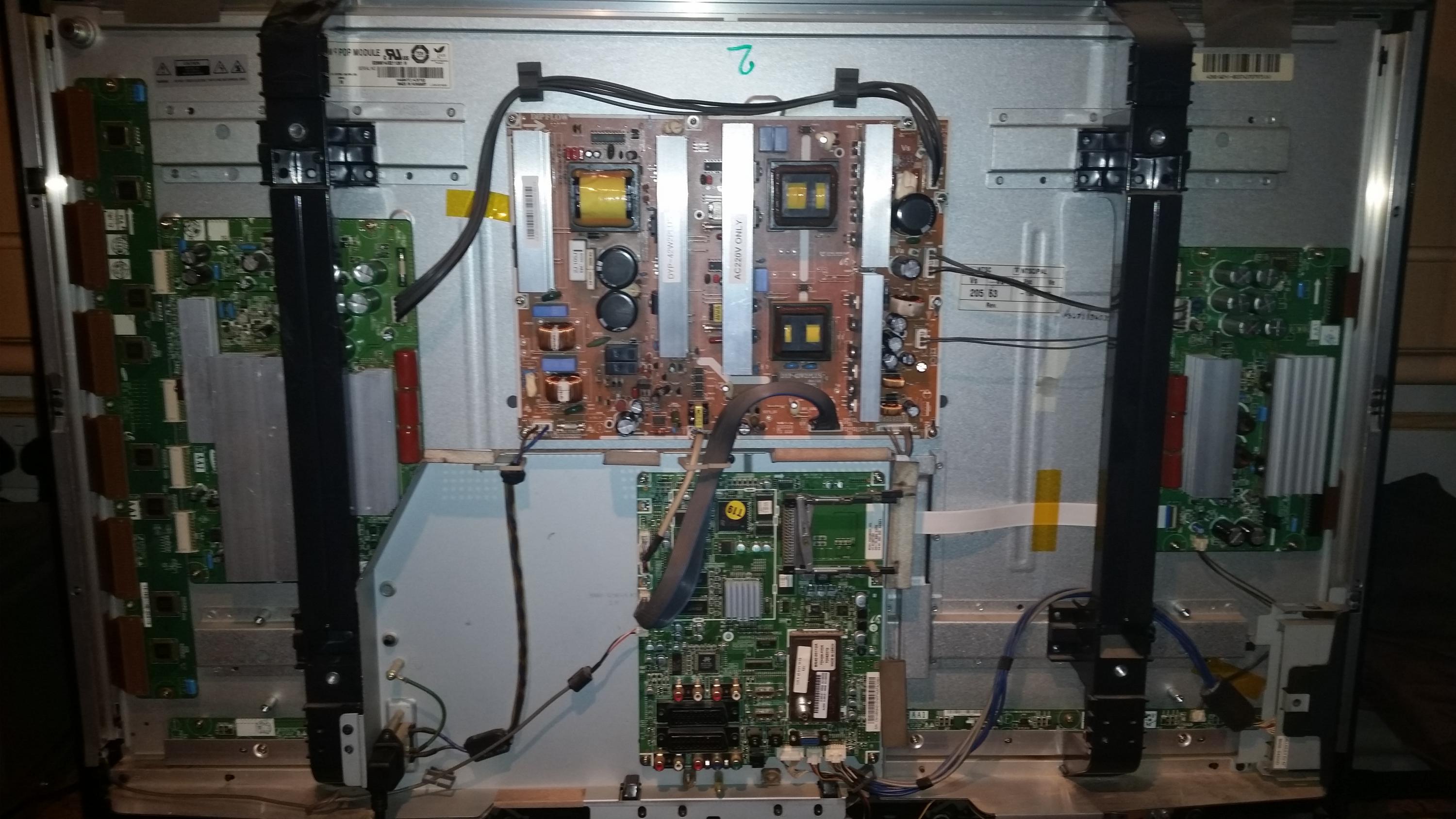

    hello
    got this tv today totally dead no VS or VA voltages so examined the power supply for any visible faults but nothing checked the fuses which are ok,but had one of these before where cold solder joints are common so resoldered the board now i have the correct VS 203 v VA 60 v voltages but the tv switches on with the chime but thats it,also the control board is flashing green should it be constantly lit green ?

          i have a working PS42Q96HD main board tried that still the same so im assuming its a control board fault ?

            Yeah, sounds like a logic board problem.
            Try the logic board test jumper trick by shorting whatever the two highest pin numbers on the test jumper are (usually 3-4), the main board can be totally disconnected, and just force PS-ON to ground. I'm expecting that to not work but it's worth a shot.
            Then, I'd start checking voltages on the logic board. There are a whole swack of regulators on there and it's quite possible you're just missing one or more of the power supplies to some chips. Check for power to everything, check any fuses and all the regulators.

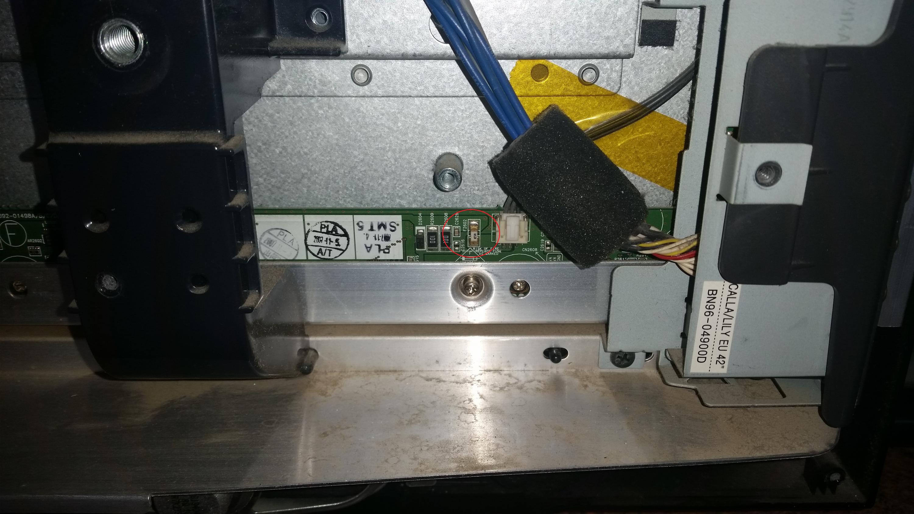

                          ok so maybe im wrong but i have sound but no picture but the screen lights up could it still be the ysus ?
                          and does anyone know what voltage i should be getting from the fuse i have uploaded via picture

                            On that panel sticker which i out of focus, looks like 63V. Word of warning do not disconnect then reconnect that grey 3 pin lead from the xmain to that buffer board.without making sure there is novoltage(residual) i killed the 50" model arcing that because I left it off by mistake, turn the tv off then large arc and dead panel.
                            that comes via the xmain so what is that connector labelled as?

                              VE on the panel is marked up as 99 volts im getting 98 volts from the xsus
                              the buffer number where the fuse is LJ92-01498A

                                Whatever is next to 205V for Vs is what i believe goes to those buffers, looks like 63V, Va?
                                just looked at a US version and that's routed direct to those from the PSu, trying to find your xmain version.

                                  I can't be 100% sure without trying to dig for manuals etc but trace it back. there's only 1 main power input to the X and looks like Vs, Va, gnd, vcc goes in and I'm pretty sure 63V would be those bottom buffers because it's about 50-60 v on the panasonics i mess with down there. Not sure but it may also get 5v supplied too but you have 2 cables supplying the one voltage to that point so I'm thinking 63v.

                                      Should have Va on both ends of that fuse (about 60V)

                                        Re: samsung ps-42c96hd totally dead
                                        i had a spare xsus but still no reading of the fuse on the lower buffer
