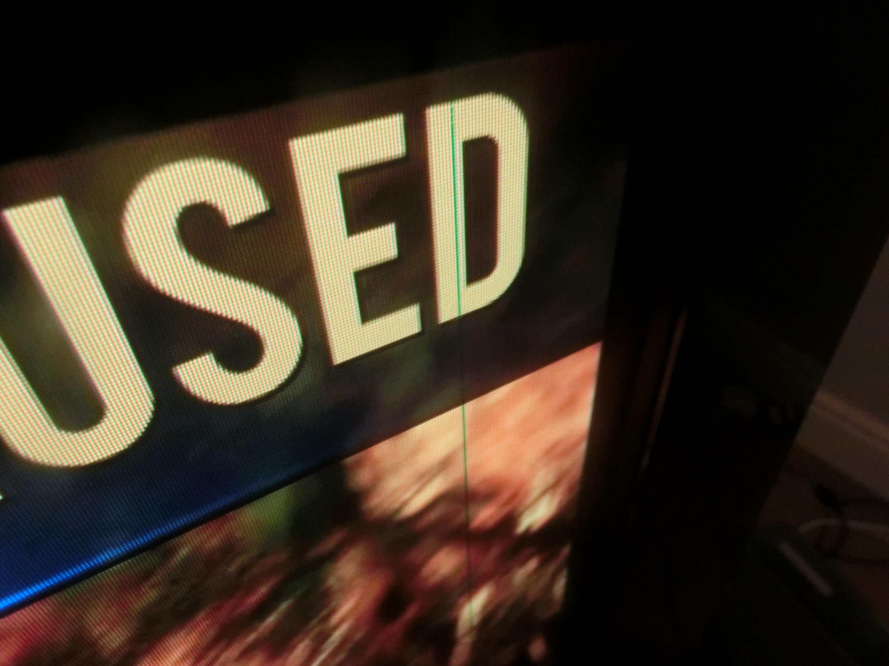

Bad Panasonic PZ80 panel
    It's rare but it does happen. My first PZ80 with this issue. I fixed this set with a main board issue by replacing the main board. Oddly the line is intermittent; it comes and goes Seems to affect red and green subpixels mostly.
    Happens to the best, I guess...
    Model: Panasonic TH-42PZ8BA.
  • tw2005
    • Oct 2011
    • 6457
    Re: Bad Panasonic PZ80 panel
    At least they usually die gracefully. The PX7 I had, had that and put up with it for ages without it getting worse. varied colour and some backgrounds not too noticeable.
