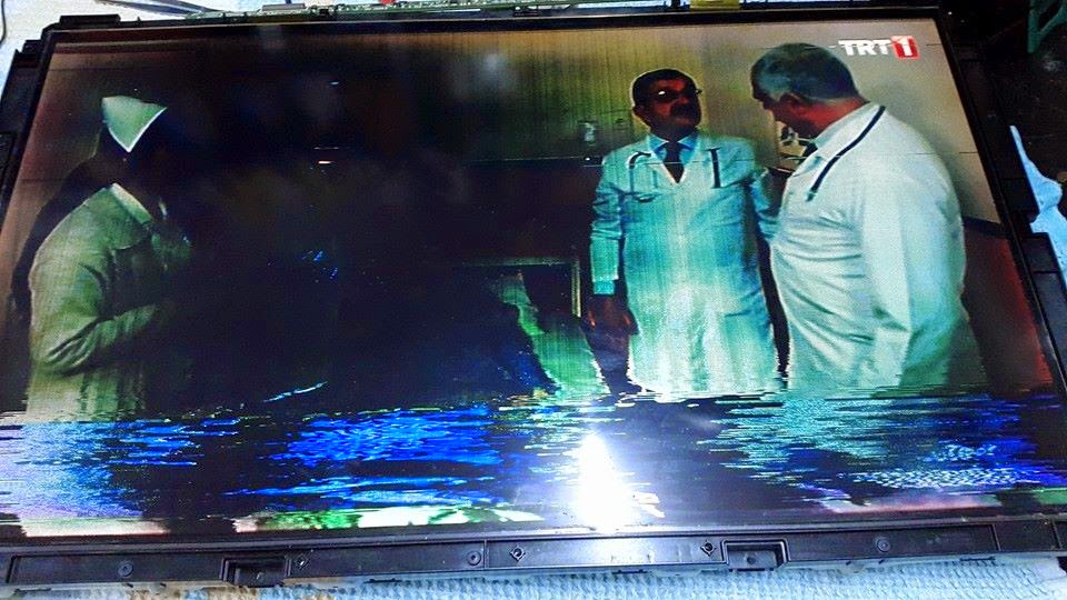

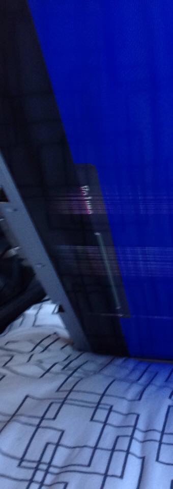

    Had over 5 of these lcds all from vestel chassis all with the same issue, the other 3 I threw out and replaced the screens as I was able to find a batch of screens on ebay for £40 but that listing has ended and now im stuck and dont want to spend £80 as I ant find a cheaper listing for these junk screens. I will upload photos of the issues its not tab bonds or ribbon or motherboard issues as I swapped all them for known working parts and the same issues still occur. Nothing is blown on the timing board, just wanted to know if anyone knows a fix for this stupid issue ?
    From the photo you can see that there is a section of the screen that is totaly missing and there is a line forming down the middle.

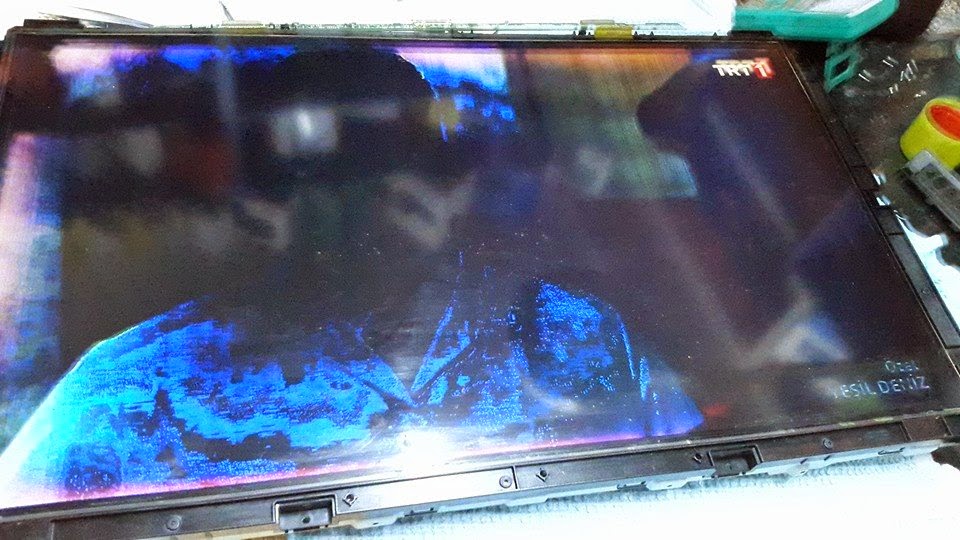

      hi i have one here doing it did you ever find out why ???
      screen seems to work fine then after a short while those lines appear and the middle of the screen goes white-ish, it also looks like a refresh problem as sometimes image stays on the screen

        Hey Garry, I know that the issue isnt tab bonds Im really begging to think that when this happens that the actual lcd glass layers are parting probably because the frame is so flmsy

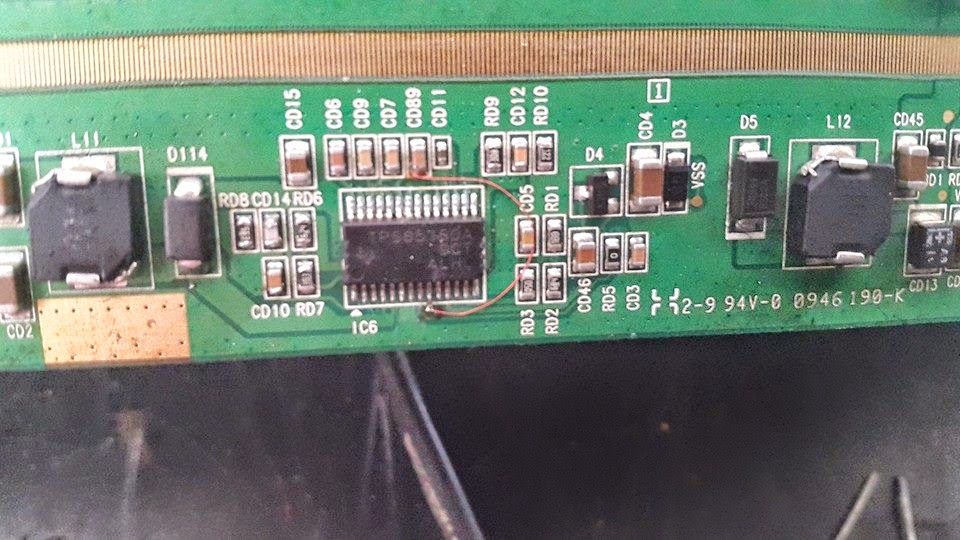

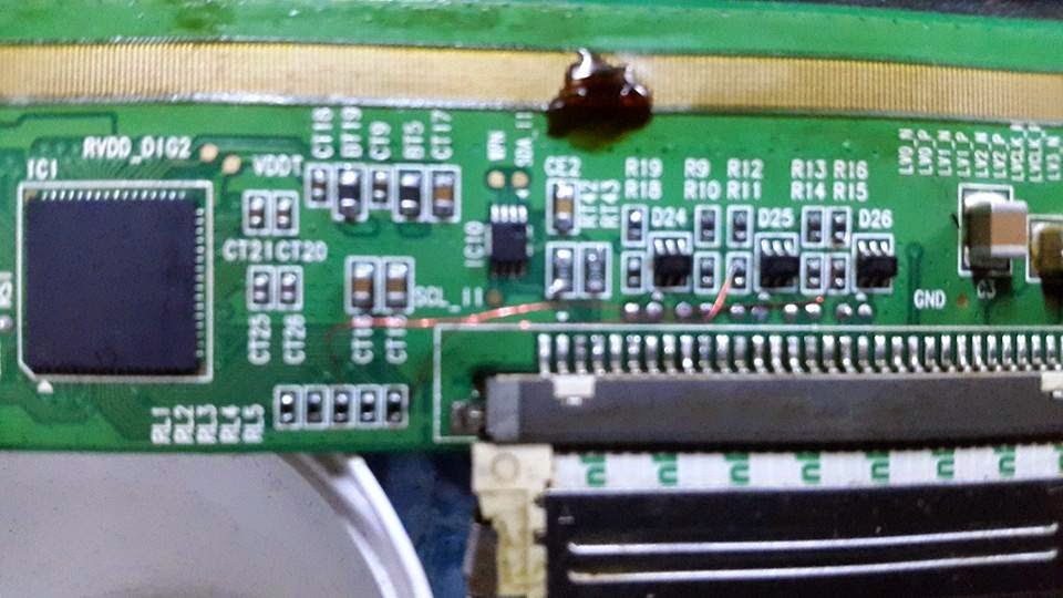

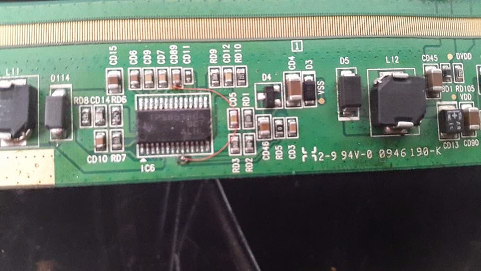

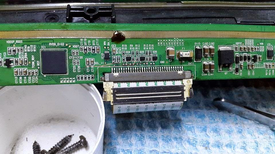

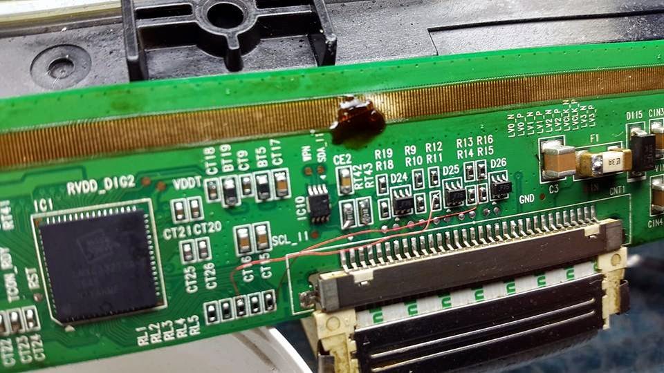

          For anyone else interested I cam across this whilst looking for screen issues with the LTA320AP06 screen issues
          Website here:
          https://plus.google.com/105379196467...ts/AGtexj4yYDG
          I have attached pictures from it for anyone interested
