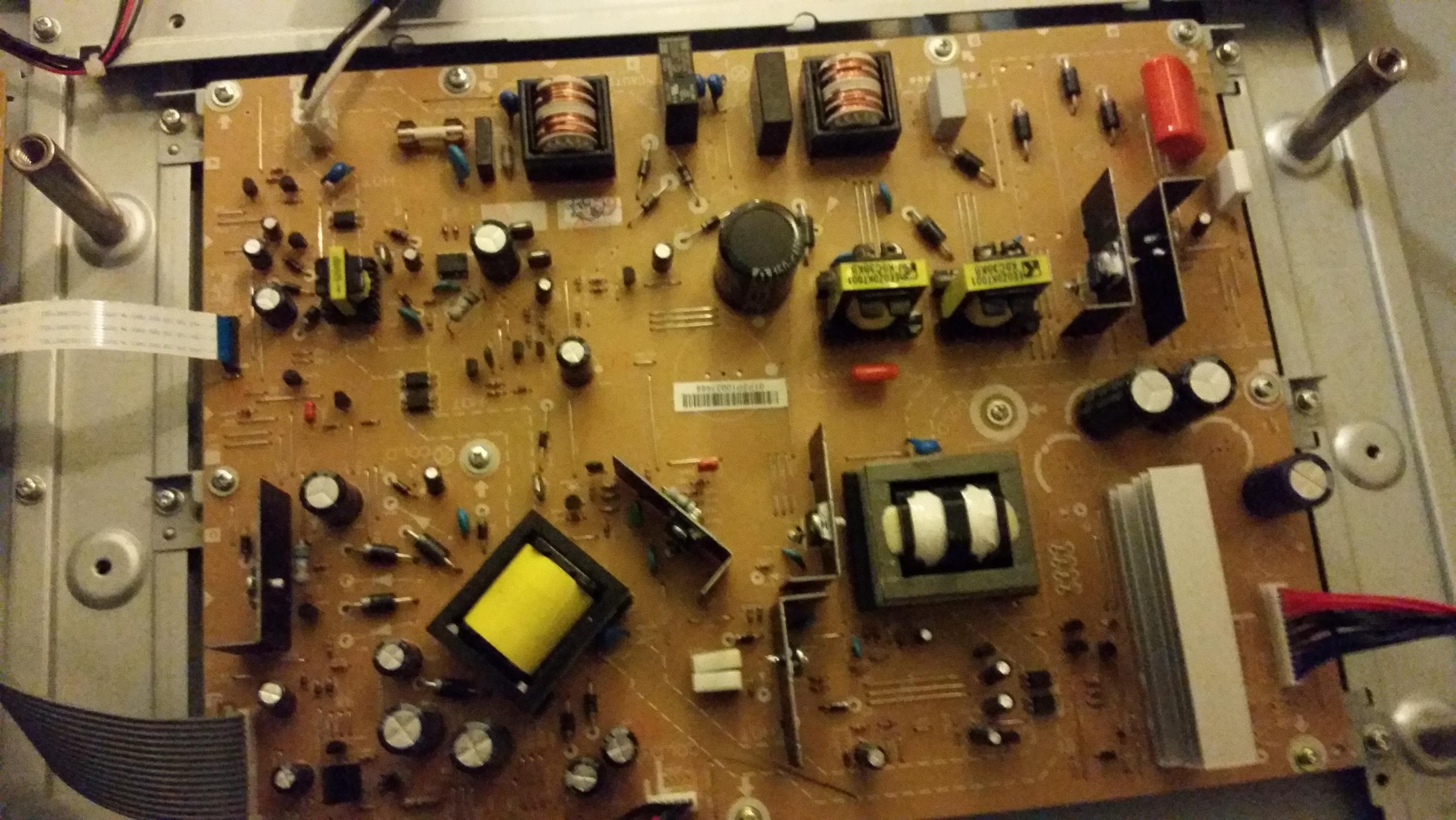

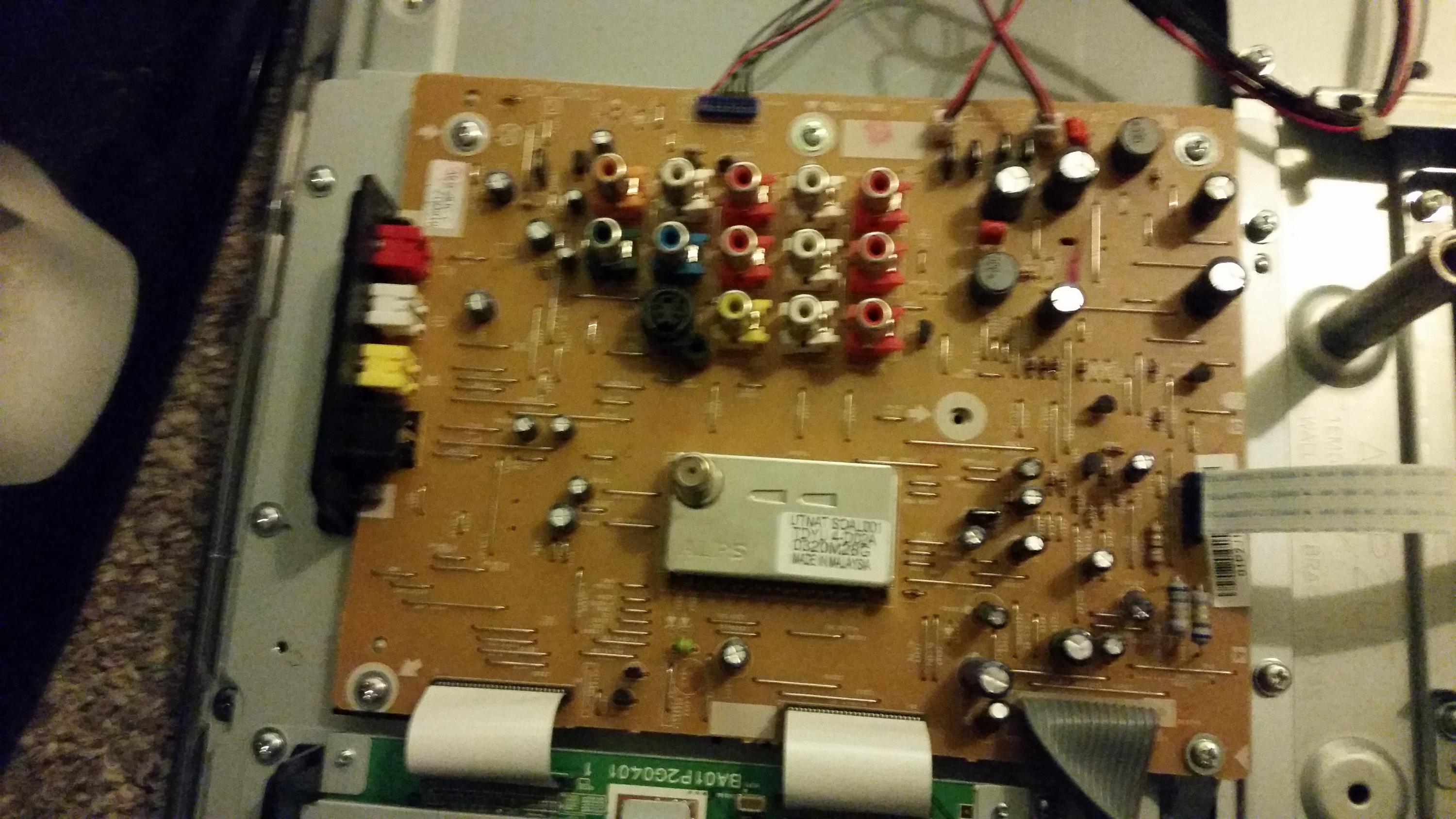

    No picture, uncertain of sound because I do not have a remote with the tv to switch inputs ( or try to anyway)
    backlight does come on, its brightens at first then dims but is on.
    I toggled the ribbon cable on the t-con board to try and get a difference but no such luck, just blank screen.
    also makes a buzzing/hissing noise hard to describe, only happens when its on.

    Do a continuity test on the t-con fuse.
    Edit: I had the same issue a couple years ago with this particular TV. I soldered a new fuse on top of the old one instead of trying to remove it - totally acceptable: http://www.digikey.com/product-detai...5TR-ND/1206513
