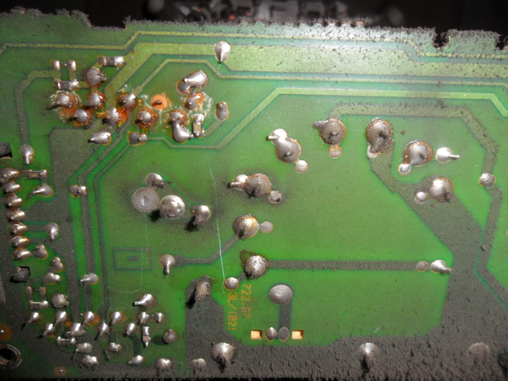

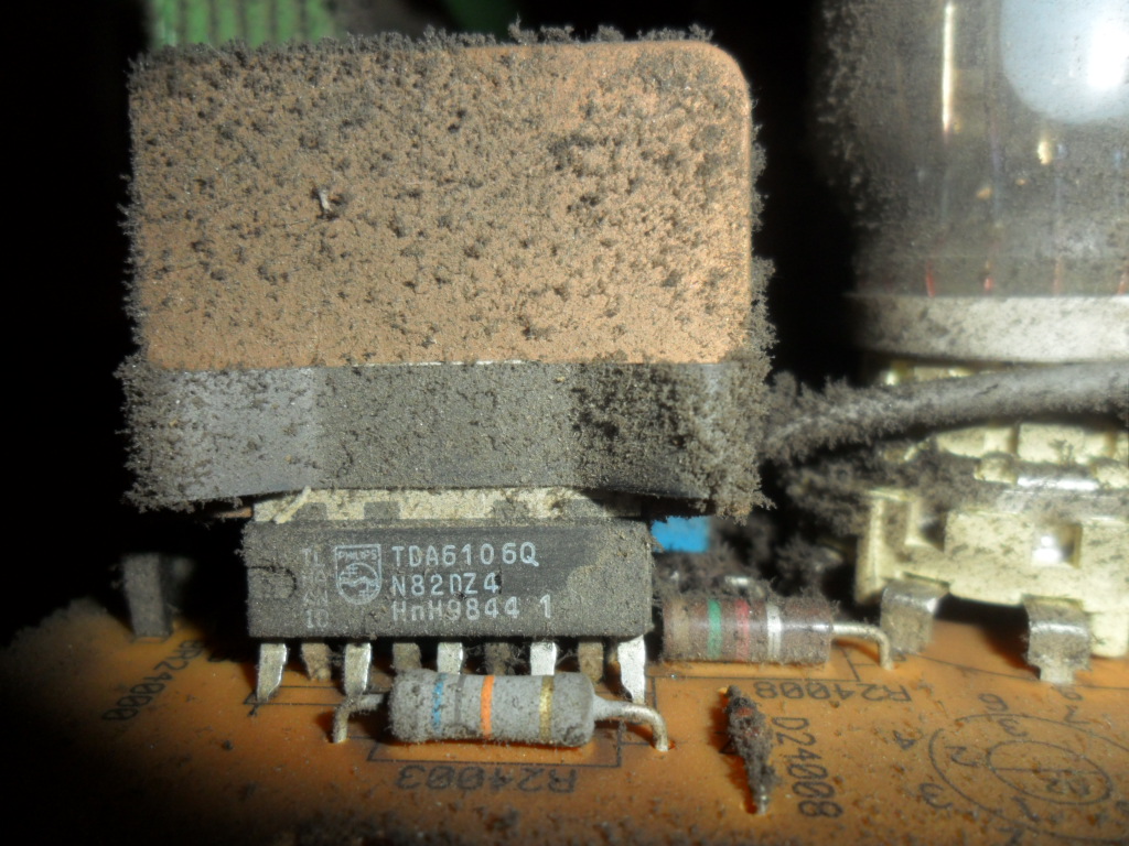

    Here I have Grundig CRT TV, problem is that it wont turn on all the time there is some sound like "zzk", "zzk" and repeating in some time intervals. On the board at CRT are "TDA6106Q" and around one of them is pins like somebody was re soldering or so.
    So all of the capacitors looks fine and board itself.

    some suggestion?
    Tested that soldering it is ok. When TV goes to "ON" state, it is some discharging i don't know HV cable from flyback moves a little bit , and TV repeating that
