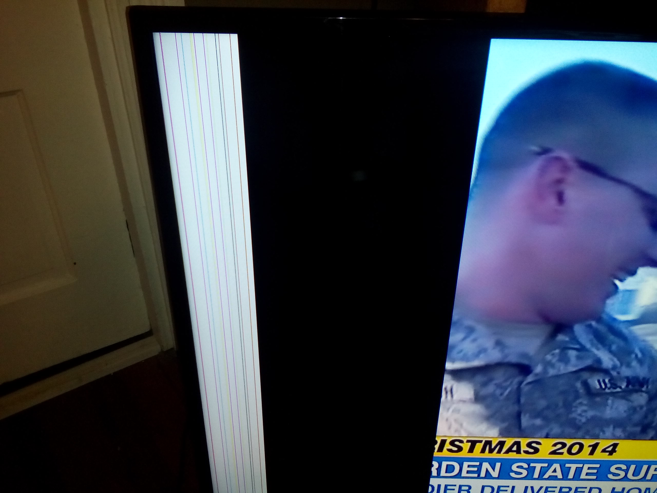

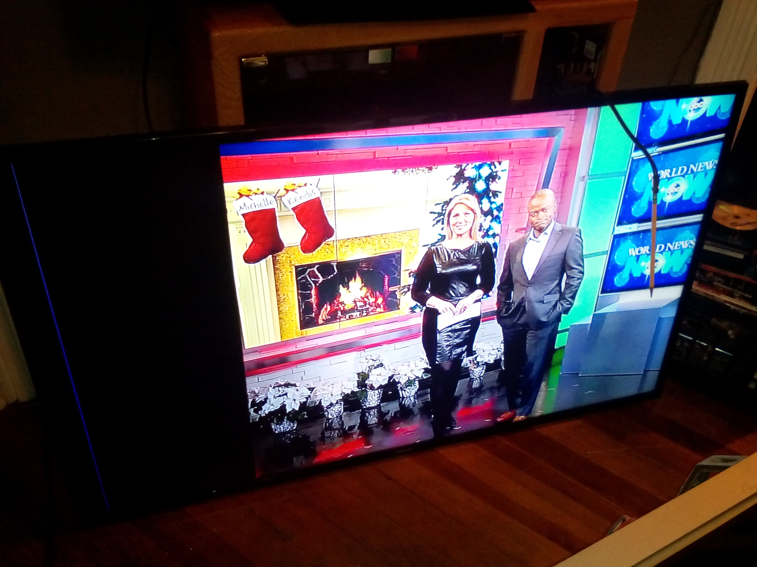

2 year old Samsung UN60EH6003 Missing one third image
    Thinking T con first, main board second, bad panel third.
    Both boards are very expensive for this tv so Ill see if anyone has seen this before and I will then go ahead with ordering a part.
    Some vertical lines on left hand of screen accompanied by missing part of image. Already reseated cables, ribbons to Tcon with no change.

    Here is another shot. Those thin vertical lines in the white space are different color
      Re: 2 year old Samsung UN60EH6003 Missing one third image
      99% bad panel, in my opinion, sorry.
