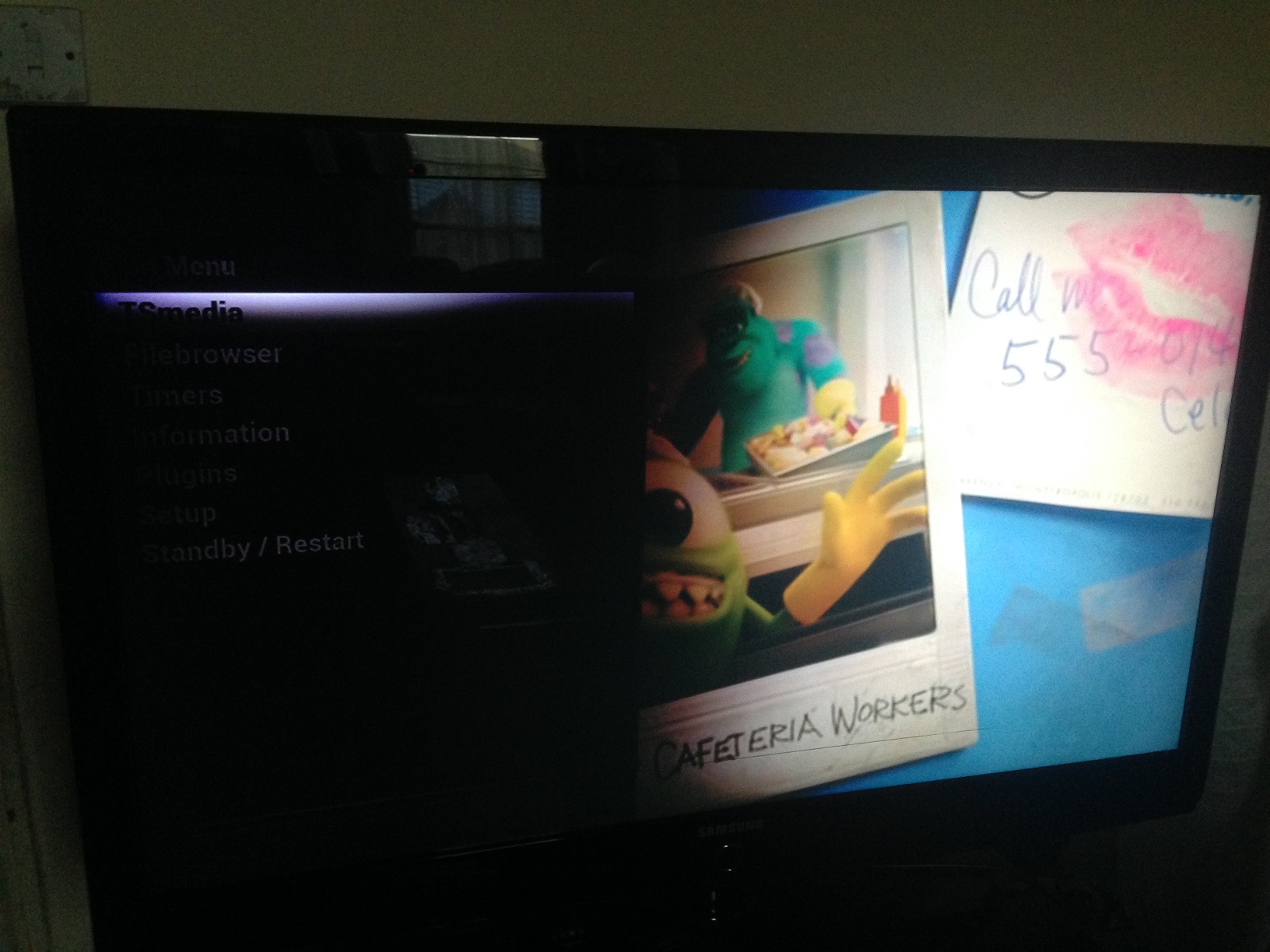

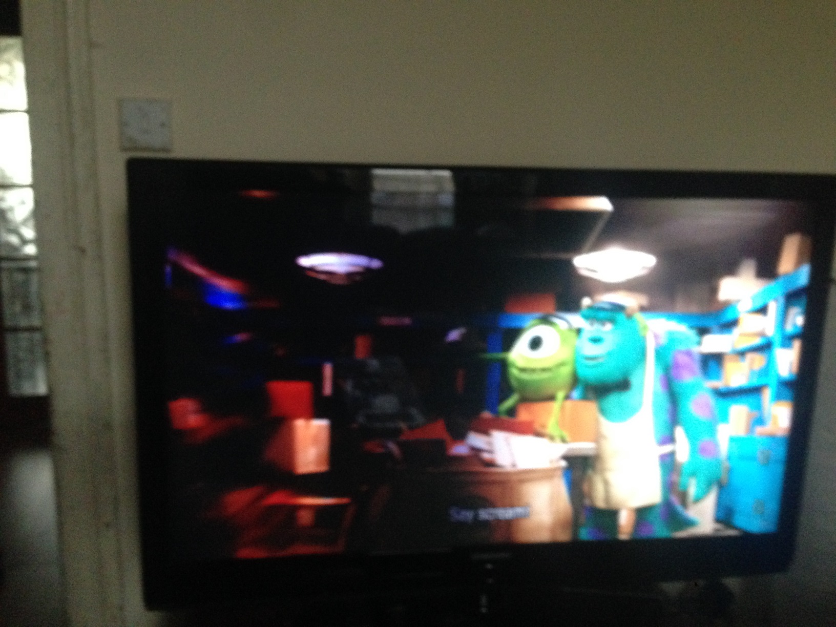

    When powered on the picture is half dark
    then after a while (20mins or so )
    once warm it is ok
    And no issues
    Is it a t con issue or is it with the panel ?
    Re: Samsung LE46M86BD half picutre dark
    Panel. Maybe tab fault, sometimes fixable.
      I was afraid of that.
      Will have a play with it on the weekend...
        What is that line, under Cafeteria workers?
          That's often seen when gate tab bond failures occur; I'm not sure why...
