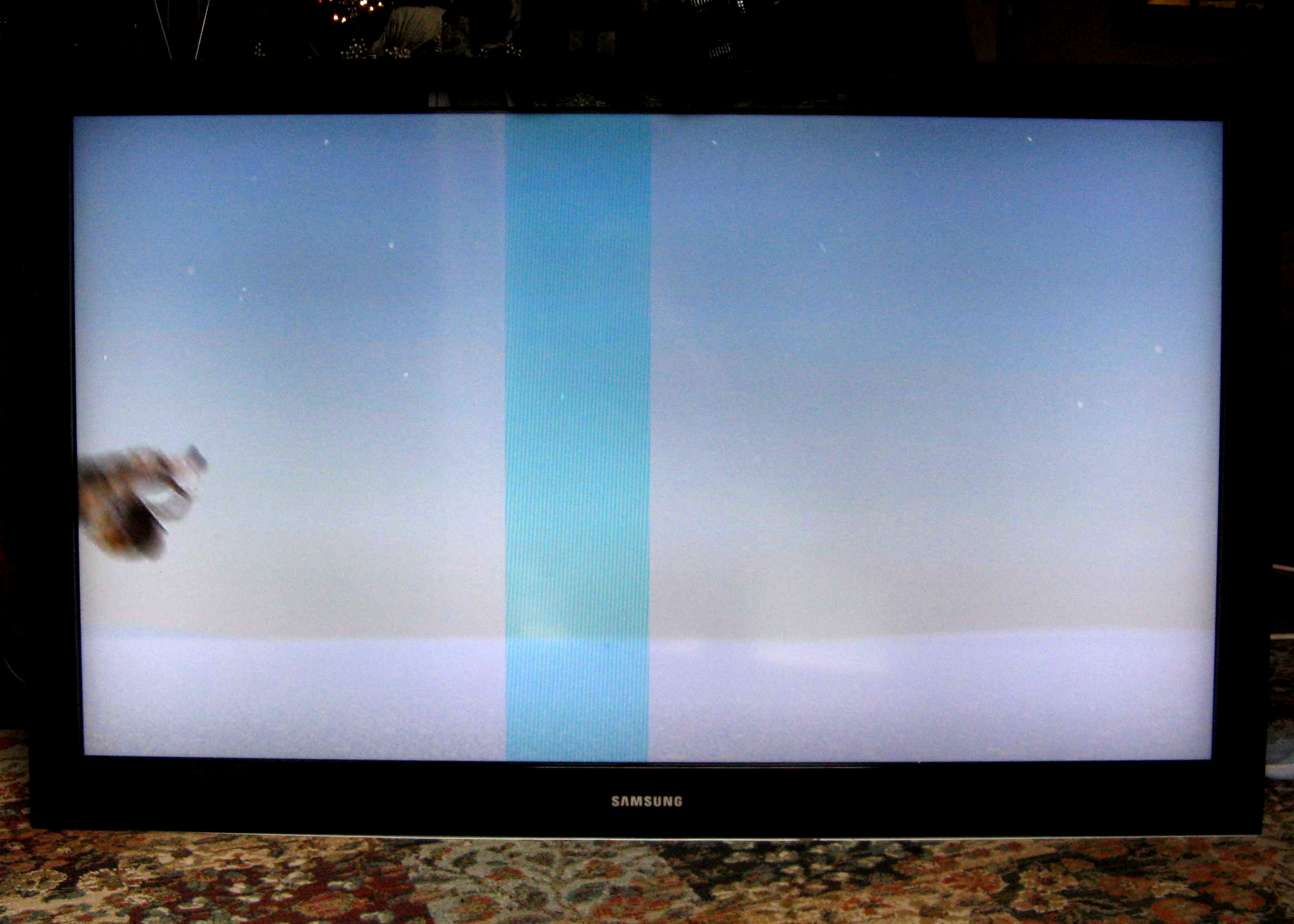

This is my first post. Photo should be worth at least ten thousand words. Inspected, cleaned lvds cable and T-Con ribbons, looked for bad caps. Carefully massaged all around the edge of panel but no change. At this point I am suspecting T-Con board but wanted advice before ordering. Thanks in advance for your help. Complete model #LN52A550 P3FXZA

Scene on the screen is Scrat the squirrel (on left) from dvd "Ice Age". While playing around with set while dvd was playing, the blue band went away for 10-15 minutes but came back. Set works perfectly except for blue band.Last edited by stevo440; 12-16-2014, 01:46 PM.Comment

Does it goes away if you flex the panel?Never stop learning

That may be tab bonding problem.

Yes it appears to be the tabs. Just taking the screws out of the metal frame makes the problem go away. I just found the "hot" tab right adjacent to the blue area at top of screen. Now I need to order the stuff to fix it. Thanks again!Last edited by stevo440; 12-16-2014, 04:31 PM.Comment
