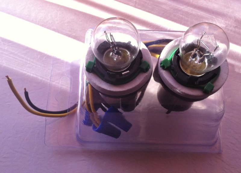

    I've built a test load for 24VDC using 2 auto 1157 bulbs in series. The cold ohm measurement looking into the load is under 1 ohm. Should I add some resistance?

    As soon as the bulbs warm up, their resistance will increase.
    The cold resistance may be too low to allow the power supply to start. If so, additional resistance may be necessary.
      Re: 2-1157 test load design for 24 V
      You can put NTC Thermistor is series, also use the low beam filament instead of the high beam.

          It has two filaments one for low brightness (running lights), one for high brightness (when brake is applied), I use them for testing also.
          http://s807.photobucket.com/user/bud...?sort=3&page=1
          http://s807.photobucket.com/user/bud...?sort=3&page=2
          Some power supply will not handle high inrush and it will go into shutdown.
