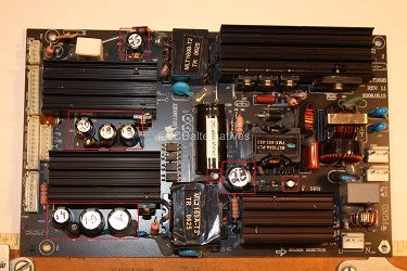

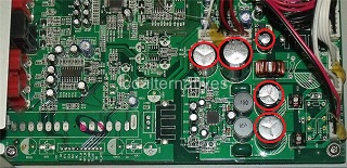

    Ok here are some pictures of the boards I am concerned with wondering if the caps circled in red could be the reason for the image and sound distortion and if the problem lies on the main board or the smps on the smps are the caps in red a reason for the problem
      Re: ilo lcdtv question with yutube video link
      PSU pic too small--cant tell.
      MB pic, most those caps U/S.

        Since you already see bad caps on the main board, then you will have to at least replace them first.
        You might as well get the list of the caps on the power supply board and change them as well too (except the main big filter cap on the primary side).
        Make sure to use good quality LOW ESR/LOW Z type with 105C temperature rating.
          thanks budm will pull all caps! what would cause a spike in voltage on the 12v line where it connects to the main board I have 12v on the smps side but measured on the main its running 80v and climbing is that a regulator problem, mosfets or something else
