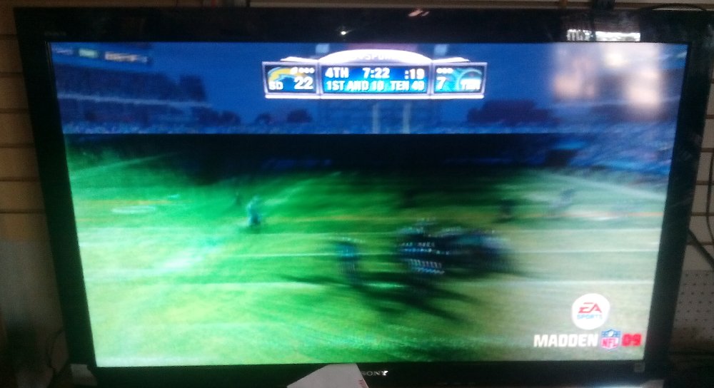

Sony KDL-52V5100, Left Middle Blur Pre-Warmup, Right Side OK, Top Bar Discolored
  • Michale32086
    • Nov 2011
    • 1453
    Sony KDL-52V5100, Left Middle Blur Pre-Warmup, Right Side OK, Top Bar Discolored
    Yea, with that subject, it's gotta be
    OK, 52" Sony LCD... When powered up, the Left and Middle areas are darker and a "blur"... Latent images that linger.. And there is a top bar that is normal for color and no blur...
    After the TV warms up (anywhere from an hour to all day depending on ambient temps) the latency/blur goes away, but the lighter horizontal bar remains...
    Initially had it hooked up on HDMI ports and it was ALWAYS blurry/latency.. Left it running for days (3-4) at a time.. Last week the HDMI ports quit working, so I hooked up to COMPOSITE and that's when I noticed it got a better picture after warm-up...
    I read up on TOM's awesome Guide on Plasmas.. It's got the same type of symptom that Tom describes:
    The picture is slow to update (motion blur) and has a purple or lilac tinge to it. When first turned on, it may look like a lava lamp that has not yet warmed up. The screen may not be evenly lit - it may look a bit "foggy". Half of the screen may be more distorted than the other half. When running, it may look like this (excuse the camera shake). This is in about 95% of cases the Z-sustain.
    but then I realized I was dealing with an LCD...
    I have replaced the buffer (buffer??) boards on the sides with no change to the picture...
    Since I have been walked thru troubleshooting on another set and lived (THANX TW!!! ) I figured I would use this new found skill (courage?) on another one..
    If anyone can point me in the right direction, I would be greatly appreciative..
    Michale
  • freakaftr8
    • Oct 2012
    • 3743
    Re: Sony KDL-52V5100, Left Middle Blur Pre-Warmup, Right Side OK, Top Bar Discolored
    this is most likely due to a tab bonding issue on the panel itself the small ribbons that are enclosed behind the metal frame of the LCD screen you could get a can of freeze spray and try hitting the upper left and right corners of the screen and see if it clears up but I'm almost certain that it's at a bonding issue this is very common in Sony and Samsung
    there are many post about this issue and it is curable but probably not long term by putting a buffer shim between the metal frame and the LCD screen
    • Michale32086
      • Nov 2011
      • 1453
      Re: Sony KDL-52V5100, Left Middle Blur Pre-Warmup, Right Side OK, Top Bar Discolored
      And, since it's on the display, replacing parts is likely not on option..
      Would that be a safe assumption??
        Re: Sony KDL-52V5100, Left Middle Blur Pre-Warmup, Right Side OK, Top Bar Discolored
        Yes, it would be known as a "panel failure" and require replacement of the whole panel.
        • Michale32086
          • Nov 2011
          • 1453
          Re: Sony KDL-52V5100, Left Middle Blur Pre-Warmup, Right Side OK, Top Bar Discolored
          That's what I was afraid of..
          One last follow-up. Is this a common symptom with LCDs that have the same issue??
          The reason I ask is that I have a Samsung LCD LN40A500 40" that has the same issue. It's blurry and latenty at power up.. The difference is that, with the Sammy, after 5-60 mins, the blurriness clears up and the display is perfect...
          So, I was curious if that symptom usually indicates the same fault...
          Thanx for the replies.. Much appreciated...
          • Carlos#2003%
            by Carlos#2003%
            02-15-2024, 07:52 PM
          • dkneyle
            Sony KDL-46HX850 Can't upgrade/update firmware
            by dkneyle
            Diagnosed this TV as having a failed main board which I've replaced with one from a KDL 55HX850. They are (supposedly) the same board.
            Being 'Smart TV' it requires a firmware reboot when you swap out boards such as T-Con or main board. It starts with a black screen and flashing yellow and green LEDS, indicating it needs that firmware boot. The procedure described all over the web is to put the software into the root directory of a FAT32 formatted USB drive and it should load that up once plugged into USB1 port. But not for me. I can see the LED on the USB chip flash for about...
            09-25-2024, 10:44 PM
            Sony VAIO SVF11N1L2E Hybrid (2-in-1) Fit multi-flip Specification for Upgrade or Repair
            This specification for the Sony VAIO SVF11N1L2E Hybrid (2-in-1) can be useful for upgrading or repairing a laptop that is not working. As a community we are working through our specifications to add valuable data like the SVF11N1L2E boardview and SVF11N1L2E schematic. Our users have donated over 1 million documents which are being added to the site. This page will be updated soon with additional information. Alternatively you can request additional help from our users directly on the relevant badcaps forum. Please note that we offer no warranties that any specification, datasheet, or download...
            09-06-2024, 05:27 AM
            Sony VAIO Duo 11 Hybrid (2-in-1) Duo 11 Specification for Upgrade or Repair
            This specification for the Sony VAIO Duo 11 Hybrid (2-in-1) can be useful for upgrading or repairing a laptop that is not working. As a community we are working through our specifications to add valuable data like the Duo 11 boardview and Duo 11 schematic. Our users have donated over 1 million documents which are being added to the site. This page will be updated soon with additional information. Alternatively you can request additional help from our users directly on the relevant badcaps forum. Please note that we offer no warranties that any specification, datasheet, or download for Sony VAIO...
            09-06-2024, 05:30 AM
            Sony VPCF13S1E/B Specification for Upgrade or Repair
            This specification for the Sony VPCF13S1E/B can be useful for upgrading or repairing a laptop that is not working. As a community we are working through our specifications to add valuable data like the VPCF13S1E/B boardview and VPCF13S1E/B schematic. Our users have donated over 1 million documents which are being added to the site. This page will be updated soon with additional information. Alternatively you can request additional help from our users directly on the relevant badcaps forum. Please note that we offer no warranties that any specification, datasheet, or download for Sony VPCF13S1E/B...
            09-06-2024, 05:27 AM
