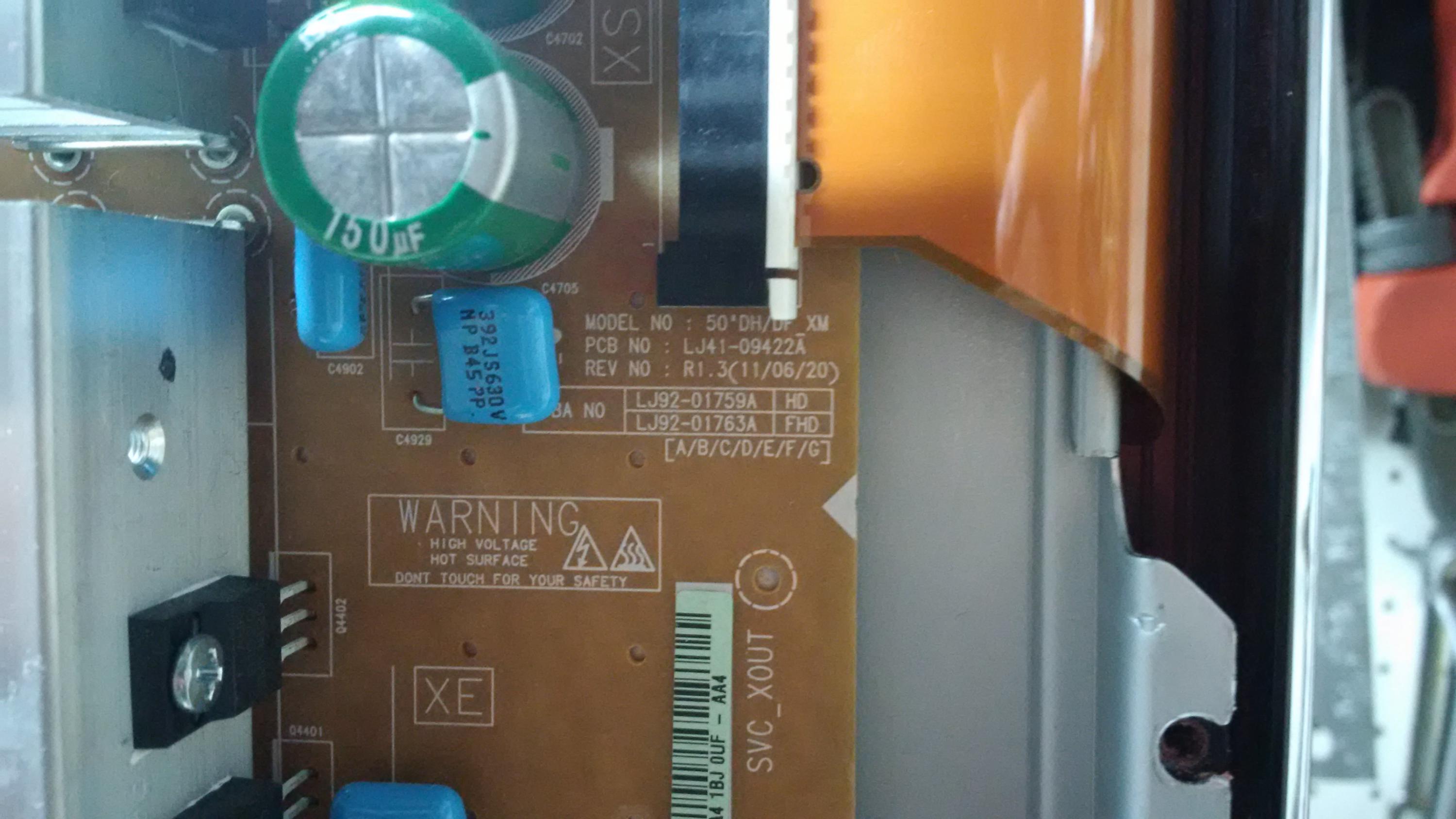

    The suspected dead x-main I have is this:
    Model: 50'dh/df_XM
    PCB: lj41-09422a
    rev r1.3(11/06/20)
    lj92-01759a
    lj92-01763a

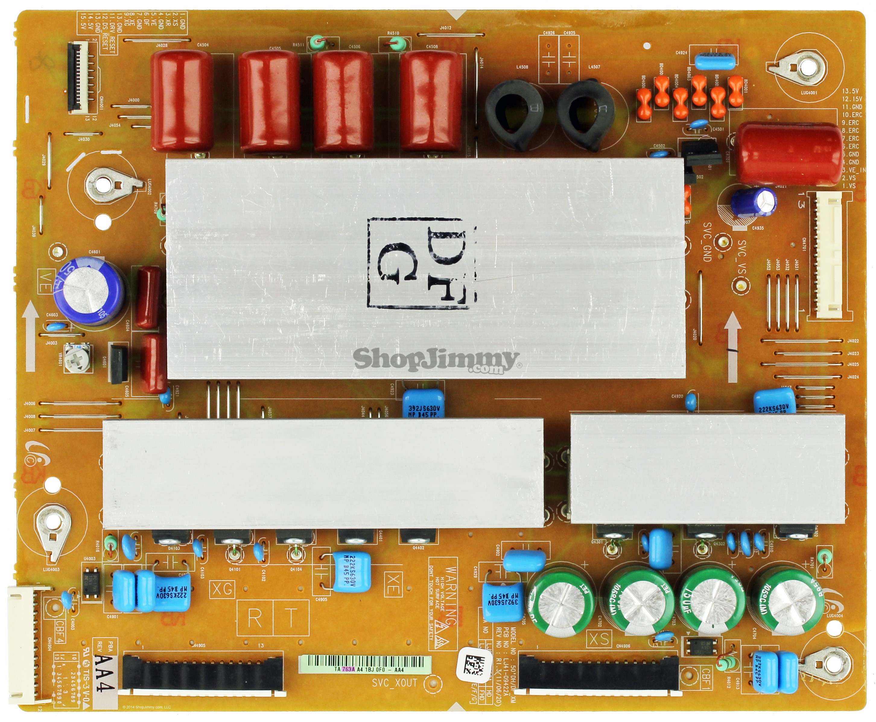

      Here are some pictures of the board. One I pulled off a site that sells them, and the other is a close up of the info off the board taken from my phone.
      Thanks for looking!
        Re: Samsung pn51d550C1fxzc plasma died, hope to fix
        Wow, this board is failing a lot. 4 or so posts in the same week?
        The IGBT is bad if shorted, but there may also be other IGBTs bad in the same area. Often the IGBTs are arranged in half-bridge pairs, a high and low IGBT for the sustain voltage, for example. If you find the low bad, you must replace the high, and vice versa, unless you can be certain they are all ok. It's usually simpler just to replace them.
        Also, I would always replace any driver chips which control the IGBTs, this is because in some cases the IGBTs can damage the drivers when they short. If this is the case, turning on the set with new IGBTs but old drivers would cause the new IGBTs to burn up, as they would be given incorrect gate drive. This will involve surface mount soldering work in most cases but it's relatively easy 1-layer PCB stuff, hard to do wrong.

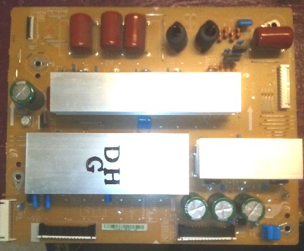

            Here's what I have...
            Can't vouch for it's functionality... PM me your shipping addy and I'll get it to you. If it works for ya, then just cover my shipping and we'll be square...
            Michale
              Michale, 'fraid that's a 720p board (probably PN51D450 or D490) and so probably wouldn't work in his 1080p set.

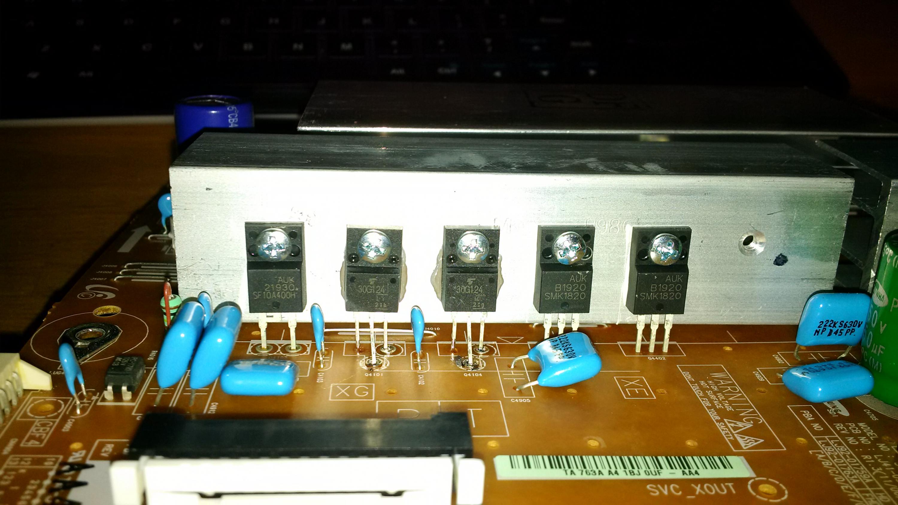

                      What did you use to repalce the FETs? You must use exact replacements.
                      Also it's often advisable to replace the driver chip that controls the FETs.

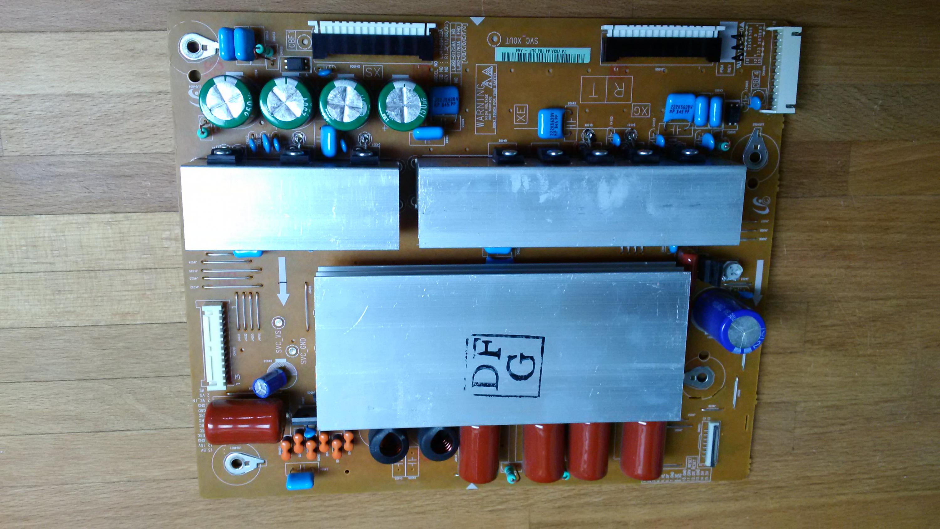

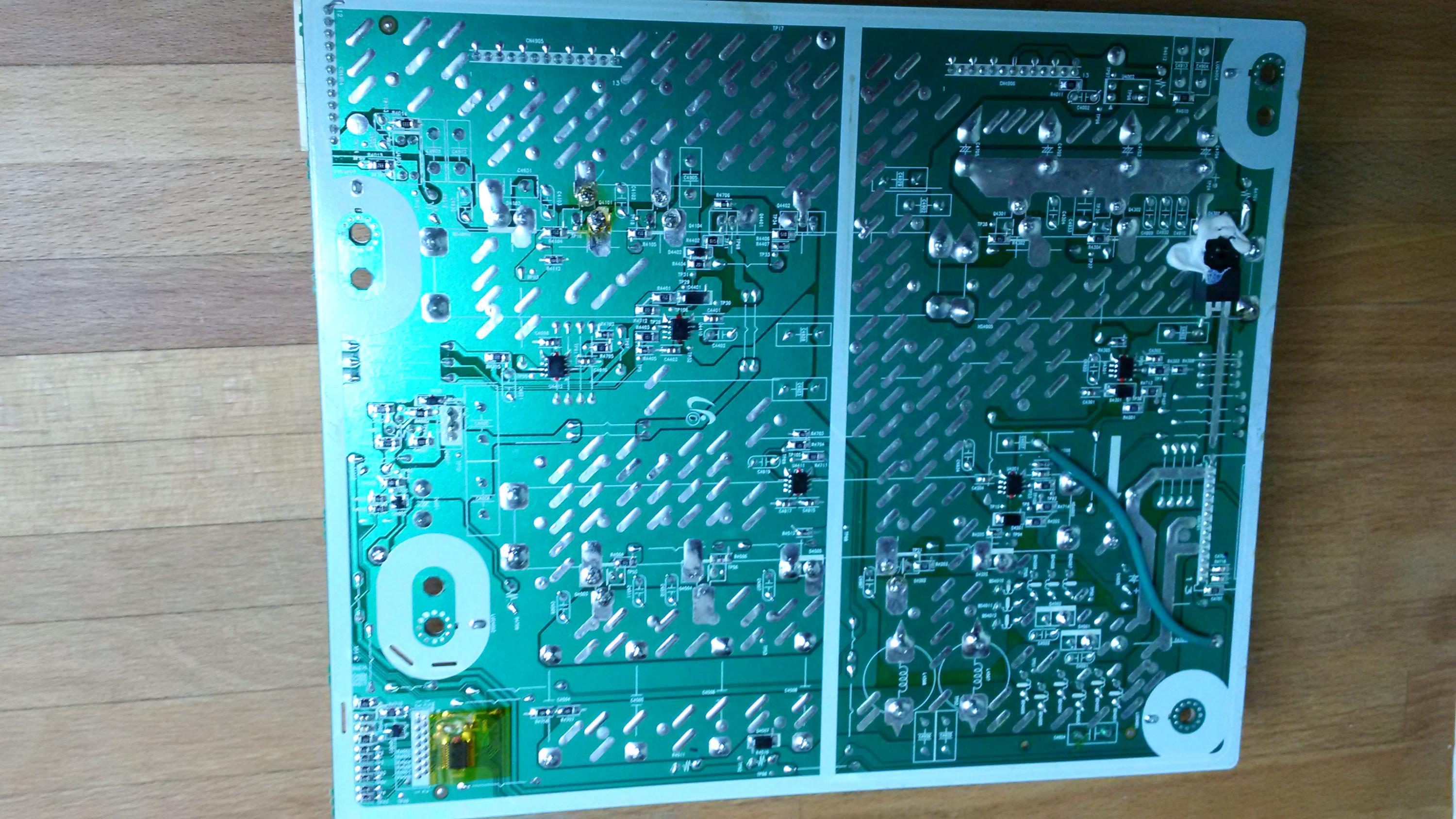

                        I replaced the fets with the same part number as was written on them. Toshiba 30g124. I don't have enough experience to identify which ones are the driver chips that you're referring too. I've attached 3 pictures, one of the back of the board, one of the front, and one of the fets including 2 I replaced. If you could point me to the driver chips, that would be very helpful.
                        Thanks!
