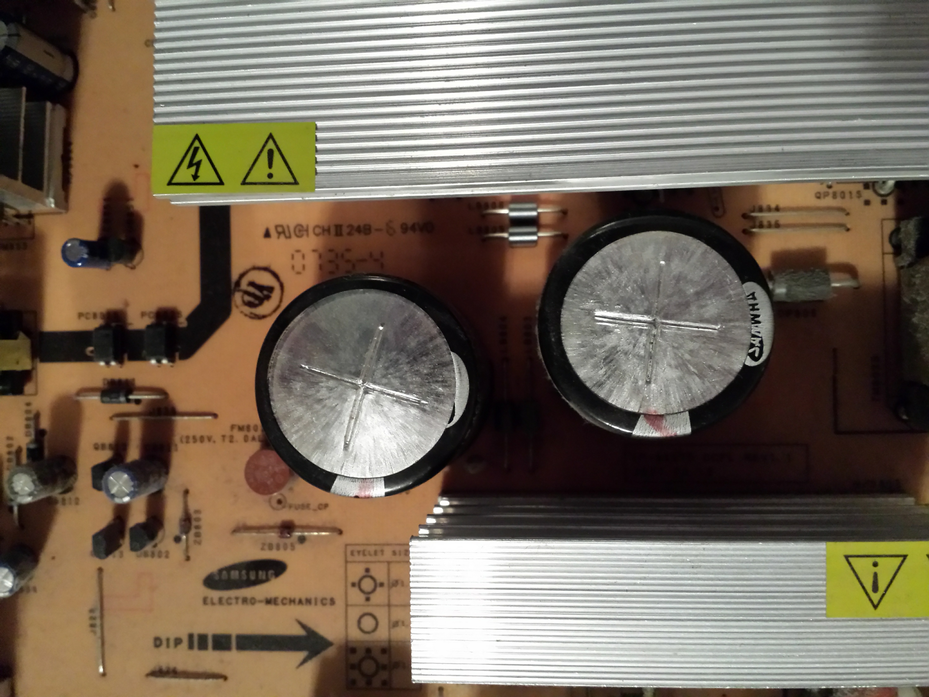

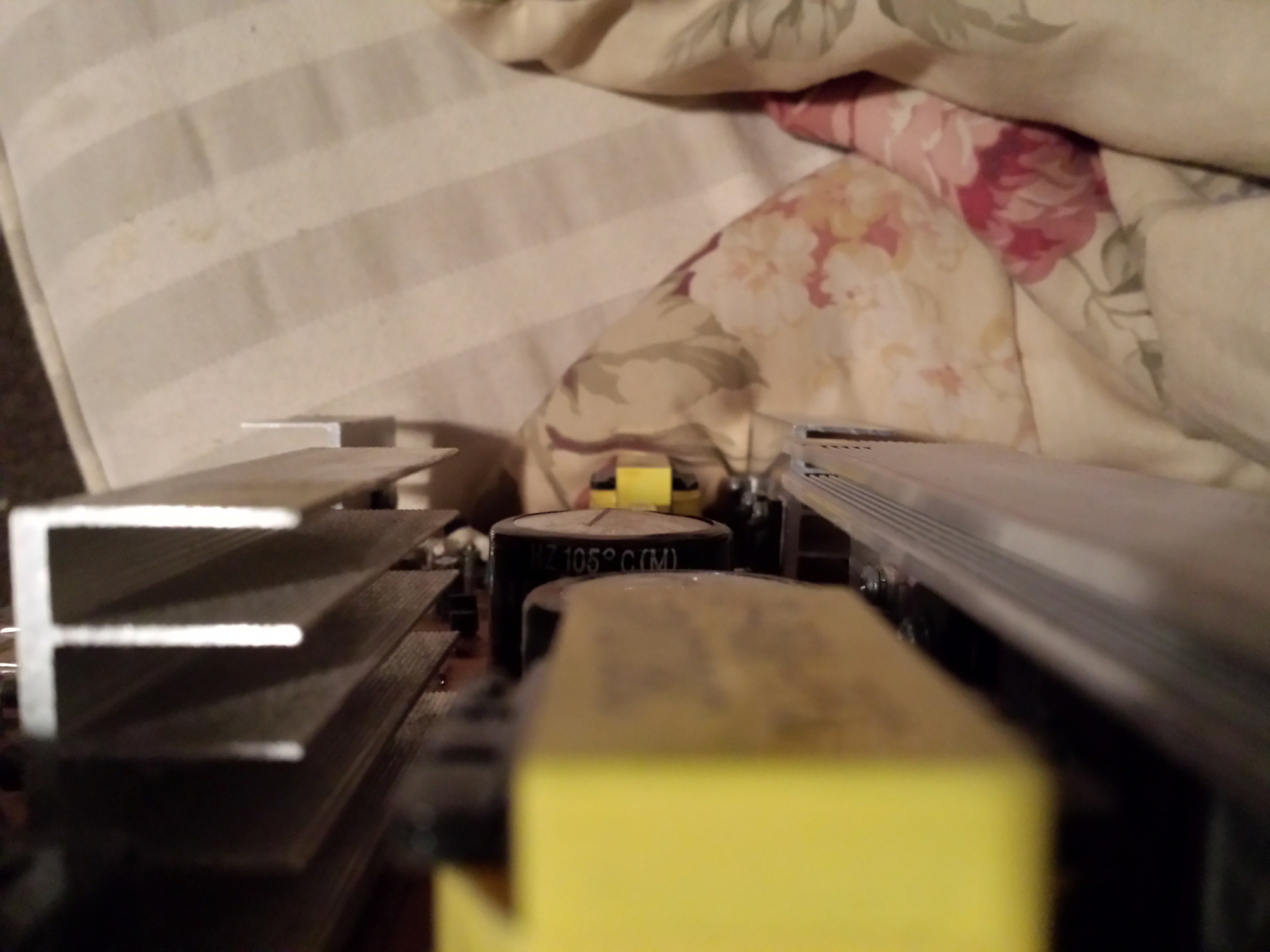

    Samsung LN-T4665F bad PFC caps, what series to replace with?
    As the title says, I have a bad PFC cap, and it's the first time I've ever encountered a bad one. It's a 450wv 150uf. I usually go with Panasonic FC, FM, or FR. I can't find any in those series though, so I'm not sure what to get. There's actually 2, but only one looks bad. Should I replace both? Lead spacing is 10mm, diameter is 35mm. There's room to play though.

    Re: Samsung LN-T4665F bad PFC caps, what series to replace with?
    If one died the other is probably on its way out. In any case it sounds like a bad brand as it looks like these guys had the same problem with Samwha capacitors too: https://www.badcaps.net/forum/showthread.php?p=494827
    https://www.badcaps.net/forum/showthread.php?t=10001
    You won't find the value\voltage in a Low ESR series as primary capacitors are not typically Low ESR types.
    Make sure you check voltage on them and discharge if needed before putting your fingers\soldering iron near their leads when removing.
      Yeah, these are Samwha too. I think the same series as in the link you posted. HZ series. I figured it'd be wise to replace both. I'd sooner do it right the first time.
        So, general purpose caps are OK?
          These OK?
          http://www.digikey.com/product-detai...C30-ND/2428153
            Probably, if the replacement is the same size or bigger it should be just fine. To be paranoid, you could check the Samwha datasheet and check ripple current rating but HZ is not listed here: http://www.samwha.com/electric/produ....html?f_num=40
            In fact neither is LP series that was used in the other thread. Presumably they are custom ordered ones or a discontinued series.
              I couldn't find a data sheet for them earlier when I looked. And, being that Hz is the abbreviation for Hertz, Googling it seems impossible.
                Without knowing the specification it might be smart to use whatever will physically fit and has the highest ripple handling you can find.
                  Ordered them already. Digi-key didn't have much selection, in stock anyway. Unless I'd went with a different can size, maybe I should have. They're rated 10000 hours @105°, ripple current 790mA. My understanding of the ripple current rating was backwards, I'd mistakenly thought the lower the rating, the better.
                    No. The ripple current rating is like the voltage rating, the higher the number the more it can handle. If you go below what the original was, or rather, below whatever the circuit expects the capacitor to be able to handle, the replacement capacitor lifespan will likely be shortened as it tries to cope with more ripple than it can handle, which will result in higher operating temperatures.
                    ESR is the one that is typically better when lower, although depending on the circuit this is not always the case.
                      I'm going to call Digi-key and see if I can change it to these ones.
                      http://www.digikey.com/product-detai...1676-ND/483274
                        I got through in time and changed them.
                          Looks better - and cheaper too.
