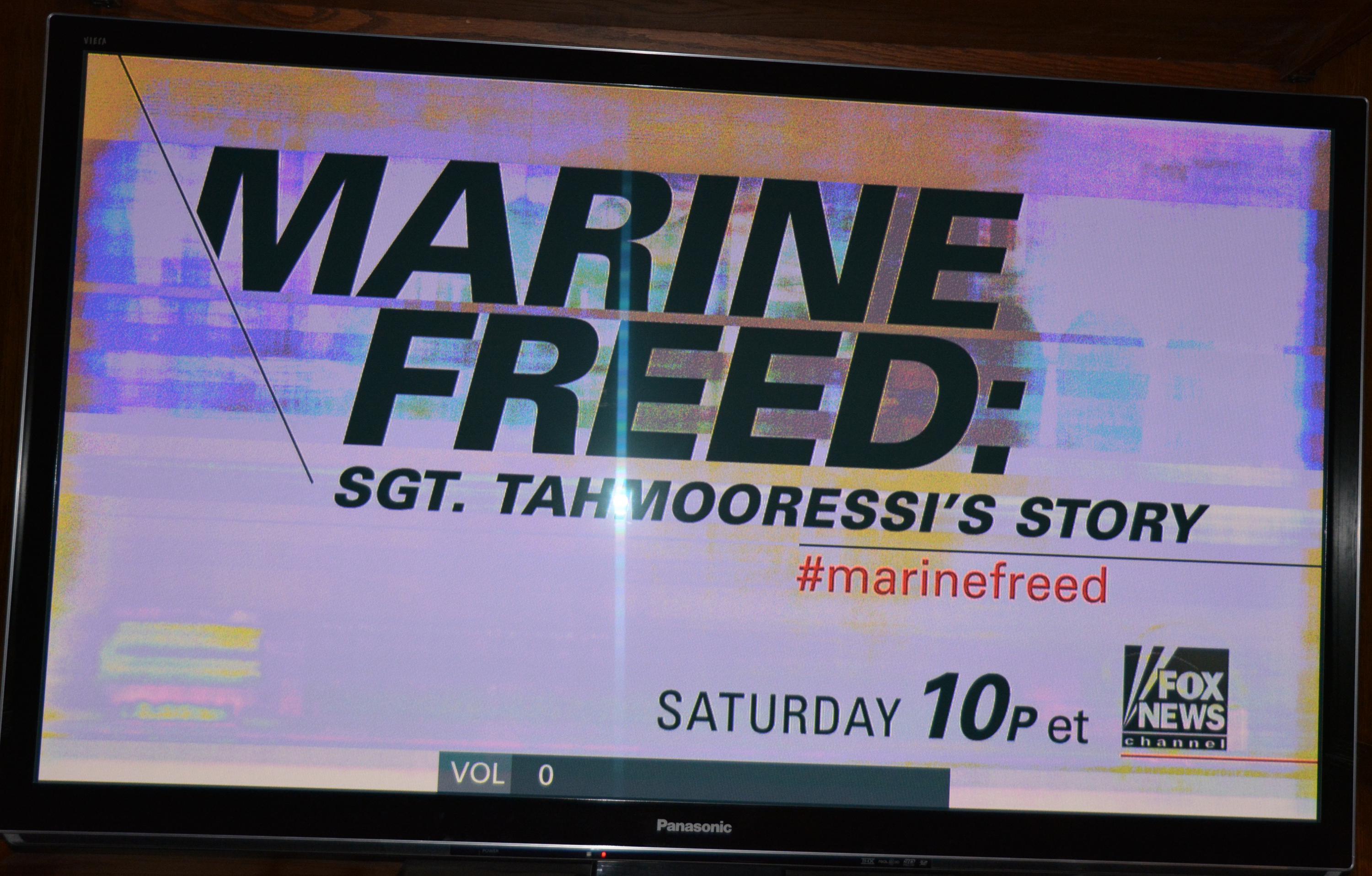

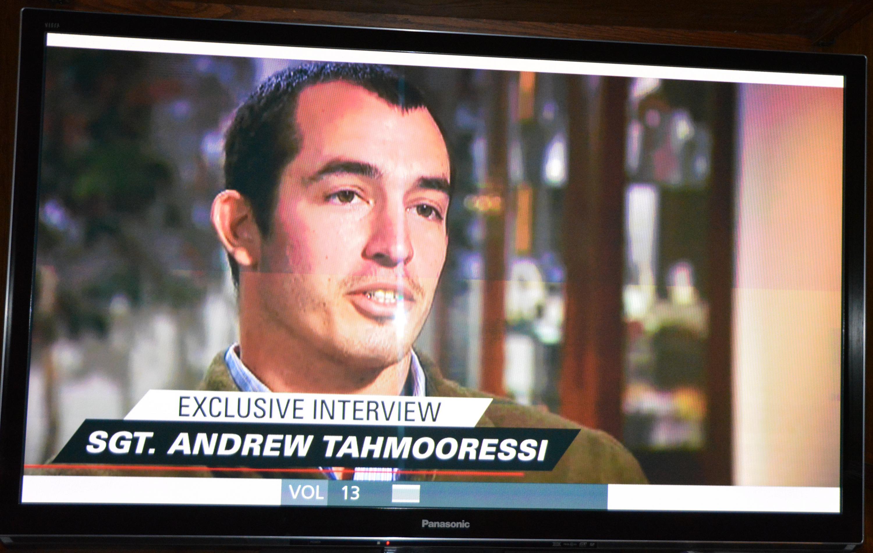

    Hi all. I am having an issue with my plasma for up to about 30 seconds after I first turn it on. After 30 sec's, the problem is gone until the set has been turned off for at least a few hours. I basically have this about once a day. As you can see from the pictures, the top half of the picture has some purple tinting/distortion. Depending on what's on the screen it is not that bad or pretty bad and it is exactly 1/2 (top) of screen. This leads me to suspect the upper y-buffer, but I have also read that the z-sustain leads to purple tinting. I have not heard of that really affecting only half of the display though. I'm thinking replace the upper y-buffer. I'd be interested in thoughts of those with much more experience than me. Thanks in advance.

    Sorry, I was having trouble uploading pictures...attached now.

      I'd be taking the back off , remove the Sc and ss boards, make sure the mount points are clean, check likewise the pads on the boards are good. make sure the screws are tight and firm against the board making good contact with the earth points.
      I suspect this model also suffers from loose screws and or wrong type fitted.
      If you look at this link, you'll see kits with new screws.
      http://www.shopjimmy.com/catalogsear.../?q=TC-P55GT30
      if you do this sooner rather than later it may save the boards blowing.
      i've read stories where people have left it and after a while the Sc board shorts,, possibly also the Sd/su boards go too which I'd also make sure are earthed and screws tight but the screws also need to make good contact to earth all the boards correctly.
      If the Tv becomes more reliable and stable after doing this then maybe look into new screws.
      i have not touched any of that generation but I get the feeling from what Ive read if you address this now it may save the Tv .It's a theory but no harm in having a go before she blows.

        DO NOT RUN THE TV ANY MORE!
        If you continue the SC board will be damaged increasing the expense of the repair.

              Yeah, first signs of ER circuit malfunctioning. This will kill SUS-UP/SUS-DN IGBTs which will then nuke the rest of the SC board. So it is absolutely critical that the TV not be used any more as no damage has currently happened but it may happen soon. How long, I have no idea.

                              Quick update. For starters, this is the first time I have opened up a plasma. I removed the power and let sit for a day then pulled the back off. On this particular TV, the back panel is thin sheet metal and sharp enough to cut your fingers deeply (don't ask me how I know this), so use gloves. If the back doesn't come off without prying, then there is still a screw lurking somewhere. If you get all the screws out, the back comes off pretty easily. I stress again, watch the sharp edges.
                              I cleaned it out thoroughly and started checking the connections and tightening screws. All connections were very secure. Most screws were able to be tightened a little bit and I was careful not to overdo it. 3-4 screws on the SC board were extremely loose. I probably got a full turn and a half to 2 turns on 3 of them, less on a fourth. A couple of screws on the SU board seemed a little loose as well, but probably not enough to really cause a problem. I tightened every screw inside carefully to the point that I felt good contact was being made. Put the cover back on, connected everything and turned it on. The problem seems to be resolved. I say this with relative certainty because every time I have turned it on cold for the past three weeks or so the problem presents itself without fail. My sample size so far is only 1, but it worked fine the first time. Will report back in a week or two just to be complete.

                                If it was me i would have removed and confirmed no arcing or burn marks regardless to be thorough as these could still create a bad earth but sounds like you have saved it. A good lesson for other owners as prevention is better than the expense of repair.
                                What you found confirms exactly what Tom and I were expecting. maybe a dob on non permanent loctite may be a good long term fix as well.

                                  Happy to report that this issue is definitely resolved. Kudos again for the folks on this forum who helped me out.
