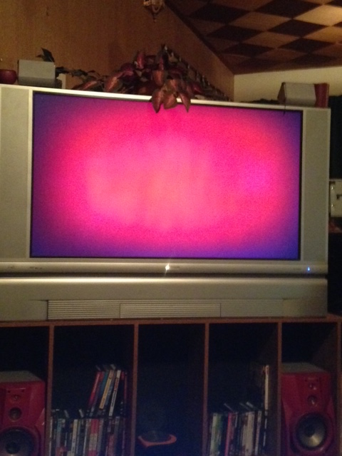

    I have a rear projection tv with a color problem. Does anyone know what would cause this?

    Yes, its the light engine that needs replacing, the fault is that the optical filters are discolored (burnt) from heat and possibly poor ventilation as the fans get pluged with dust.
    New pt# UX22202D Rebuilt UX22202DR
    I do not recommend replacing, too costly.
    Here is a service bulletin regarding cleaning but it won't help
      Agreed !
