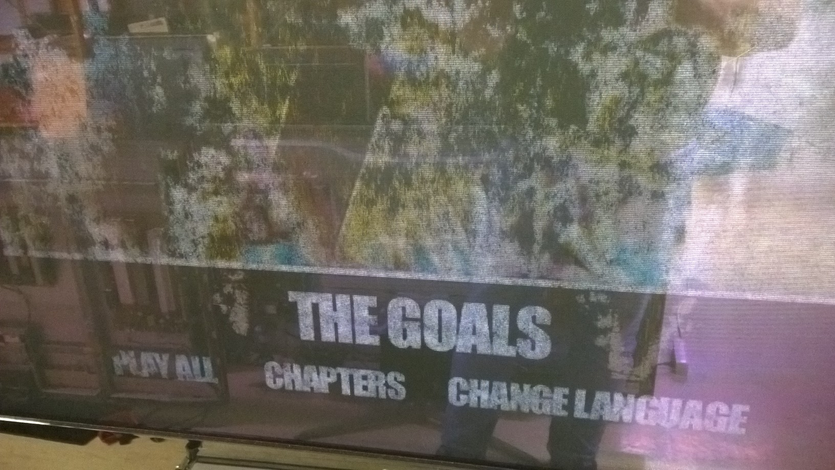

    Hi all
    Samsung PS50Q96HD plasma.
    At first I thought this was the "famous" Y-buffer issue.
    But looking at the screen it tells me more it's an X-main issue, right?
    When powering up the set behaves like a cracked screen, certain random areas of the screen are completely black, but awake after a minute or so and grows more and more to a picture.
    What do you say guys?
    Re: Samsung PS50Q96HD X-main issue?
    Good chance of X-main being bad. Can also be low Vs or Ve.
    Do you have a scope to check drive waveforms from X-main board?
    • PowerAmpFreak
      • 982
      • Sweden
      Vs and Va up to spec. Ve not checked yet.
      Noticed that after 10 minutes of operation, everything was warm except for x-main heatsinks being all cold.
      Will dig into the X board. Thanks as always Tom!
      • tw2005
        • Oct 2011
        • 6458
        I think there's some pico fuses on that too that may be worth checking
