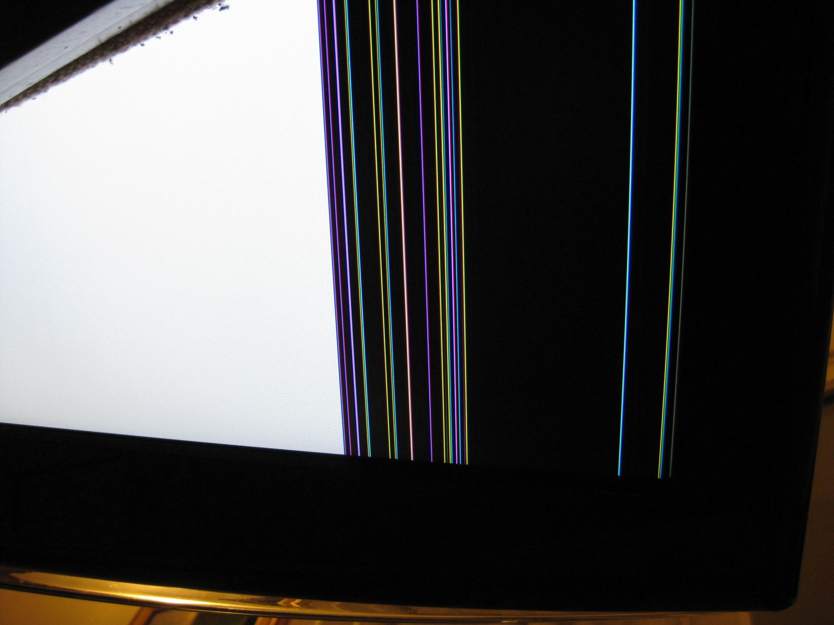

    It seems the same as LE32R87BD and LE32R88BD. The mainboard is BN41-00813B-MP1.0 - BN94-01327A.
    I found a BN41-00813E-MP1.0 for a 40". The tv now powerup, but I got vertical color lines. How could I do to make it works?

    pictures ?

        the board from the LE40R86 is an BN94-01472M
        • Kilroys
          • Feb 2014
          • 70
          • Sweden
          Re: Samsung LE32R86BD
          t-con voltage for LE40Rxxx is 12V
          unless the panel is T400XW01 V1
          but for all LE32Rxxx models it is 5V
          Measure the t-con voltage, must be 5V
          otherwise there is a chance that the t-con is broken

            Is there a way to set the output of the main to 5V?

              Near the tcon connector the 40" version doesn't have the c1156 the is the in the 32" version
              And yes, 12V on 40" main, don't know on 32", mine is broken.

                Look at t-con voltage at Factory Option-32 you see all is 5V.
                At 40" i couldnt find BN94-01472M but as you said,
                it was 12V.
                No I dont know if there is a way to change to 5V.

                  Yes, mine is LTA320WT-L07, 5V. I don't think 5V/12V is set by firmware.
