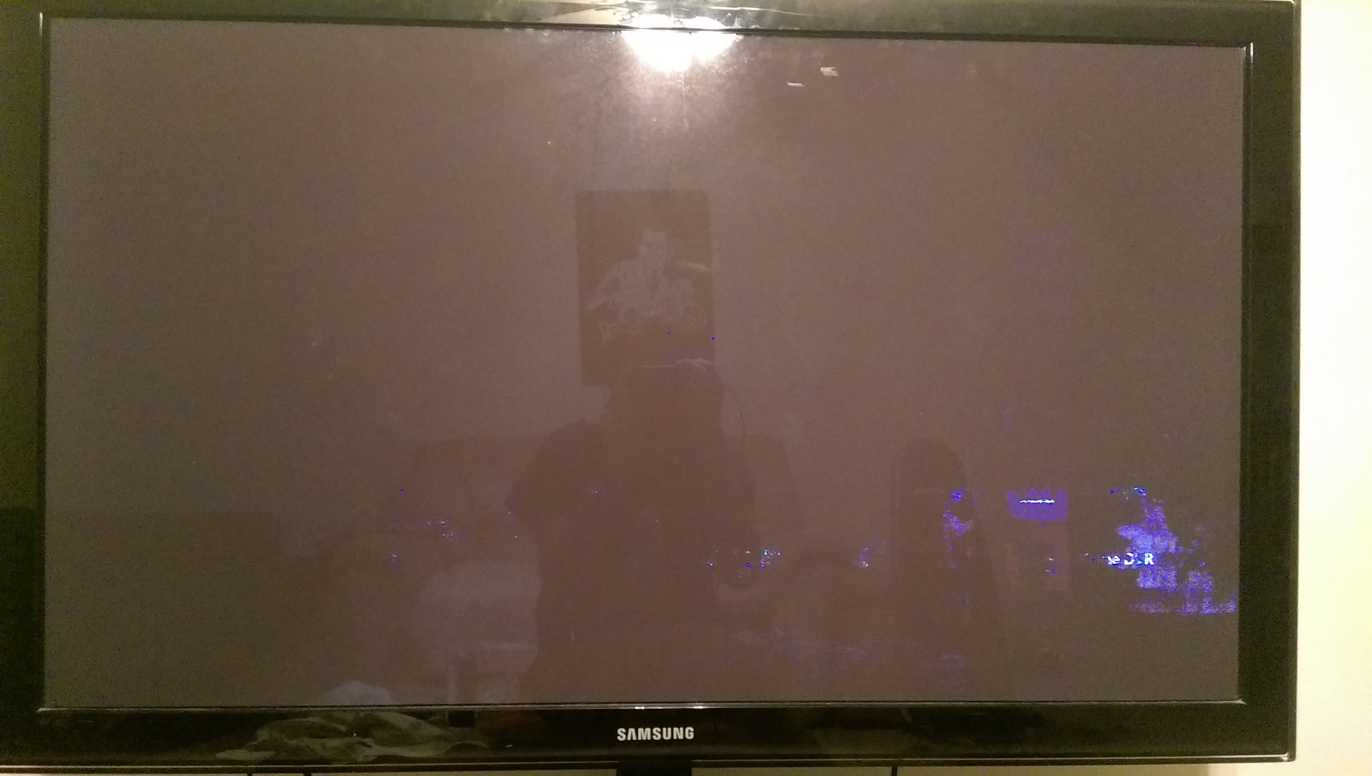

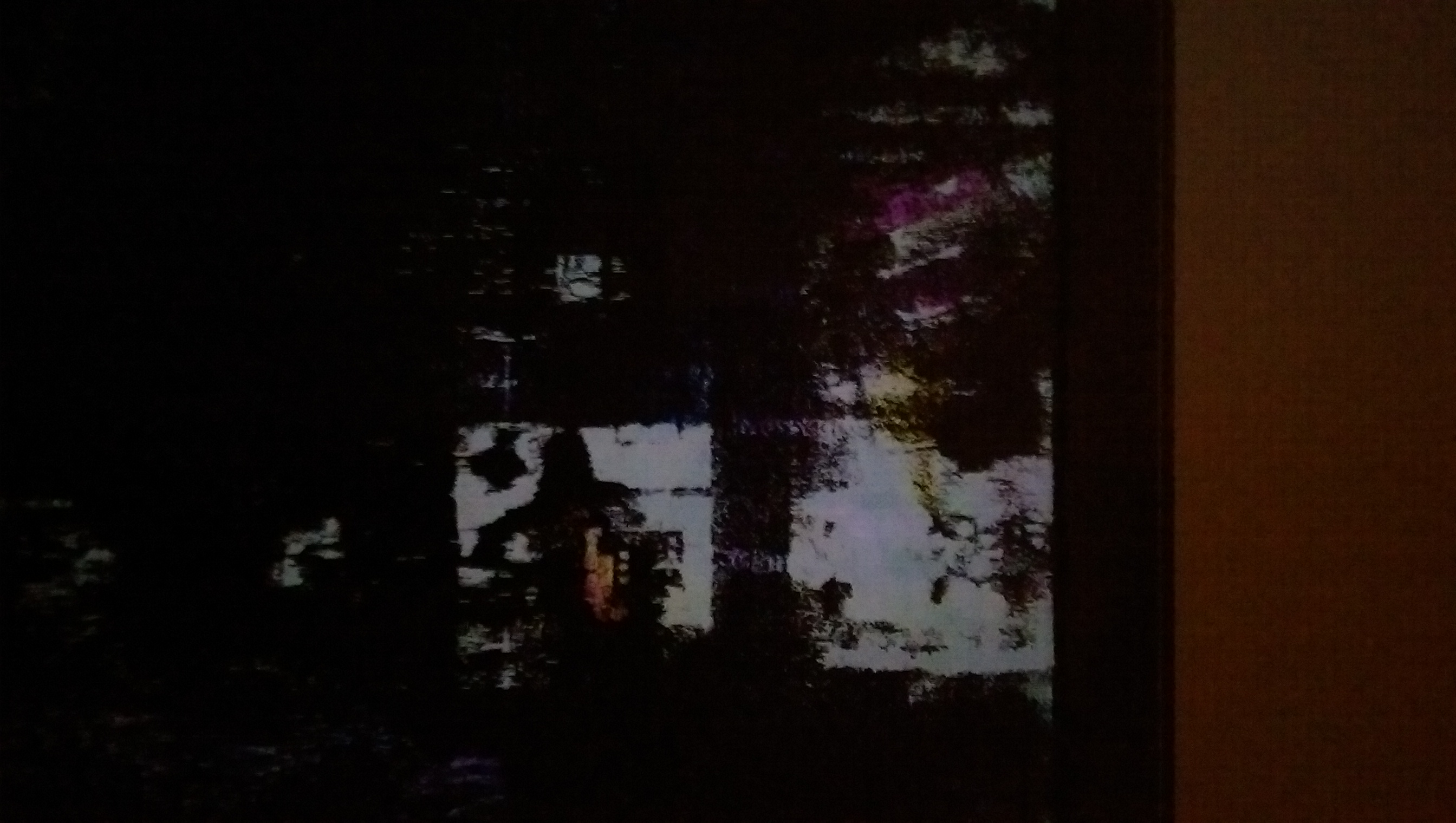

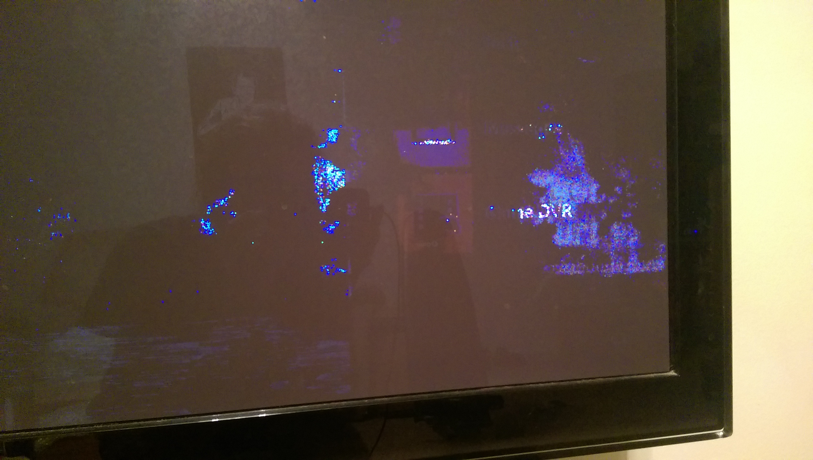

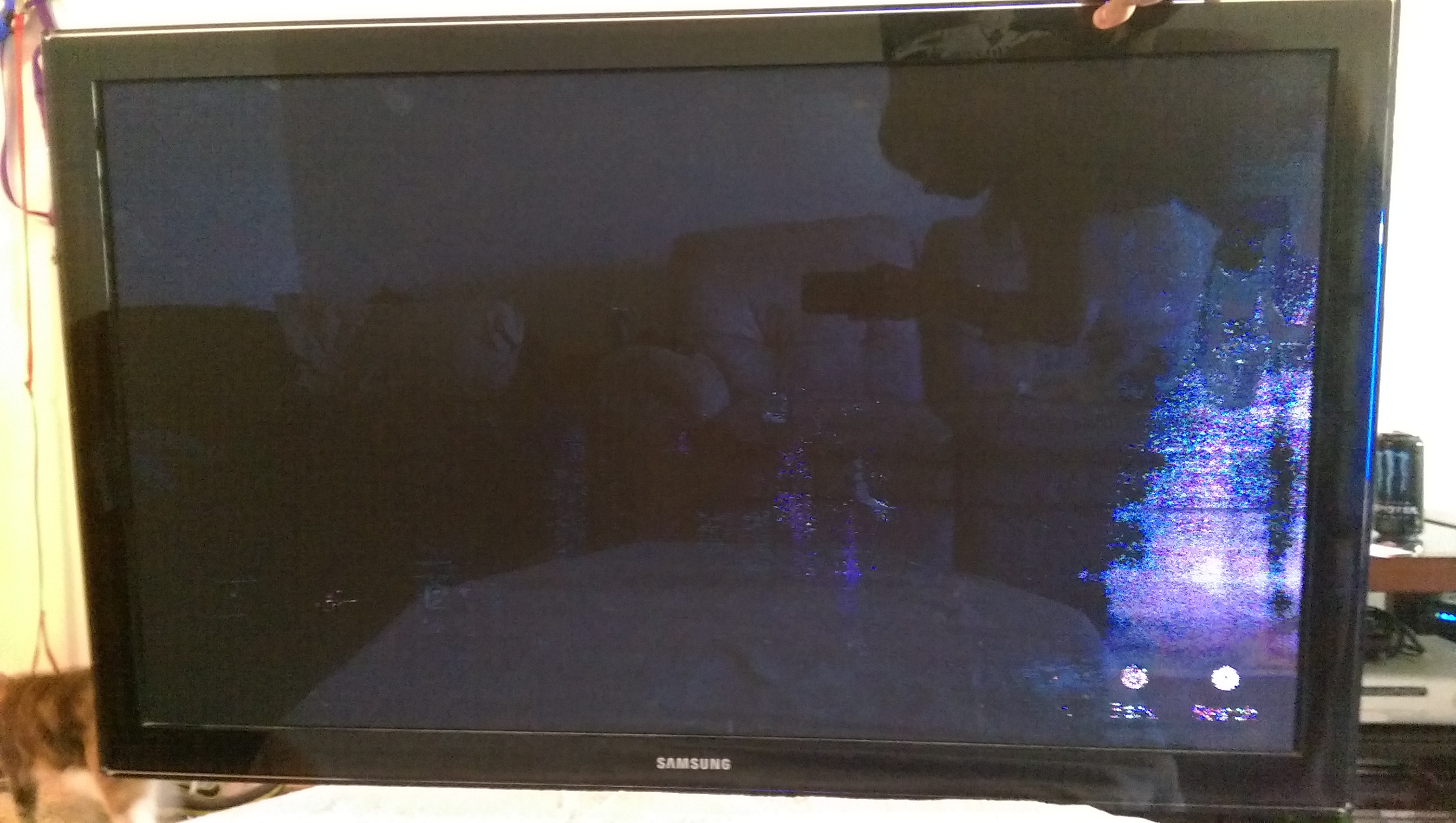

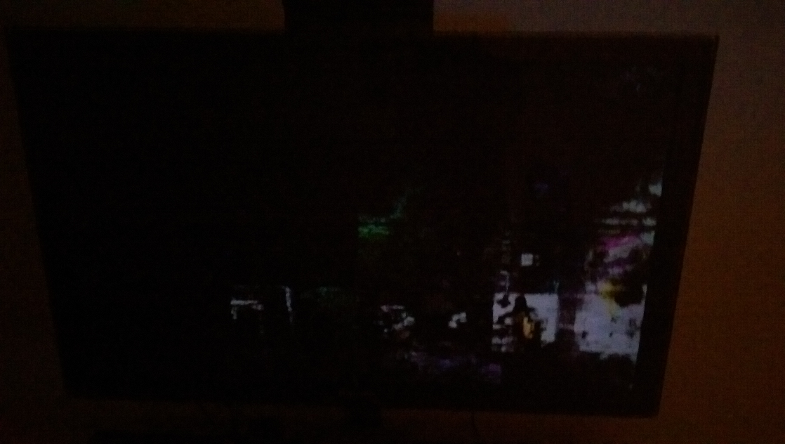

    I have a Samsung PN50C550G1FXZA which suddenly began showing a dark display with what appears to be a form of sparkles down in the lower right-hand corner (when facing the display). The image actively changes when I swap around inputs, but does so with what looks like a strong image burn. I had previously received some information that led me to replacing the X-Main, but doing so has led to no change in the display.
    When the issue originally occurred the set was powered on & functioning normally, then abruptly changed to what appears attached below. I do not recall any odd noises (crackling, popping or anything of the like). Upon examining the internal boards I found no bulged capacitors.

    1. Full-shot of display, powered on with an active input, prior to the swap of the X-main

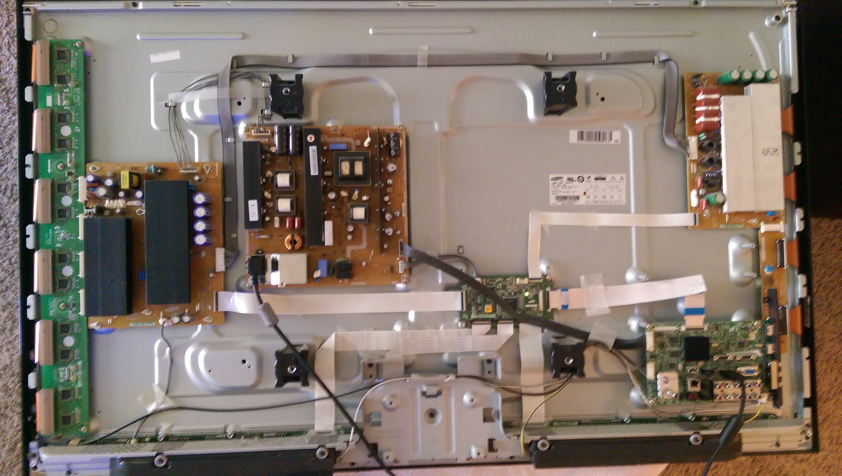

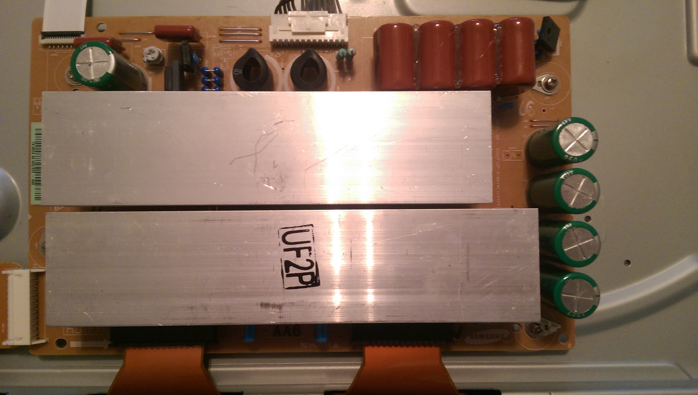

    2. Full-shot of internal boards. I do have close-ups of each individual board if requested.

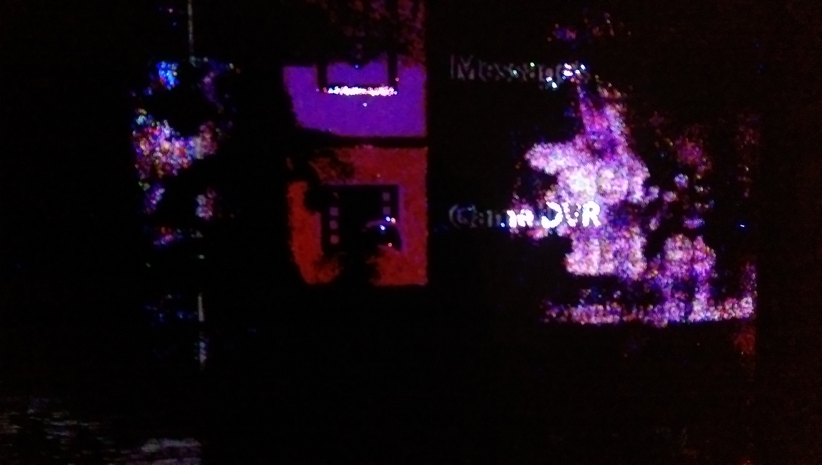

    3. Full-shot of display, powered on with an active input, post swap of X-Main.

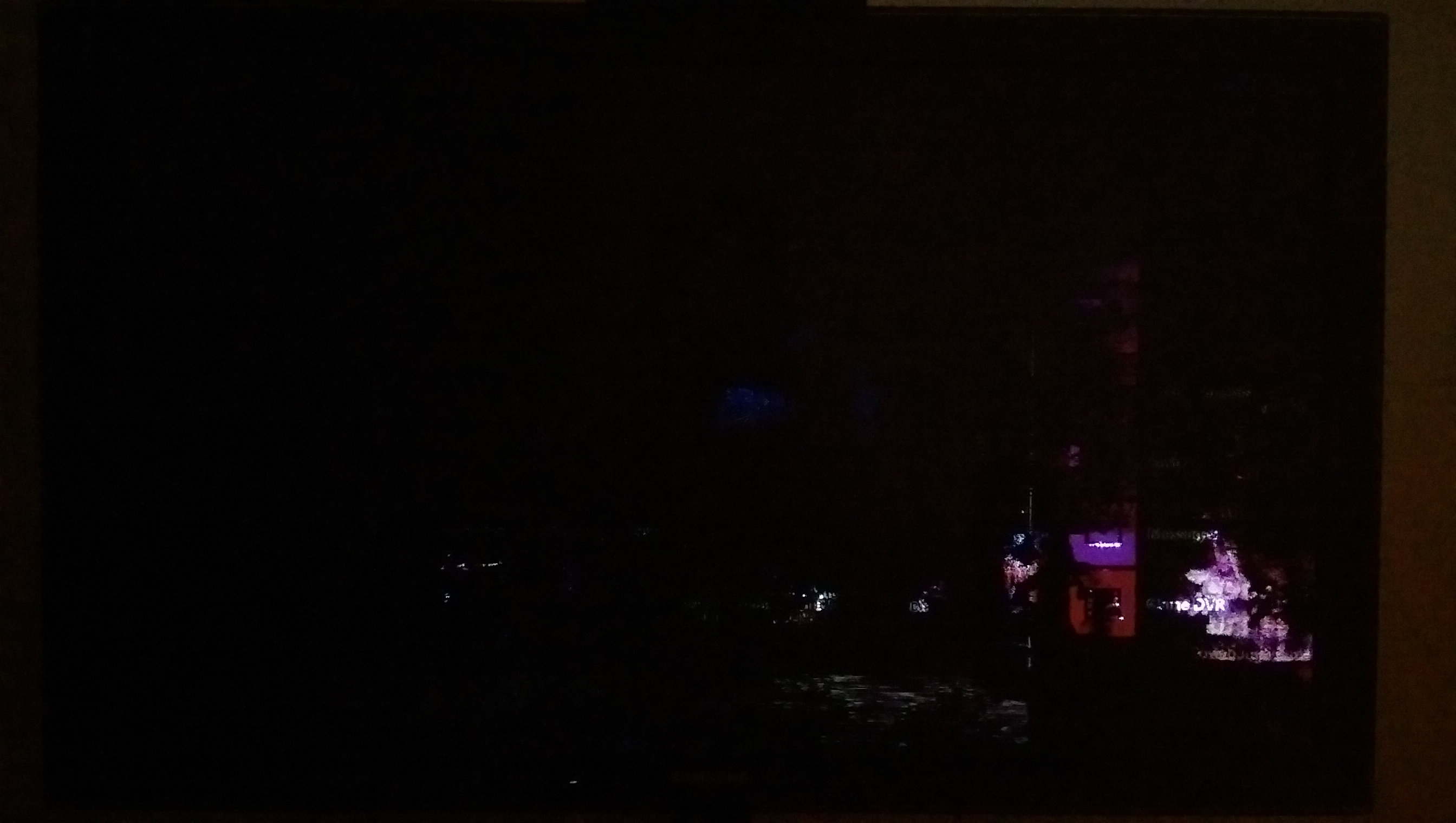

    4. Full-shot of display, powered on with an active input without room lighting, post swap of X-Main.
    5. Close-up of colored portion of display, from image 4. (^)
    6. Shot of display, powered on with no active input, post swap.
    7. Shot of display, powered on with no active input without room lighting, post swap.
    8. Close-up of colored portion of display (solely image burn), from image 7 (^).

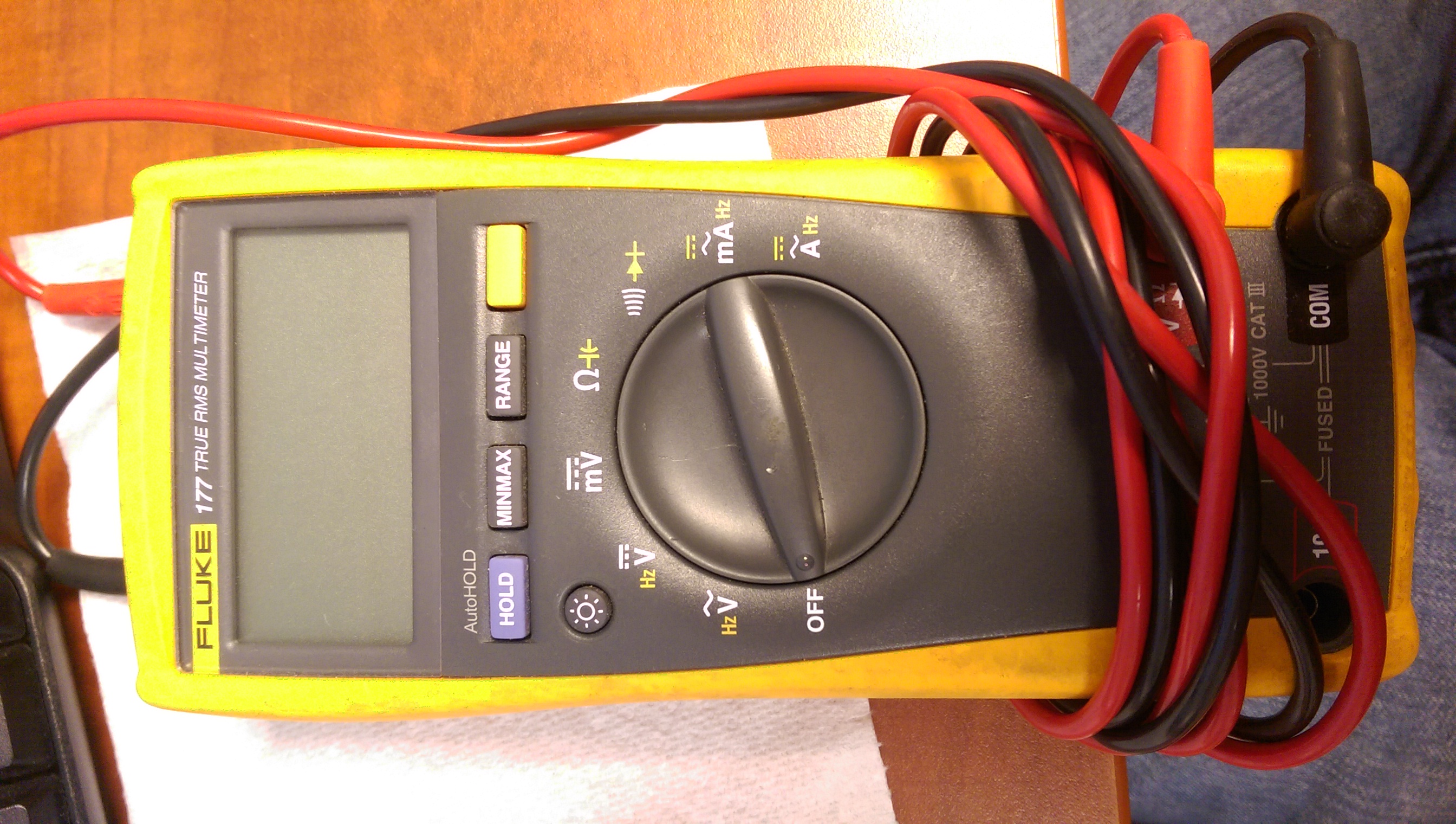

                      I presume this guy will do the job appropriately?
                        Re: Samsung PN50C550G1FXZA - Dark Display with ''Sparkles''
                        That's absolutely perfect.
                        Flukes are good meters.

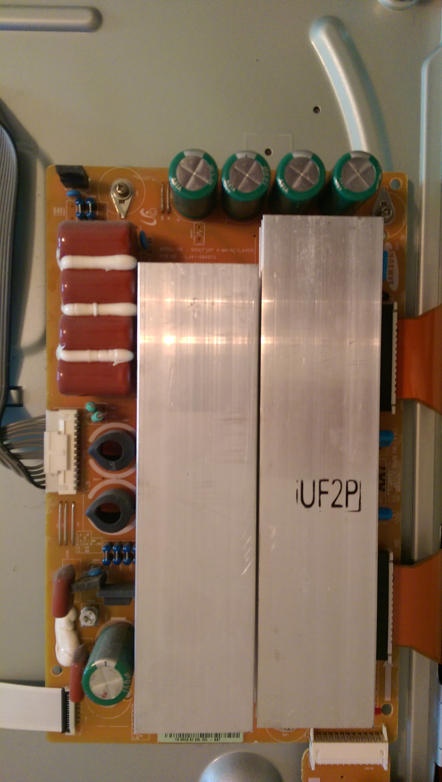

                                    Can you get a CLEAR, FOCUSED image of the board on the right hand side of the panel, connected to the orange ribbons.
                                    https://www.badcaps.net/forum/attach...5&d=1412903159
                                      Yeah,
                                      Sticker shows 209 (206-215) for Vs & 55 (53-57) for Va
                                        The first image is of the X-Main (replacement) that is currently installed in the unit.
                                        The second is the original, prior to its removal.
