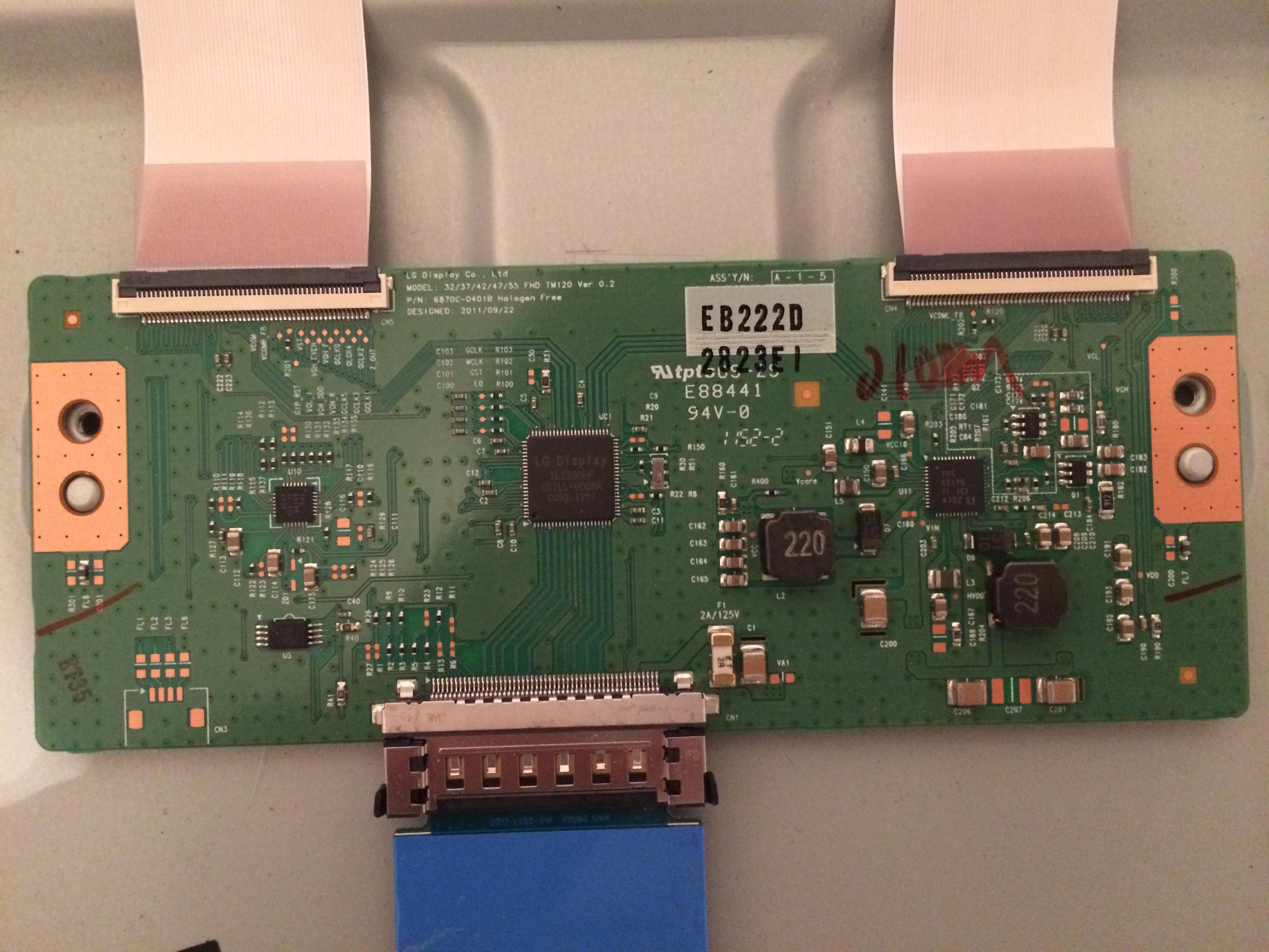

    Hello everyone

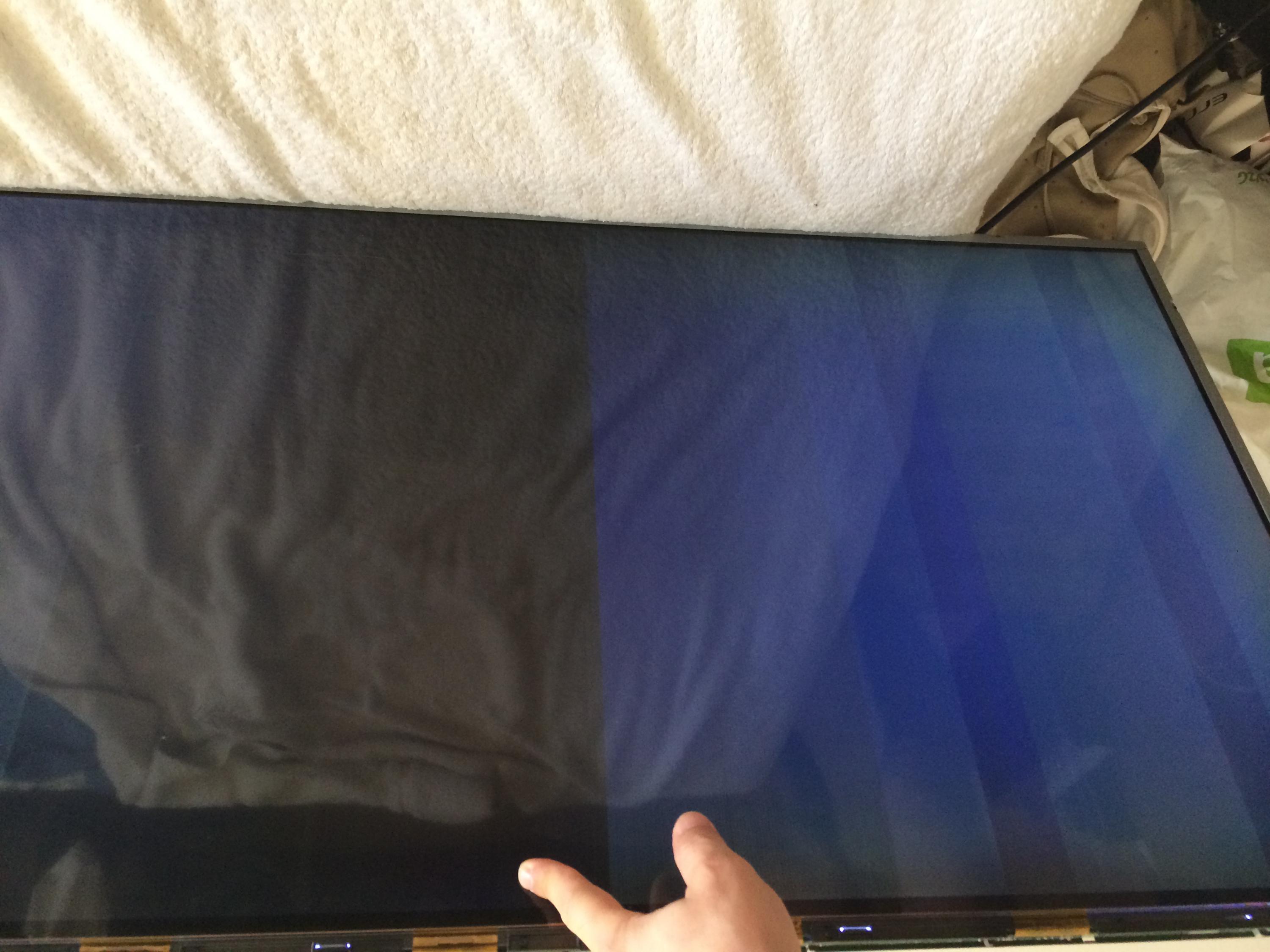

    i have a 42" Led 42lm580y-tc with no picture and no sound (sound only works when playing Through direct audio in but i"m not sure it counts)
    the TV had a small water damage incident before it stopped working as a few drops of water dropped on the top of the screen and fell all the way to the bottom , the TV worked for a little while and then stopped.
    the red led blinks twice when powering it up.(but i wasn't able to find what that means in error code)
    the backlight works fine but there is no picture or manu screen or sound.

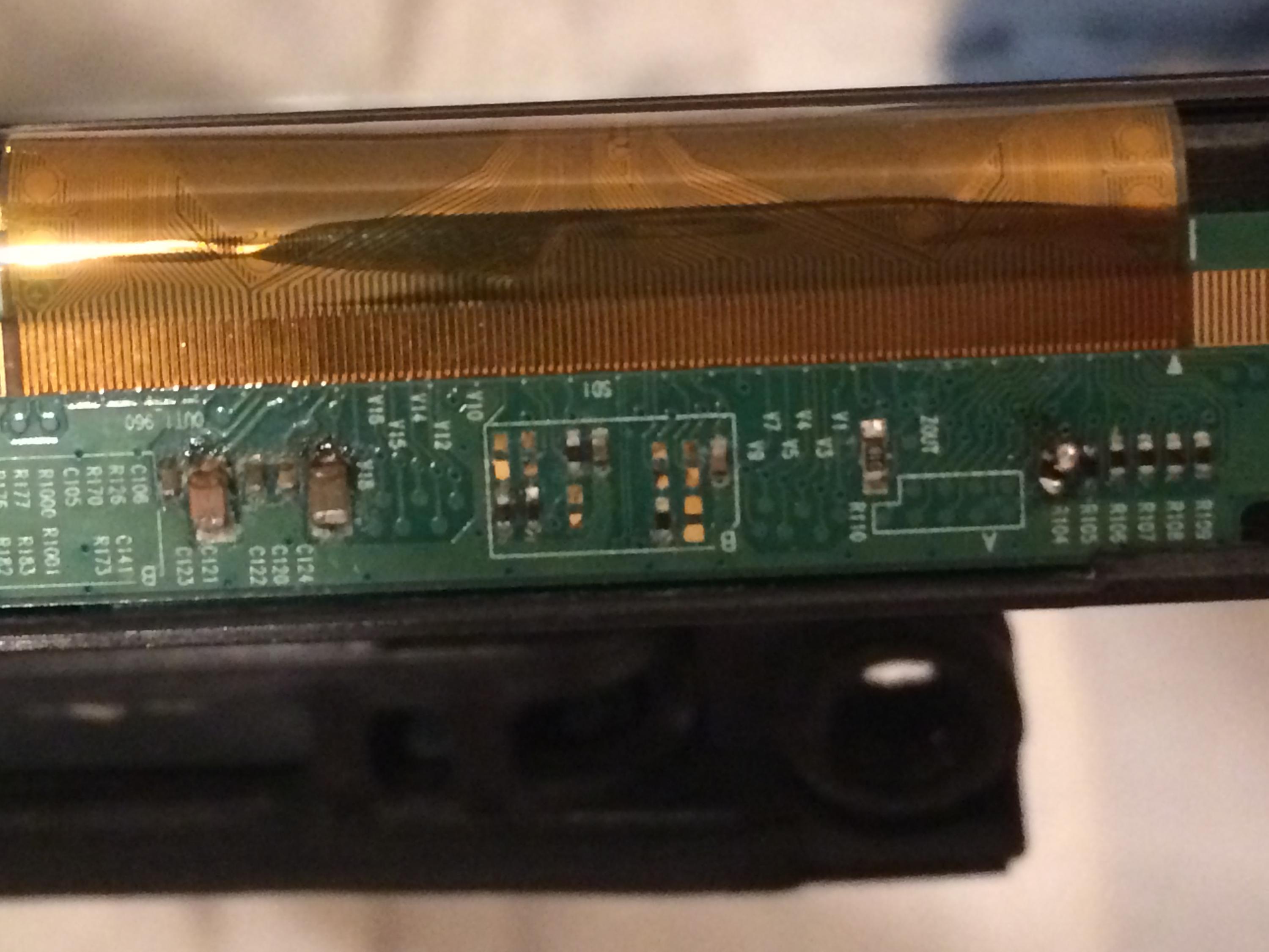

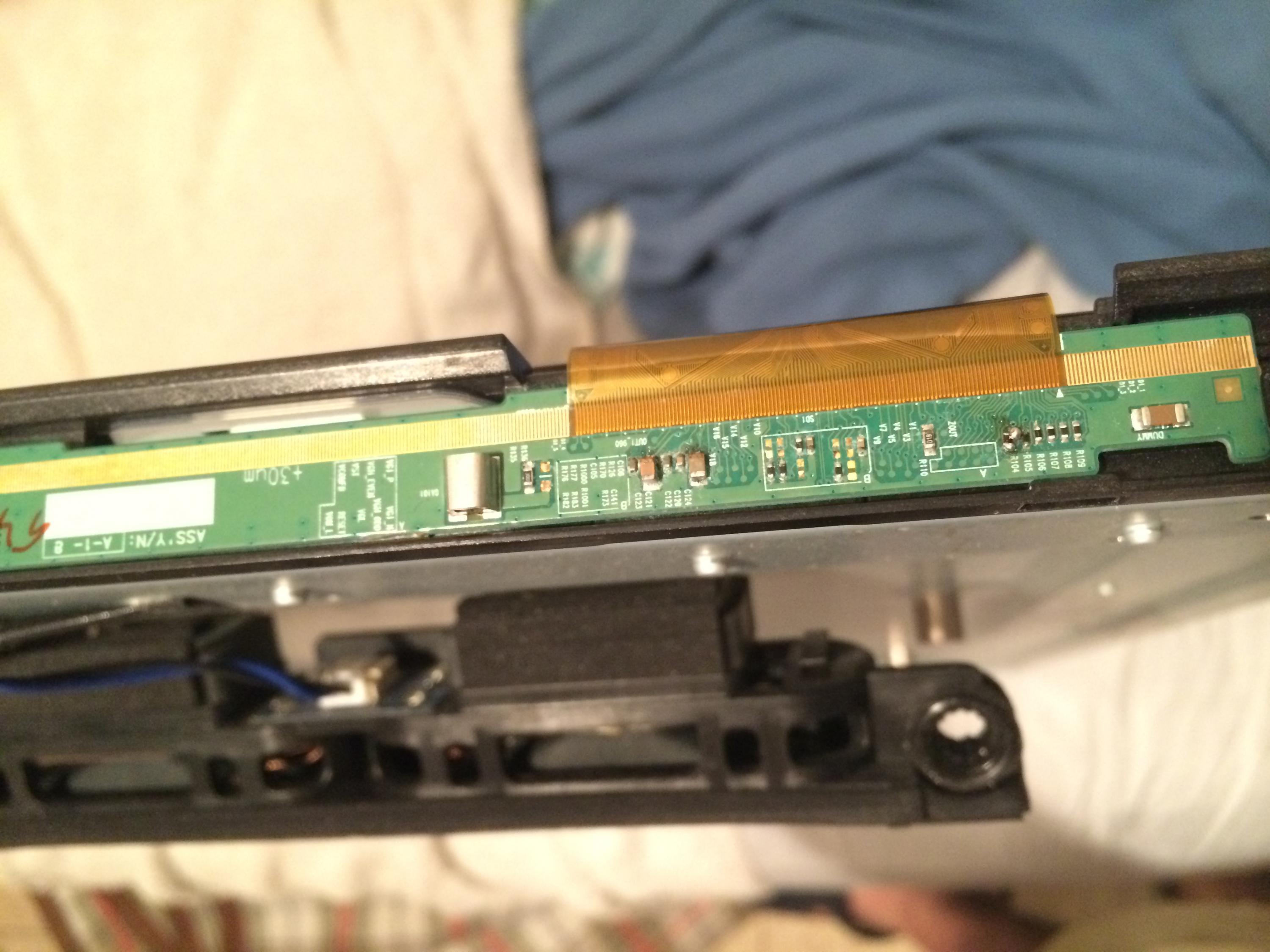

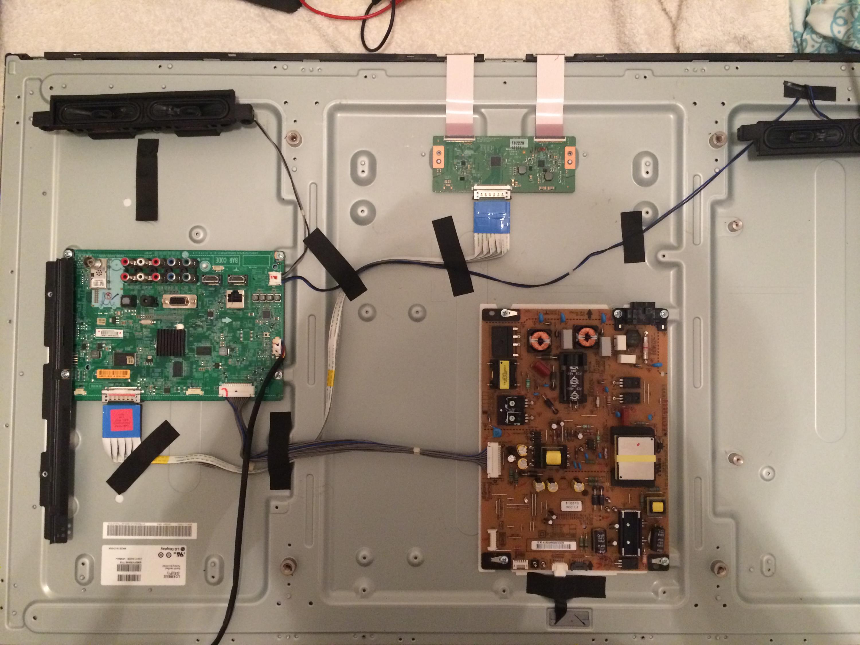

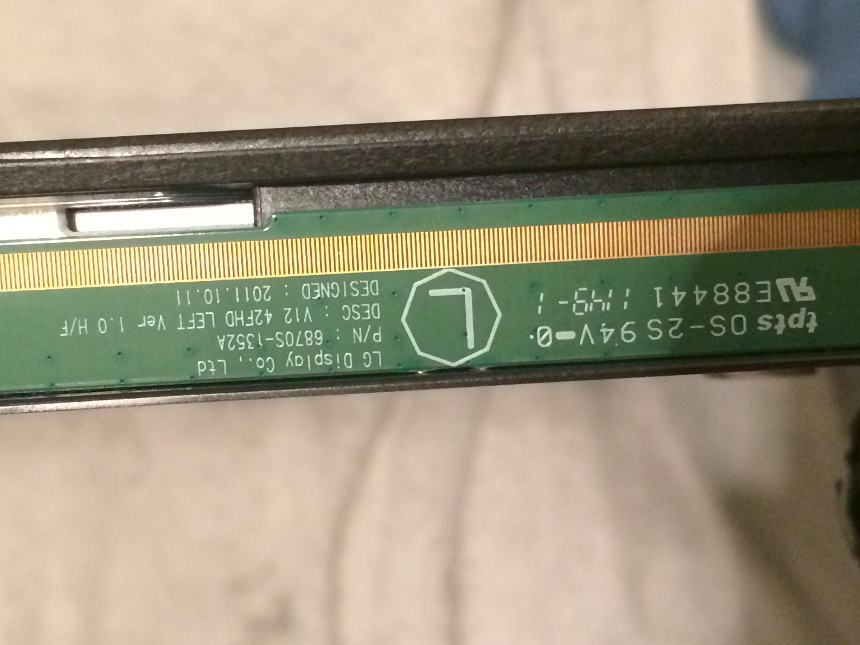

    the only place i found water damage was at the bottom on the left part (that i"m not sure how its called) that is connected with a ribbon to the T-con and with 3 ribbons to the LED screen (there are 2 of the one is called left and one is called right but they seem identical only assembled the other way around)

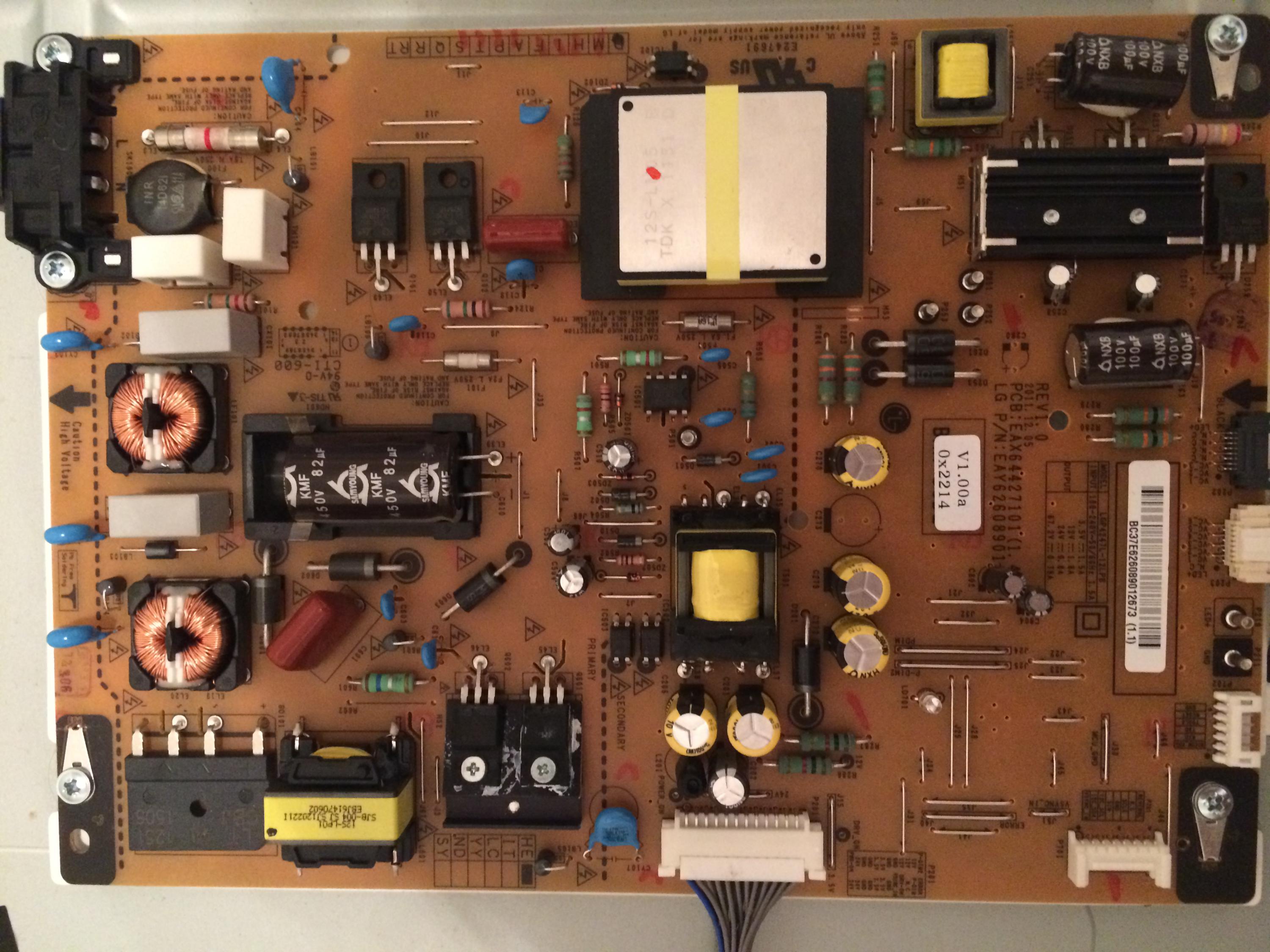

    i checked all the fuses on the power board and they were fine.

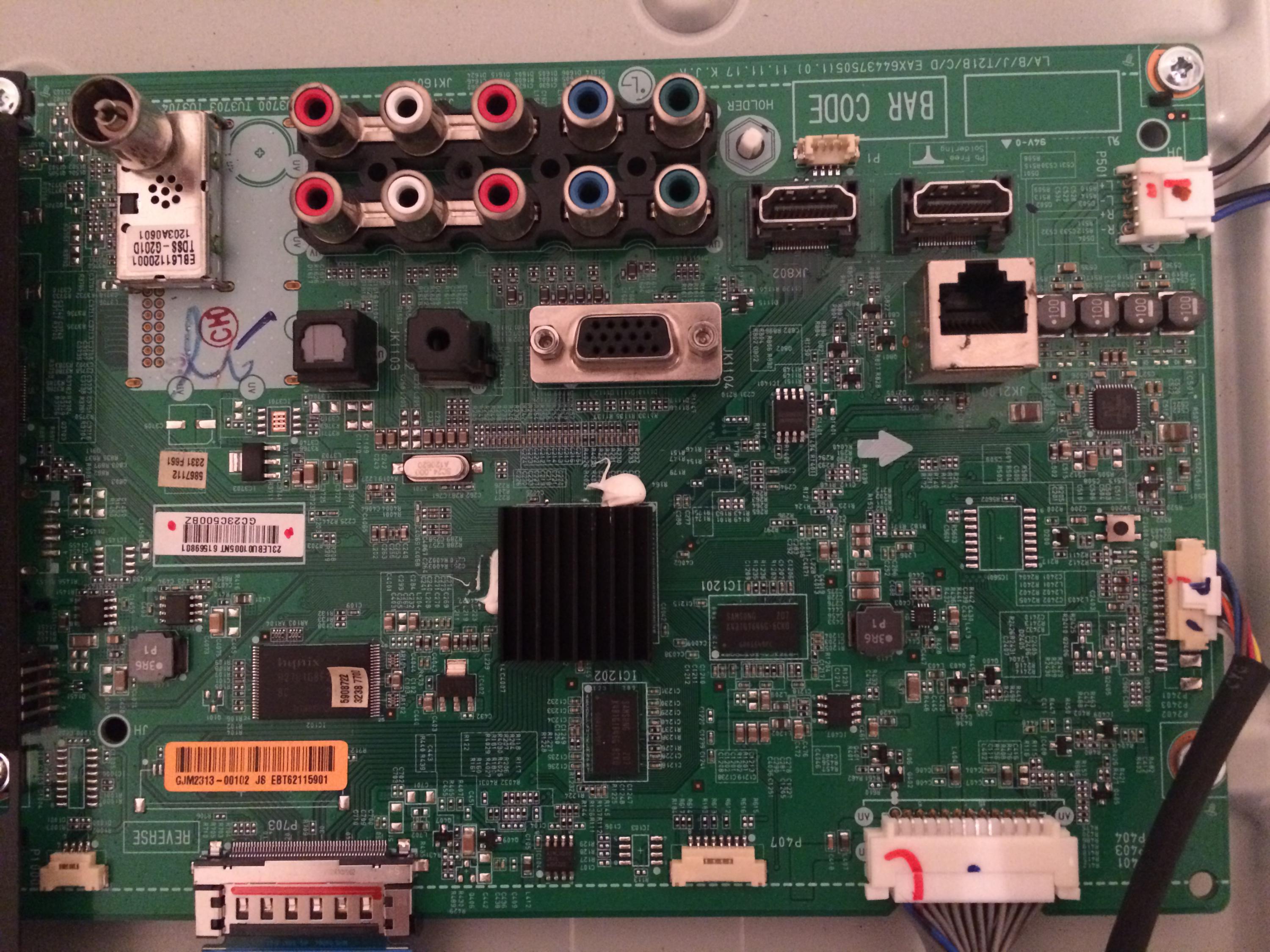

    i checked the logic board and it seems to have the 12v and 3.3v (vcc) in all the places i checked
    the T-con gets the 12v when the tv is on
    only problem that i was able to find is that one of the resistors at the bottom (R104) was severely damaged from the water damage and showed no resistance and also showed 5v on one pad but 0v on the other so i replaced it (poorly) and now passes on the 5V (also checked on the via that's after the pad and all looks fine)
    this happened 3 months ago and i didn't have time to try to fix it because i also study and work part time and finally now i have a vacation.
    i will attach the photos and if you need a better picture of anything please let me know and i will upload it asap .
    also have the schematics if anyone is interested and i will attach it below
    i can measure anything you"ll ask or replace almost any part on the board
    thank you guys in advance :-)

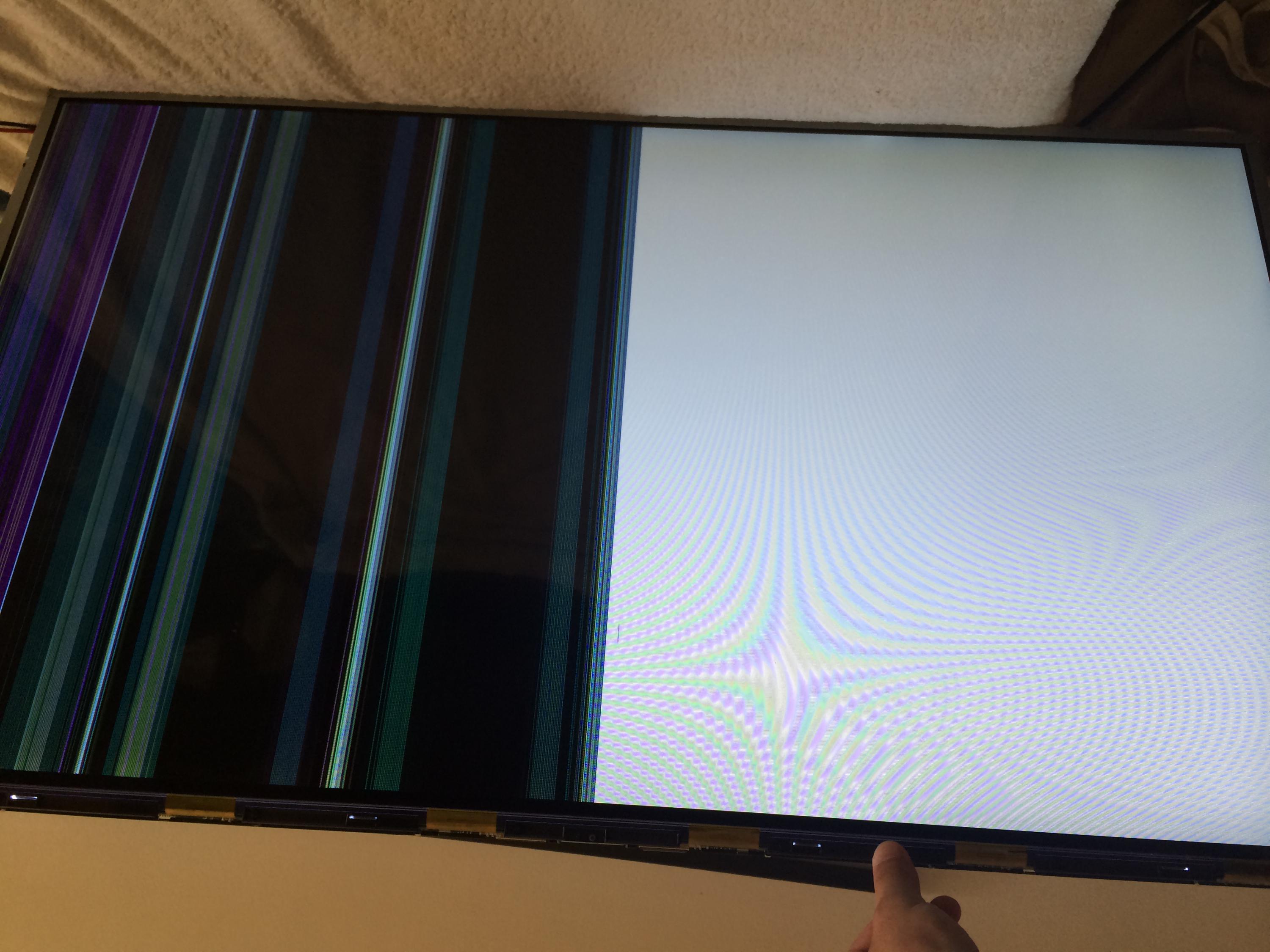

    Re: Lg LED 42lm580y-tc no picture
    tested all the voltages on the power board and all looks in order
    then i tried disconnecting each one of the cables connected to the the Tcon and here are the results
    can anyone please help me
    thanks
