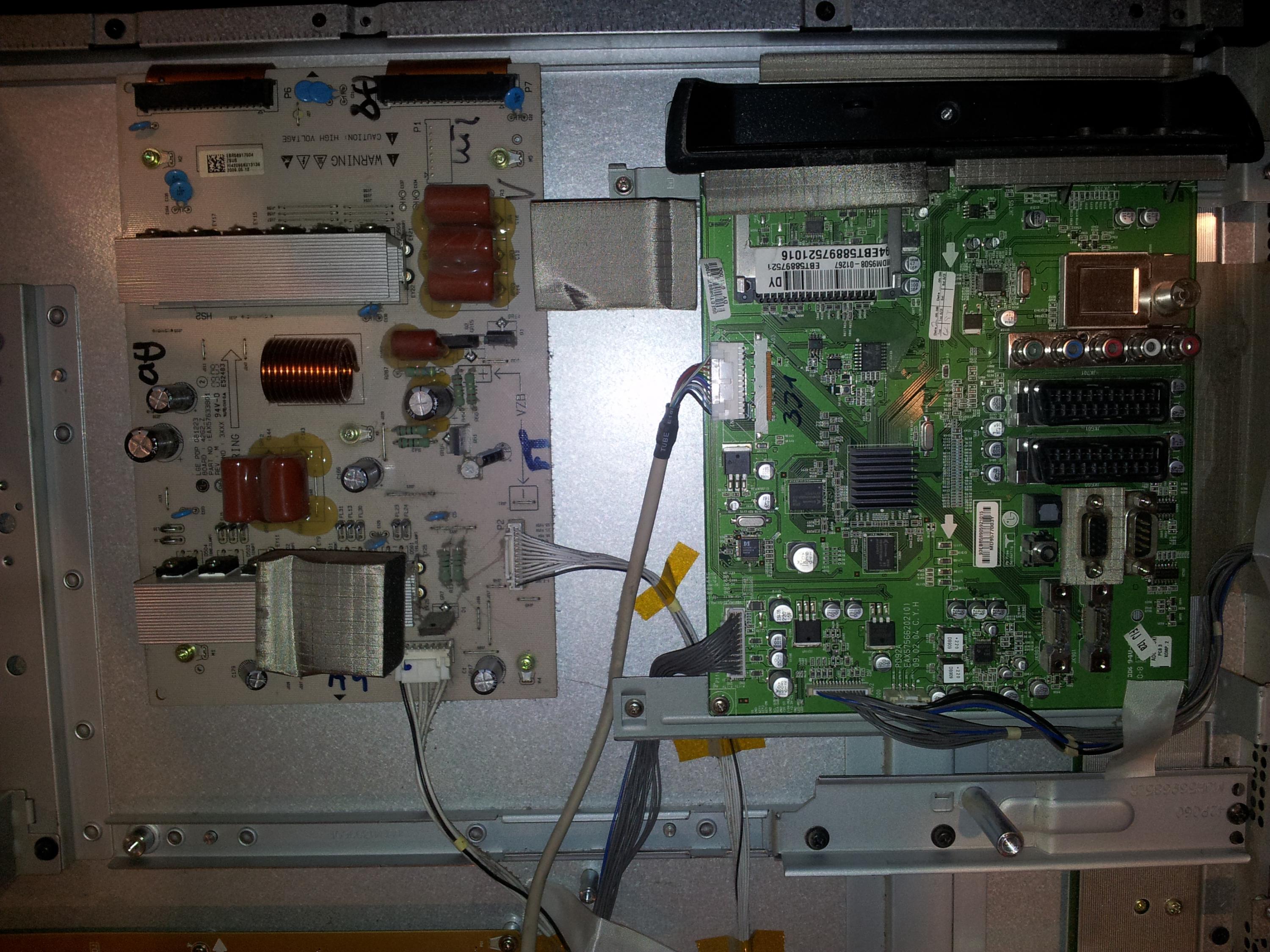

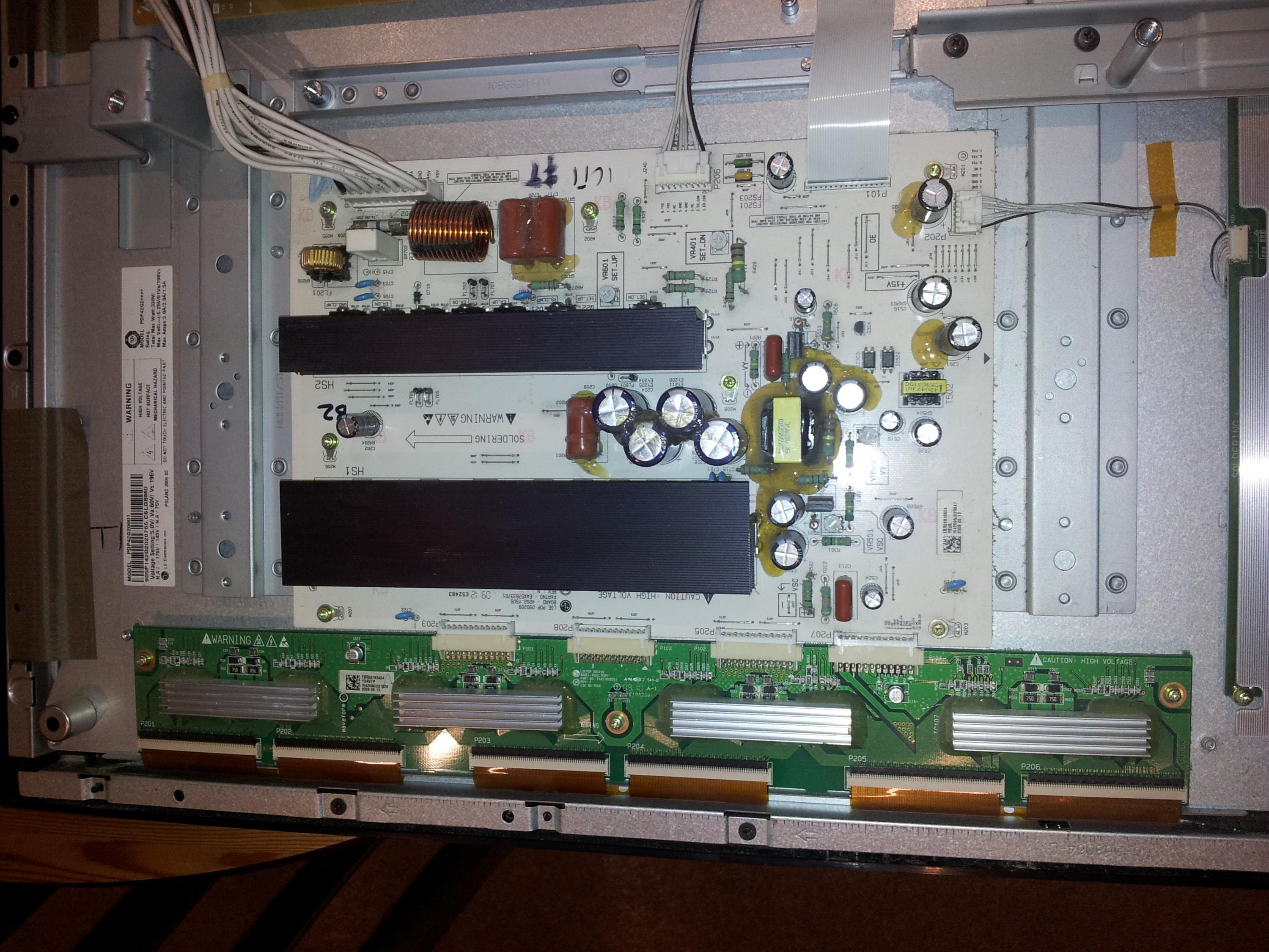

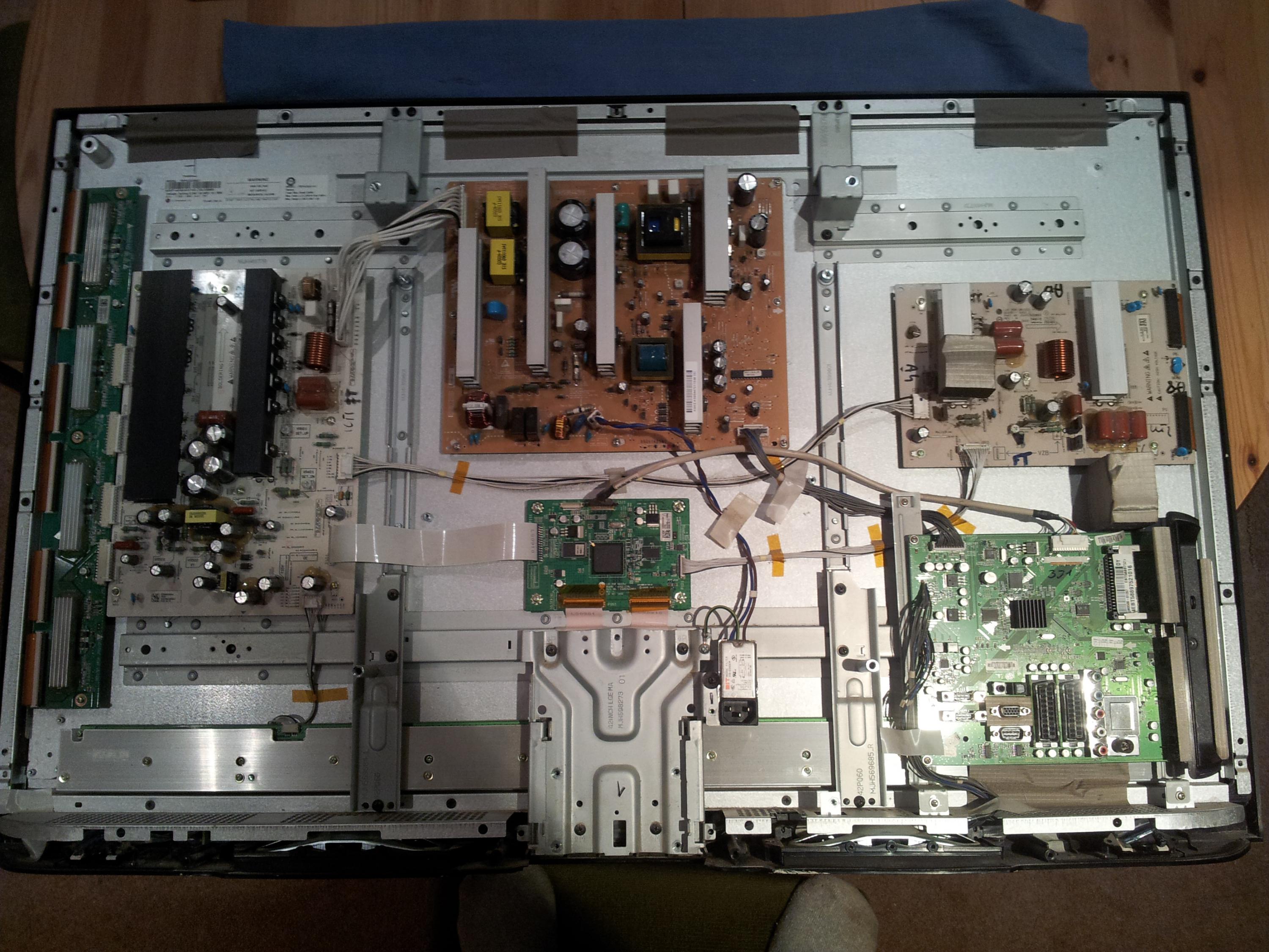

    Can you supply pictures of the boards and parts inside the set?
    • fascia-man
      • Sep 2014
      • 17
      Re: LG 42PQ6000 plasma
      Hi Tom
      hope these help
      board numbers are
      EAY59544701 power
      EAX57622801 control
      EAX57566202 av
      EAX57633801 zsus
      EAX57633701 ysus
      justin

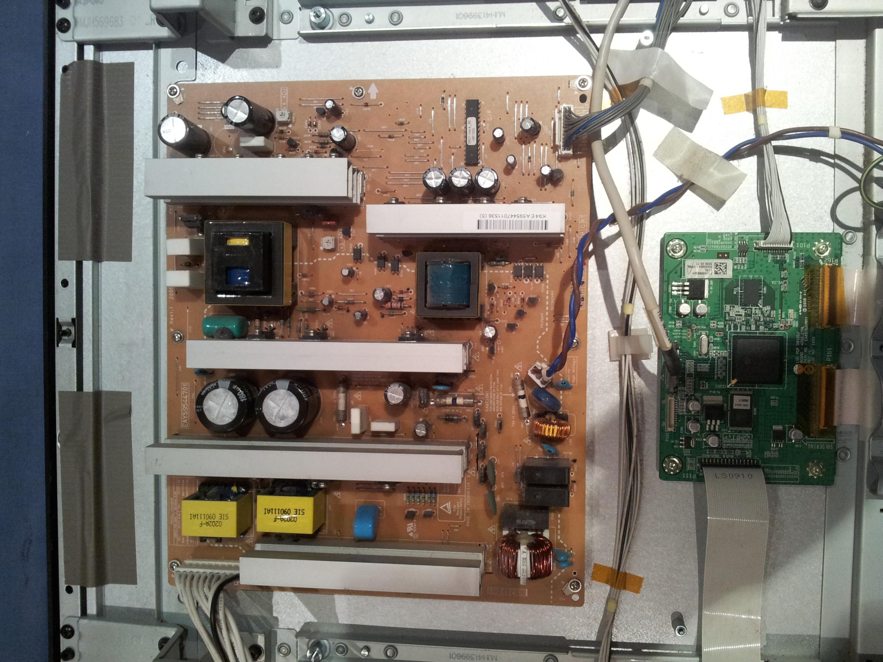

        OK, have you checked that fuse in the middle of the power supply? Between the 2nd and 3rd heatsinks (from the bottom of this image: https://www.badcaps.net/forum/attach...3&d=1411502216)
        • fascia-man
          • Sep 2014
          • 17
          just rechecked the said fuses 1 white one and 2 with black stripe all check out fine

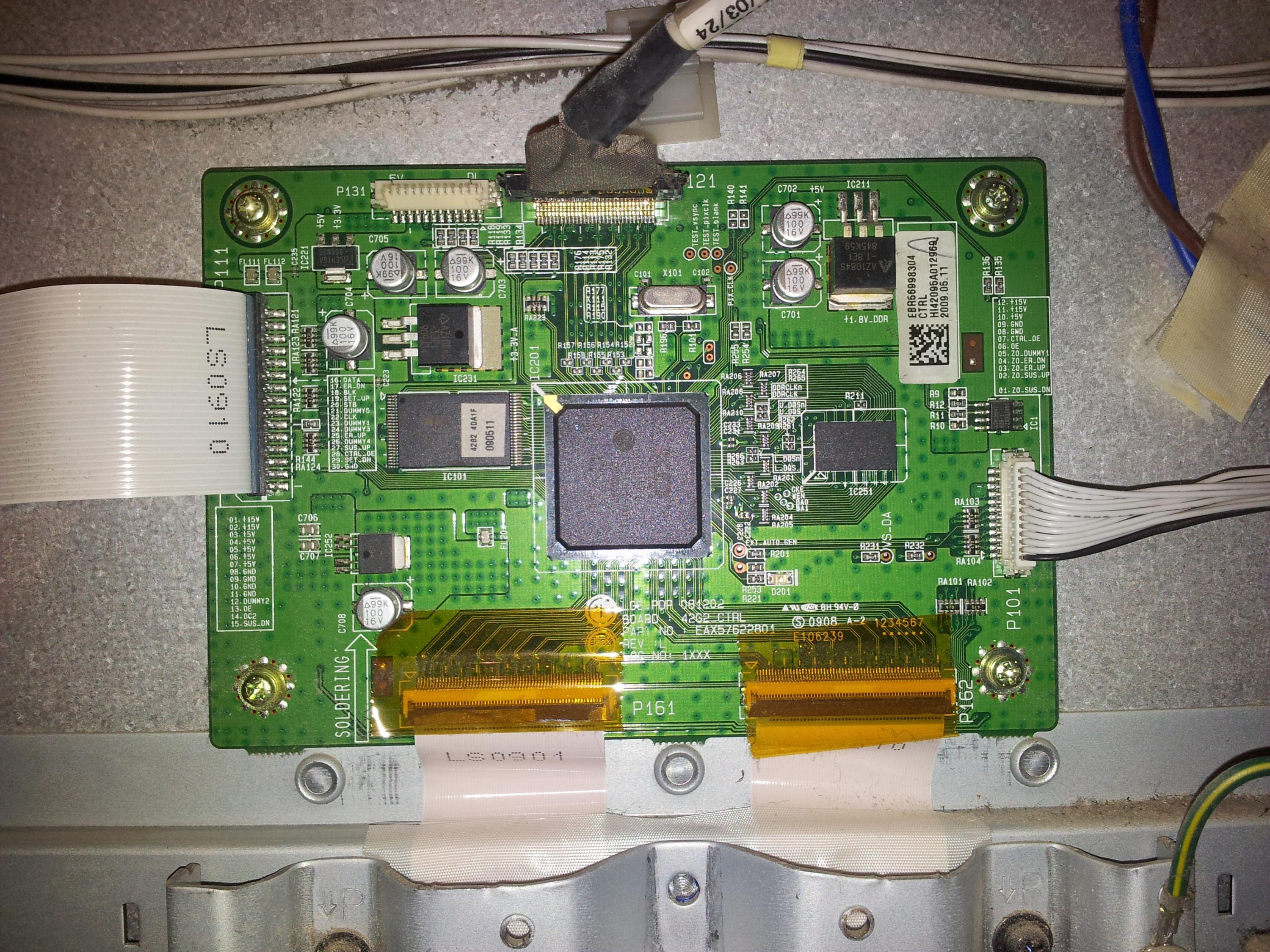

                                Ok, can you post a closer photo of the control board, I need to be able to see the writing better.
                                • fascia-man
                                  • Sep 2014
                                  • 17
                                  control board
                                    OK, just above and to the right of the "LGE PDP" writing there are two holes marked EXT AUTO GEN
                                    Take a piece of wire and jumper these together by hooking it through both holes.
                                    Unplug the top most connector (should go to the main board)
                                    Plug in the TV, do you see test patterns?
