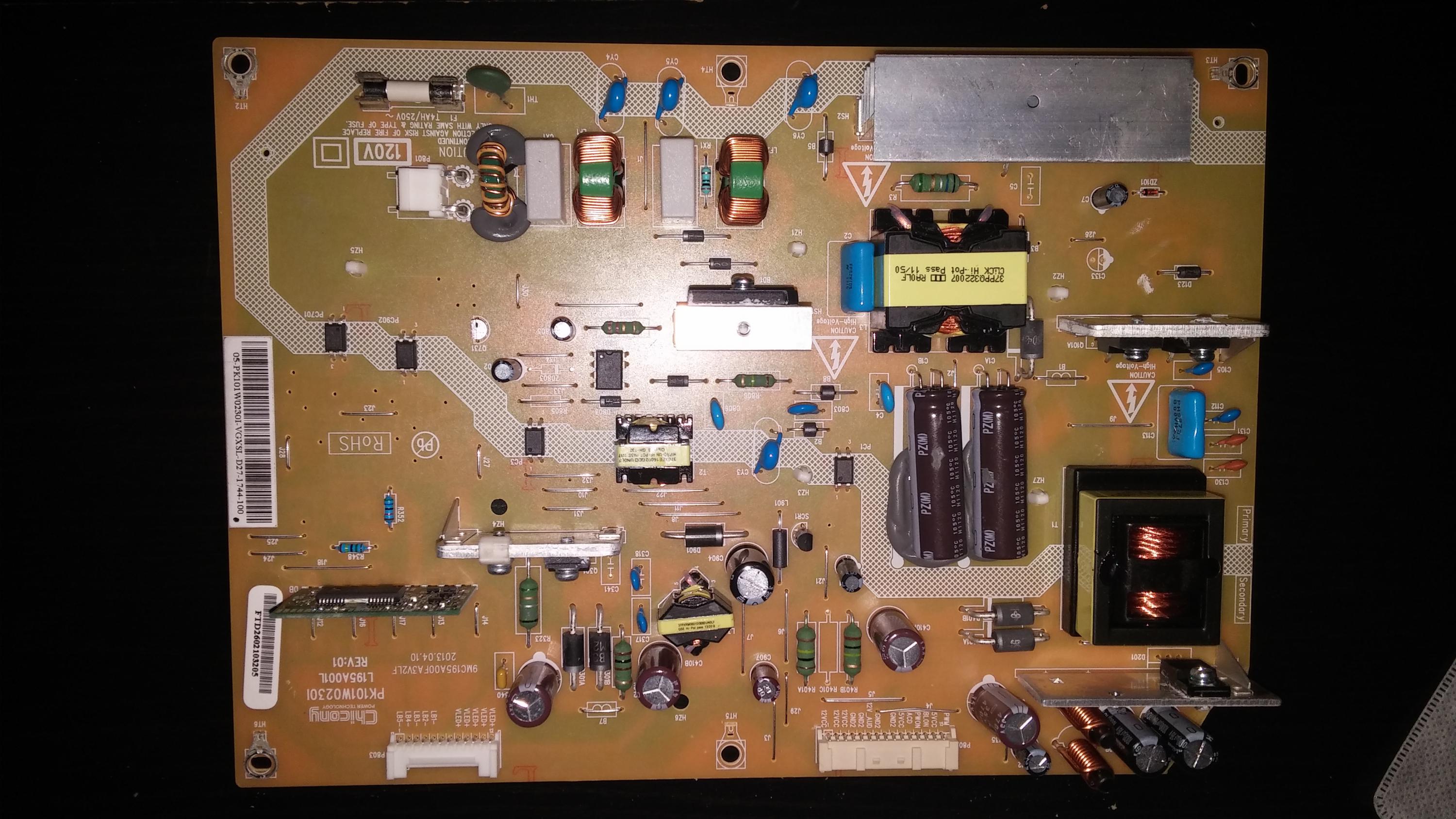

    I've verified that the 3.3V input from the Main board to the PSU is good, and I am getting the full 5 volts on the PSU side. I am NOT getting 12VA (pins 3,4) and am also not getting 12VCC (pins 8,9) (Picture 1)
    I am also not getting voltage on the 24VLED outputs to the inverter. (Picture 2)
    I've traced this back to the secondary side of the transformer. When I power on the TV I get 1-2 volts with the meter, for roughly 1 second, and then it goes back down to zero.
    I found a refurbished power supply board on ebay and just ordered it. It has a 14 day money back guarantee. But I wouldn't mind trying to find out the faulty components and maybe repairing this one and selling it to recoup the costs.
    I've verified i'm getting voltage off of the big capacitors (getting 167v on each one) But im not sure if that is within the spec. Next to try is the rectifier circuit voltage. I've verified the AC fuse is good (first thing i checked).
    Does anyone have the spec/manual on the Chicony PK101V3120I power supply board handy? I've been looking all over online and can't find one for it. Even emailed Chicony and haven't heard back at all.
    Thanks for any/all help ahead of time.

    Can we see the picture of the whole top side of the board?

      Yes sir.
        Re: Toshiba 46L5200U1 Power issues.
        What DC Voltage do you get on P802 pin 13 (POWN) when TV is off and when power switch is activated)

          I get 3.3V when powered on, and 0 when powered off.

              167VDC on the main filter caps are correct since this power supply does not have PFC Voltage booster circuit.

                OK, PS_ON is OK, now we just need to find out why the switched 12V outputs are not on.

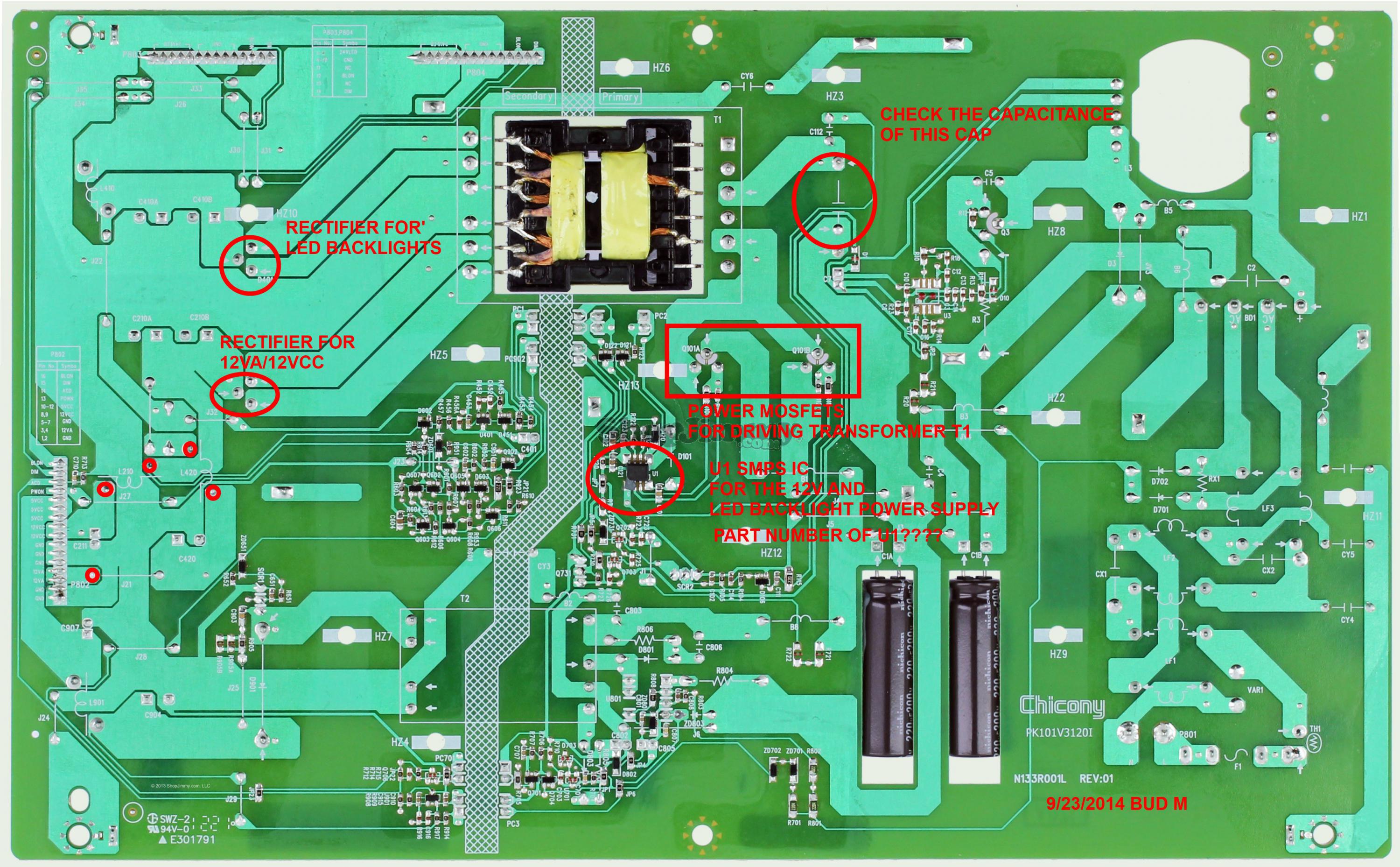

                    OK, I look at the bottom side of the board, right now the T1 which supplies the 12Vs and the Voltage for the LED backlights is not putting out, it can be due to bad cap (red circle), bad SMPS IC U1 (need P/N so we can find out which pin is the VCC pin to check).
                    Notes: Photo provided by Shopjimmy.
                      Thanks for the info. I'll try to get some pictures tonight to see which chip IC U1 is, and i'll also check out the test points you mentioned. Thanks for the great info!
                        the U1 chip is an ST product Number L6571b link:
                        http://www.alldatasheet.com/view.jsp...5toaAnou8P8HAQ

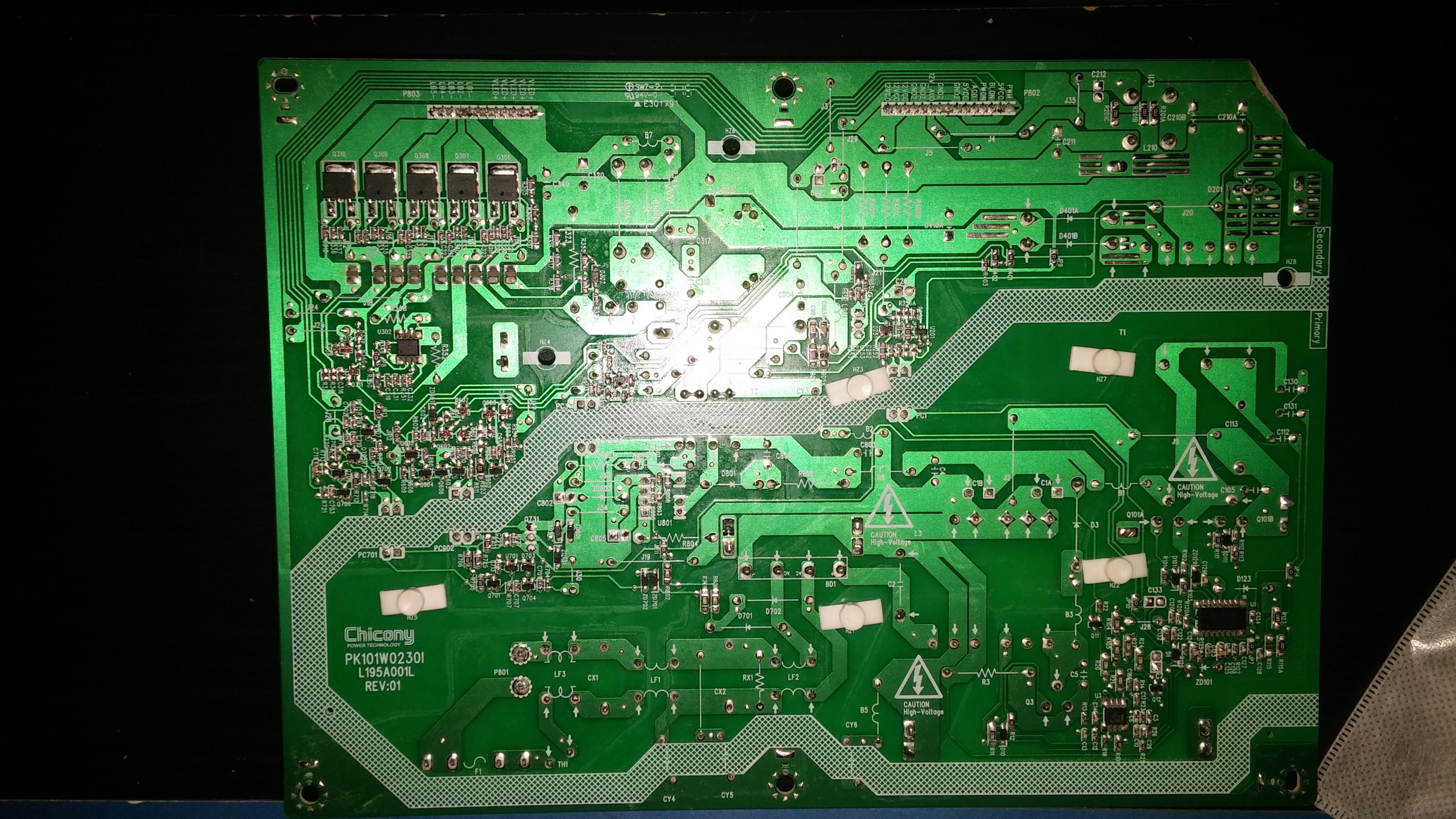

                          I have same problem, but the power supply is not exactly the same. Model Chicony PK101W0230l
                          C1A and C1B 389.7V when P802 is connected and 146V with P802 unpluged.
                          I have 5V output to main board, but not 12V output
                          PWON has 3.1 V when I plug the TV, no chage if I turn on. Can be a problem with power button?
