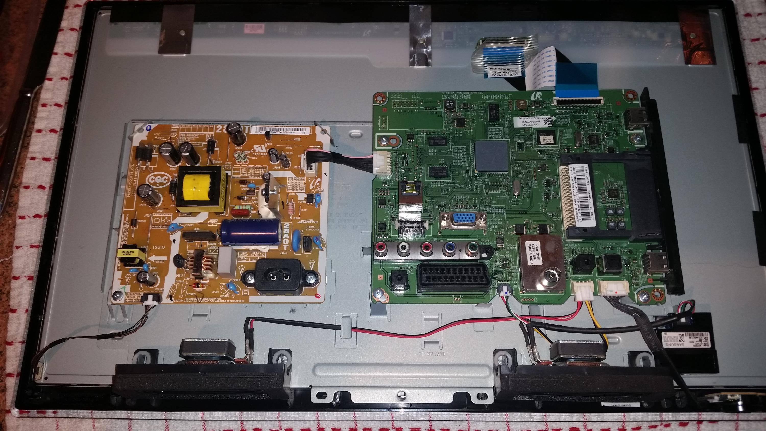

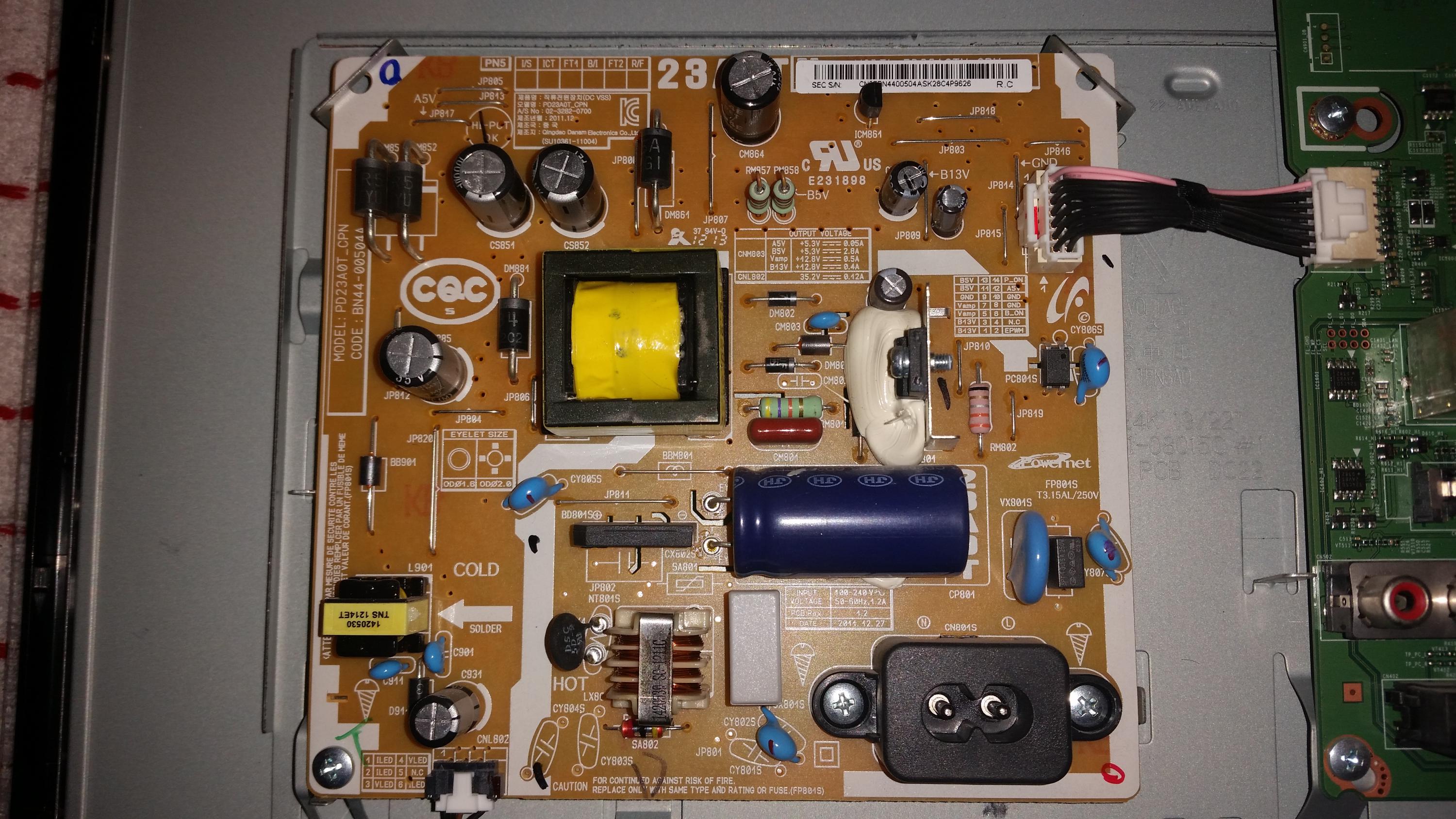

    ok this tv has no sound but works fine when speakers are plugged in
    checked voltages
    pin 1 13v 13.07v
    pin 2 Epwm 0.81v
    pin 3 13v 13.07v
    pin 4 Nc 13.07v
    pin 5 Vamp 13.07v
    pin 6 B_on 5.10v
    pin 7 Vamp 13.07v
    pin 8 Gnd
    pin 9 Gnd
    pin 10 Gnd
    pin 11 B5v 5.17v
    pin 12 A5v 5.22v
    pin 13 B5v 5.17v
    pin 14 P_on 3.28v
    main cap reading measuring 328 volts
    thanks

    Re: Samsung ue22es5400
    psu picture
      "ok this tv has no sound but works fine when speakers are plugged in " Do you mean you get sound through the audio level line out?
      The voltages look normal.

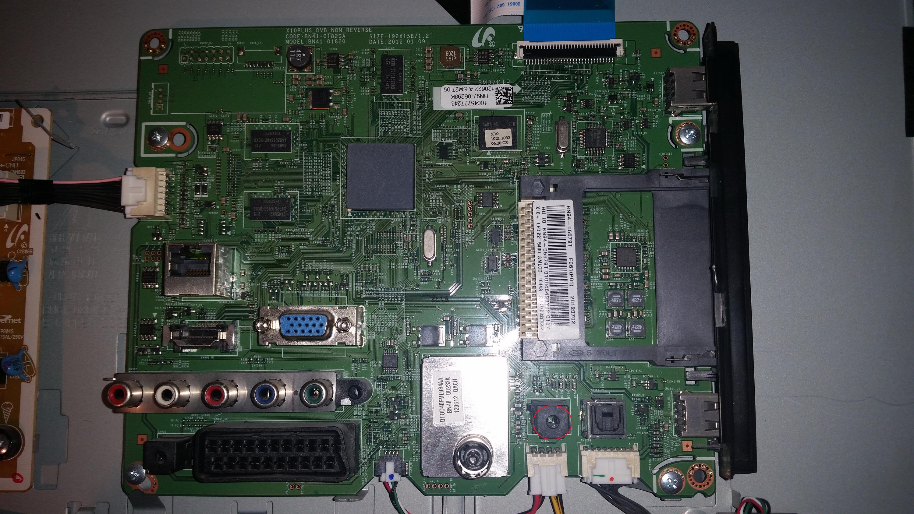

        hi budm
        i have a speaker connection on main board that works fine if i plug in headphone speakers
        ive circled this in red
          ive noticed i also have a strange ticking sound by the right speaker ?
            Try isolating left and right speakers individually by cutting one wire on each. Then try with just one in.
              I am not sure if the audio output at the headphone jack has its own amplifiers that are not the same Class D power amplifiers for driving the speakers.
              I think power amplifier is in that section that has 4 inductors with 4R7 printing on the top.
              Need to find the diagram for this main board next.
                  Probably a bad audio amplifier IC. I doubt a schematic for E-series (2012) Samsung will be available.
