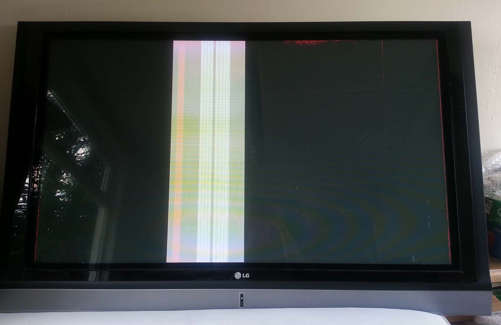

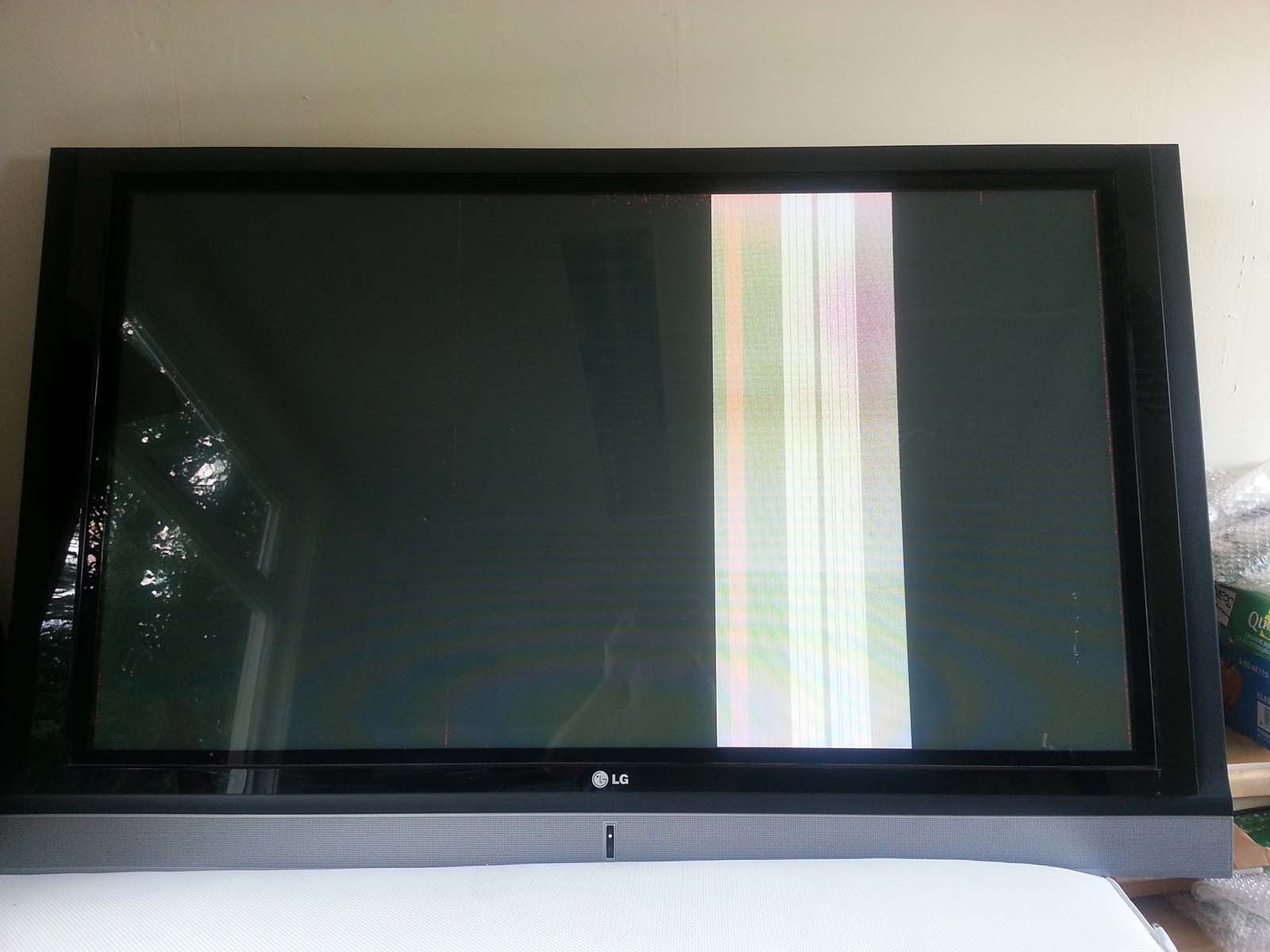

    Hi
    Got a LG 50" Plasma TV 50PC1DA with a major screen issue. I'm thinking its a bad panel, can anyone confirm this ?
    thanks
    Mark

    Re: LG 50" Plasma TV 50PC1DA Screen Issue
    Short MOSFET on Buffer-board.
      Cheers Alistair
      Much appreciated.
      Mark
