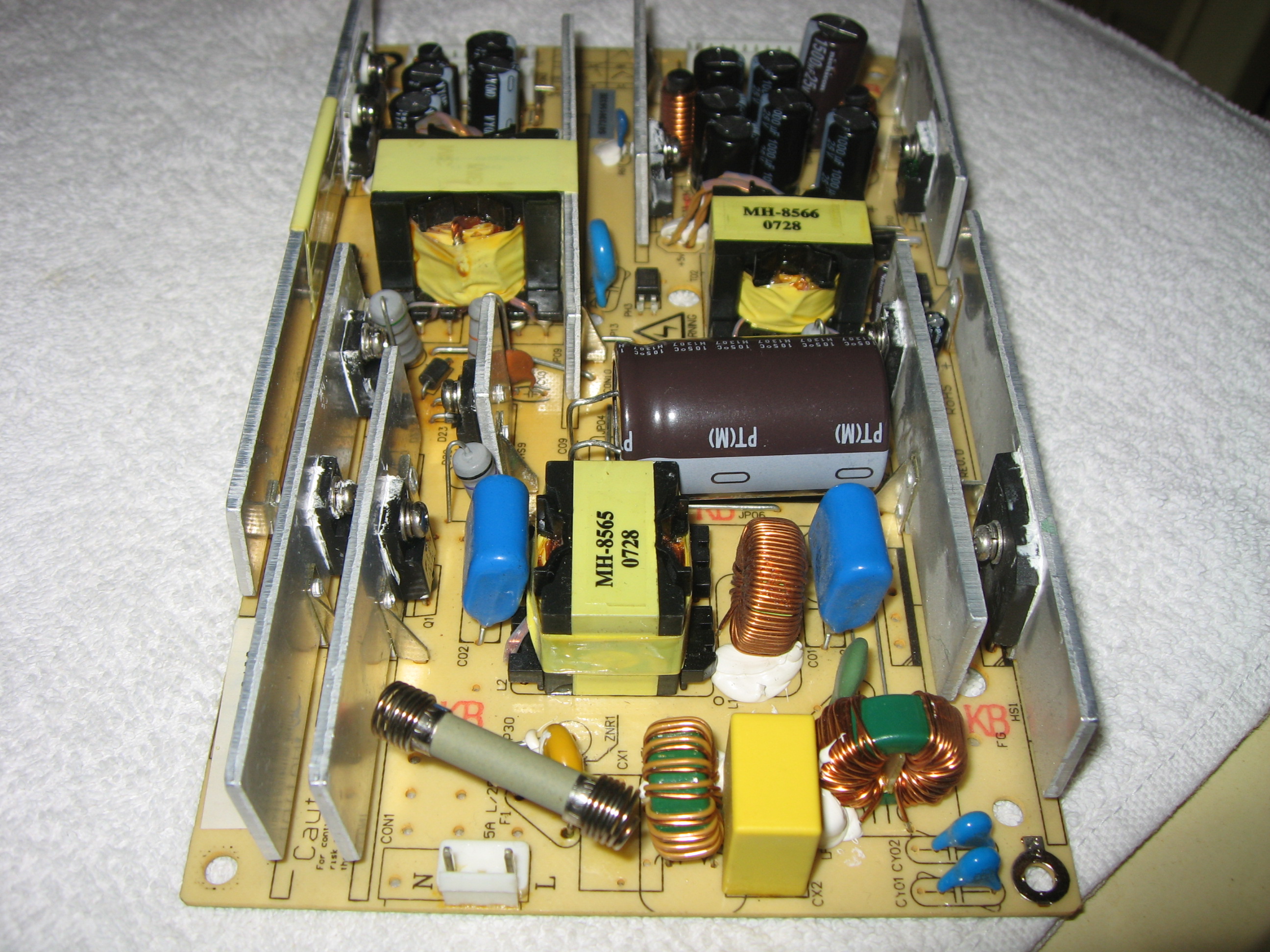

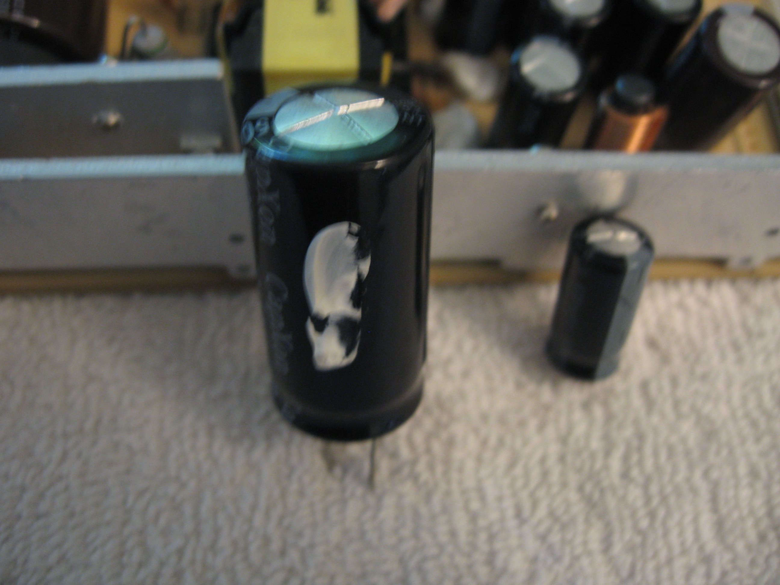

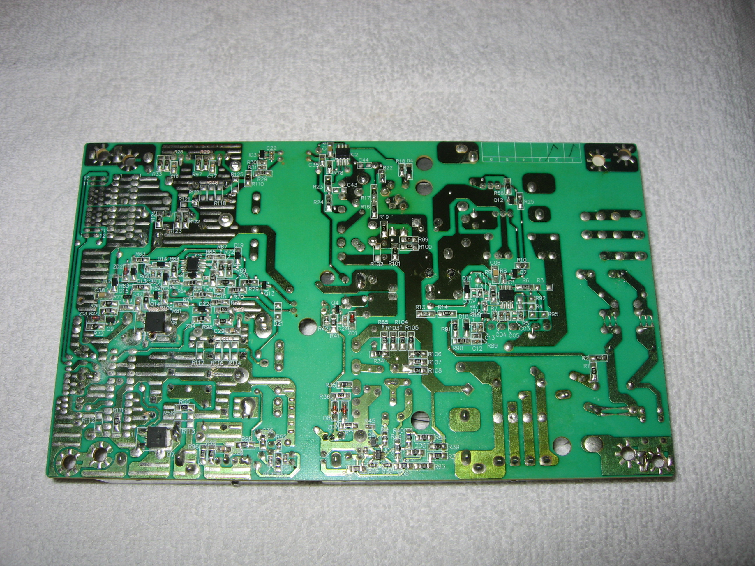

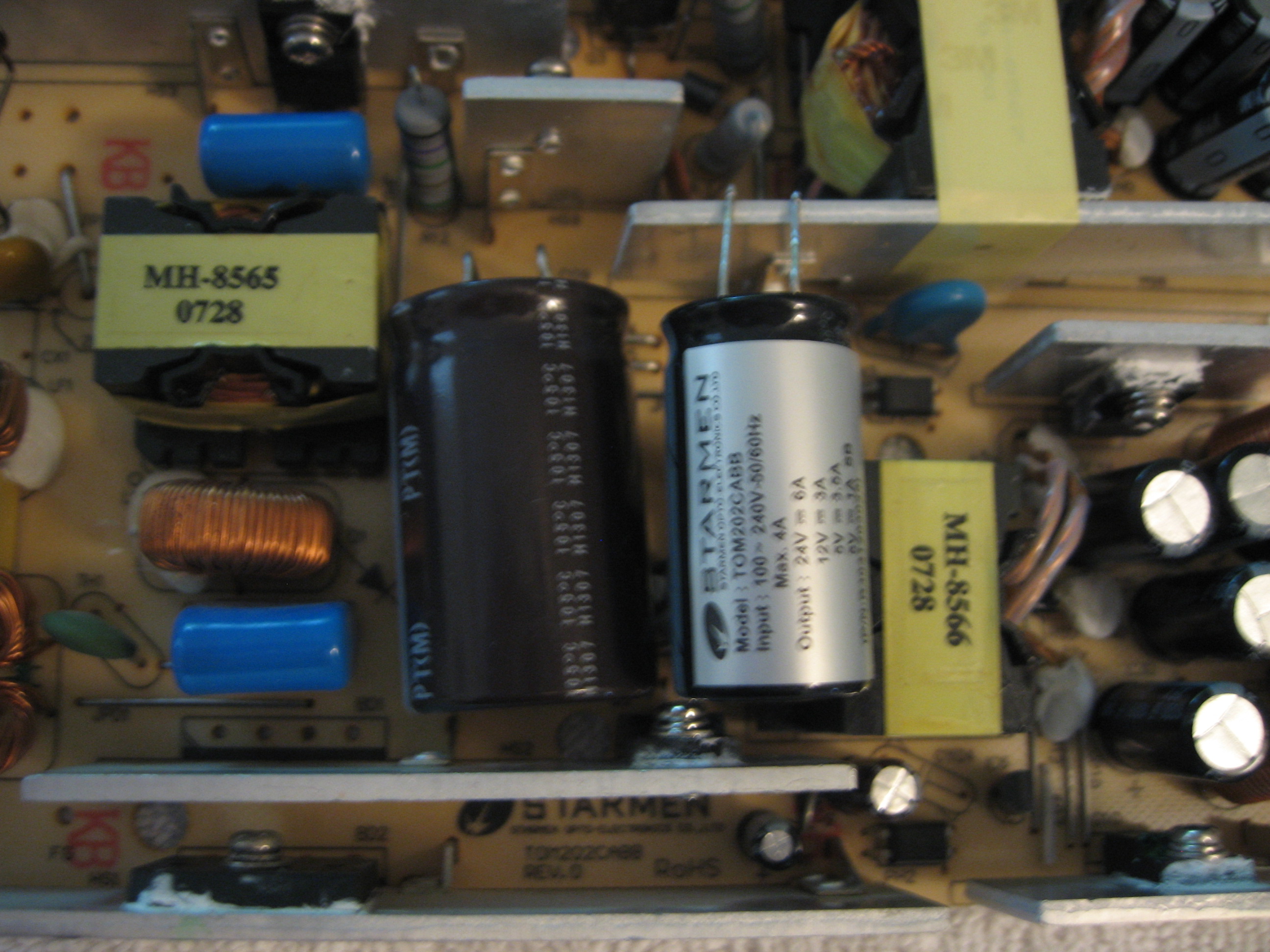

    The main symptom is the Power LED is completely dead. Nothing happens when the power button is pressed. It is not even red in standby. It does not turn green when power button is pressed. The 5a slow blow fuse is popped. I replaced all of the caps on the power supply as there were 2 that were bulged.
    As I am new to working on power supplies, I would appreciate any help steering me in the right direction to troubleshoot this power supply. Is there a way to obtain the SCHEMATIC for this item?

    1. No life whatsoever. No LED or sounds at all.
    2. Fuse is blown.
    3. Caps bulged -1500uf 16v C37 and 150uf 400V C09.
    4. 120v measured at incoming to fuse. Other side has no reading. Removed fuse. Reads open.

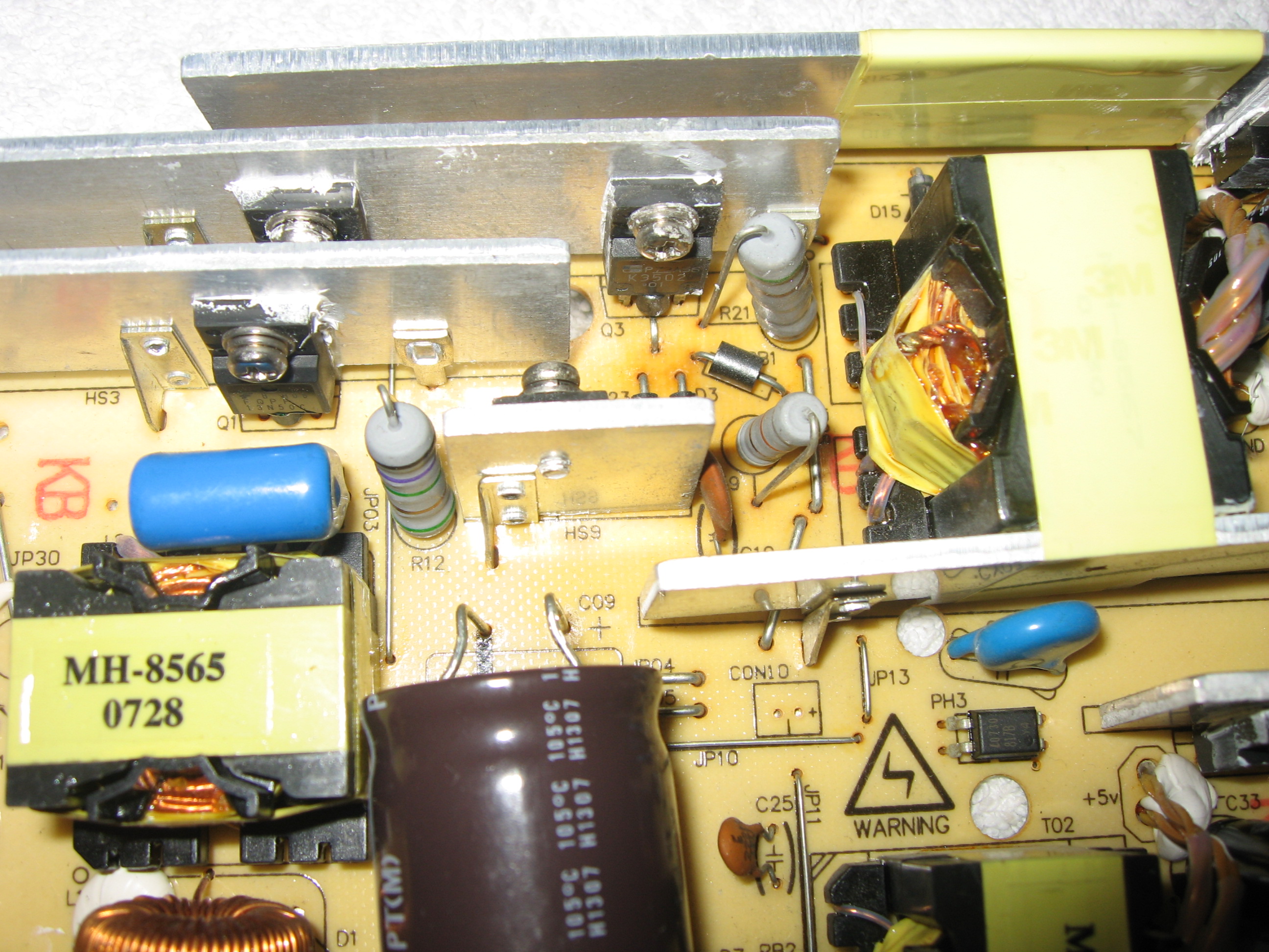

    5. Juncture of Q3 a [2SK3502 (N-Channel Power MosFet)],R21, RB1, D3 and D23 appears darker on the board.

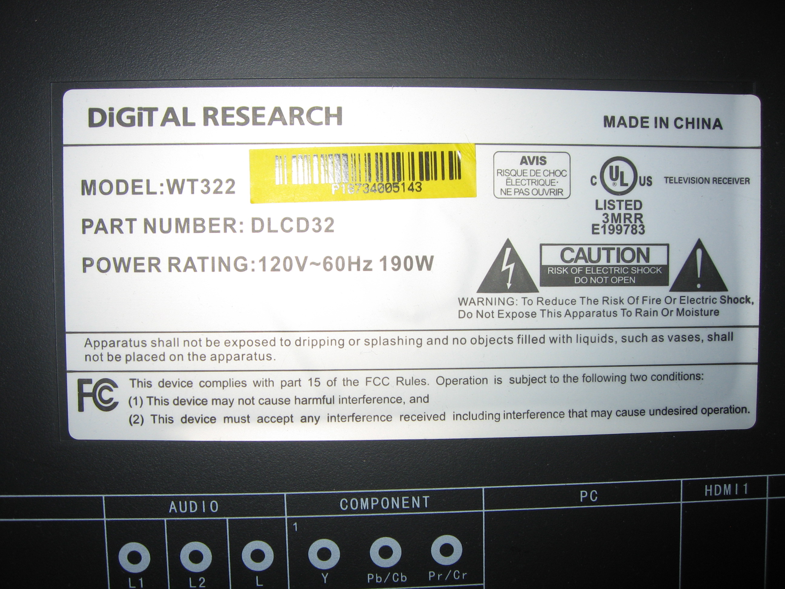

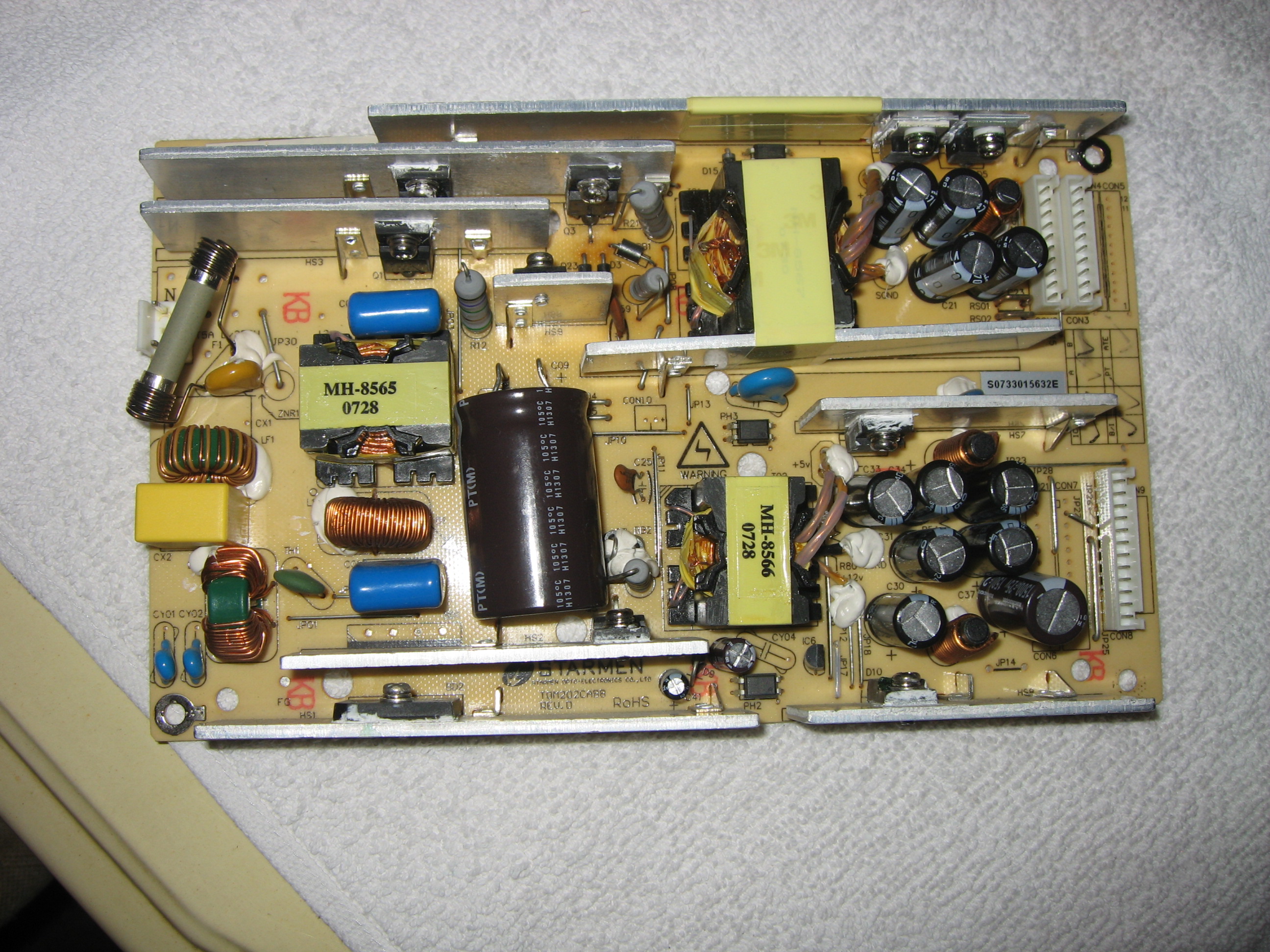

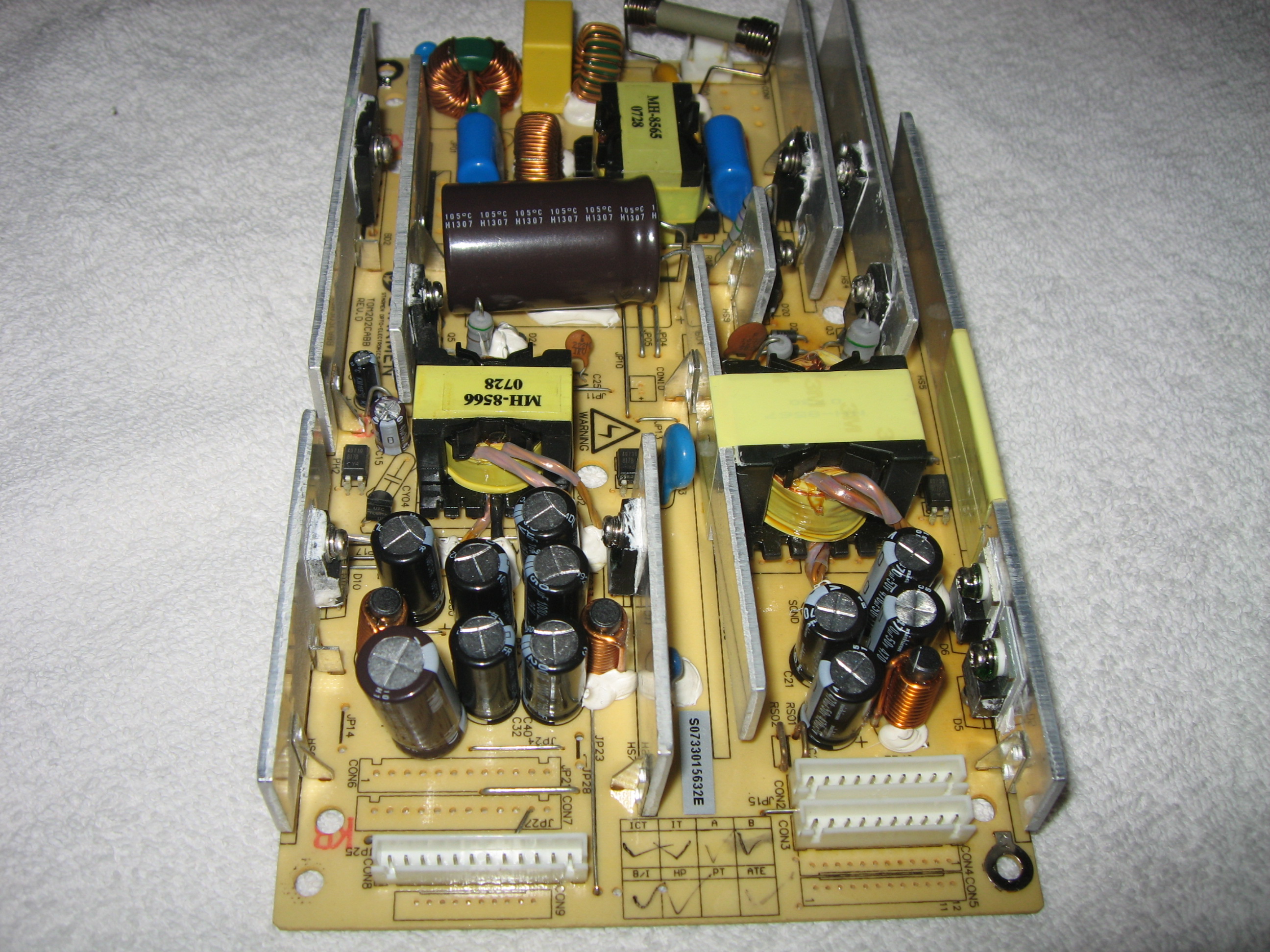

    Photos Included – If better photos needed I can dust off my Canon PowerShot Pro.
    1- Model Number Identification
    2- PS Board Top View
    3- PS Board Bottom View
    4- PS Board Left View
    5- PS Board Right View
    6- Q3 suspicious area
    7- Bulged Caps that led to replacing all capacitors.
    8- Comparison of Large Cap replacement

    BD2 – GBU606 (Bridge Rectifier)
    Q1 – FQPF13N50C (N-Channel Qfet MosFet)
    Q3 – 2SK3502 (N-Channel Power MosFet)
    Q5 – 2SK3115 (Switching N-Channel Power MosFet)
    Q11 – Unable to See because of Obstruction
    D5 – MBR20150CT (Dual High Voltage Schottky Rectifier)
    D6 - MBR20150CT (Dual High Voltage Schottky Rectifier)
    D10 – MS865C10 (Low IR Schottky Barrier Diode)
    D11 – SB2020FCT (Isolation Schottky Barrier Rectifier)
    D20 - ????No Name on Part
